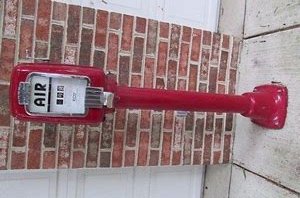

    [​IMG] OIPPUU803P3.jpg Sorry, just my first reaction. Merry Christmas. Bob

    You can't have to many PanHeads....................................................

    That's pretty fair. I had another friend compare it to a parking meter. The ****** is shaped kinda weird. I got *****d by a ****** once, but it wasn't quite shaped like a parking meter.

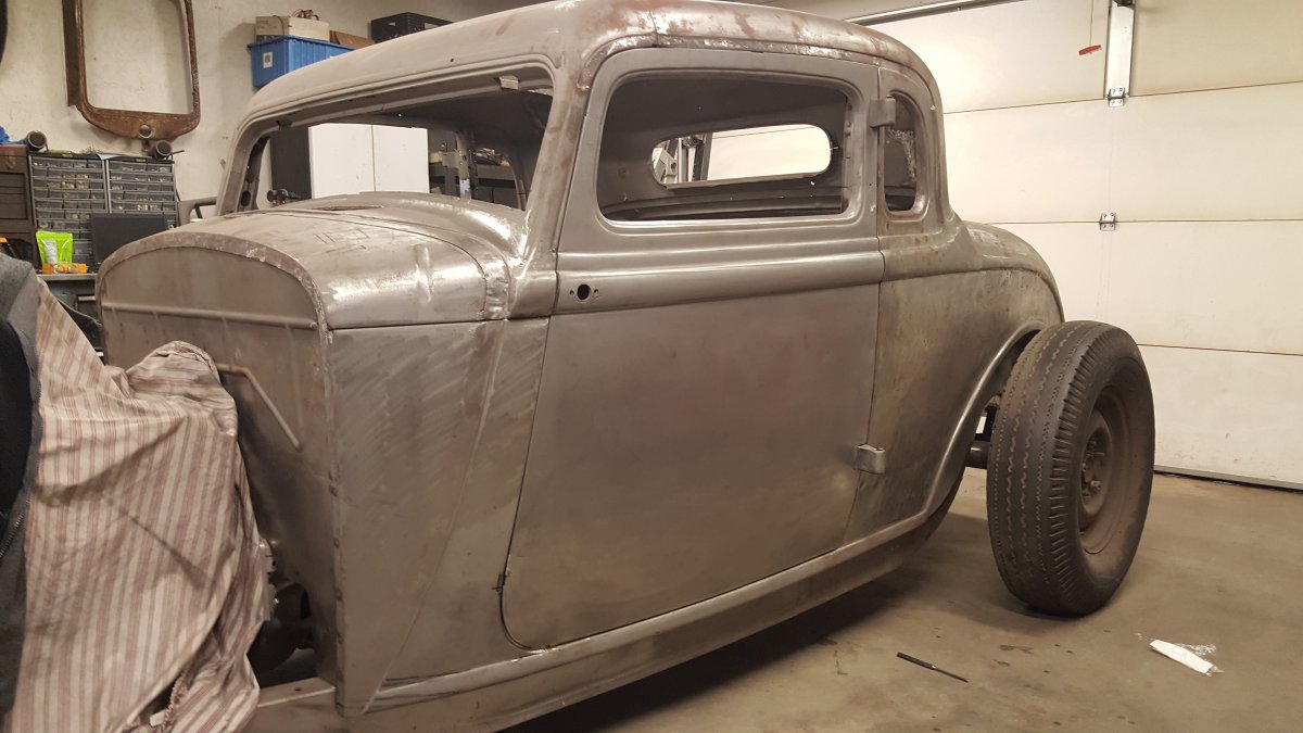

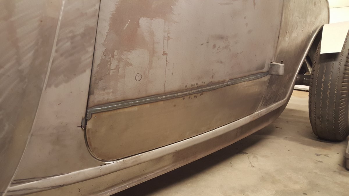

  7. Johnny Sparkle
    Joined: Sep 20, 2003
    Posts: 1,226
    Johnny Sparkle

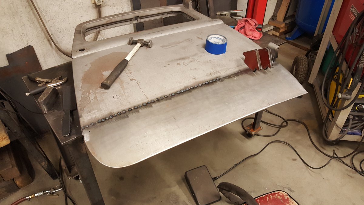

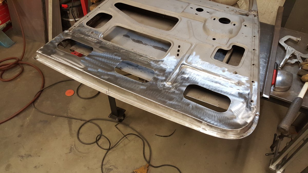

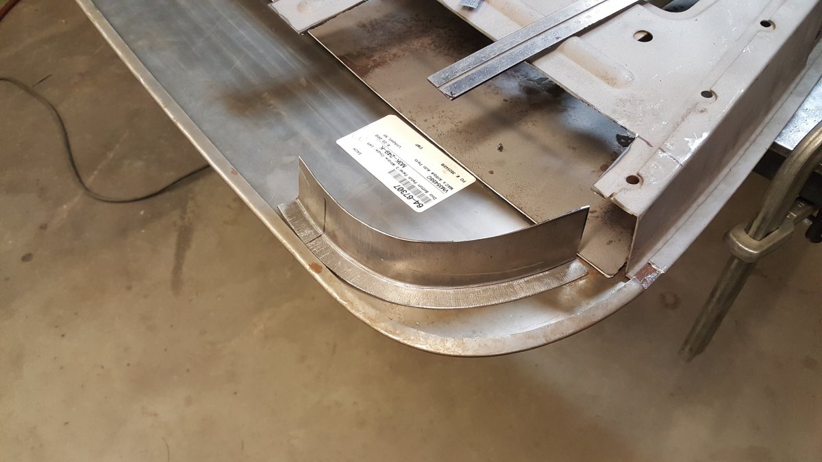

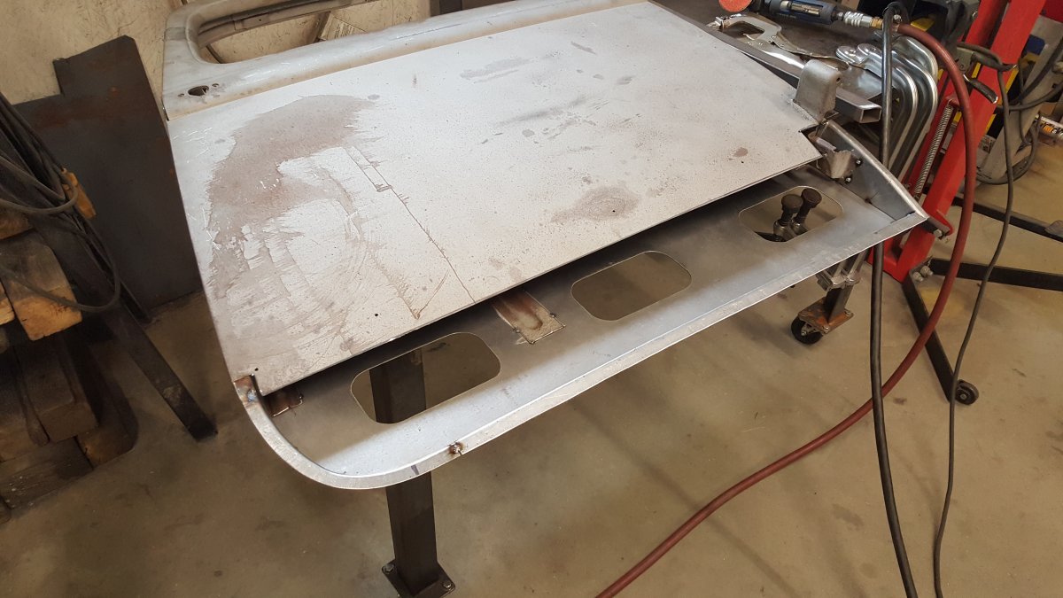

    Step 538:

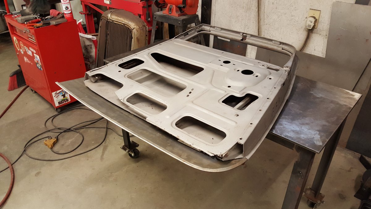

    It'd sure be nice to see the doors actually close. But, the doors are all wobbly sausage because about 1/4 of the damn things are missing.. Since you decided to take the stupidest route possible to build a car, the door bottoms have to be custom made.
    Try to make it follow the door opening. Try to make it fit the '32 3W door panel. Discover that those two goals are mutually exclusive. Shrink and stretch all of the things until it does some stuff.
    Driver's side done. P***enger side to be finished sometime between now and 2029.

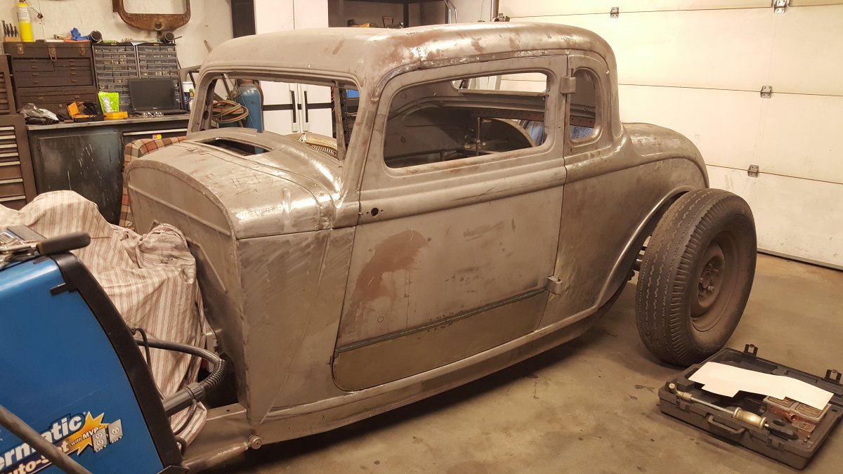

  8. Johnny Sparkle
    Posts: 1,226
    Johnny Sparkle

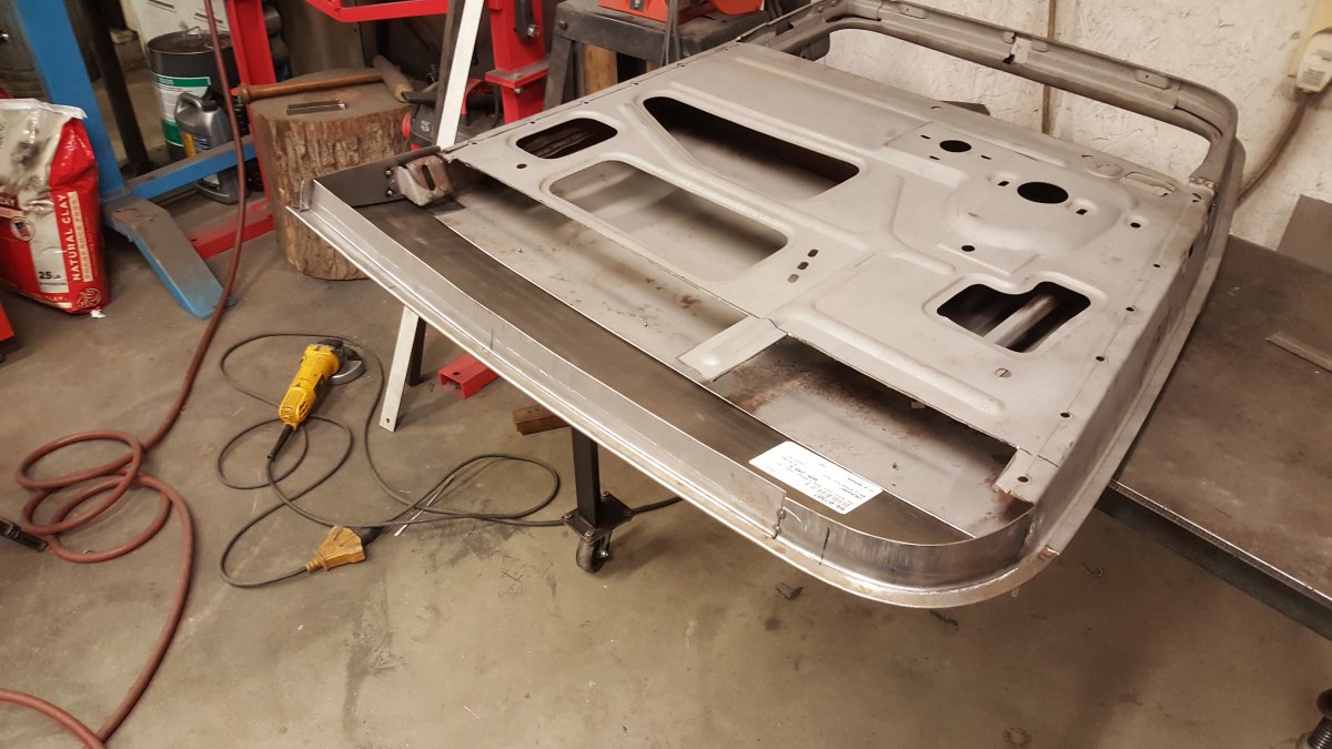

    Step #539:
    Fit the 32 3W door panel. Become concerned when it ****s in about 3/4" in the middle after welding. Hit it with a variety of hammers with increasing desperation until it finally doesn't look terrible. Grind the welds and take pictures at an angle in poor lighting so the panel looks way straighter than it really is.

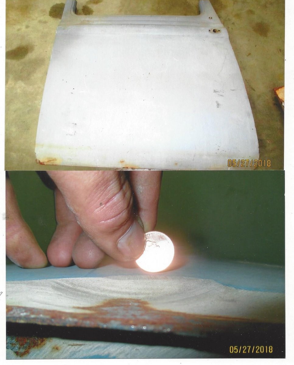

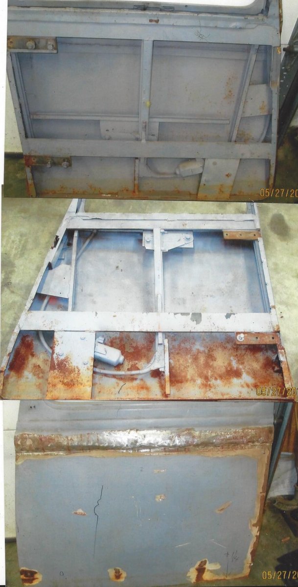

  11. stanlow69
    Joined: Feb 21, 2010
    Posts: 7,346
    stanlow69

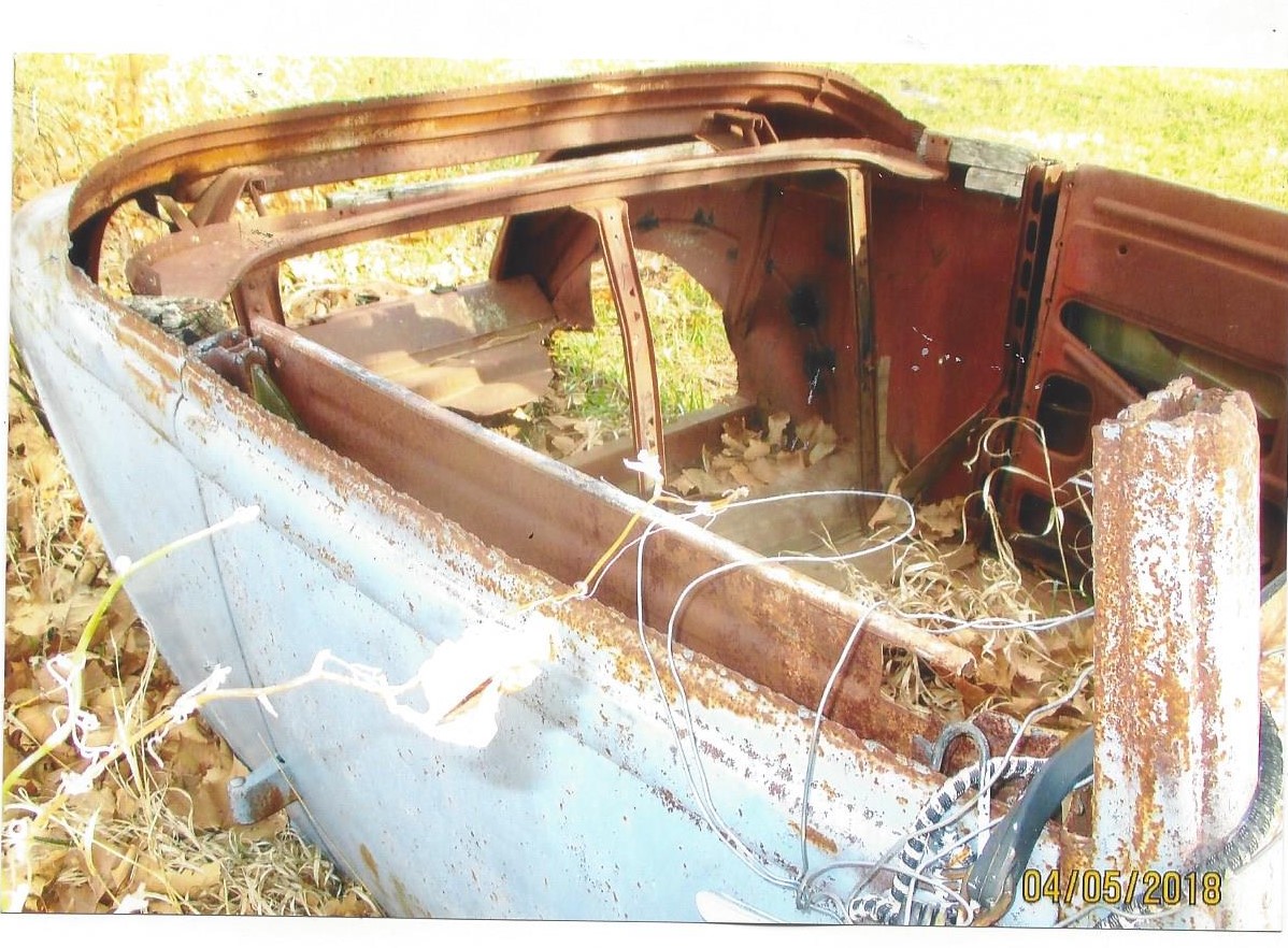

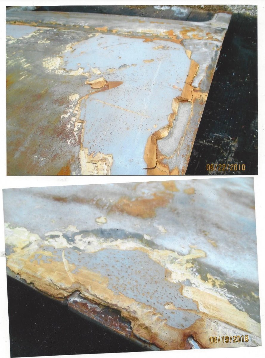

    Scan0691.jpg Scan0740.jpg Your doing a much better job than the guy who tried to fix these doors. They are very heavy. I got them for free to fix my door tops. Scan0741.jpg
    chryslerfan55 and vtx1800 like this.
  12. stanlow69
    Posts: 7,346
    stanlow69

  14. stanlow69
    Posts: 7,346
    stanlow69
    One door weighed 10 pounds more than the other.

    The37Kid
    That's two cans of mud isn't it?:eek: Bob

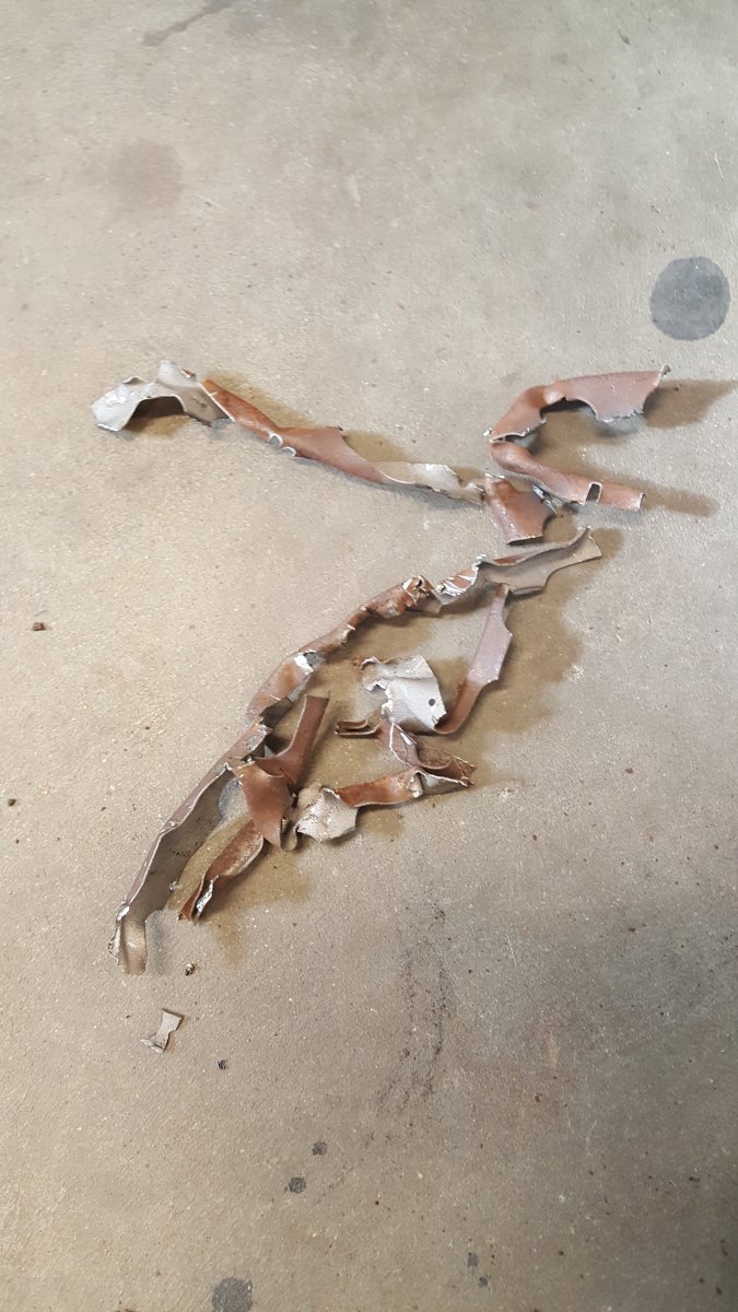

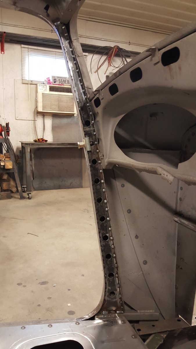

    Remove the twisted and cut up inside plating of the A-pillar.
    Install bear claw latch.
    Neglect to take any pictures of the bear claw latch install.
    Make new plate for the inside of the A-pillar.
