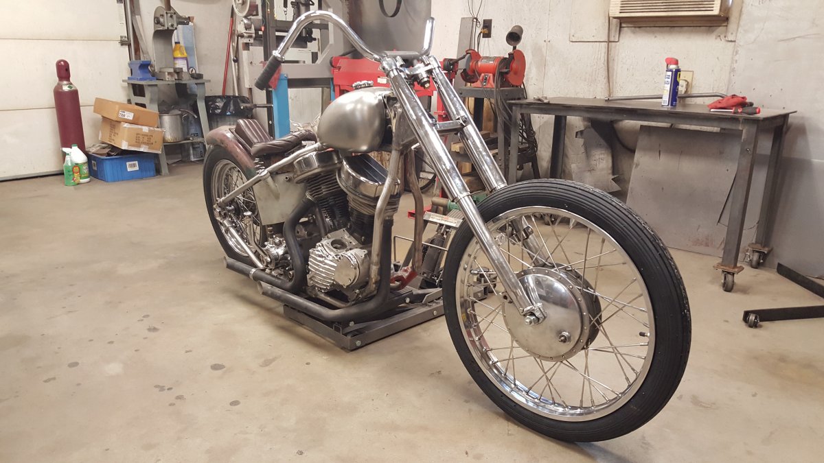

    Step 555:
    Almost worked on the coupe on accident. Better sell the Shovelhead and start on another bike.
    1948 Harley. It's fun making all the bungs and spacers and mounts in the lathe.
    The engine and ****** are currently in a thousand pieces. This should delay coupe progress quite nicely.

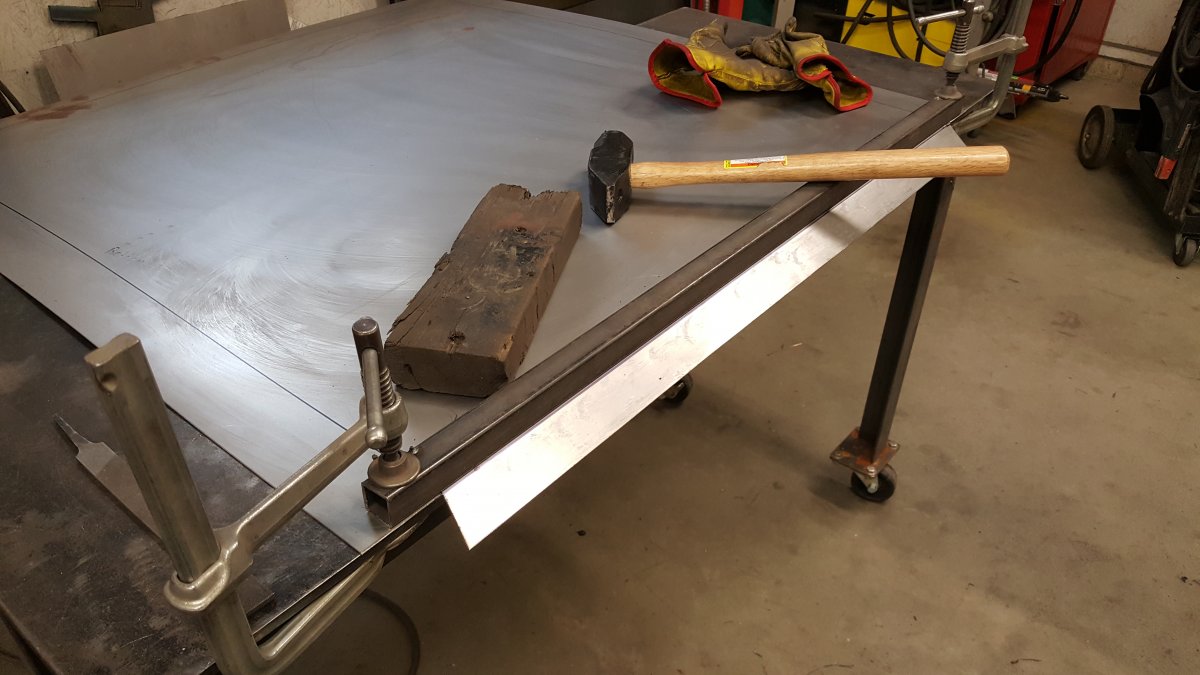

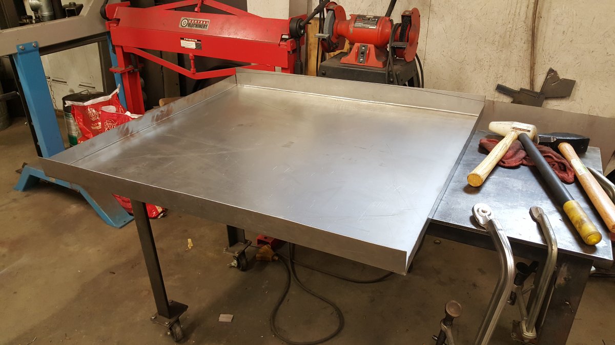

    Step 642:
    Cut a big chunk of 18 gauge steel. Hit all the things with hammers on your ghetto sheetmetal brake (aka whatever metal tube you can clamp down)
    Use the fancy Harbor Freight shrinker/stretcher to curve the thing. Realize you are a wimp and don't enjoy holding a huge panel at shoulder height for hours.

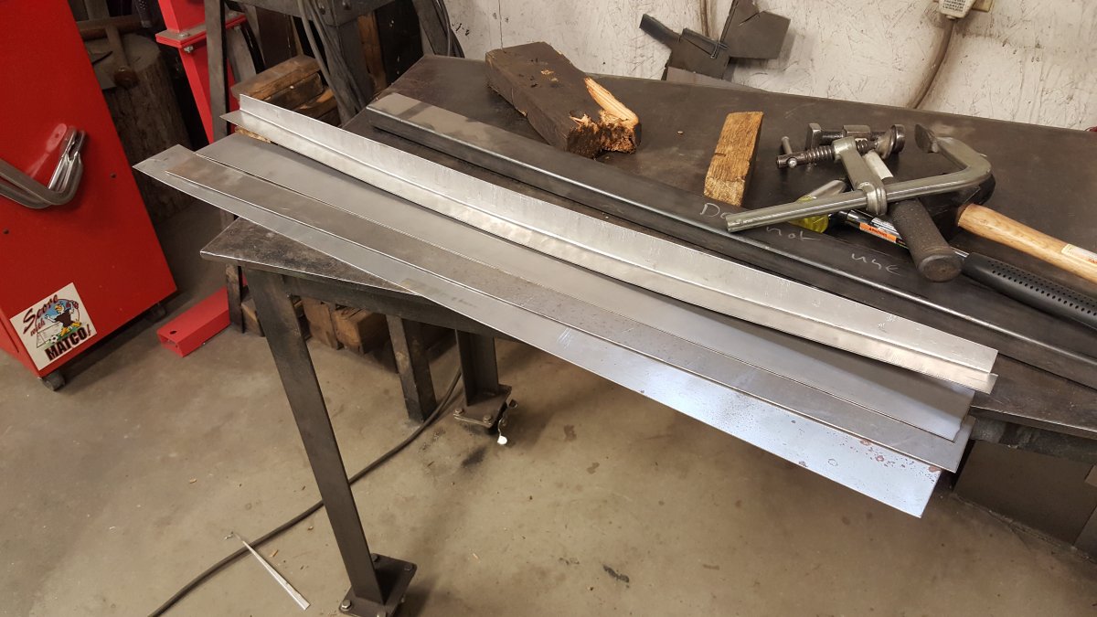

    Next step, I need to make 4 long strips of 18GA and bend them 90° and curve them to make the lip that the outer skin will be folded over on. It's gonna ****.

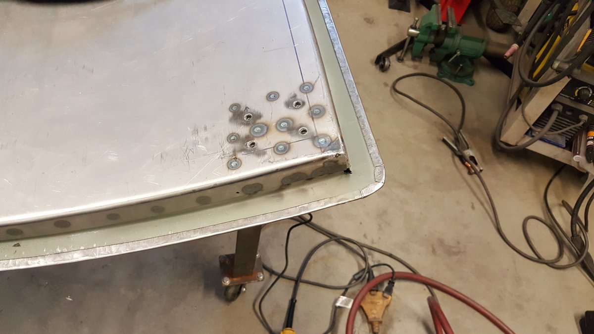

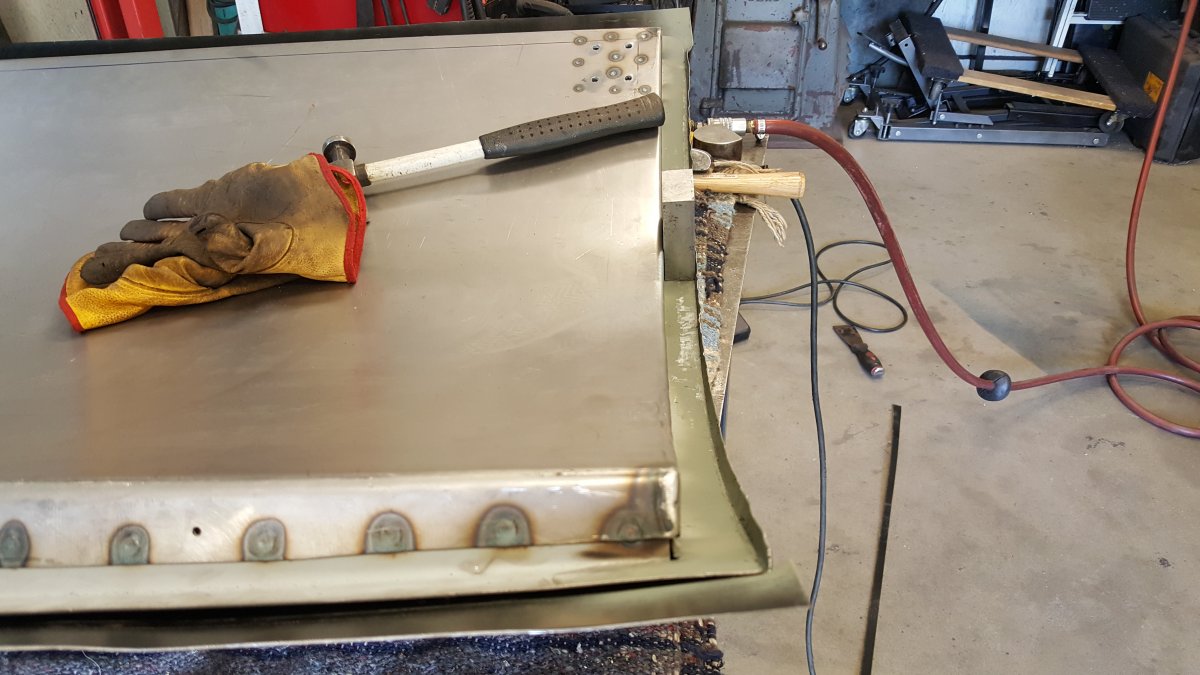

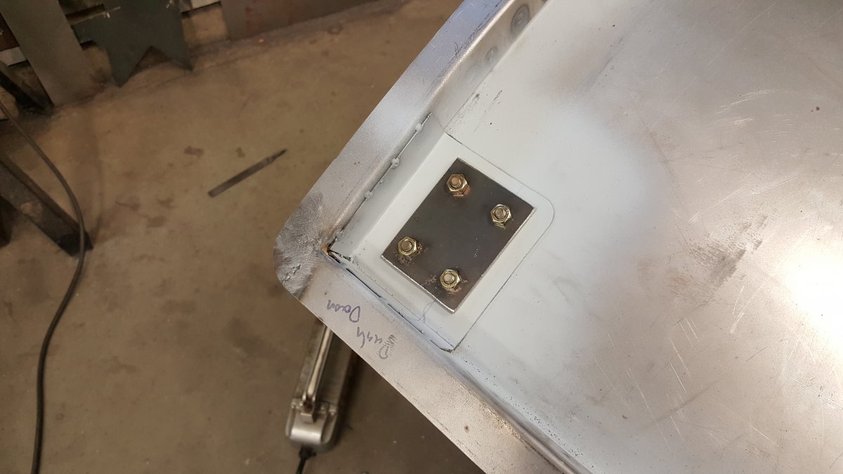

    Step 646:
    Weld the angle things to the other thing. Make support things. Mount the latch thing. Trim the sides to make an even gap. I gapped the inner panel about 1/4", it may have been a bit wide, but it looks fine.

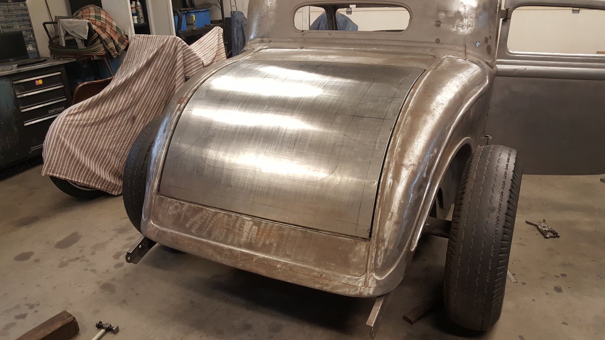

    Step 647:
    Cut out a giant piece of 20 gauge. Invite your friend over to help you run that steel on the English wheel.
    It's important to not know what the hell you are doing here. It's more interesting that way.
    Spend 3 or 4 hours sweating and cursing. Weep softly because your shoulder hurts and you are a pansy. Try to not show your friend you are crying. Fail.
    Accept that you aren't very good with the English wheel. Who cares if it's tiger striped and a bit lumpy? It'll putty out.

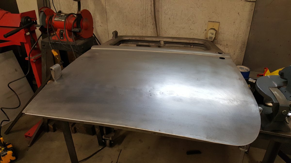

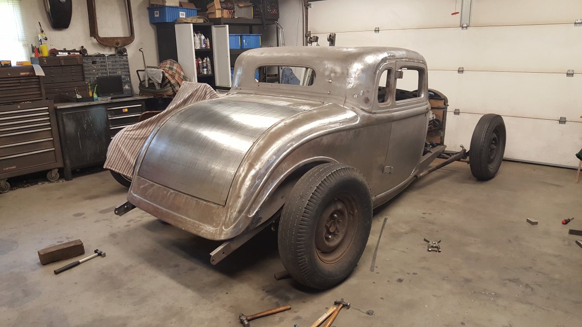

    Step 649:
    Get a running start and throw that mofo on the car.
    Be careful. The decklid now weighs approximately 3 metric tons (tonnes?) now, so try to not get a hernia. The 18 gauge steel may have been a bit of overkill.
    Marvel at your luck that the stupid thing actually fits. It may be lumpy and has more tracks on the skin than Miles Davis' arms, but the gaps look good.
    Celebrate and don't accomplish anything else for a while.

    It only took me 7 years to make that decklid. I'm really hitting my stride now. Within the next 400 years or so, I'll have my metalworking skills at a nearly "acceptable" level. Fingers crossed!
  24. raymay
    Joined: Mar 2, 2008
    Posts: 2,599
    raymay

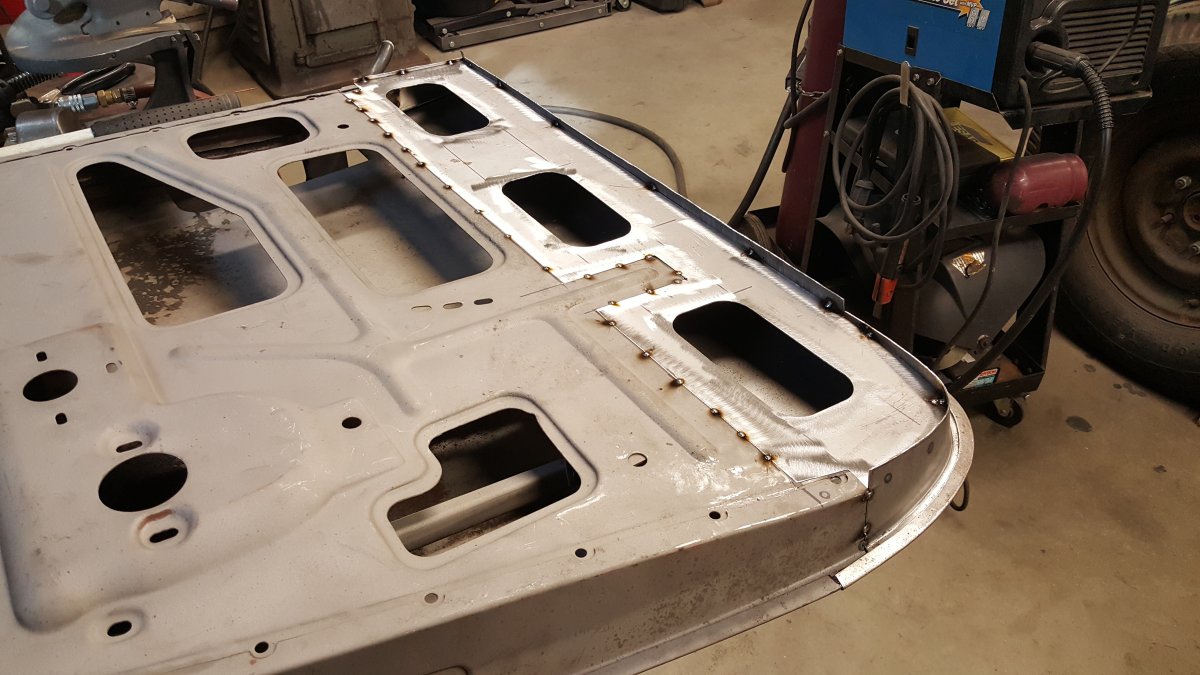

    The decklid looks great. Original ones had a series of holes on the inners skin. Maybe if you cut some similar size holes in yours it might lighten it up a little.

    I thought about holes to lighten it, and thought about dimple dies, but basically I just wanted to get the whole thing over with. I'm covering it with a panel eventually anyway. I'll just hit the gym so I can handle the weight.
    Nope. I didn't want any chance for water to get in the trunk, and this panel is definitely not nice enough to louver anyway. It's gonna require a skim of bondo to be kinda close to right.
    I can't say I'm super duper proud of the decklid, if I'm honest, but I'm happy to have it done. I figured I'd at least show that even a ***** like me can make something that'll work if you hit enough things with hammers and use some cheesy Harbor Freight tools. I guess that sums up the whole build, really. Haha.
