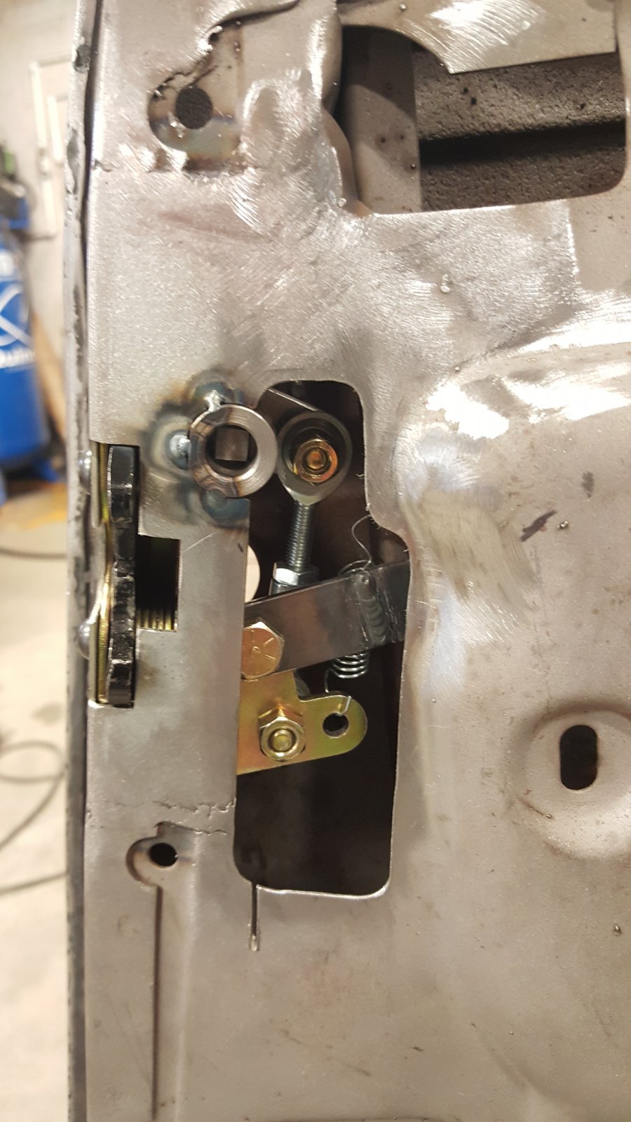

    Work on external door handle Rube Goldberg linkage. Bear claw latches were never meant to be used with a door handle, if you ever wondered. Maybe just shave your handles next time.

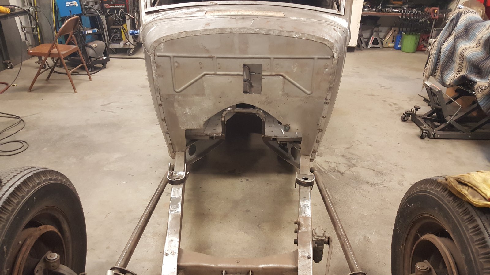

    Step 847
    That's a real nice engine mount, firewall, and transmission tunnel you got there. It'd be a real shame if someone.....hacked it up...

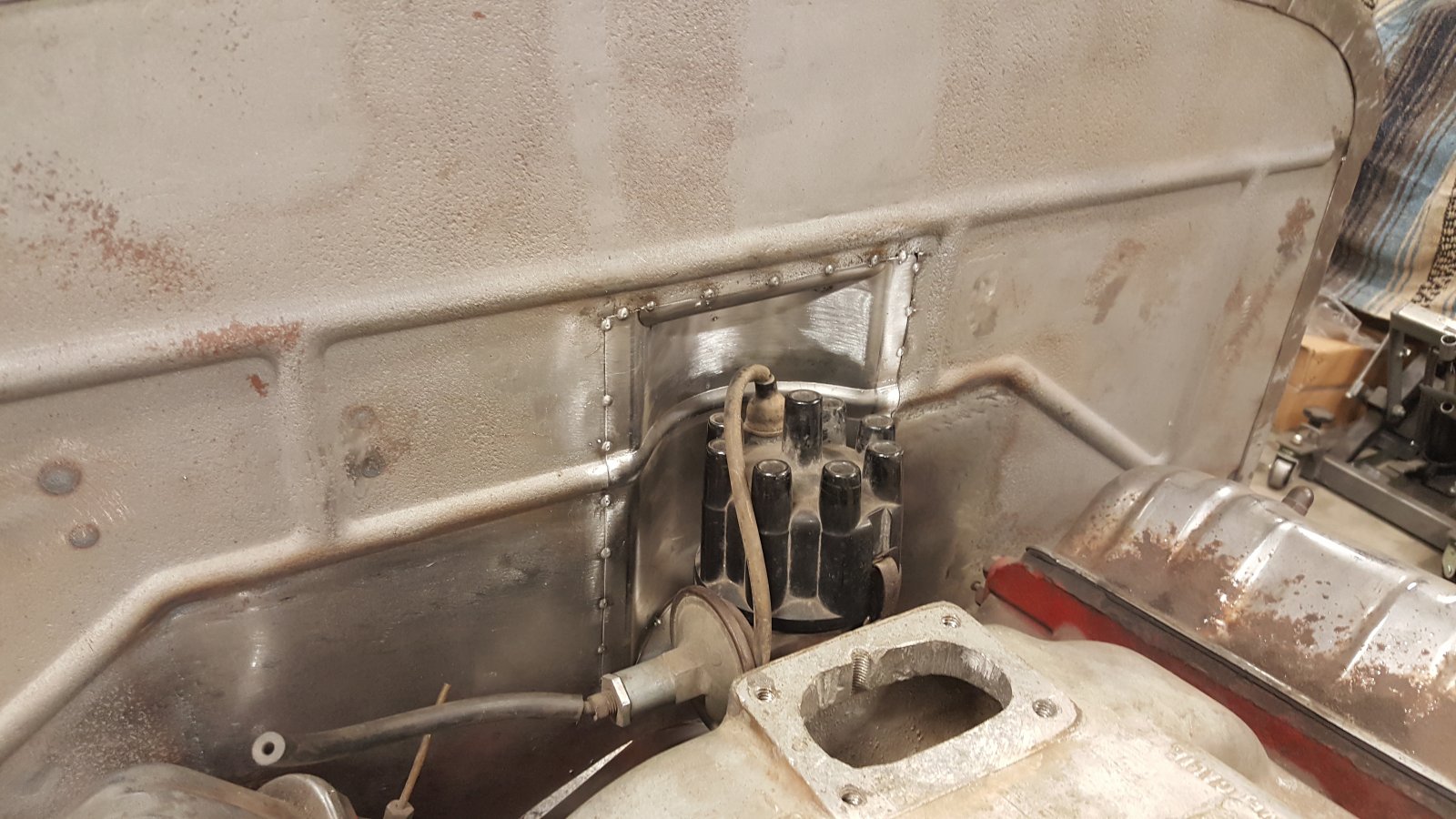

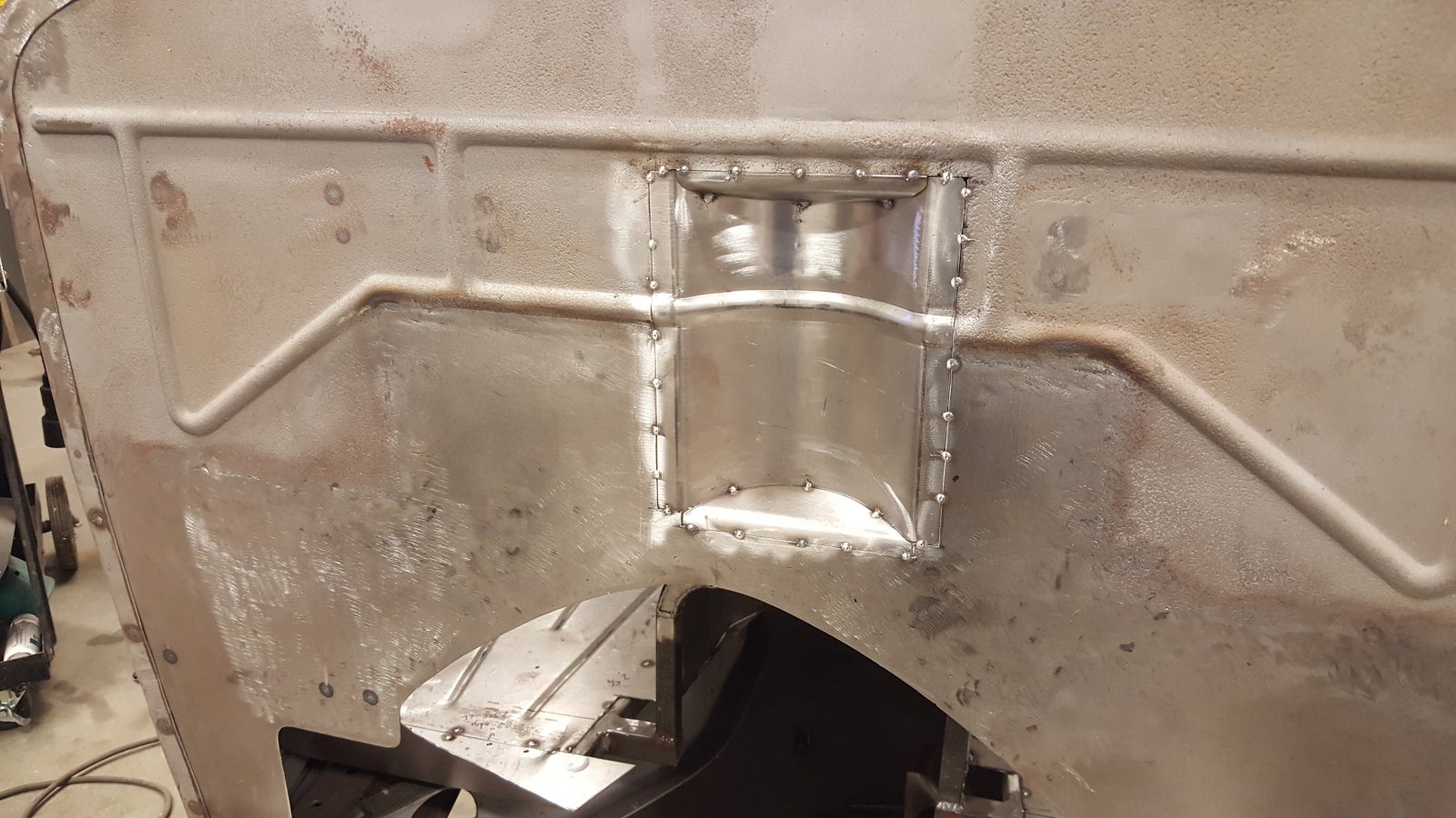

    Step 852
    That whole cutting the motor mounts thing? Hacking a big stupid hole in the firewall? You know why? The engine was out far enough that I could see the ****** adapter. Bugged the **** out of me forever. You could practically fit a Kia between the head and the firewall.
    It needed to be moved back 1.25 inches. It *had* to be done. The ****** plate just sat there and mocked me, I had to hide it behind the firewall, even if it took a few days of work to make it happen.

    Step 857
    See? Isn't that better? Satisfying. All is right with the world.

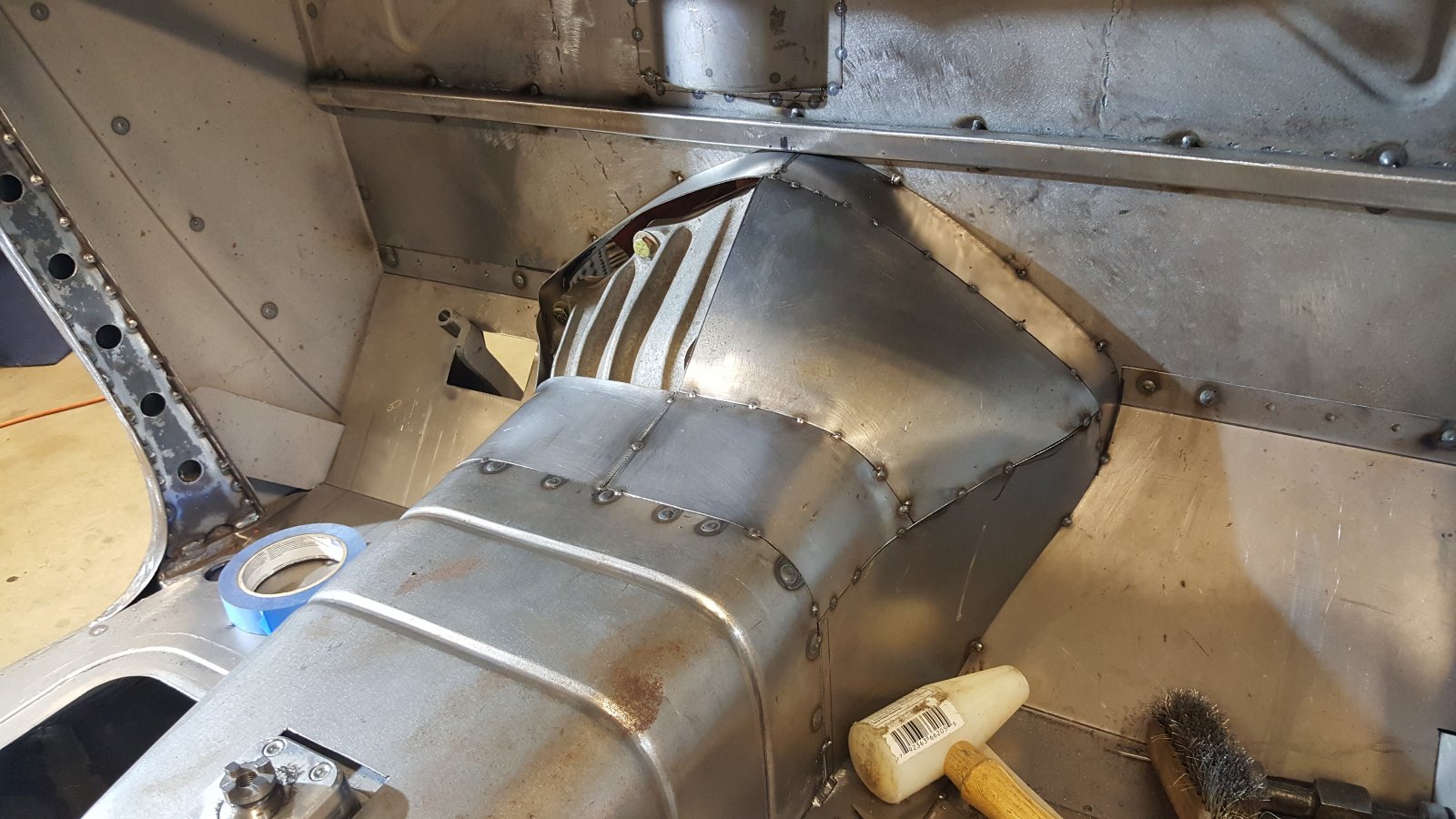

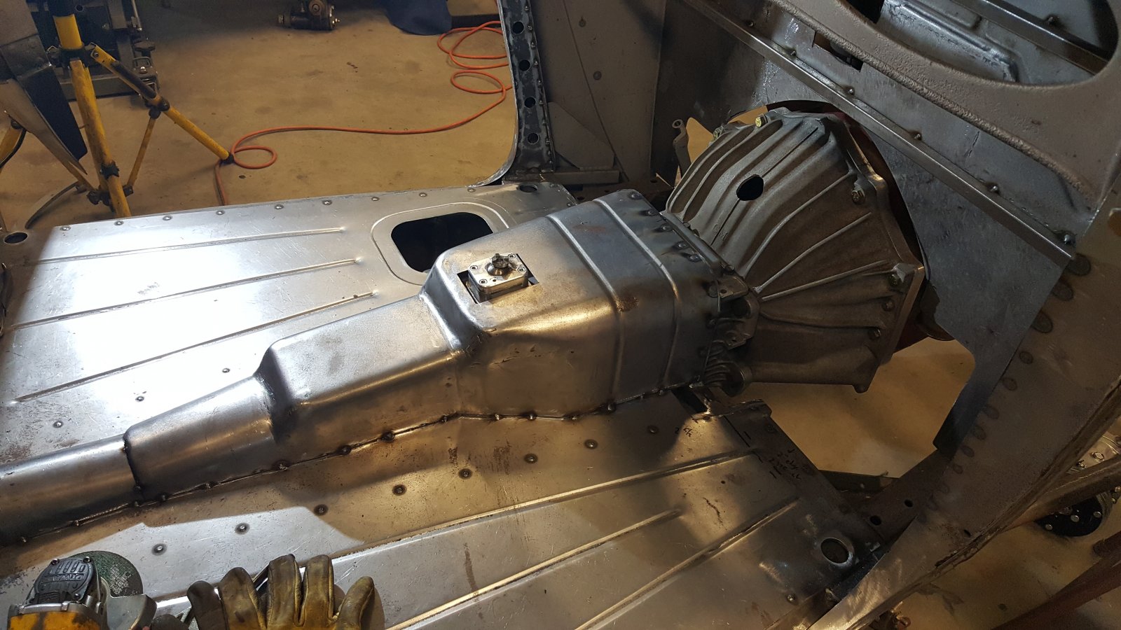

    Step 899
    Finally finish up the ****** tunnel and front of the floor. What little curve there is in the panels was just made by smacking the piece with a plastic mallet, no English wheeling.
    Filling that giant chasm of despair was a big step. It feels like a car now. I'll have to seal up the sides of the toe boards later when the body is off the frame.
    I'm still not really sure where I'm gonna put my feet. That stupid TKO600 is super duper wide, and it's all in the cab because I didn't want the oil pan hanging down too much. I'll figure it out eventually, I guess. Or buy a '34 sedan instead. We'll see.
