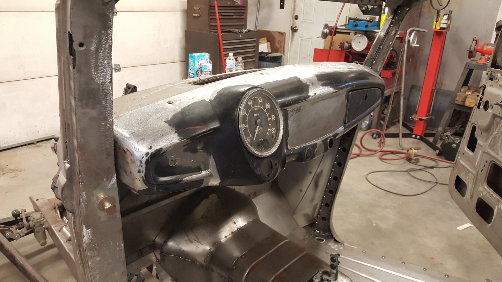

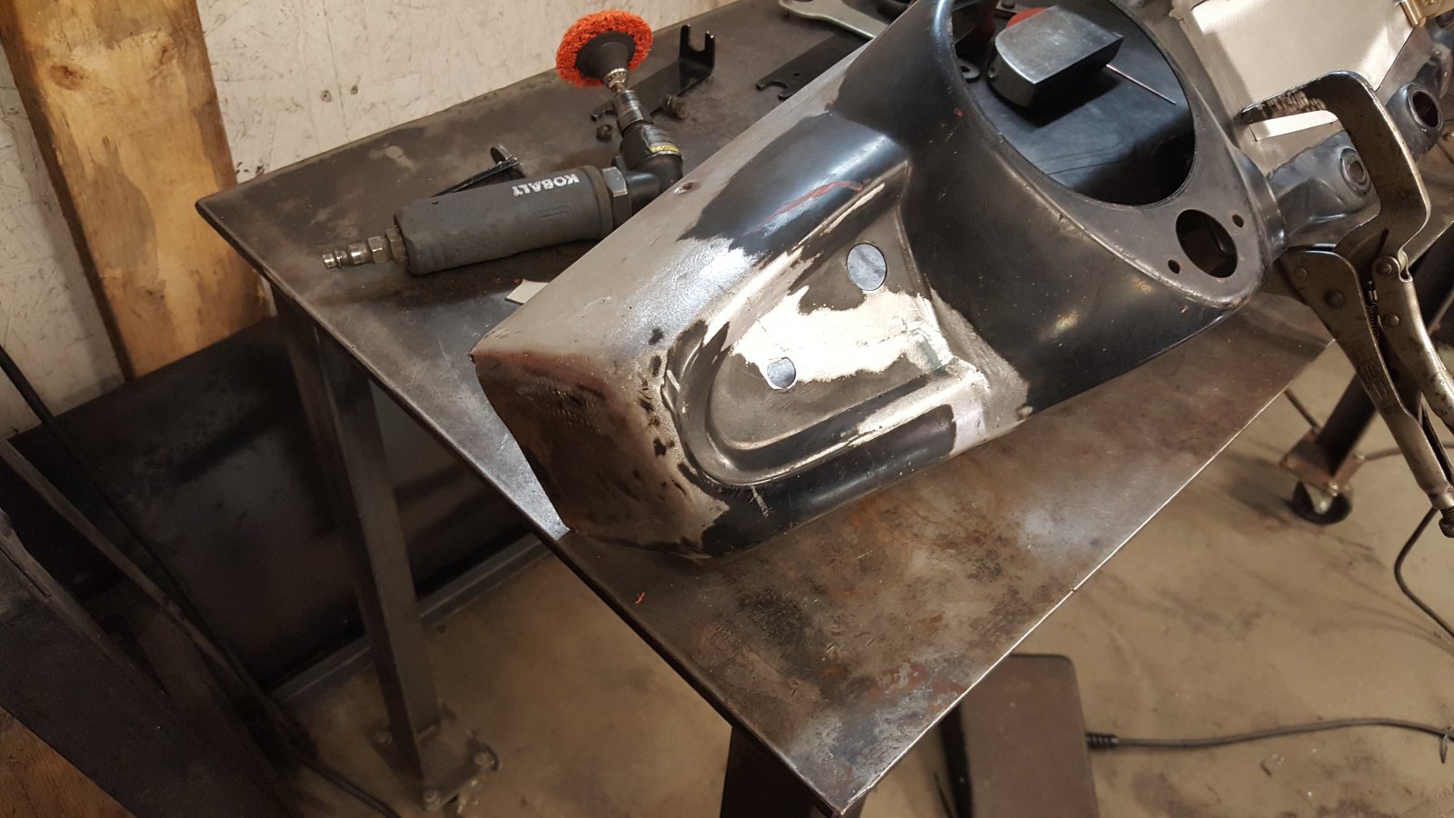

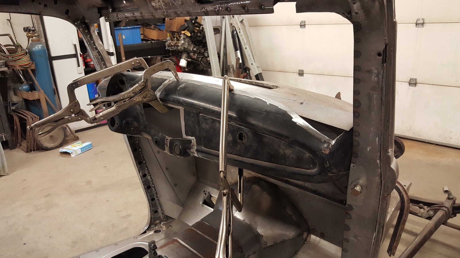

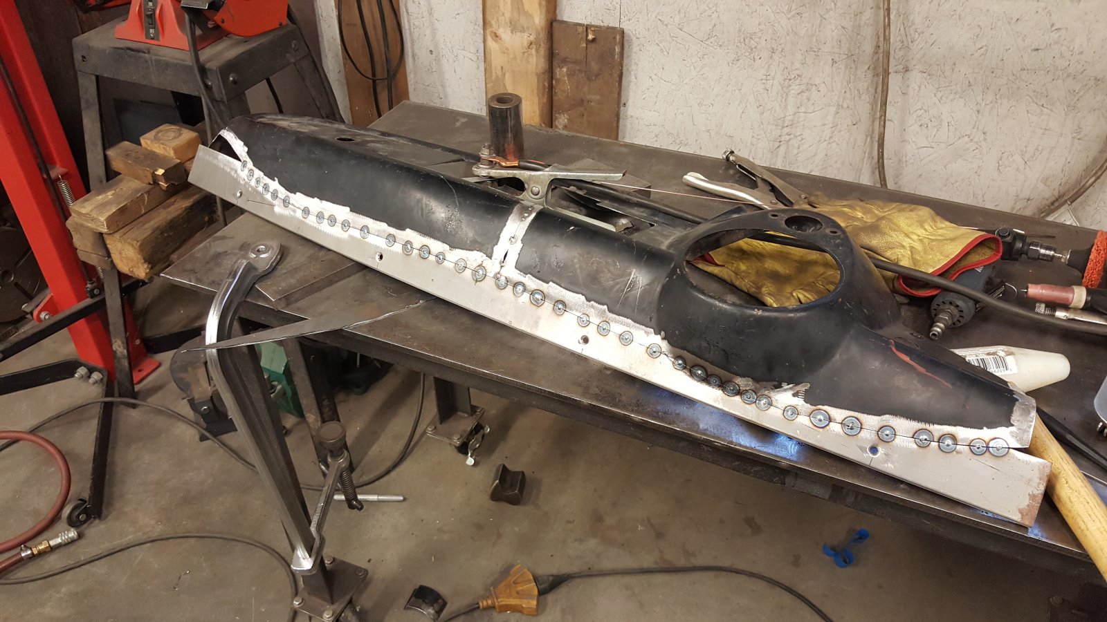

    Step 990:
    Now that the T-birds are out of the way, time to finish up the dash.
    Take 4" out of the center and a couplefew inches out of the left side to center the speedo with the driver position. Smash the end pieces with a hammer a bunch of times till it looks kinda ok and fits.

    Check the location of the window crank with the door closed. Worked on a Model a with a 54 Ford dash. The crank handle only worked with the door open. It worked out that when the widow was up all the way and when down all the way didn`t interfere with the dash.

    That's a good point, I hadn't actually thought to check that. I think it's good though, I don't have the correct handle around but the other handle clears ok.

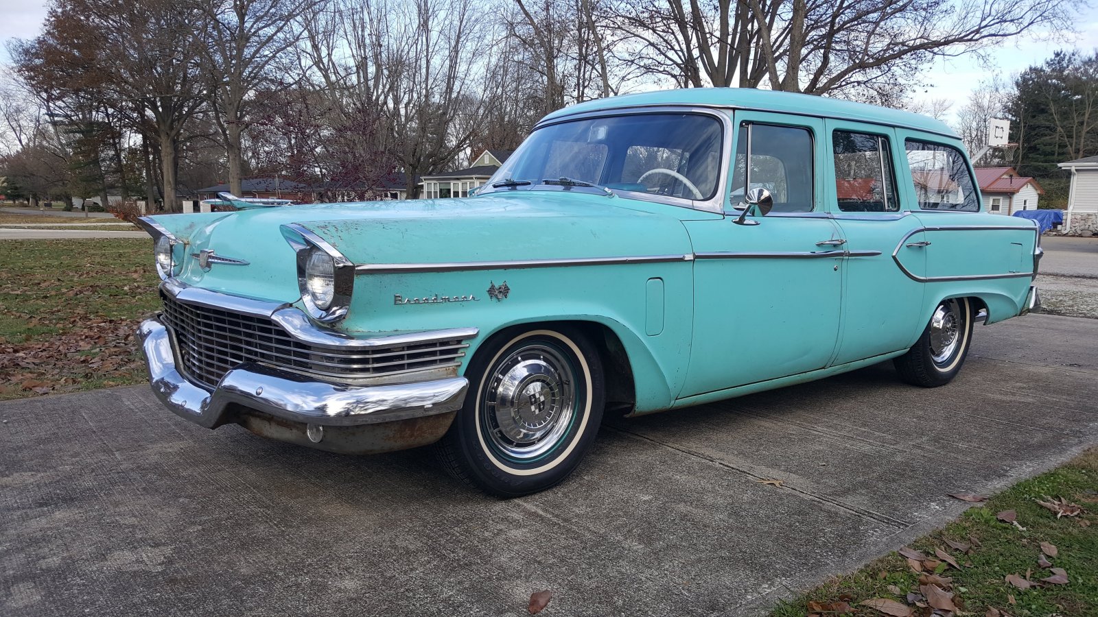

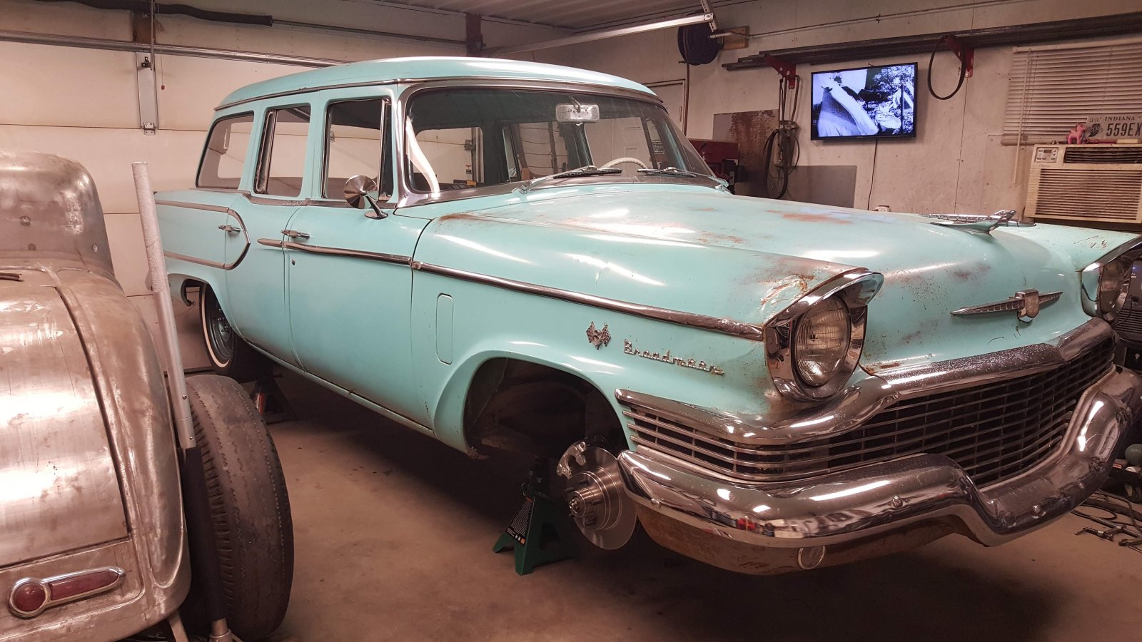

    My old wagon, I finally bought it back after 7 or 8 years of searching.

    The important information is that I have another distraction to prevent any progress on the coupe. Which is how it should be.
