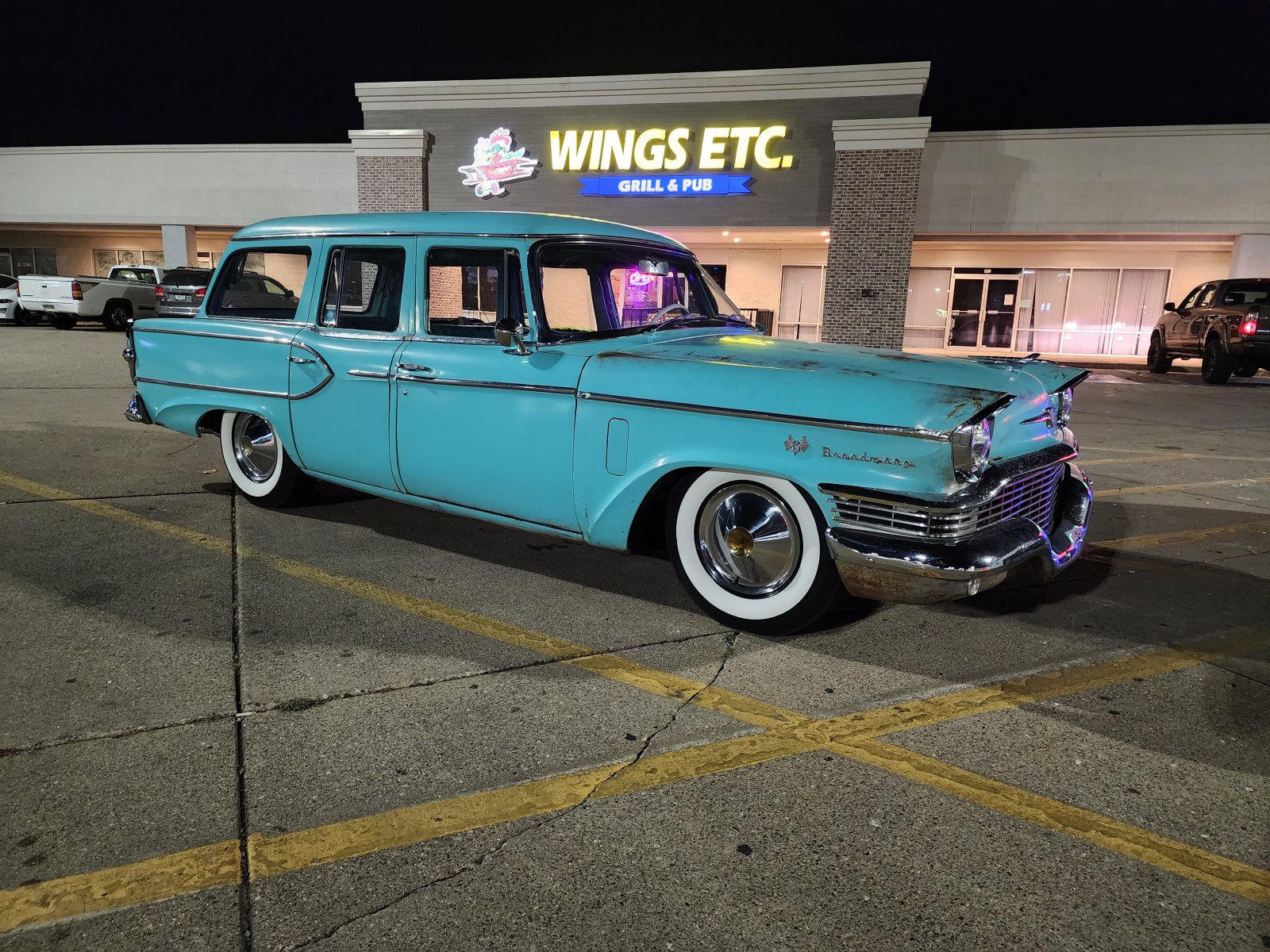

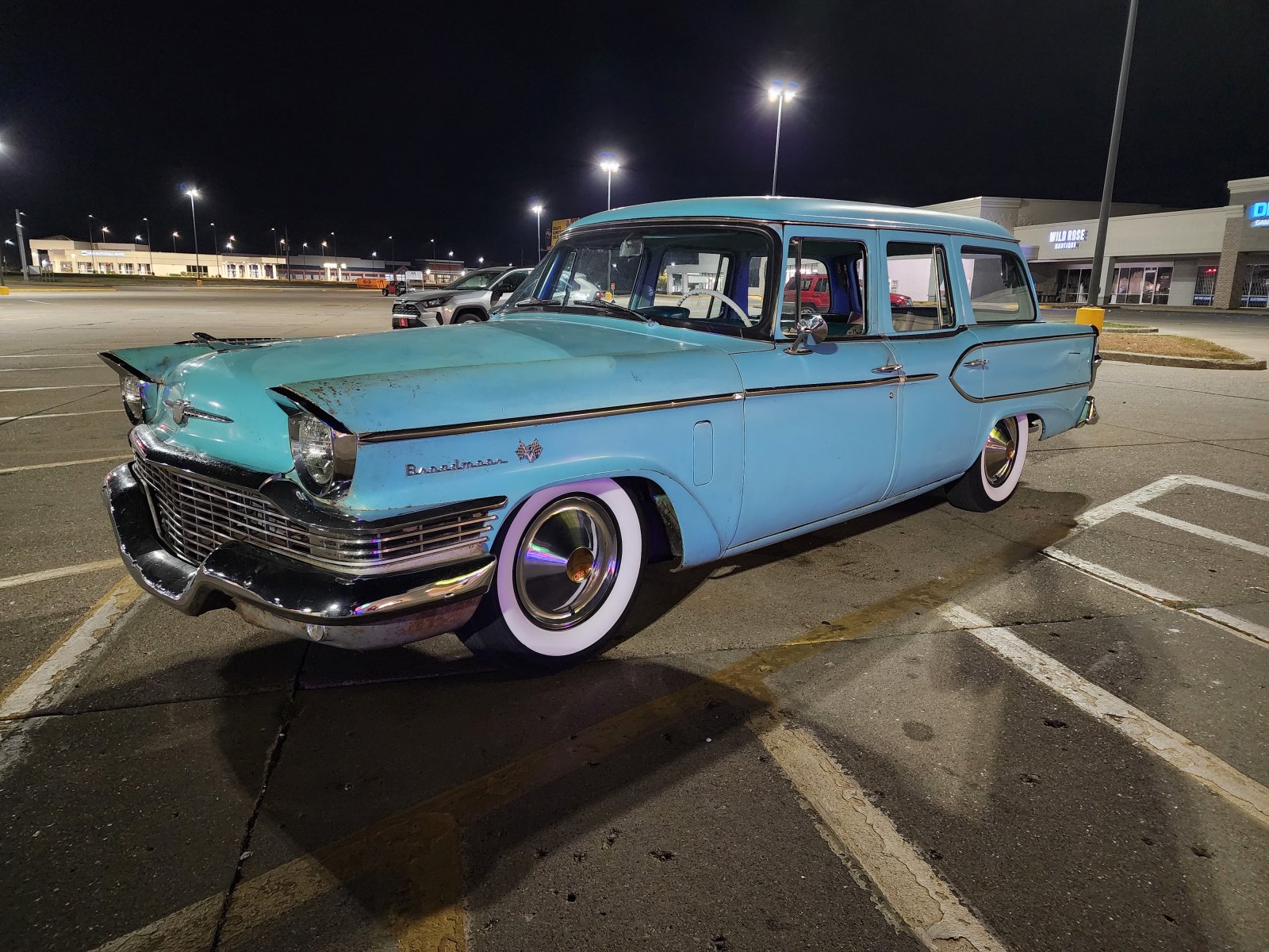

    I literally just learned that the Stude meet was going on about 2 hours ago. I'm planning on going to Davenport for Torquefest the week before it, I don't think I'll have the time to do both shows. I'd love to at least hit the swap meet, but it's not looking good.
    Stogy likes this.
  3. Squablow
    Joined: Apr 26, 2005
    Posts: 18,526
    Squablow

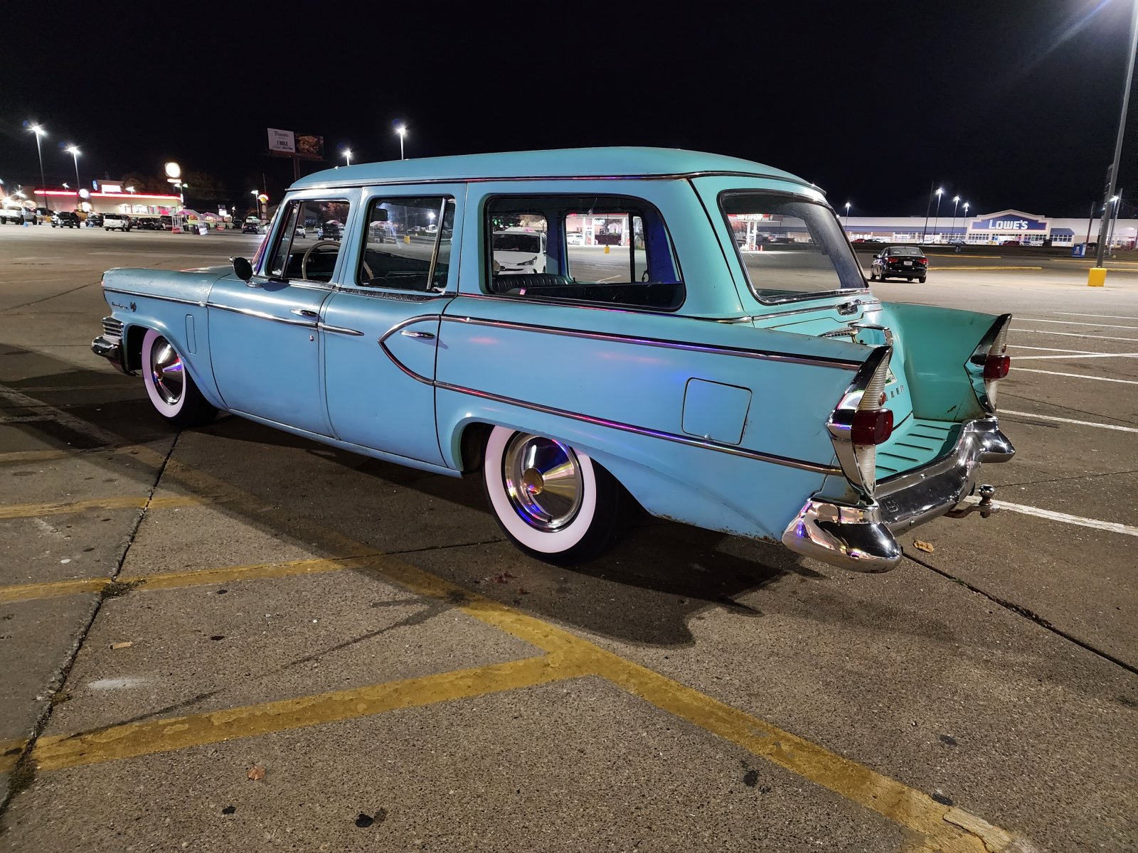

    I've never heard of a Studebaker Broadmoor before. And here I thought I knew everything. Neat old wagon, looks like a pretty well preserved original car.

  4. The "Sparklebaker" wagon...nice!

    The "Broadmoor" was the name for the President station wagon. The station wagon version version of the Commander was the "Provincial".

    Sorta! It's been so long since I've posted an actual update I'm not even sure where I left off.
    So, I did get the '57 Stude wrapped up enough to get it out of the garage. I installed front disc brakes, mounted a power brake setup on the firewall (stock is under the floor), got a Vintage Air unit mounted under the dash, and rewired the whole thing. I cut the springs and went through all kinds of pain and suffering to get proper wheels and tires to fit, and slapped on some '53 hubcaps. I'm happy with it for now, but I do need to finish the A/C install.

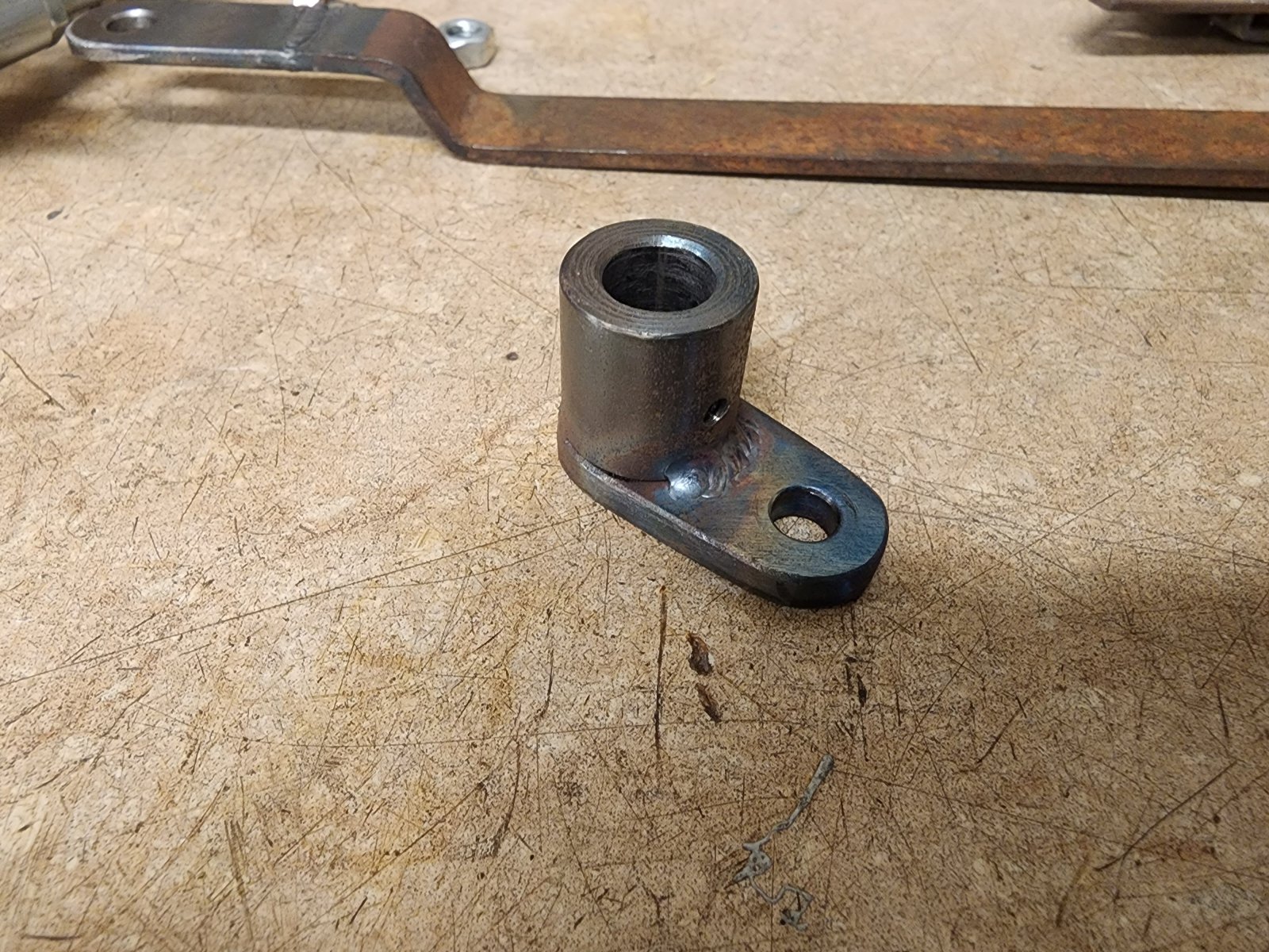

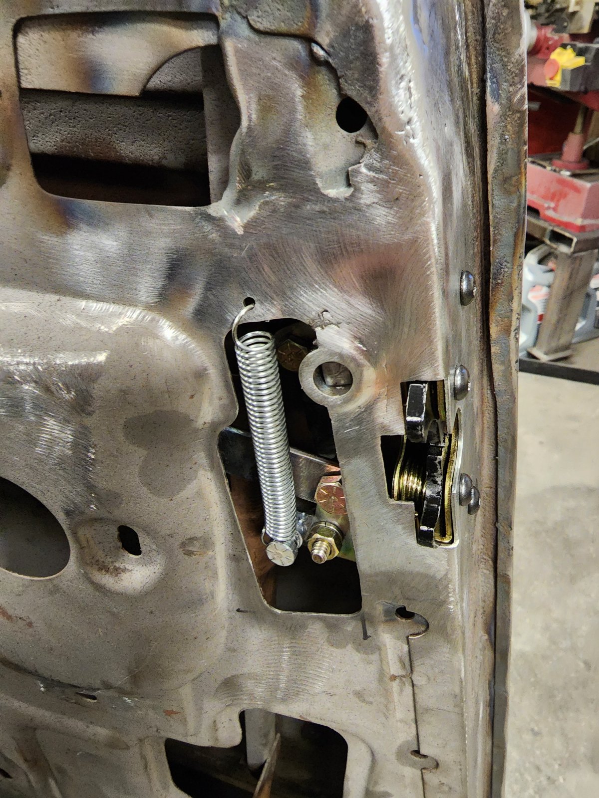

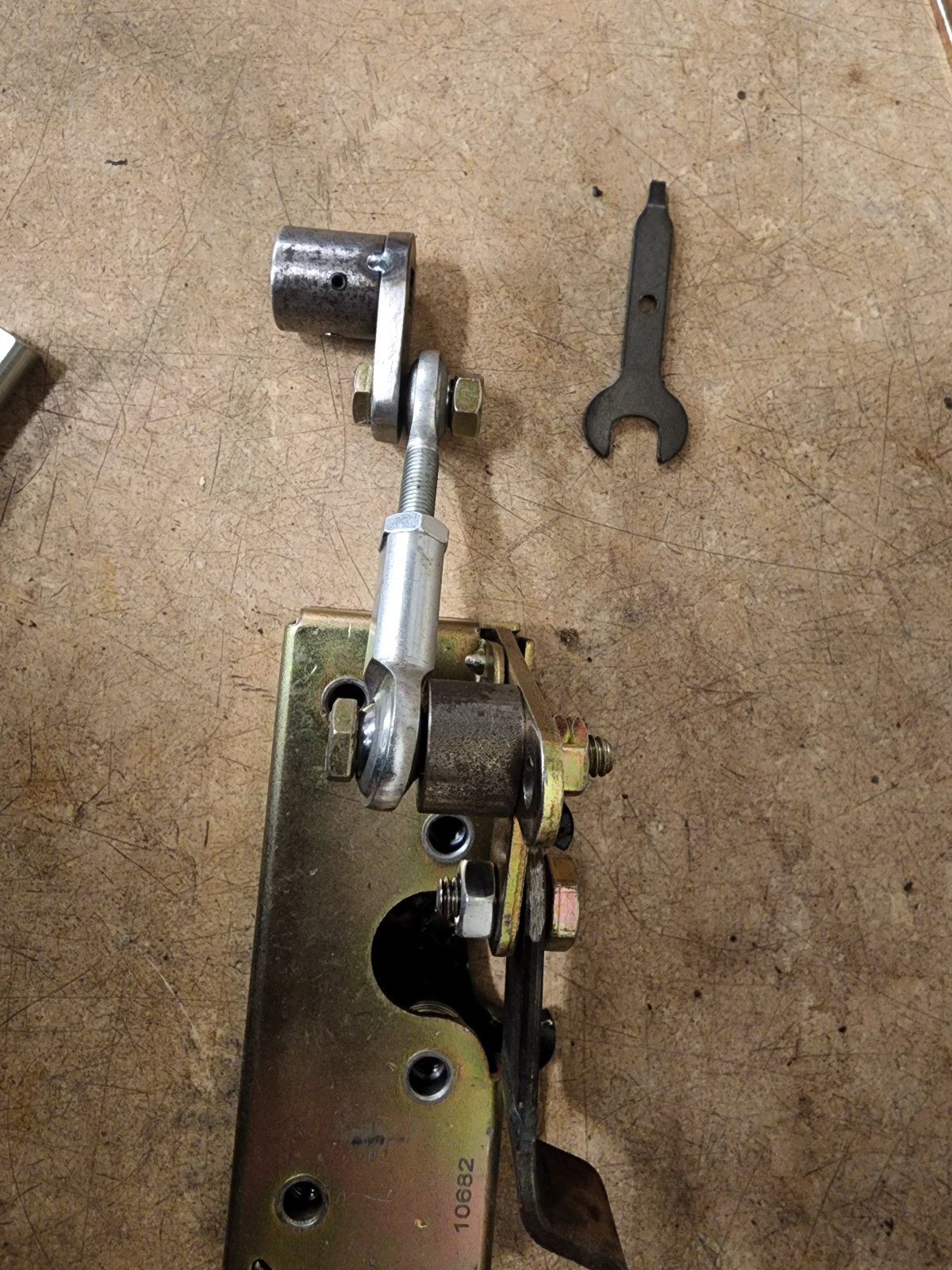

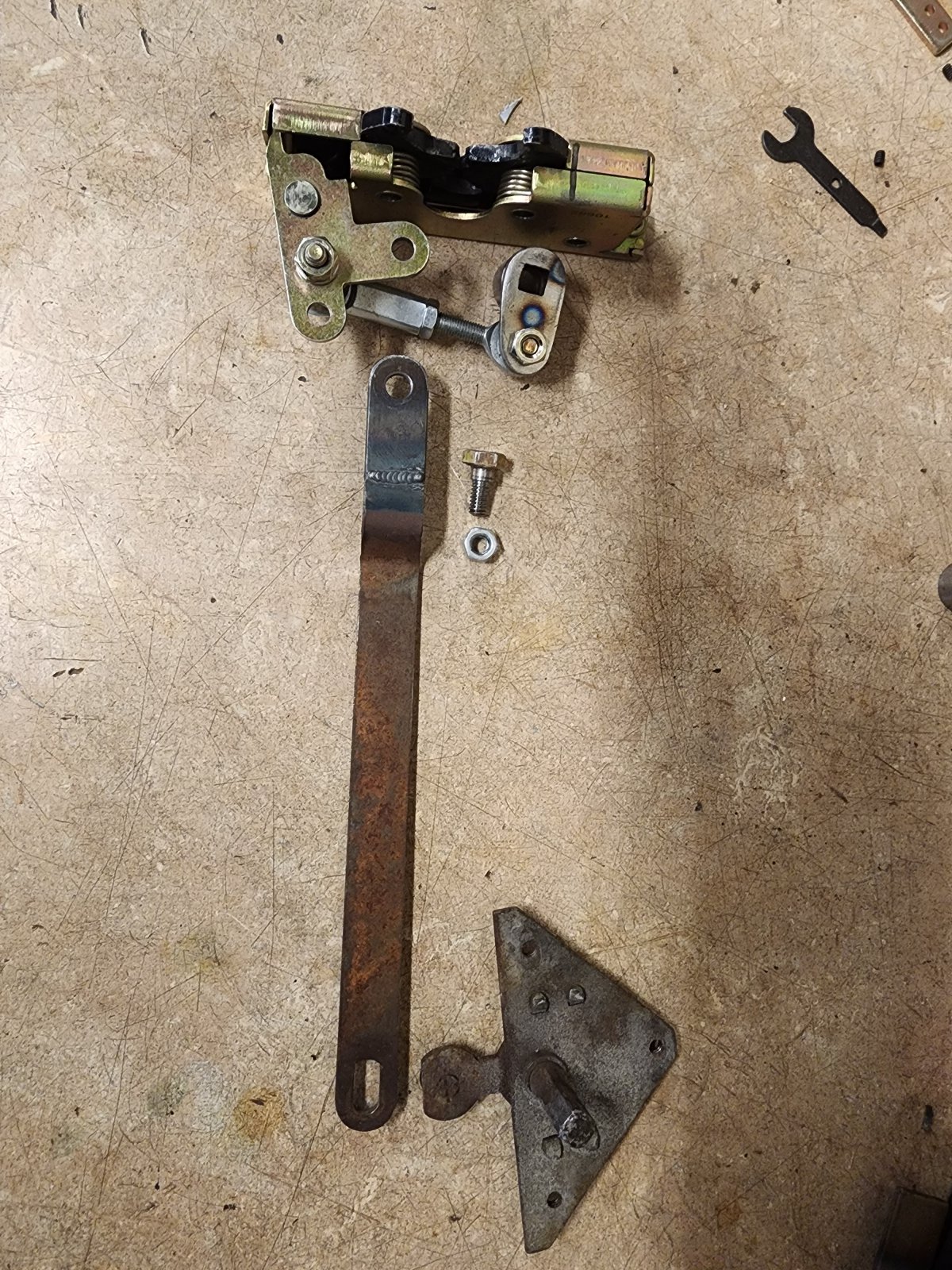

    Step 1,042:
    Get the driver's side door handle to actually work. Make a Rube Goldberg device to link everything together.
    I used repro '32 Ford door handles, so I had to weld up the old handle hole since it has different spacing.
    gonzo, Dedsoto, impala4speed and 8 others like this.

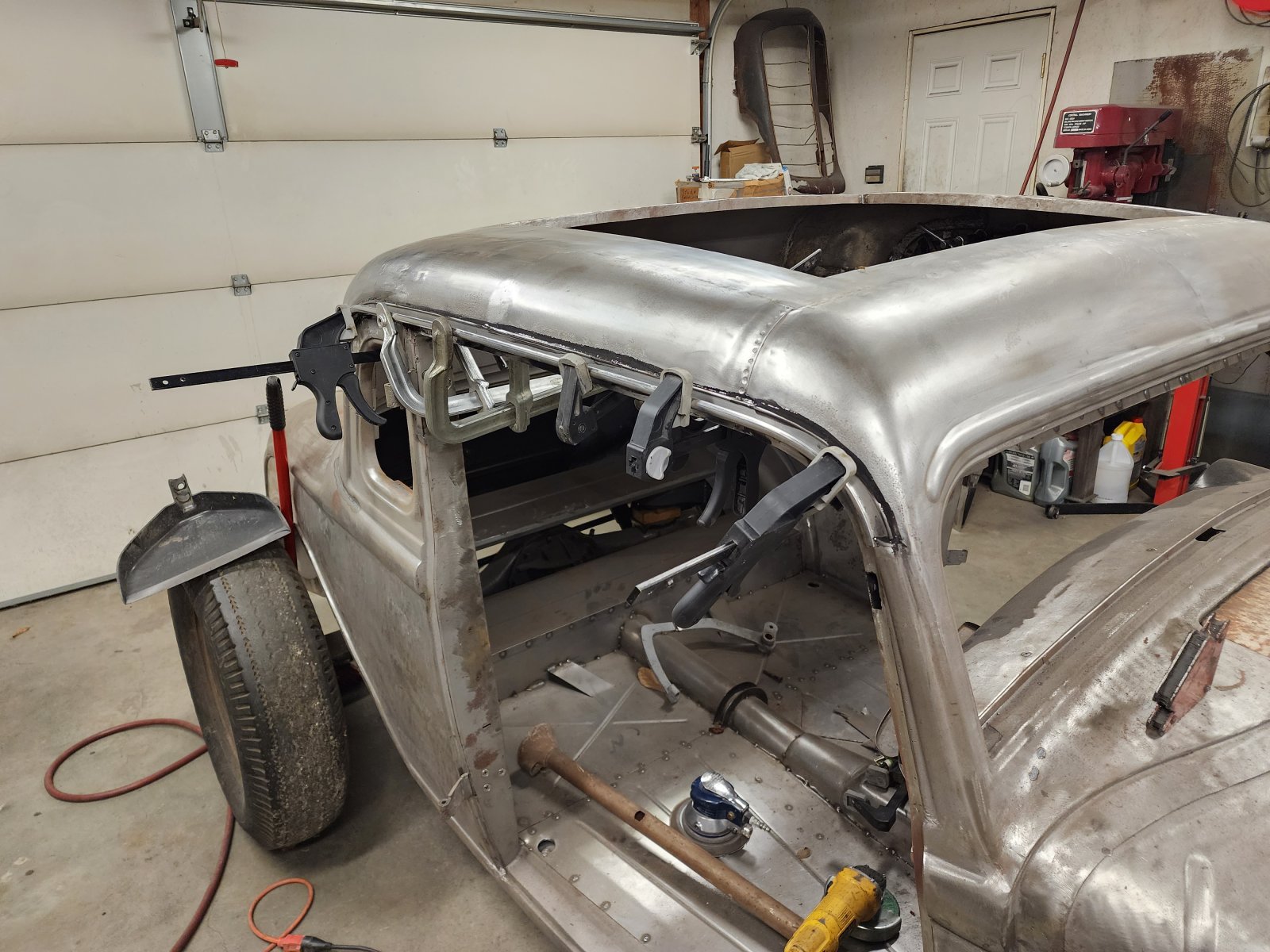

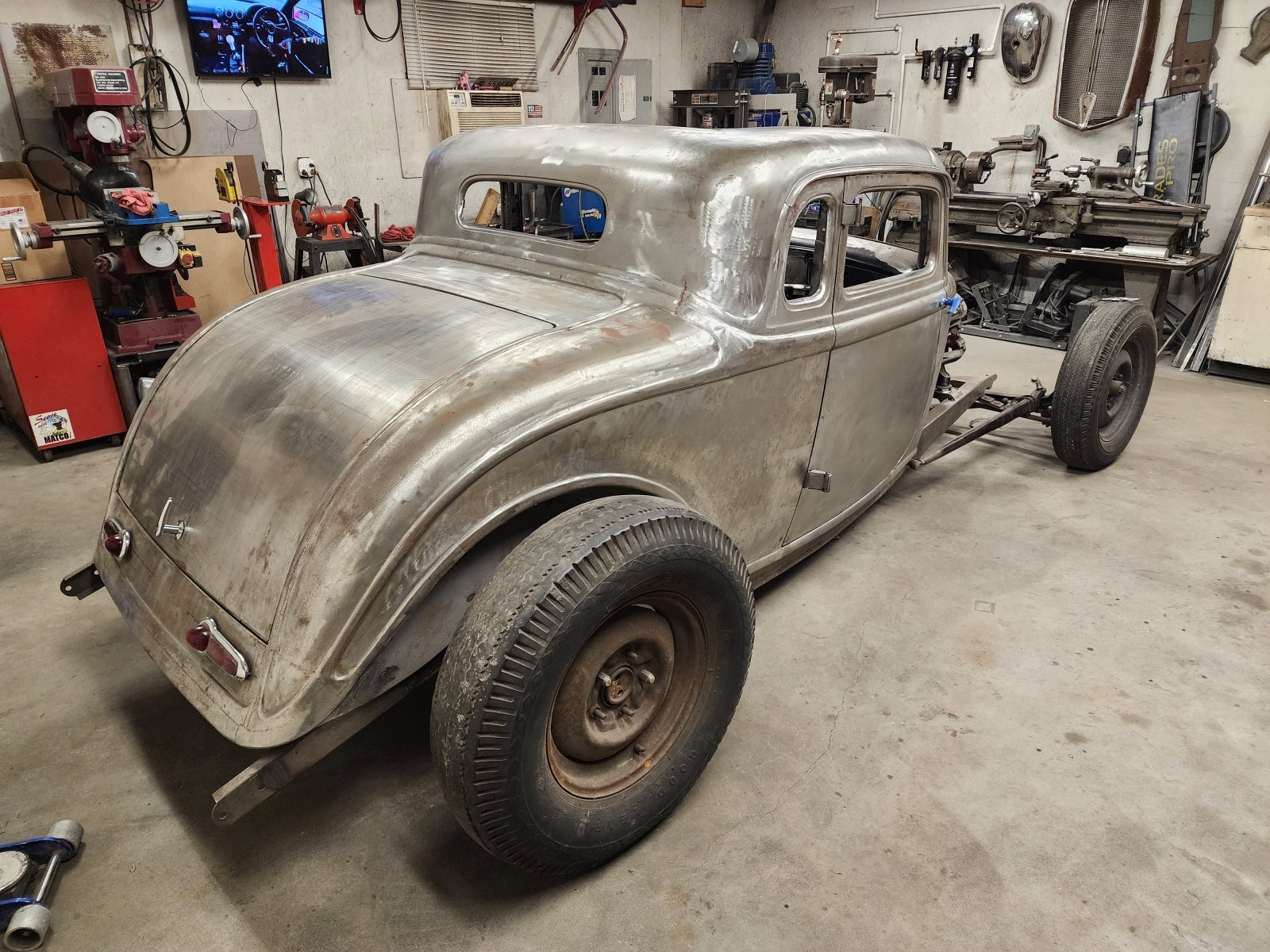

    Step 1043:

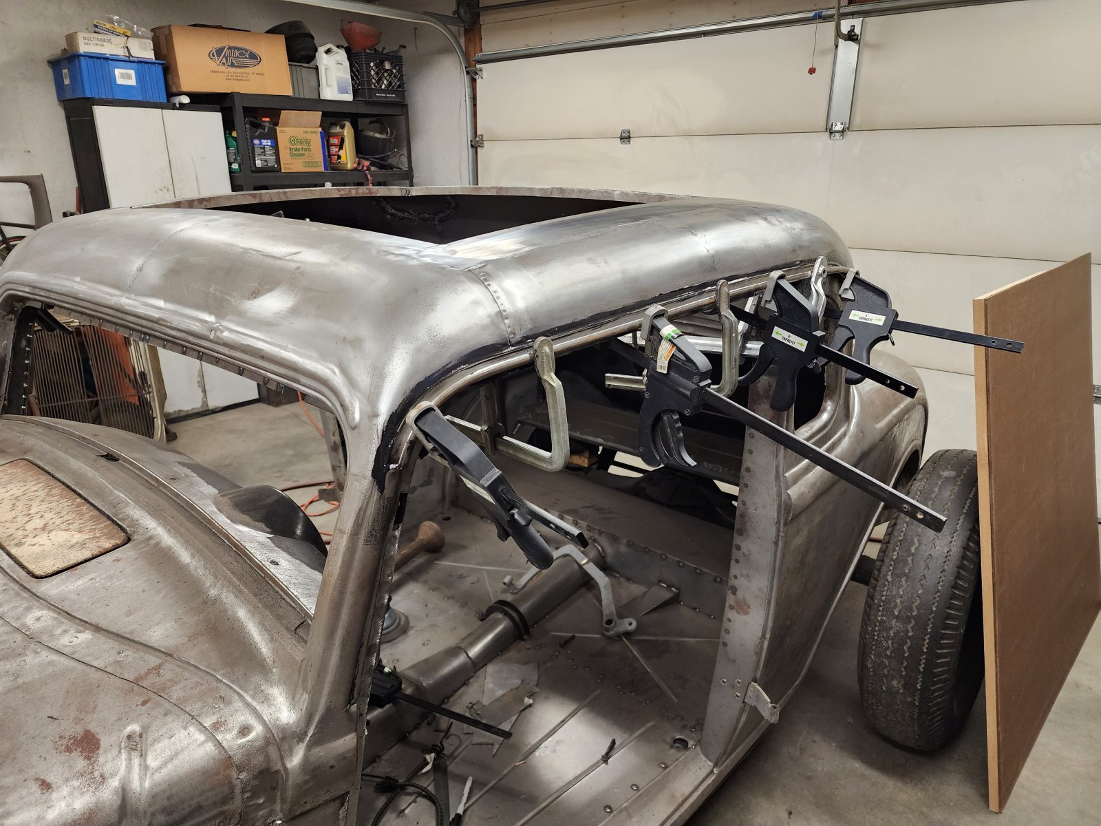

    Bend some repro '32 Ford drip rails. Spend a lot of time cursing your decisions and question your abilities. Those damn things do not like to be bent.
    Slather some Elmer's glue on there and clamp it on. Tasty tasty Elmer's glue...
    Toms Dogs, Okie Pete, brEad and 3 others like this.
  25. Johnny Sparkle
    Joined: Sep 20, 2003
    Posts: 1,226
    Johnny Sparkle

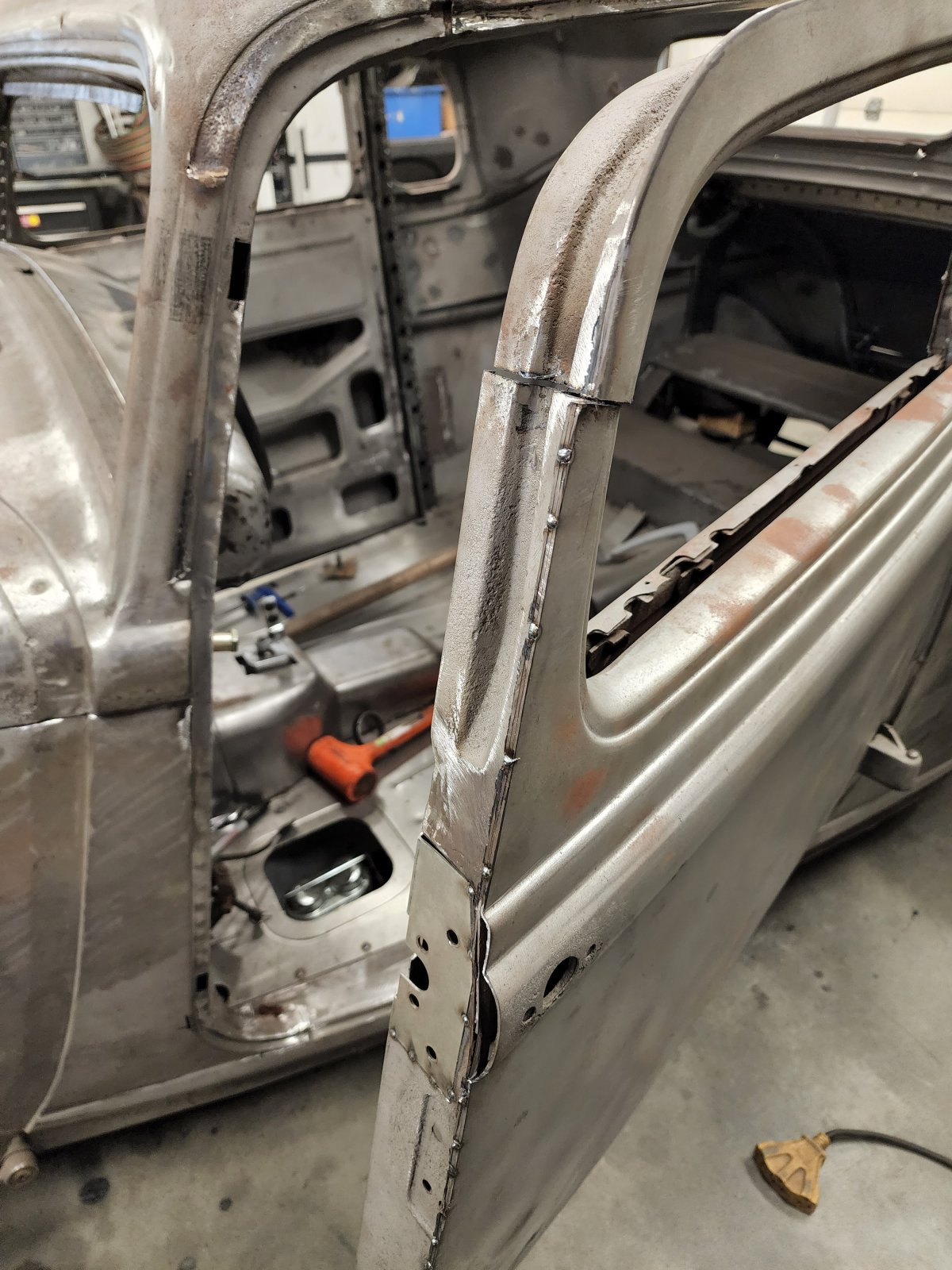

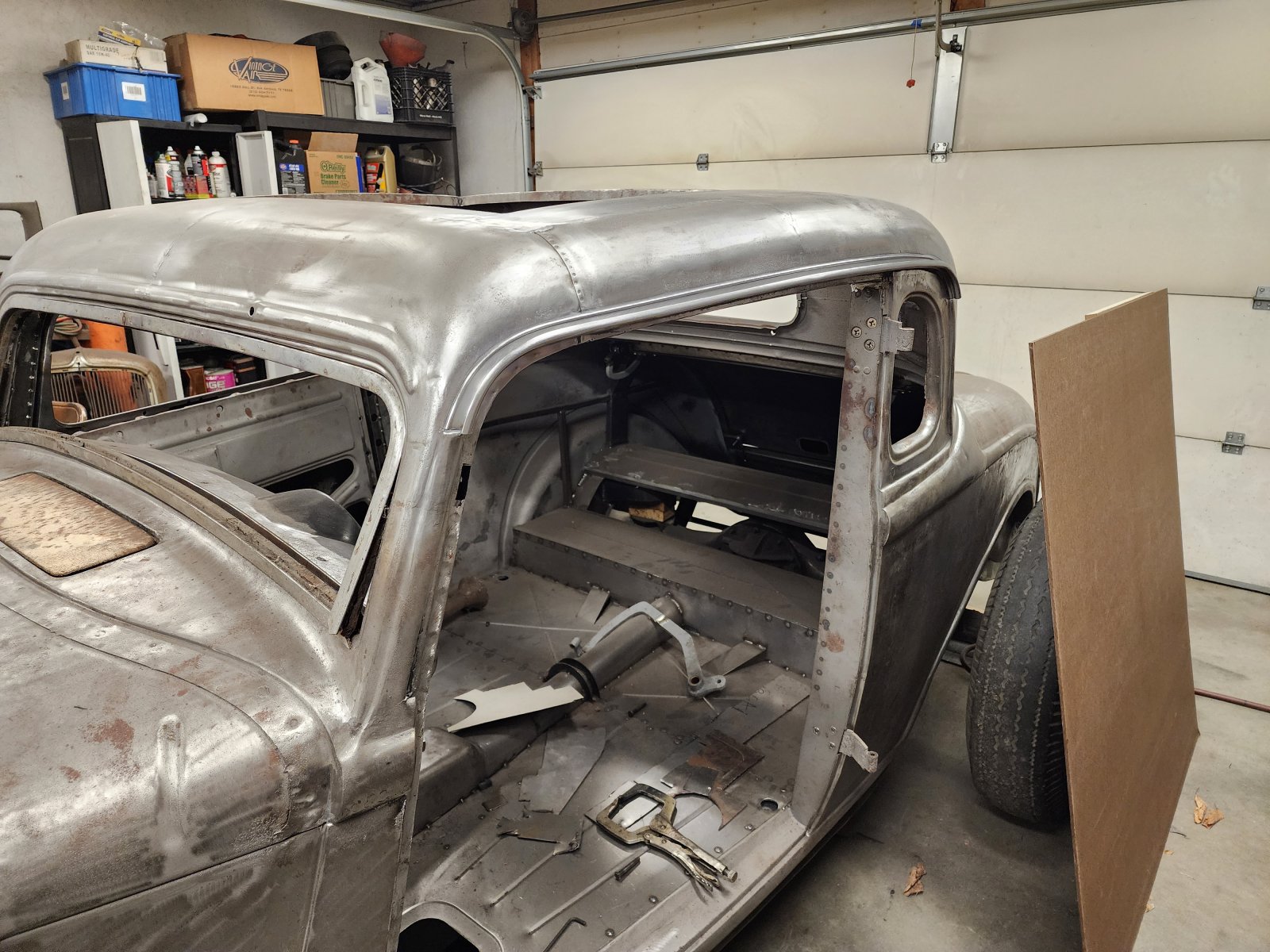

    Step 1044:

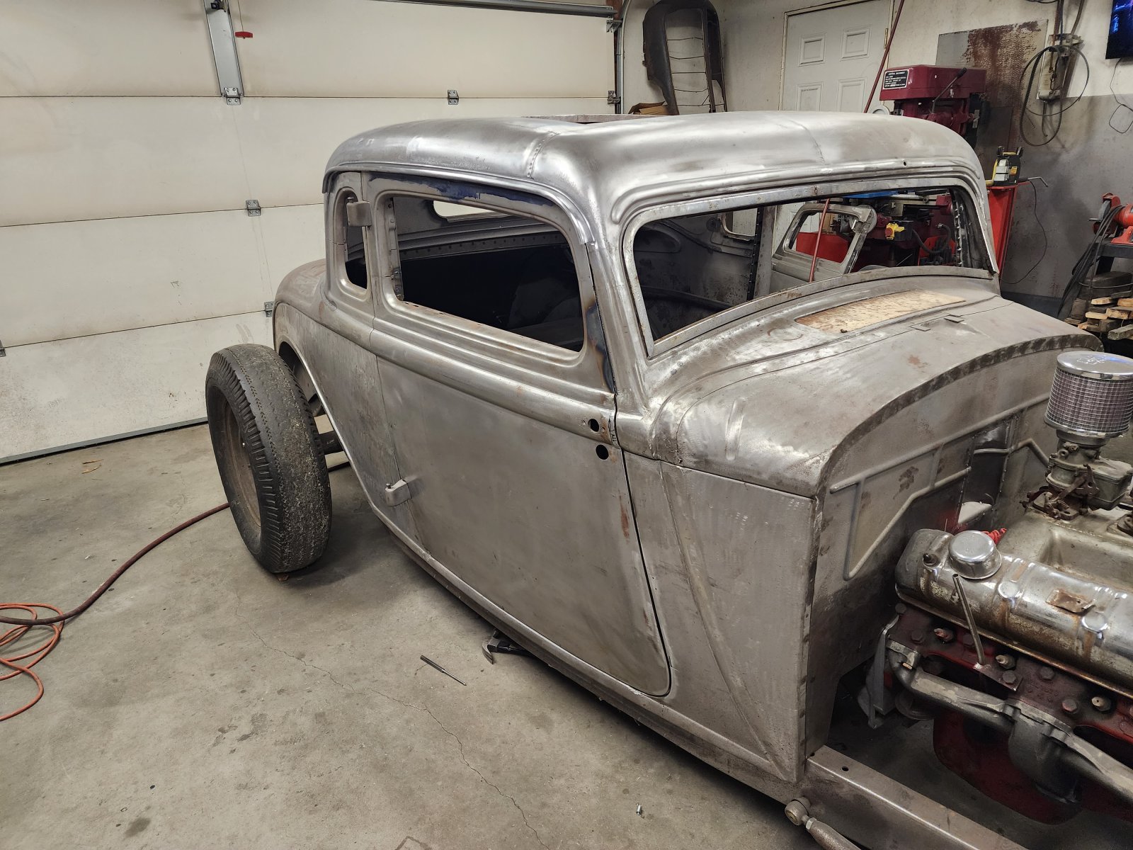

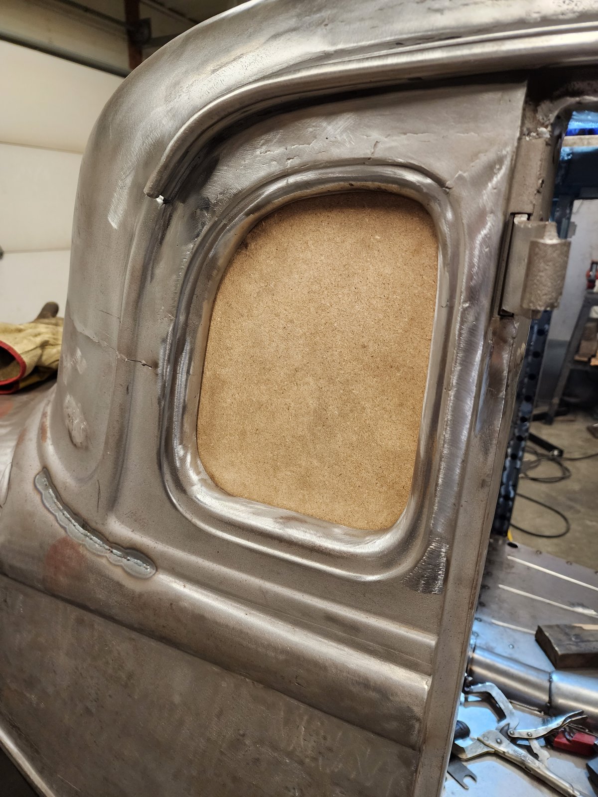

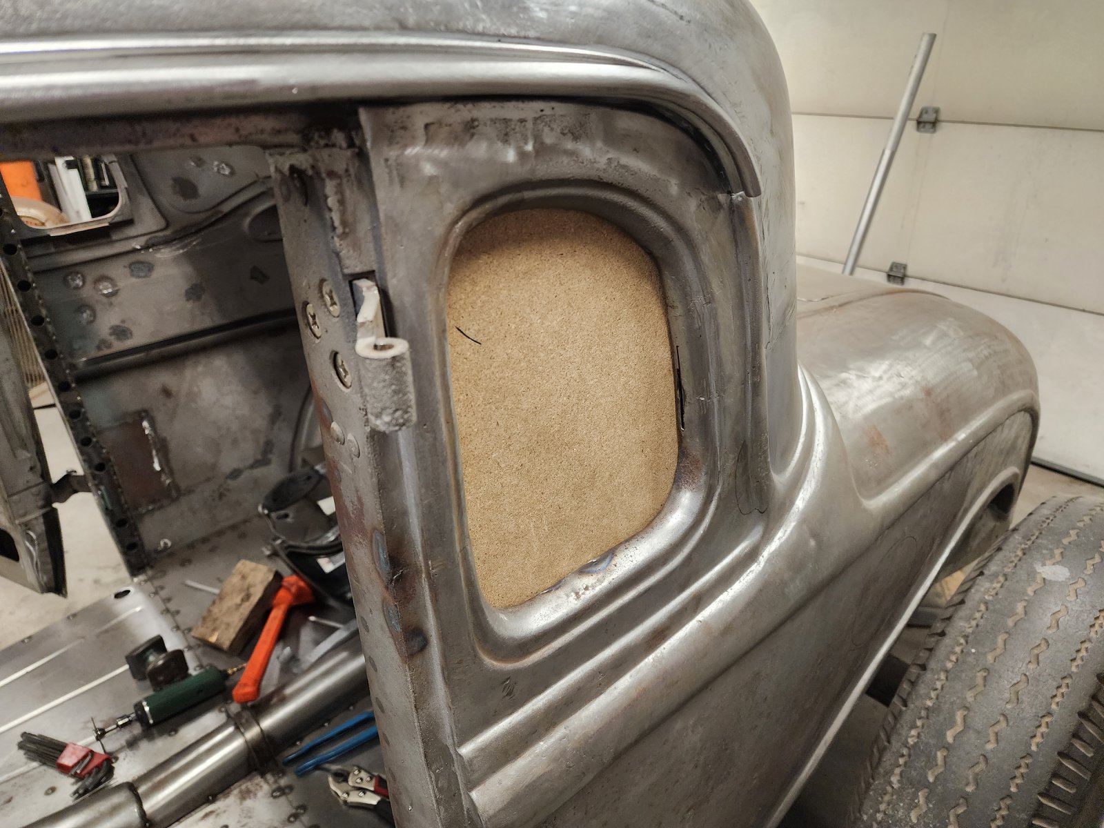

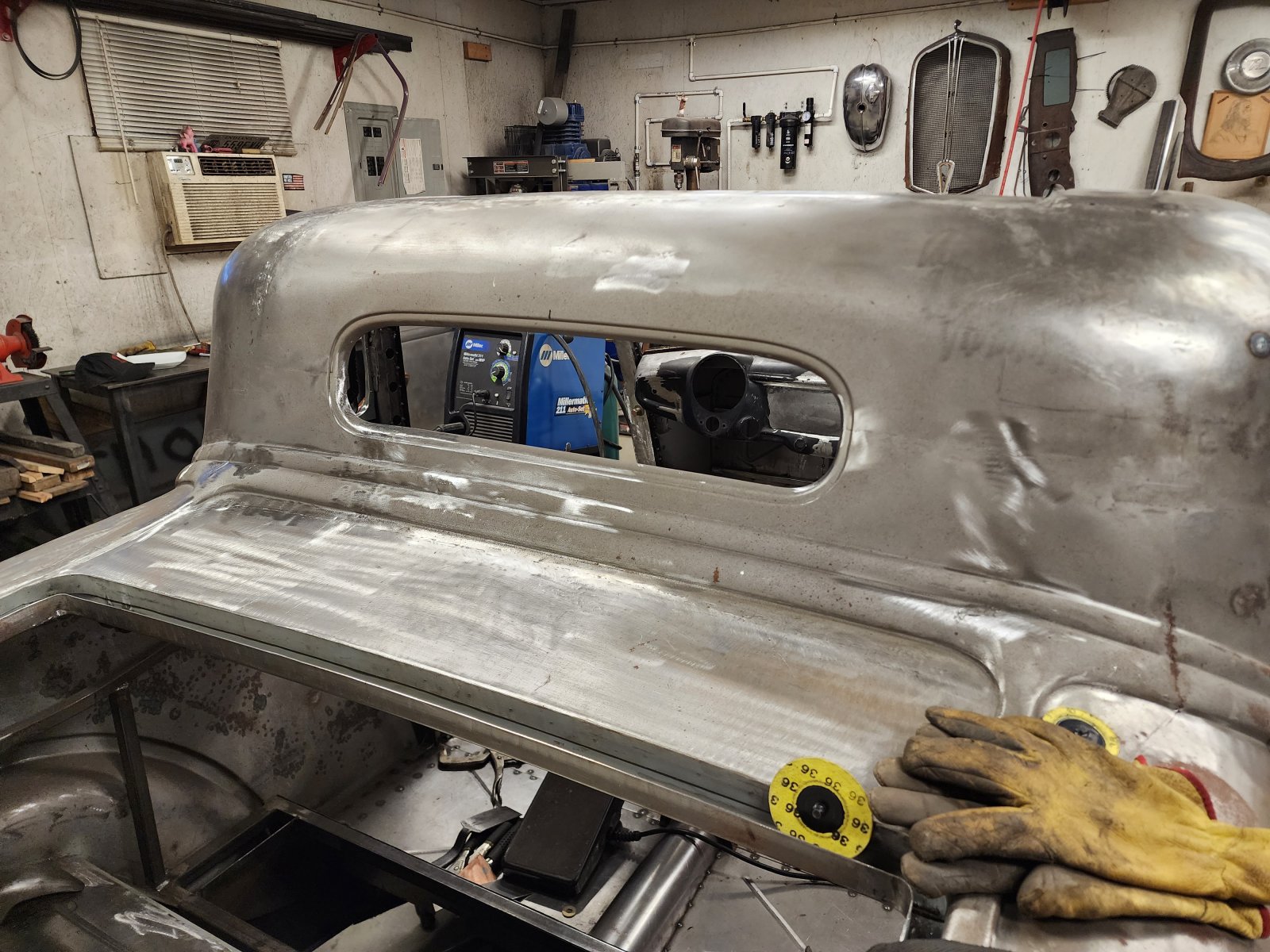

    Now that you have the drip rails on, you can finally finish the tops of the doors. I ended up cutting quite a bit off the top since they were doors from a sedan and welded the lip. I also did the same on the front and back of the doors to make the gaps right. Lots and lots of welding.
    Also, I finished up the quarter window and the area around the back window. Welded up the last 10 bullet holes in the car. So that's nice.
    Notice the piece of MDF, I used that to make sure the quarter gl*** will sit flat. I plan to do the same to the doors once I buy the window fuzzies. Doors are basically done now other than that.
    Toms Dogs, Okie Pete, Shitbox and 7 others like this.

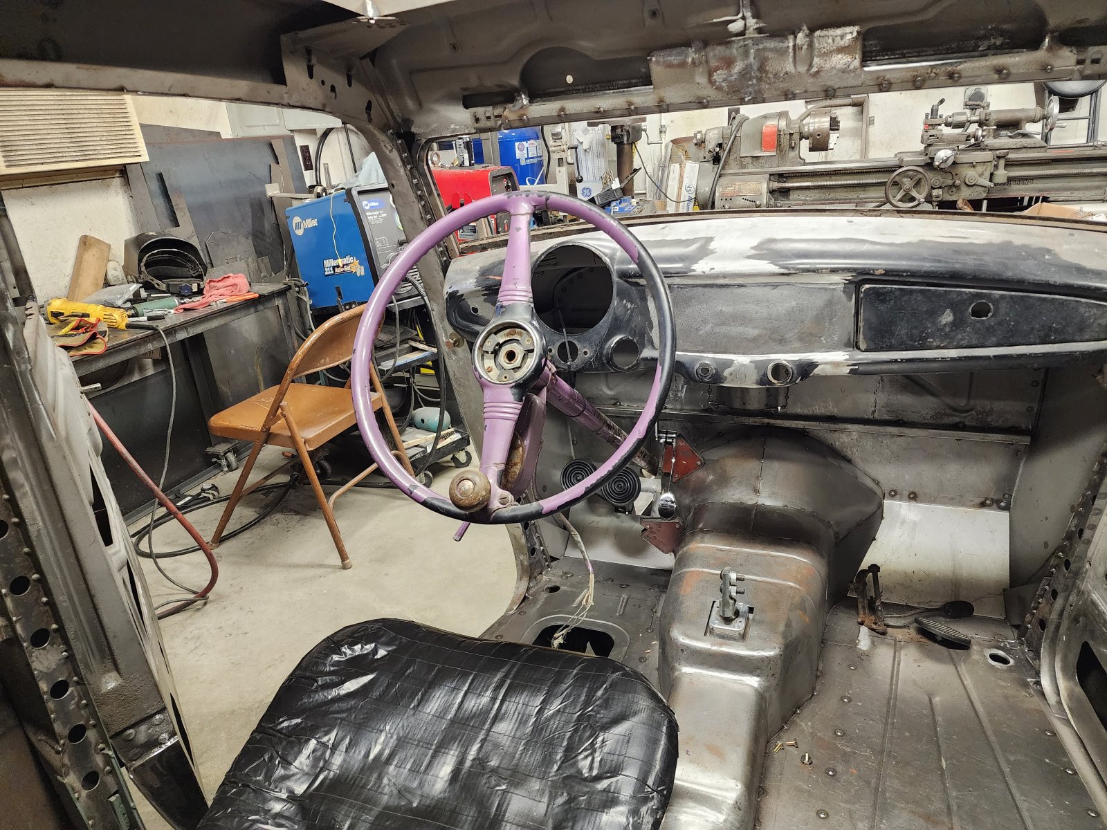

    Step 1045:
    Figure out where the driver's position is gonna be. The pedals are causing trouble, everything is too close. The seat is a cut down VW beetle, seems like it'll work nice.
    This is where I'm currently at.
    If anybody has some helpful rules of thumb or measurements for setting up driver position, I'm open to suggestions. I'm short and generally don't worry about it being tight, but I'd like to make sure you tall freaks can fit.

    I custom fit a Falcon to my wife. What I did was leave the pedals loose, the seat loose, and just gave her a steering wheel (no column) and had her hold it where she'd like it. From there I mounted the pedals, and checked, then the seat and checked, annnnd then the column finally. It was a tilt jobby, and the seat was some bit of fancy electric thing that had 8 million settings so her tiny self and I both fit. You need an ***istant for a lot of it, or at least, it helps.
    Or just hit things with hammers. If it were me, I'd hit one of those drip rails first, just because.
