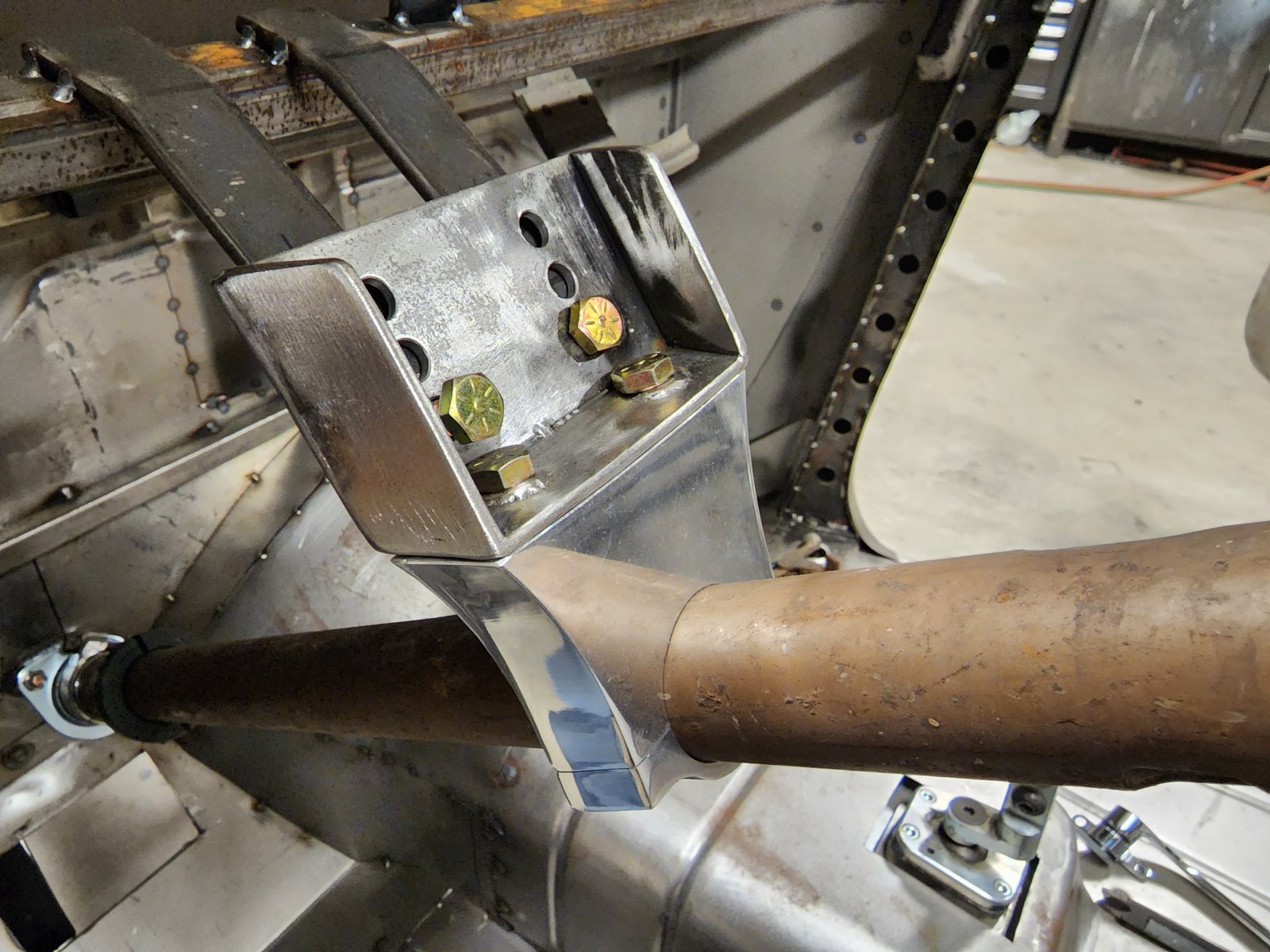

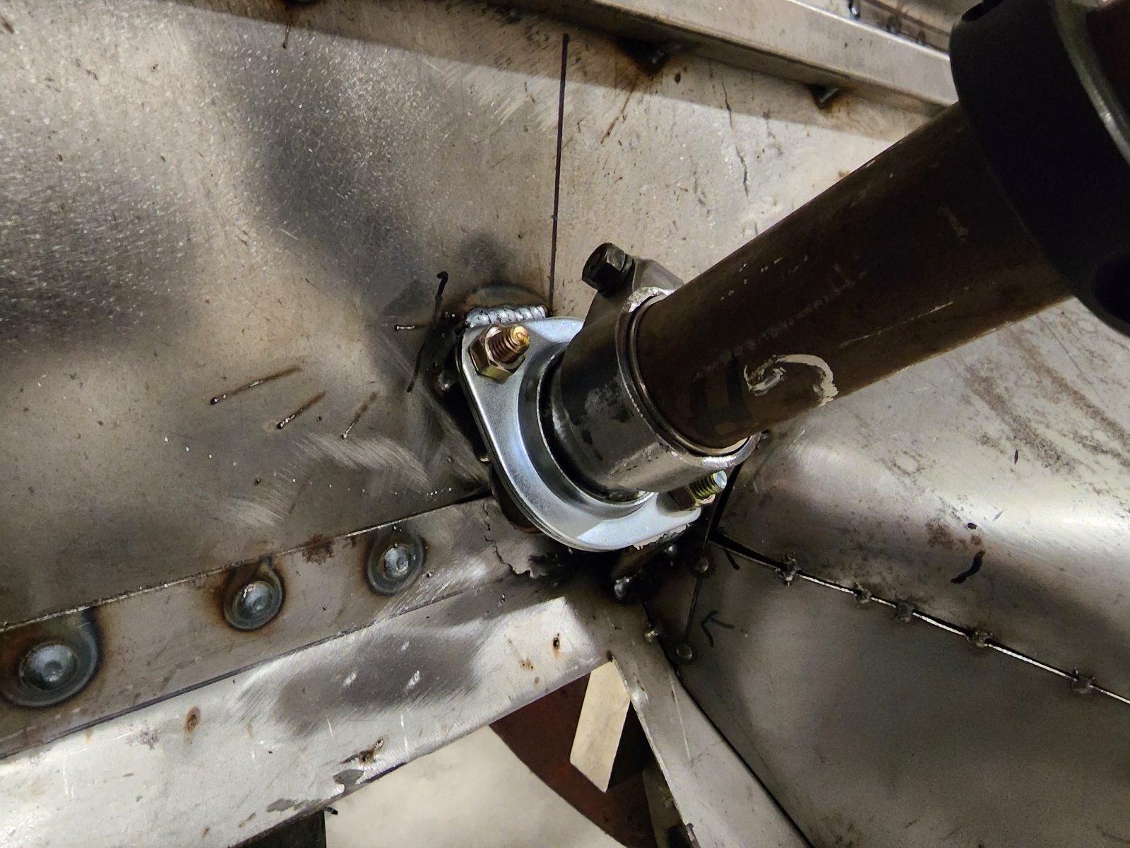

    Step 1046:
    Do more steering things. Make it all adjustable.
    I guess I didn't take a picture while I built it, but I hollowed out one of those steering support bearings that allow for misalignment and then welded a piece of tube with a 1.5" ID to it. Then I modified a stock style clamp to make it a bit bigger to hold it all together. This lets me adjust the column up and down without much trouble at all.
    I can take some more detailed pics of it if anyone is actually interested.

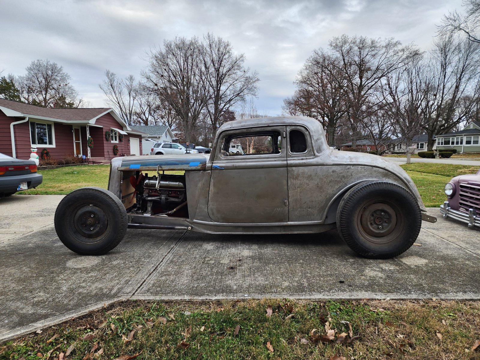

  11. Johnny Sparkle
    Joined: Sep 20, 2003
    Posts: 1,226
    Johnny Sparkle
    Step 1142:
    Sell that Model T. Pause and reflect on a long long history of poor financial decisions....

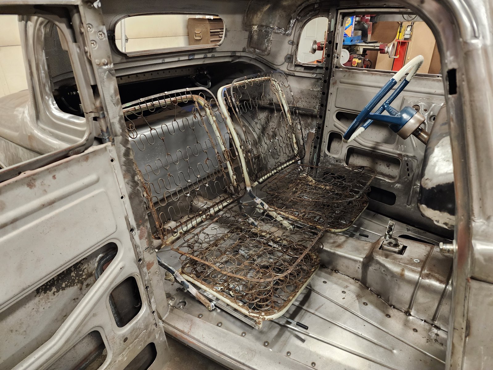

    Step 1143:
    Continue the interior stuff. Cut down the VW beetle seats, make new pivot points and bend the backs to the right angle. Hopefully I can use a regular seat cover kit.

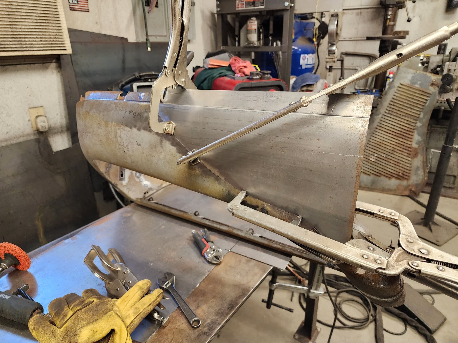

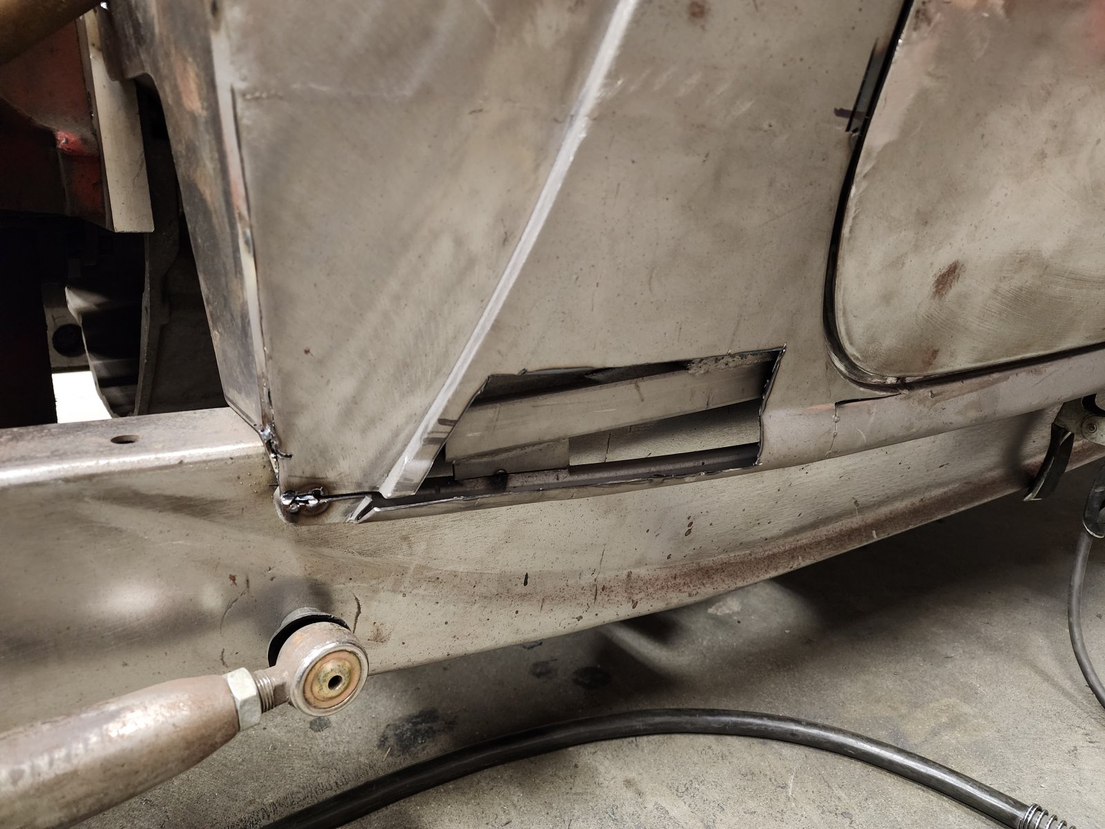

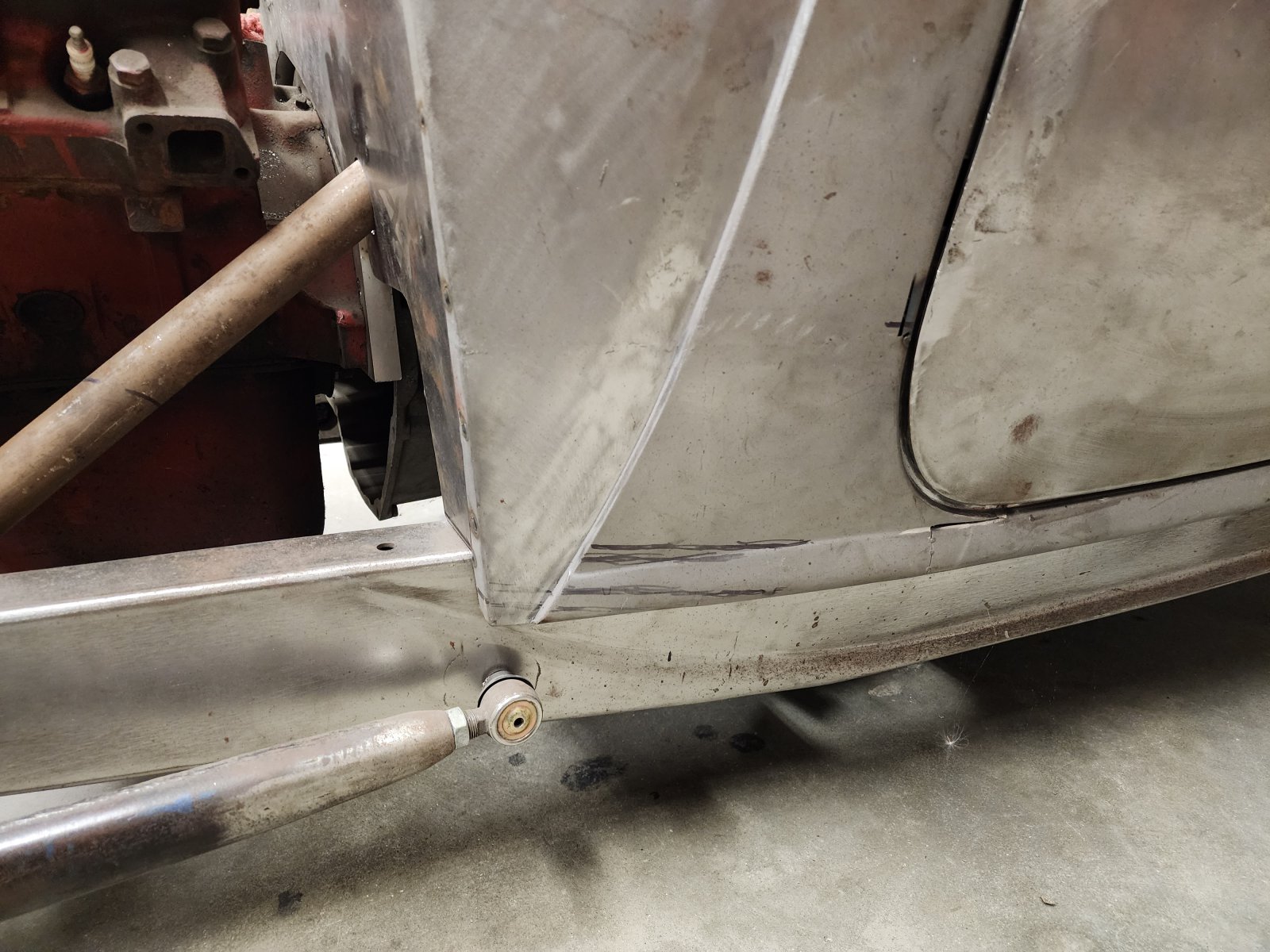

    Step 1139:
    Guess what! Redid some more of my old work again! The cowl always bugged the hell out of me. It didn't flow right, it was too straight and had a weird twist to it.
  16. Johnny Sparkle
    Posts: 1,226
    Johnny Sparkle
    I posted a reply before the finished pictures loaded up. It doesn't look like much, but I'm so much happier with it now.

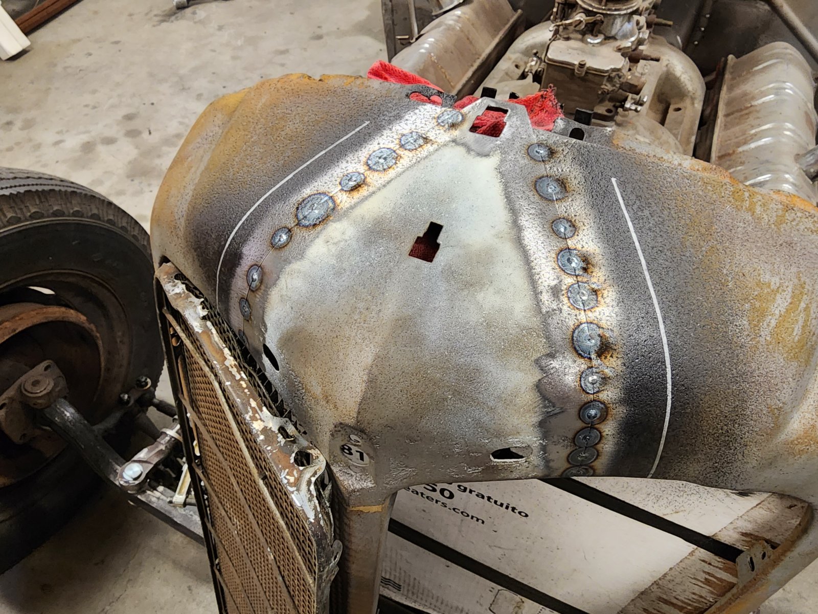

    Step 1222:
    Annoy the hard-core Mopar people a bit more. Cut down a '34 Buick grill shell to fit. Narrowed about 3" at the top, shortened 5" The stock Plymouth grill is pretty cool but the bottom looks like a shovel and the grill insert I have is pretty beat up and will take so much work to make nice.
    This is where I'm at currently. It's all tacked in while I figure out how to mount it and how I'm going to modify the hood to match the lines in the grill. Need to narrow/shorten the grille inserts too. Should be interesting to braze/solder up the super tiny thin br*** trim pieces.

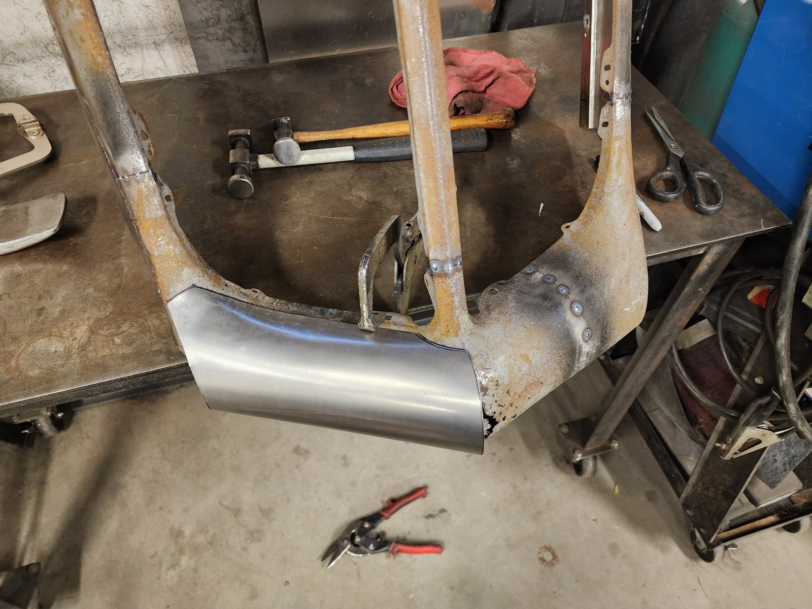

    Step 1227:
    Remake the bottom of the grill shell, make some side panels to fill in where fenders went.
    Hit all the things with hammers. Attack with a grinder until it looks cool enough for Instagram.

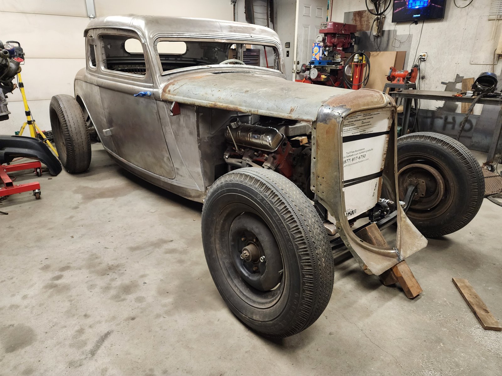

  28. Johnny Sparkle
    Posts: 1,226
    Johnny Sparkle
    Thanks!
    I'm in the middle of figuring out the hood setup right now, I'll post some better detail pics of that whole debacle once I get through most of it.
    Here's a quick pic of where it stands today.
