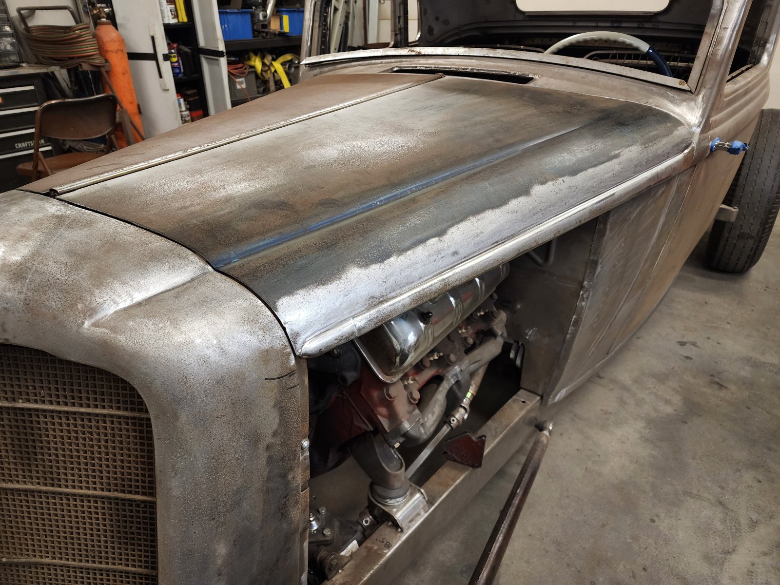

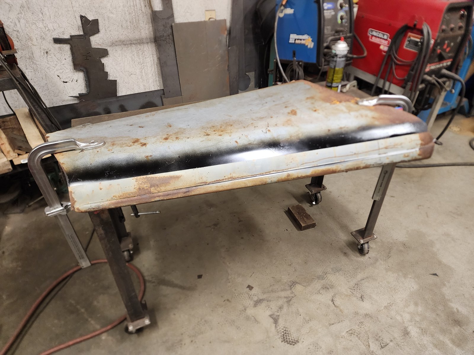

    I had to cut at least 12" off the '34 Buick hood to get it to the right length. I then had to cut the hood hinges off and narrow the whole thing and make new flanges to fit the Plymouth hood hinge. Took a bit of reshaping on the English wheel with an inner tube on the upper and a bunch of time, but I got it.
    Also welded on the original body line from the Plymouth onto the Buick metal.

  6. The37Kid
    Joined: Apr 30, 2004
    Posts: 32,496
    The37Kid
    Welcome back! Hood looks great! Is that sandpaper on the English wheel for traction? Harley 45 frame?

  7. Johnny Sparkle
    Joined: Sep 20, 2003
    Posts: 1,226
    Johnny Sparkle
    That's a rubber strip cut from an inner tube. It lets the lower wheel curve the sheetmetal without stretching it.
    The frame is a '54-ish panhead.

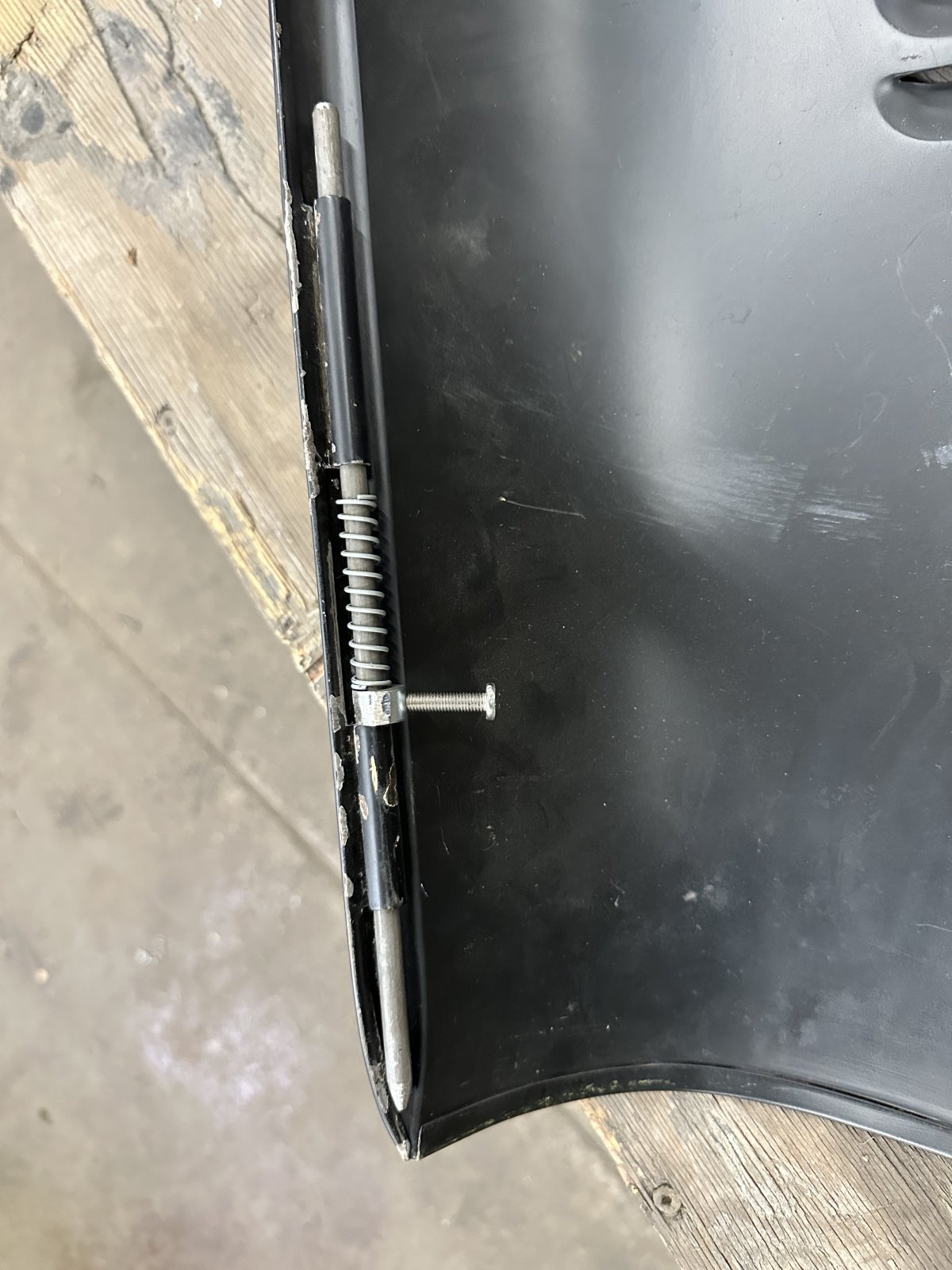

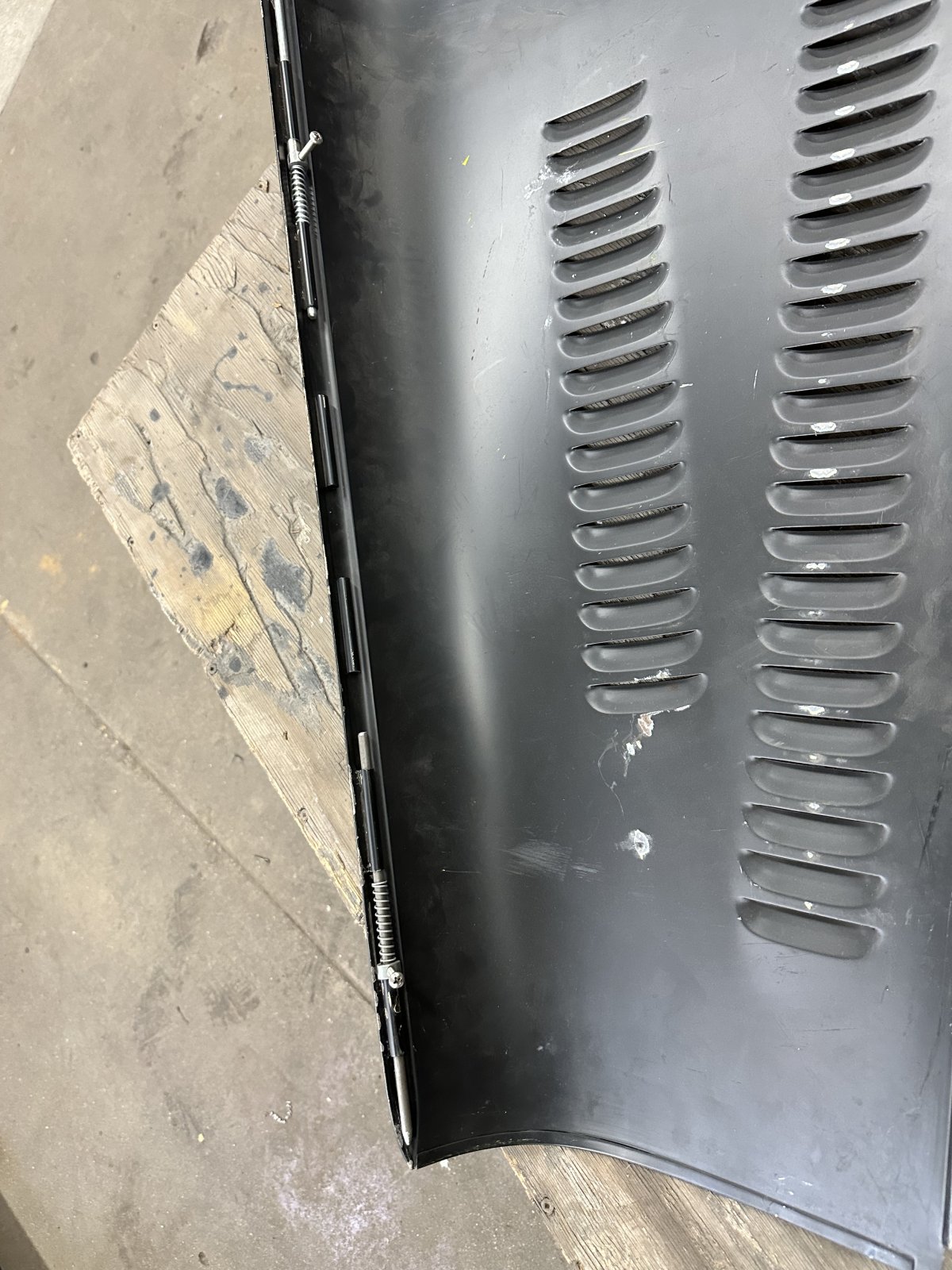

    Here is how I did the hood latches for a 2 piece top hood at work. IMG_2101.jpeg IMG_2102.jpeg

    Oooooohhhh, I like that. I was thinking about a little shot pin, but I never thought to reuse the hinges. Very nice.

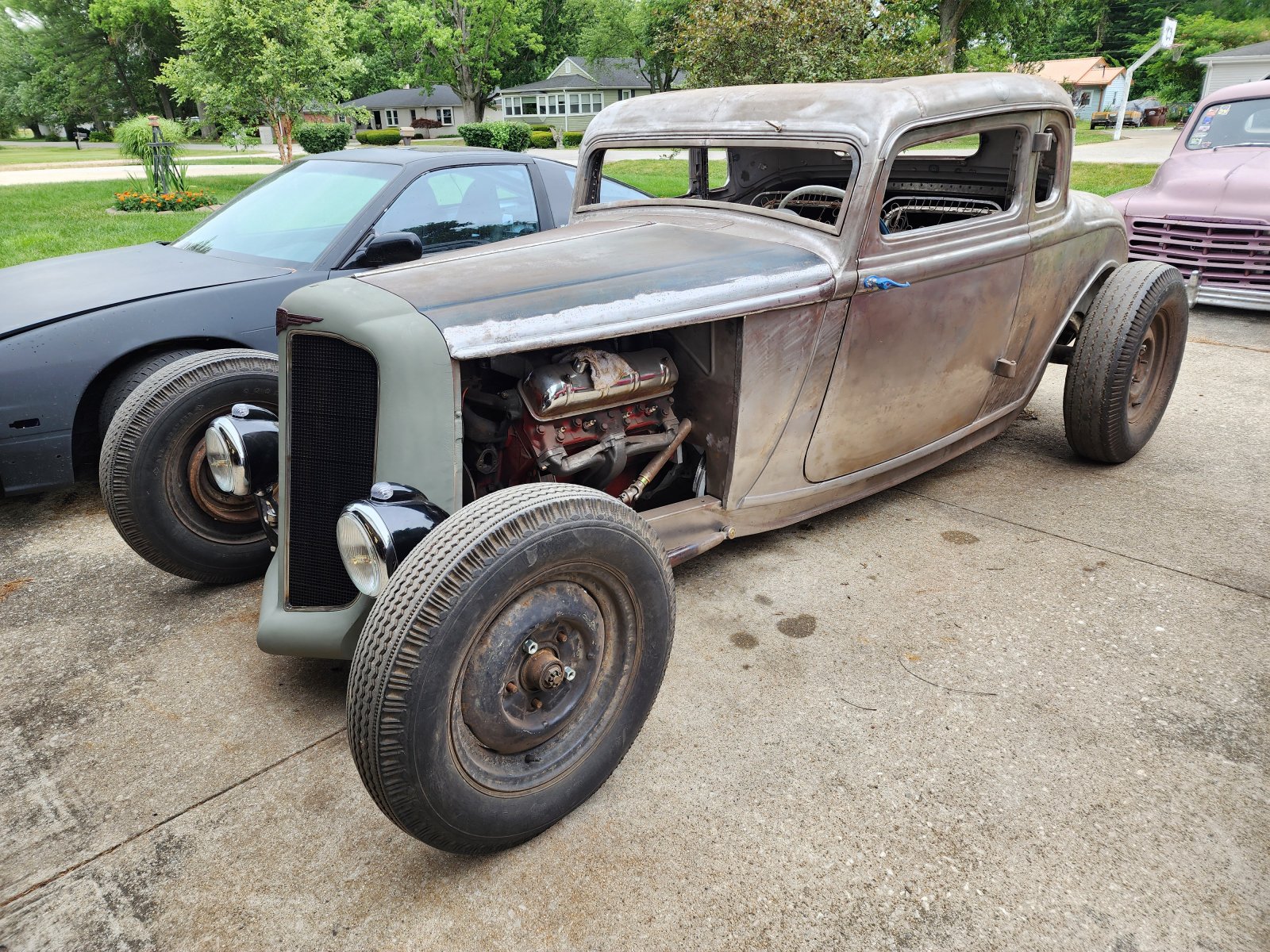

    An addendum to the hood pictures. I guess I didn't post a before pic of the '34 Buick hood. That thing was gigantic! 20231111_134532.jpg 20231126_181603.jpg 20231208_194952.jpg

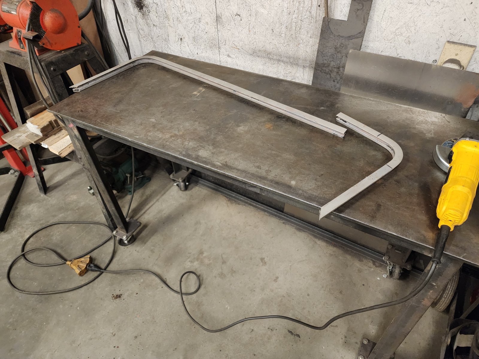

    Step 1352:
    Combine your two least-worst windsheild frames into one. The top portion had to be narrowed 1/4" and the bottom piece was rotted out one one side.
    I did have some original swing hardware, but it was easier to just make it from scratch using a Model A swing arm.
    Don't forget to forget to take a nice picture of the final result!

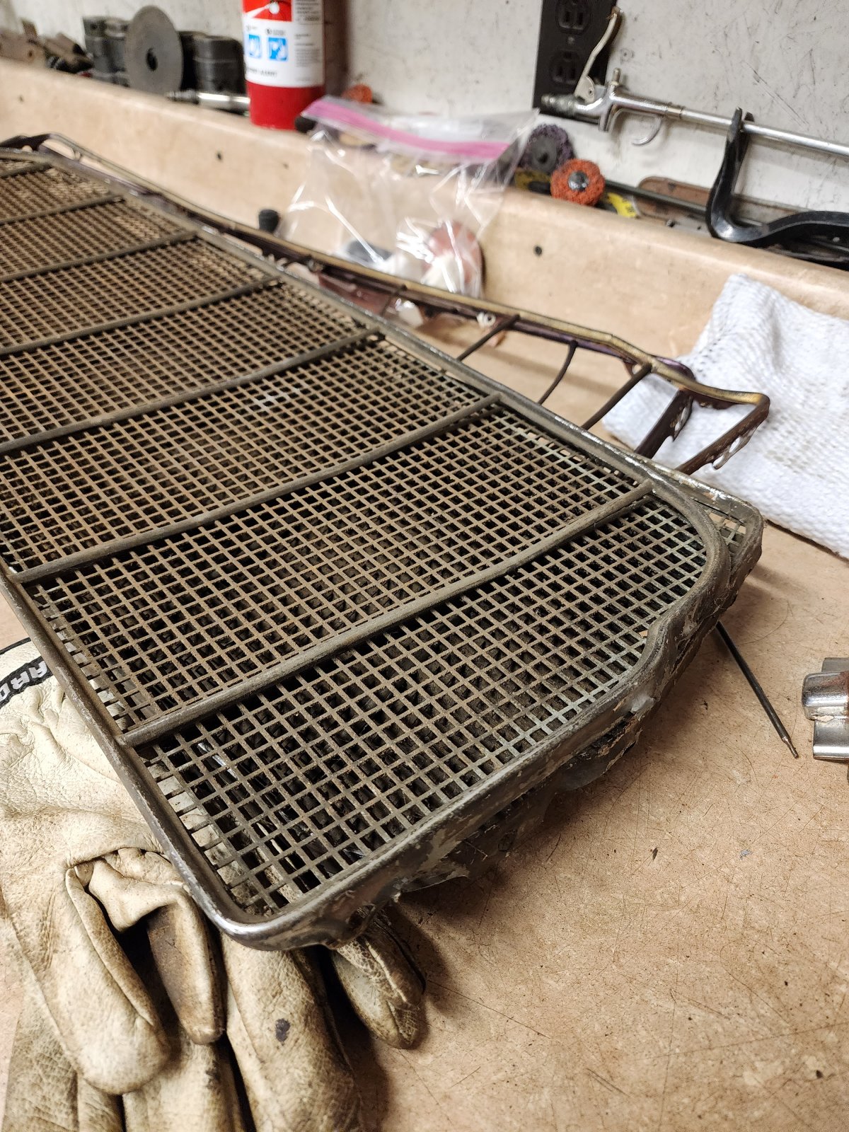

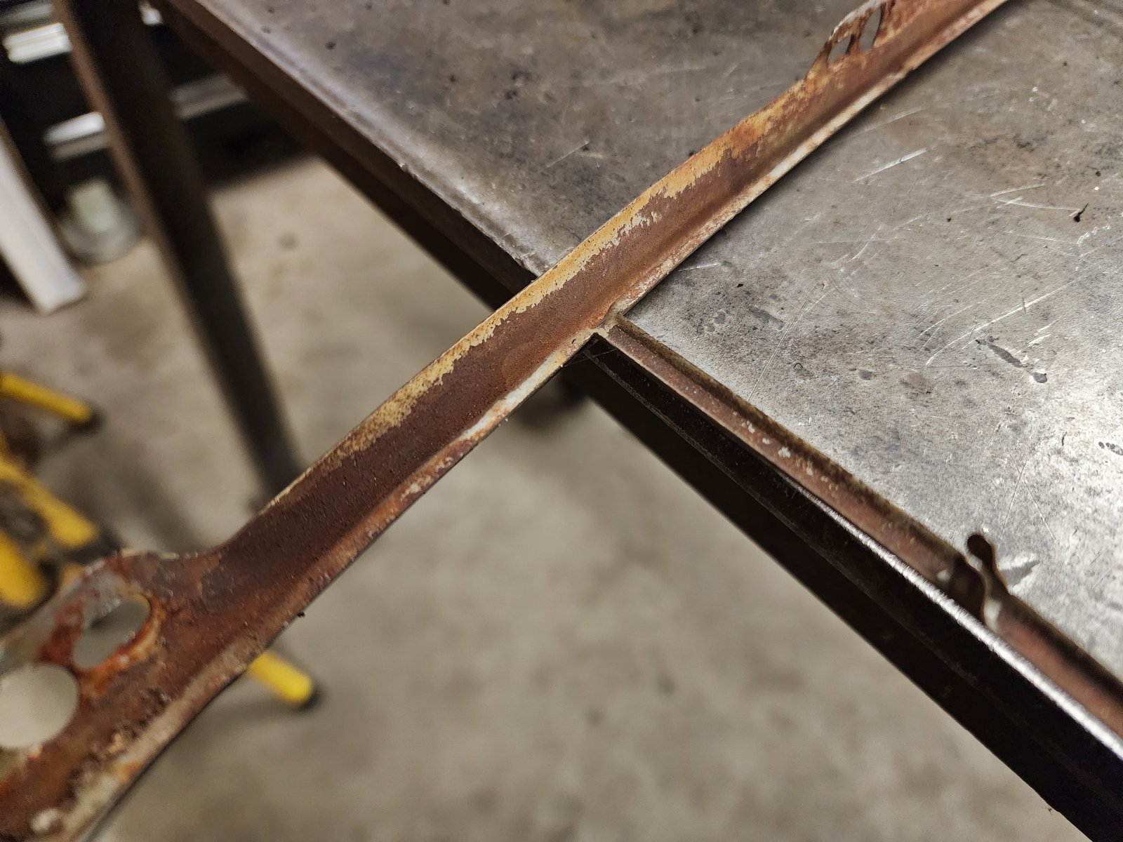

    Step 1372:
    Curse the rat ******* that decided to make the original Buick grill shell insert out of whatever hellish mystery br***-type material they purchased directly from Satan.
    Seriously. I could not modify the original insert to save my life. Nothing would stick to it. I tried 8 different fluxes, at least. I tried silver solder, acid core solder, stained-gl*** solder, electric solder, and probably another 5 or 6 solders of different brand and lead content. Even mixing my tears of rage into the flux didn't help.
    If I could heat the cursed material enough to get the solder to even wick in a little bit, the material would just crumble. I don't even want to talk about my attempts at brazing.
    This ended up giving me serious Rodder's Block and I just tinkered with various kinds of alchemy and pleas to various deities for a month before I finally gave up on it.
    Stupid Satan Br***. Should have been easy...

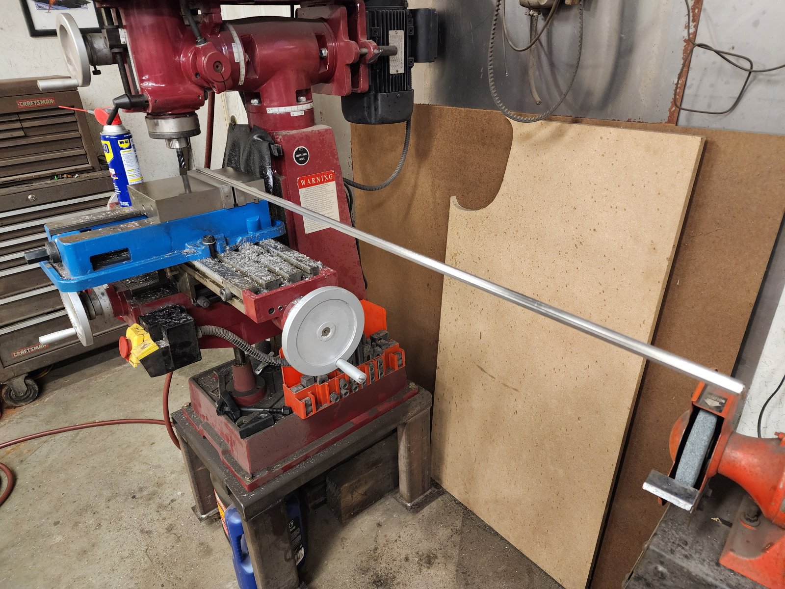

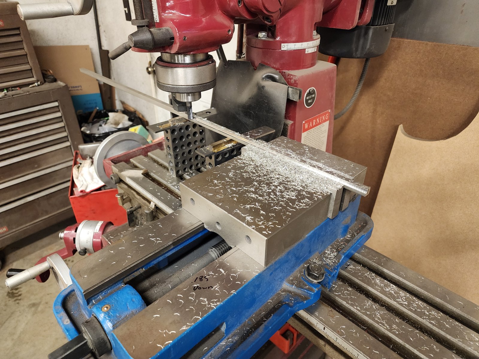

    Step 1390:
    Quit crying and order 12' of 3/8" square stainless. Spend entirely too many hours machining it so it has a neat shape. Watch "Supernatural" the entire time, but lie and say you are watching WW2 do***entaries if someone asks.
    I tried to make a setup so I could cut about 18" at a time, but the material likes to bow severely once the corner is cut out. I ended up having to cut only the 6" width of the vise. So, I'd cut with the 1/2" .060 corner radius carbide endmill along the whole length to make an "L" shape, then use a rounding bit along the length, and then flip it another time to run the rounding bit along the other side. Lots and lots of setups.

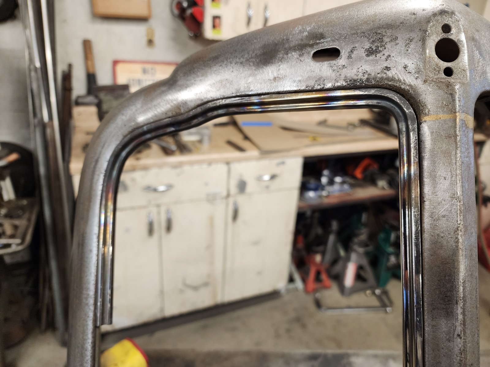

    Step 1391:
    Do torch things. Also hit the things with hammers. Make sure you use your nice expensive impact socket as a bending tool and turn it all gray from the heat.
    I ended up making each side out of two 3' pieces to make it easier to machine and easier to bend into shape. Once it was all bent I TIG welded it up. I welded some studs to the back of the trim and made angle brackets on the shell to hold it all together.
    I didn't do the cross bars like the original grill insert because I don't hate myself quite that much and I think it looks good with just the perimeter trim pieces. 20240413_131947.jpg 20240413_153823.jpg 20240613_144548.jpg 20240613_175545.jpg 20240613_184022.jpg

    Possibly that br*** was actually bronze which if I remember is br*** mixed with tin? Metallurgy gurus please correct me if I'm wrong.
  24. Johnny Sparkle
    Posts: 1,226
    Johnny Sparkle
    It ties in about as much as my other ramblings, seems like good info to me.
    It didn't look as dark as bronze, but I wouldn't be surprised if it was some odd alloy. I thought I had a better pic of it cleaned up, the pics I posted had paint and whatnot on it.
    They were chromed at one point. I sanded that off, but I wondered if that was affecting the wicking of the solder.

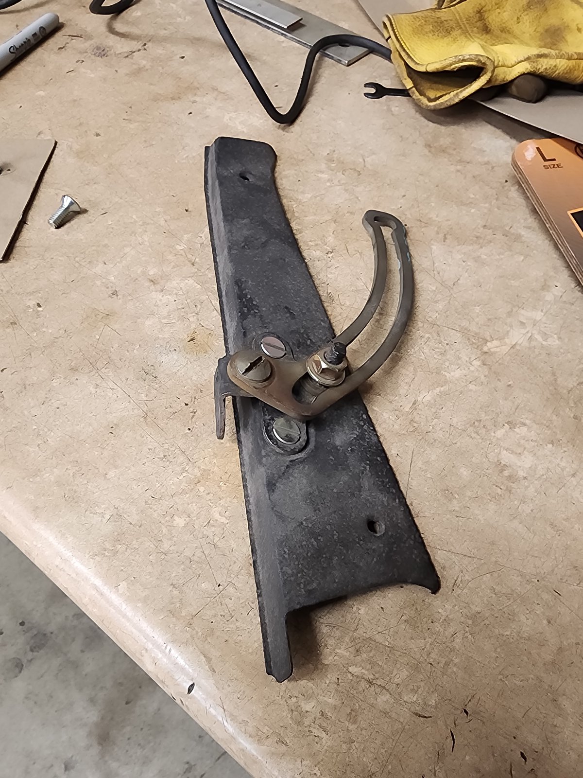

    Step 1399:
    Cut up an F1 shock mount and a Model A headlight bar. Weld them together. Heat the conglomeration and do bendy things.
    Decide you don't like it and cut out another 3" and do it all again.
