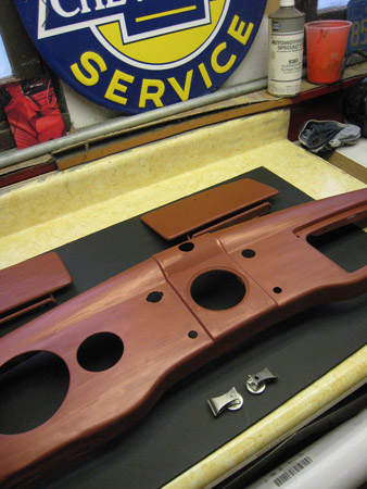

    I have wanted a woodgrain interior in my coupe for years. It originally had a woodgrain dash, but sometime in the '60s, my Dad had painted over it. I had gotten a woodgraining kit from JDee (my woodgraining hero) a couple years ago, and I have been putting off doing it because... well I didn't want to screw it up. Things started off well though...
    The parts of the kit
    The victims. I had already laid down my red oxide and random copper pearl washes to bring out the shimmer that real mahogany has. It's faint, but you can see it when it's wet.
    place the ink on the plate and squeege it across...

    Then roll the roller across the plate to pick up the image.
    First pass
    The mask for the next pass. You place it down and hold it down with magnets.
    Damn, that is bitchin!

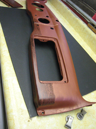

    Things take a turn for the worse. I can't get all the way across. Now what? And I can't get close enough to the waterfall area.
    You're right, that does look like shit...
    I tried to take the little tiny piece for doing corners to fill that edge in. It didn't work.

    Well now I'm screwed. So per the video, I tried to do the other side and rolled across the plate shortways and rolled it on the dash shortways. Not bad.
    But it is impossible to line up the grain doing that way. And is obviously not the right way to do such a seam. Sigh...

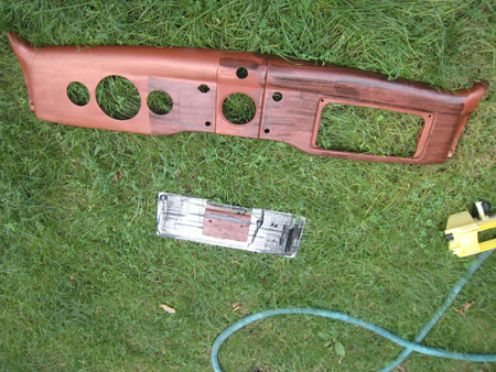

    Screw it. It's ruined. Time to clean up.
    Luckily the ink is water soluable...
    All clean.
    Well I got 2 woodgrain glove box doors out of the deal. It looks kick ass. No wonder it is such an art. It's freakin HARD to do.
    So, JDee, do I need bigger rollers, or what? How the hell do you do the intricate shapes of a '36 dash??

    While rollers and celluloid transfers work, they look like rollers and celluloid transfers. They repeat, are difficult at times to conform to certain shapes (the problem you're having), and while the copper underbase is a good move toward realism you'll still have a roller-grained dash panel. In my teens I did a fair amount of research on techniques used by the OEMs and their suppliers. Modern Metal products, Penninsular Slate, and another company which I can't recall all offered several ways and grains for the OEMs. Some of the Ford designs were also under copyright. Hand applied artistic grains were used extensively in many cars. Most burl grains were celluloids or photo transfers.
    You need to practice on a panel. Roll out your grain to the height you need around the center detail that's giving you trouble. Take a brush and pallet out the right consistancy to drag some grain. Don't overload the brush. Do it light, do it multiple applications. What you want to practice brushing is a copy of the roller pattern. Pick up the rolled pattern while it's still wet and BE PATIENT. Drag it up and around. Make it the way it looks from the roller. Once you feel ready do the corners 1st. Then roll out the rest. It's a process man. It take a kool head and a good mood. If you become frustrated walk away. Have a beer, burn one, get a hummer, whatever it takes to get "settled in" to make it come from the brush. I hope it makes as much sense to you as it does in my head. Good luck with it. Don't give up.

    I find using a lot of pressure helps on curves,the roller will distort and conform to the surface.Watch the video again,their "rocking and rolling" method works excellently.
