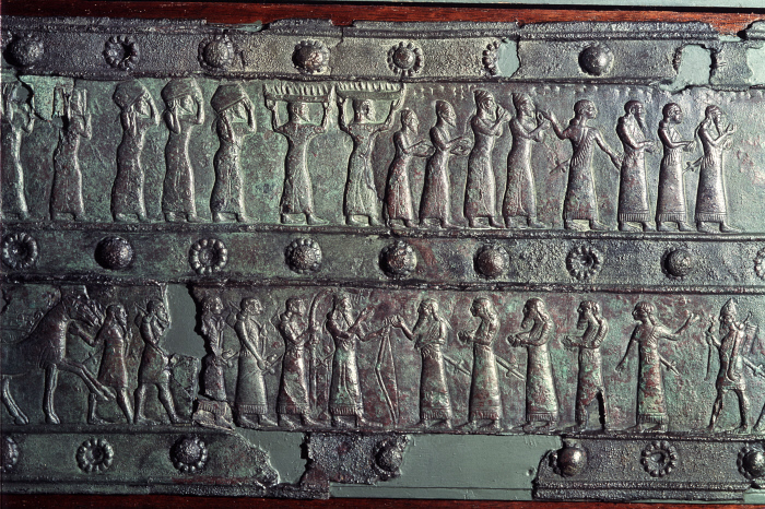

    All I really know is that the process predates me. In my Bible, in 2 Chronicles 4:9 it says "He made the court of the priests and the great court with its gates and plated the gates with bronze." Industrial processes amaze me.

  3. Oneball
    Joined: Jul 30, 2023
    Posts: 1,652
    Oneball
    Chrome plating on cars started in earnest towards the end of the 1920s prior to that brightwork was usually nickel plate.
    Your biblical quote is about attaching sheets of metal to a wooden gate.
  4. Hammering sheets of gold or silver and electro plating are 2 different things.

    I know about the gates thing from going to the British museum and seeing the ***yrian gates there.
