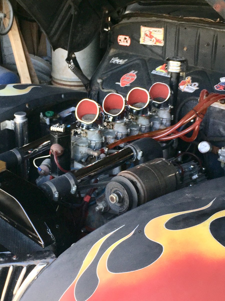

    When I built my Coupe 30 years ago, the radiator that fit by measurements was from a 6cyl Plymouth Duster, and it cooled effectively up to the day that I decided to redesign the car 2 years ago, and the ONLY reason I didn't continue to use it was that I had to have a shorter one. I think I paid $75 for it back then.
    You can see it in this picture:

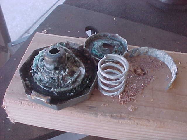

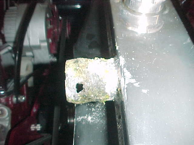

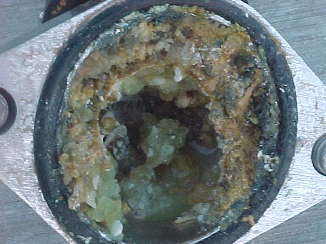

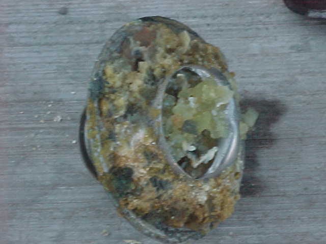

    Going on 30 years in my 32. But remember, you do have to have regular maintenance to have them last. This is one I took out of a 55 that got driven little and sat a lot with no maintenance.

    Man, that's the worst I have ever seen, did the car actually run? HRP

    It was running fine until it started to leak at the hose connections. The lower hose neck was worse the the upper one.

    It appears as though it's crystallized, was it running on just water? HRP

    No, it had antifreeze in it also, it was just neglect. Car was getting used maybe once every 4 months and the antifreeze hadn't been changed in 6-7 years. It had an anode in it also but that was worn to nothing.
