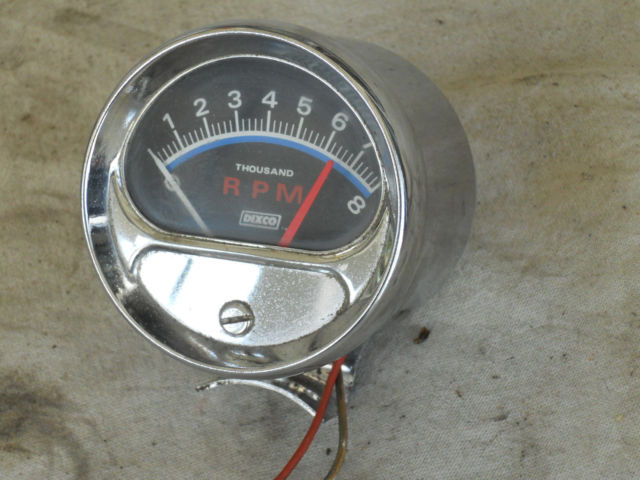

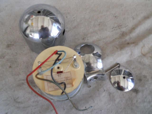

    As promised, obviously quite different, yet very similar.

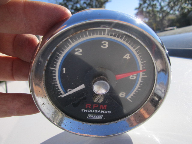

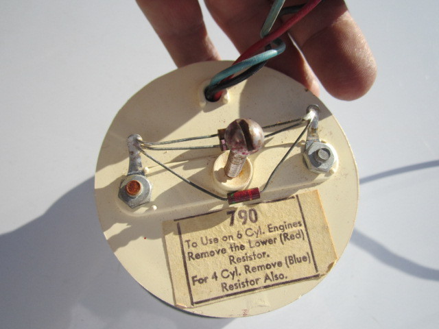

    Here's a couple Dixco's and their backside so you can see what I was talking about.

    The more I think about it I think the Dixco is a no-brainer for what I need. It works with the electronic ignition, made in the USA, has the look and less demand means lower price.
