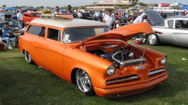

    I'm working on a second 54 Conestoga.
    When complete, it will be my daily driver.
    Stude powered (for now), GM T-200-4R, rebuilt (narrowed) Dana 44, disc brakes all around, new dash, new wiring, Weld-Draglite wheels, sway bars (frt & rr), bucket seats (older style), ooold...mostly original paint...
    Mike
    P.s. - Hope to modify the front of the hood and top at a later date.

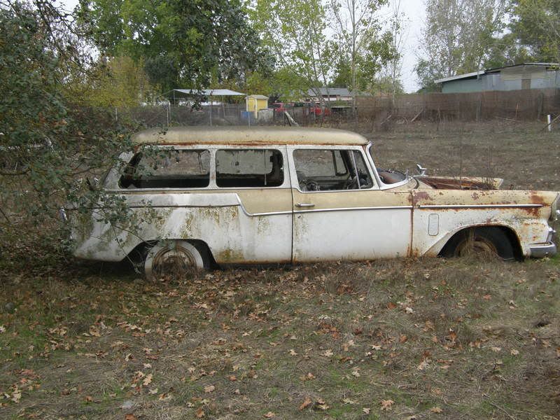

  8. That beautiful yello/white wagon is a shame. These are a super cool body style. Best o luck with your project. ~sololobo~

    If you want to start splitting hairs, the first '54 on the first post of this thread and the black one above (that one is mine) are "Regal" Conestoga Commanders and there were less than 2,000 made (1,912 if memory serves correctly).
    I'm actually glad to see so many out there. I've only seen 4 in person, including mine.

    Here is another shot of Drgnwgn's "Trailer Queen" in New Mexico taken on one of it's several round trips between Texas and Nevada. Being built on the sedan chassis means the Conestogas are 4" shorter from the firewall to the radiator than the coupes and no hood hump like the Hawks. This makes putting a supercharged Stude V8 under the hood a tight squeeze. [​IMG]

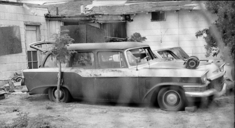

    Seeing that yellow derelict reminded me of a couple old shots I took back in '88 - this two-tone green '57 Parkview V-8 was behind a fence on Walnut Street in Pasadena, along with a '56 Power Hawk and an early Lark:
    Shot the second one pointing the camera over a wall. The license plate frame reads Bob Wyatt/Tujunga; only info I found was it had been a Kaiser-Willys dealer in 1954. Wonder what happened to it?

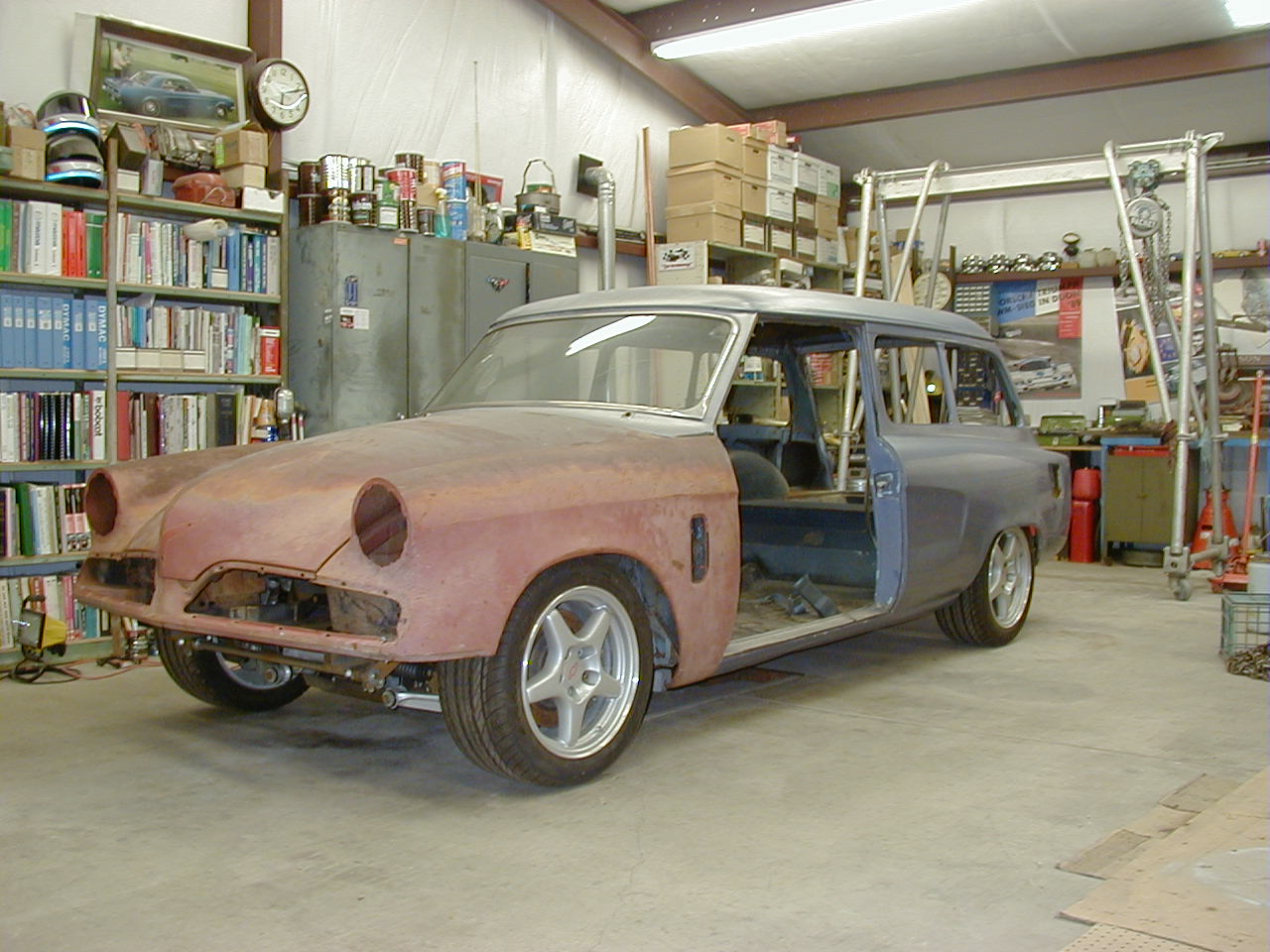

    Yea, while modifications may be a little more challenging, space in the wheel wells is not. This one has 7-1/2" wheels all around with no modification to the wells.
    Would like to get back on this one, one of these days, one of these days . . .

    Is that a Corvette front suspension I see under your wagon ?
    I put one (C4) under my 60, Stude 2dr wagon. Like yours...not complete yet. It's now my retirement project.

    Yup, C4 front and rear. And I must have been asleep when I posted because my wheels are also 9" with 275/40 rubber all around. While not a lot of clearance they fit just fine. Hope you are getting around to yours faster than me.
