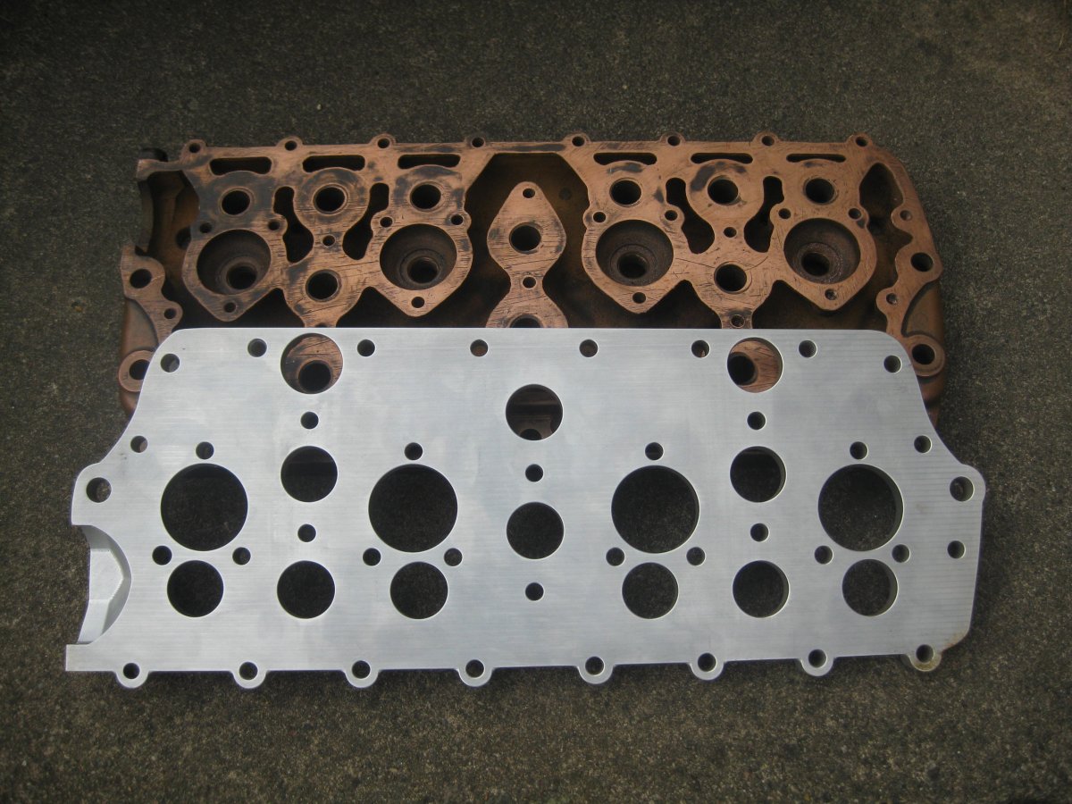

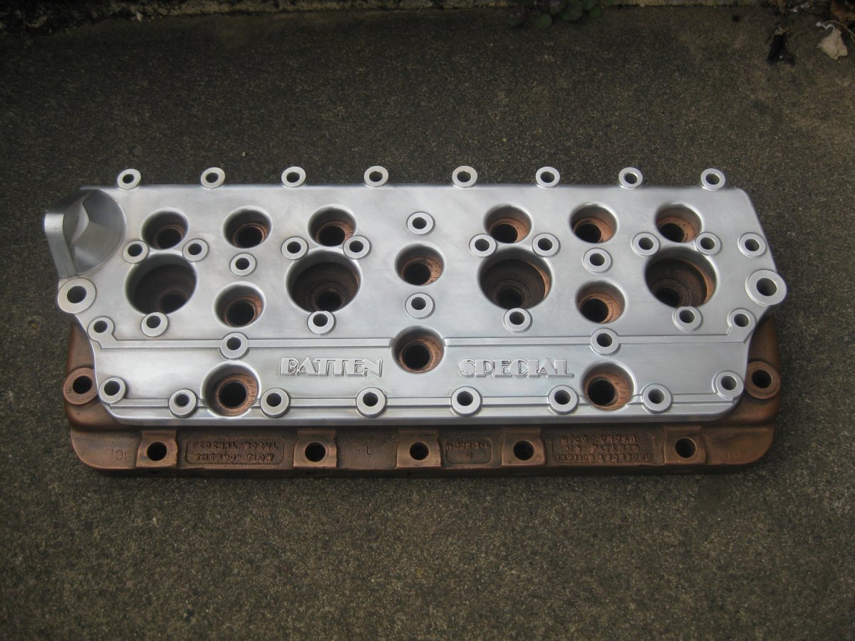

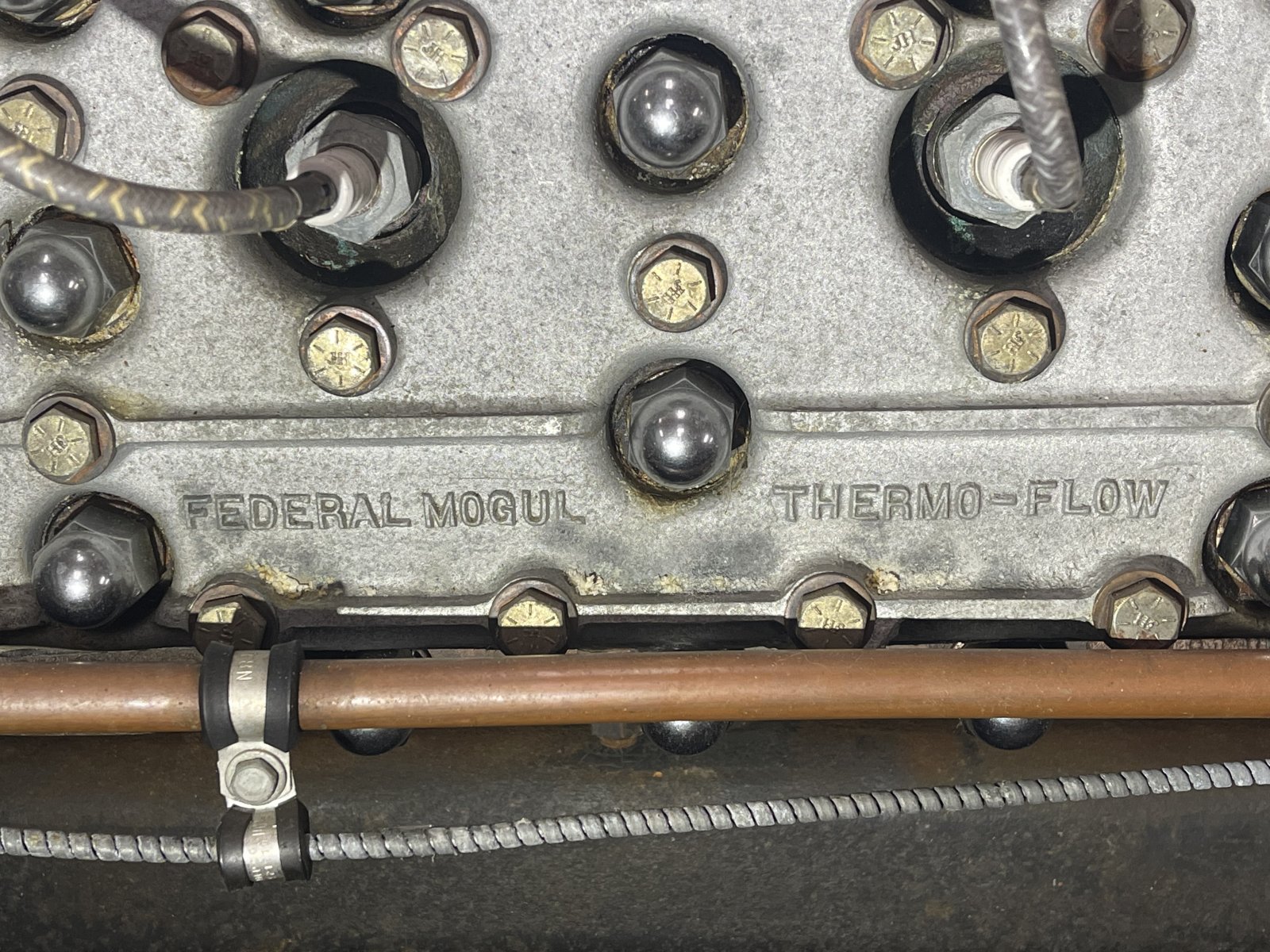

    New aluminium covers have just been made here in England.
    Since they will be fitted to my Batten Special, I had the original lettering changed, but that could easily be rectified in the CAD modelling. Since the modelling has already been paid for (by me) the cost of copies of the covers would be the aluminium billets plus CNC machine time. Rights to the modelling will remain here.
    The covers will be fitted with a full gasket to isolate the copper from the aluminium and prevent the galvanic corrosion noted above. Fasteners will be A4 stainless steel coated with Tef-Gel for further corrosion protection and to prevent possible galling of the bolts in the copper.
    I hope that may be of interest here.

    Hello - sorry for the delay.
    Here in England I use a sheet gasket material called Flexoid which is oil and water resistant, comes on a roll, available in various thicknesses, but any water-resistant sheet material would work. Cork sheet?
    In order to prevent galvanic corrosion the copper and aluminium must be kept completely separate from each other and the aluminium should not come into contact with the water else it will "dissolve" as it did in 1936 which is why F-M went to cast iron covers, which still corroded but not nearly as fast as the aluminium.
    My plan is to use a sheet of gasket paper with holes cut for only the bolt holes and spark plugs, then bolted down with stainless bolts coated in a PTFE gel (Tef-Gel) for further corrosion protection and anti-galling properties.
    I hope that helps.

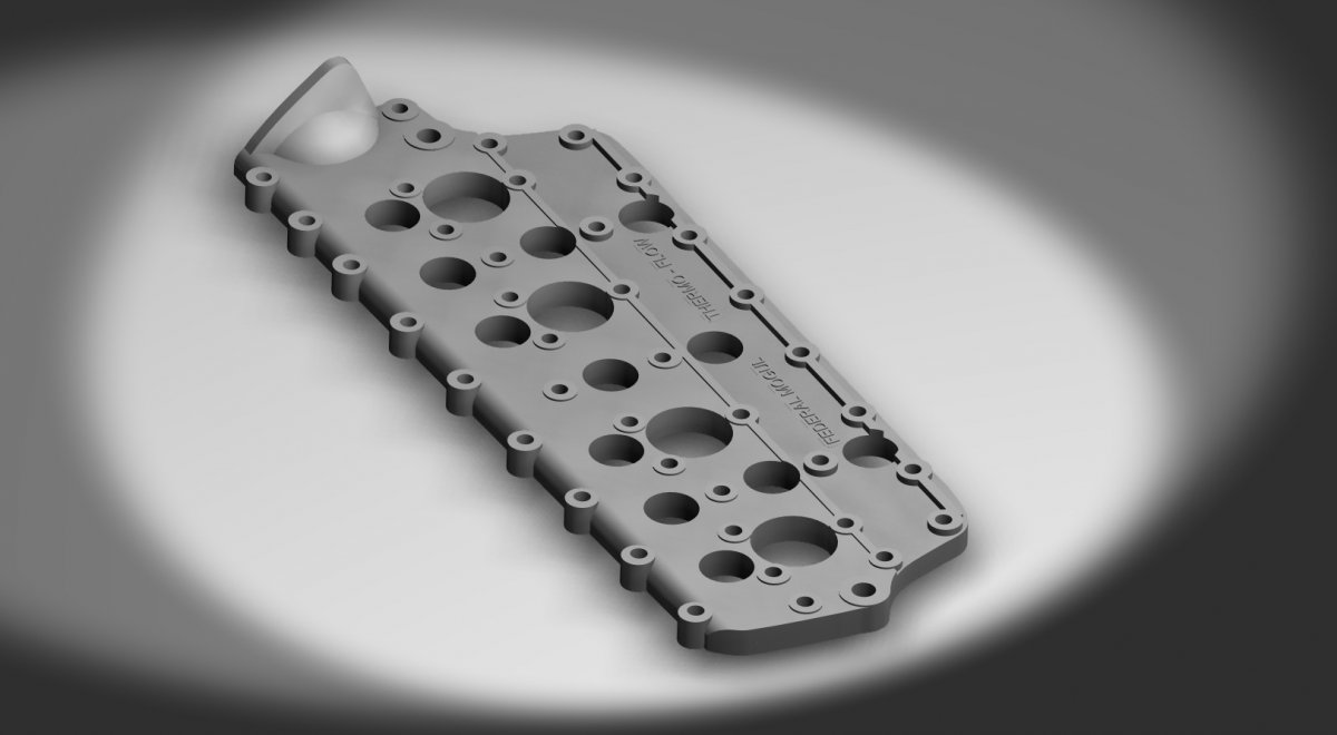

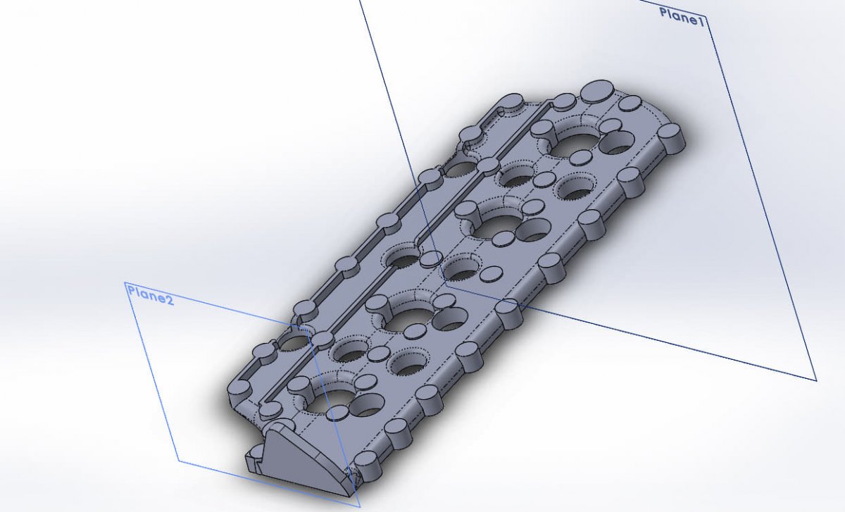

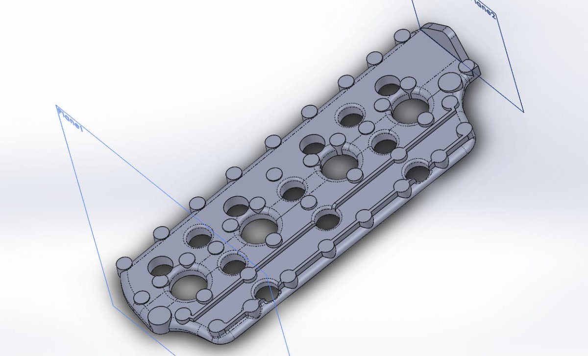

    Zach and I have been pushing forward on our project to make new covers for our heads. Here are some images of the modeling work thus far...

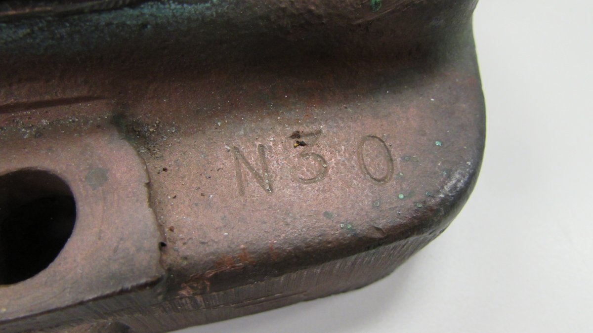

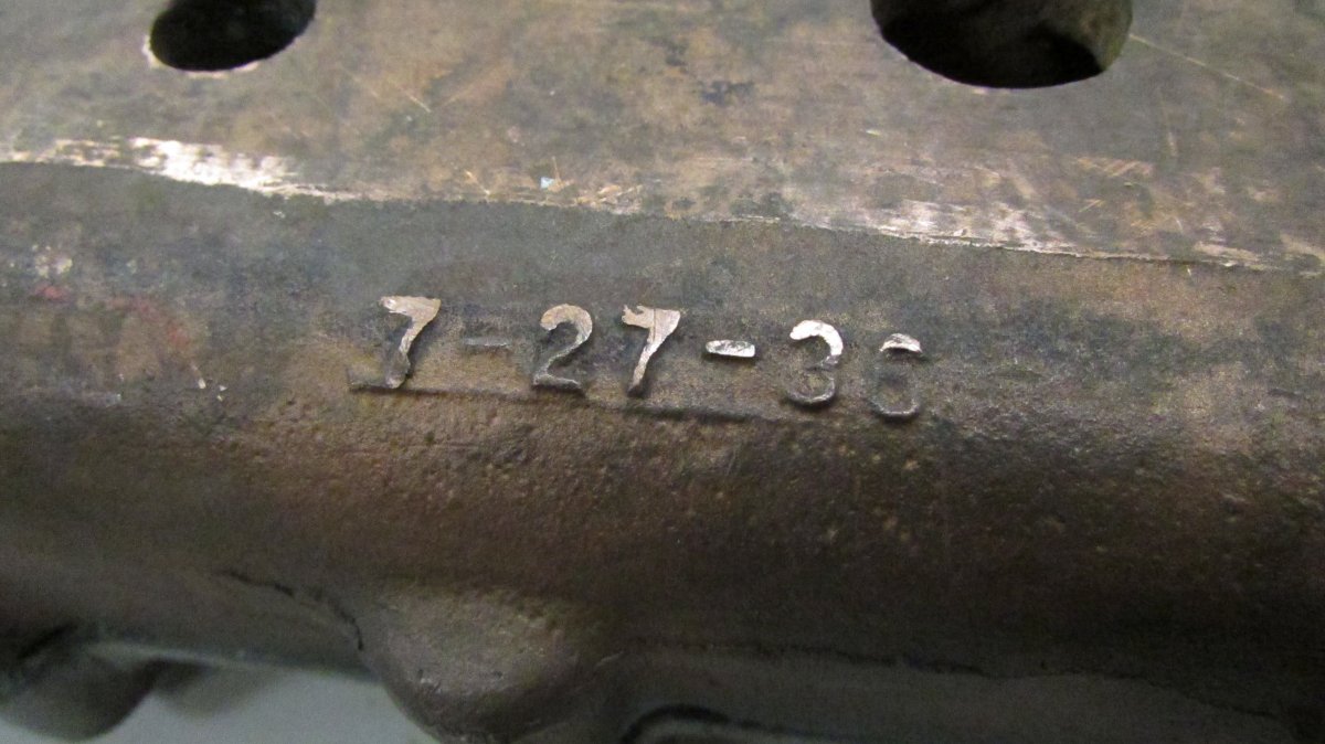

    Check the bottom side of the covers, those are the early one and are NOTORIOUS for rotting and warping.
    There should also be some casting dates on the bronze part of the head (each head has its own date) and a number on each head:

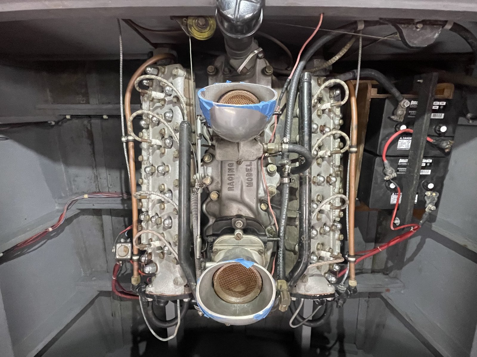

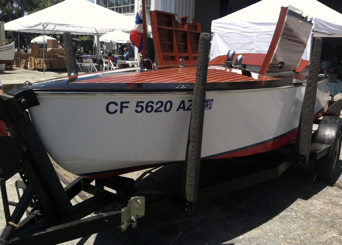

    I have a set of these on my 1940 Boyce Race Boat, and they are installed on a 1936 Flathead V8, while running great.
    However, I would like to find a correct gasket source so I can cosmetically refresh the motor and heads with my vapor blasting cabinet, so I would appreciate any help to locate a source for correct gaskets.

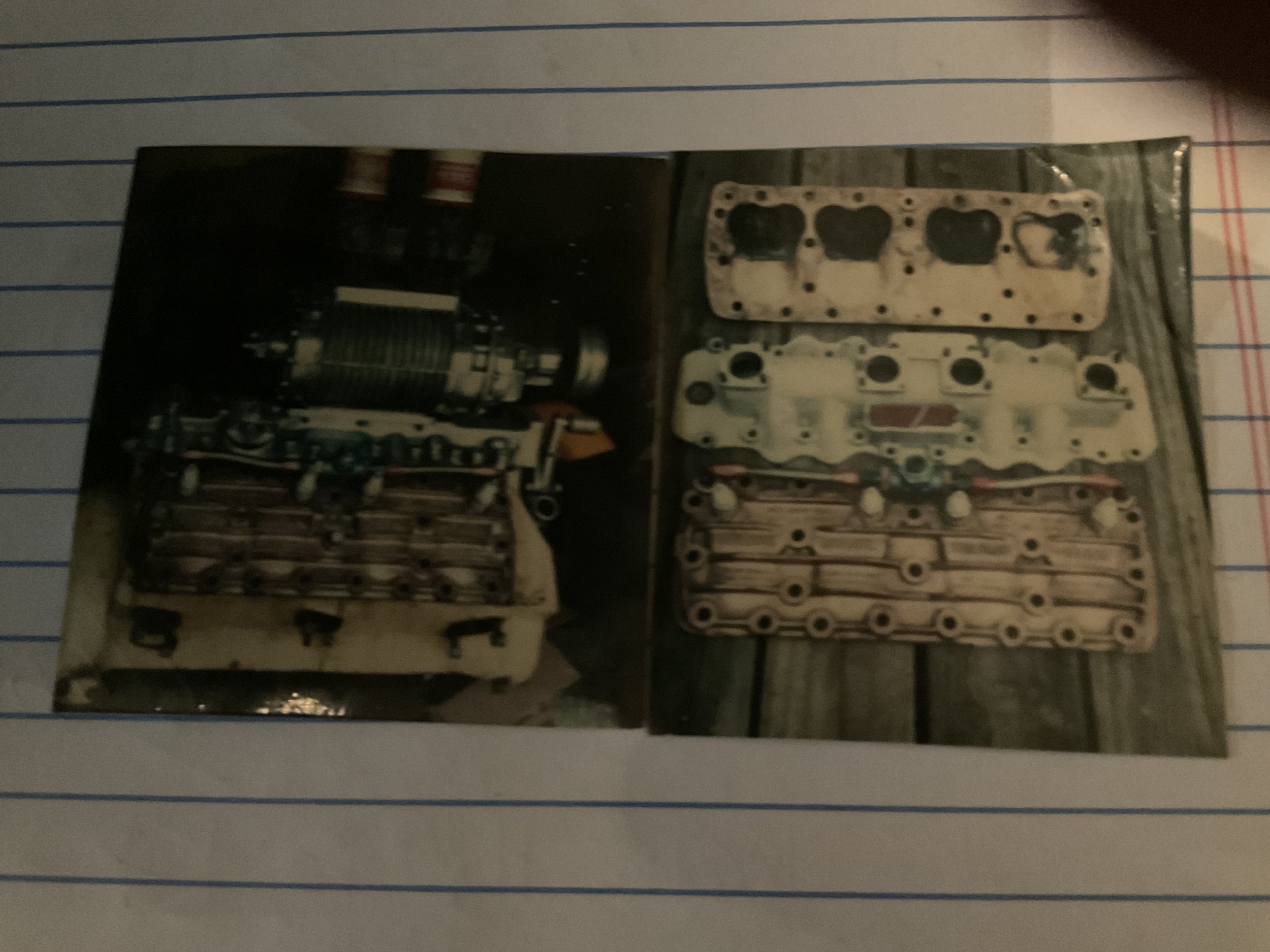

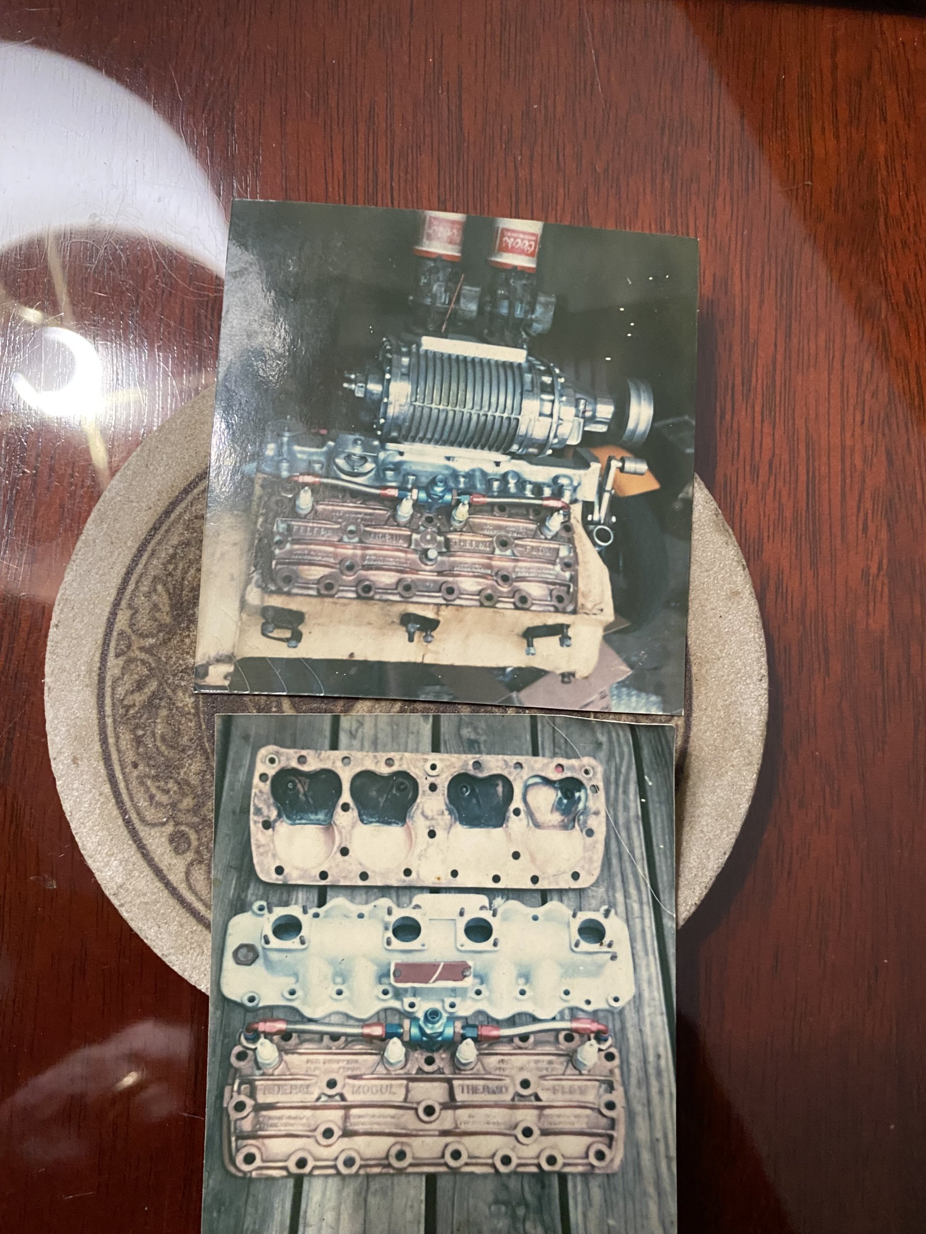

    I had a nice set of the 24 stud heads back in the 70’s when flathead speed equipment was relatively “cheap”. Someone referred to them as copper; I would have called them “bronze”, but not really sure of their actual composition/maybe a combination of copper and bronze?. IMG_0272.jpeg IMG_1941.jpeg
