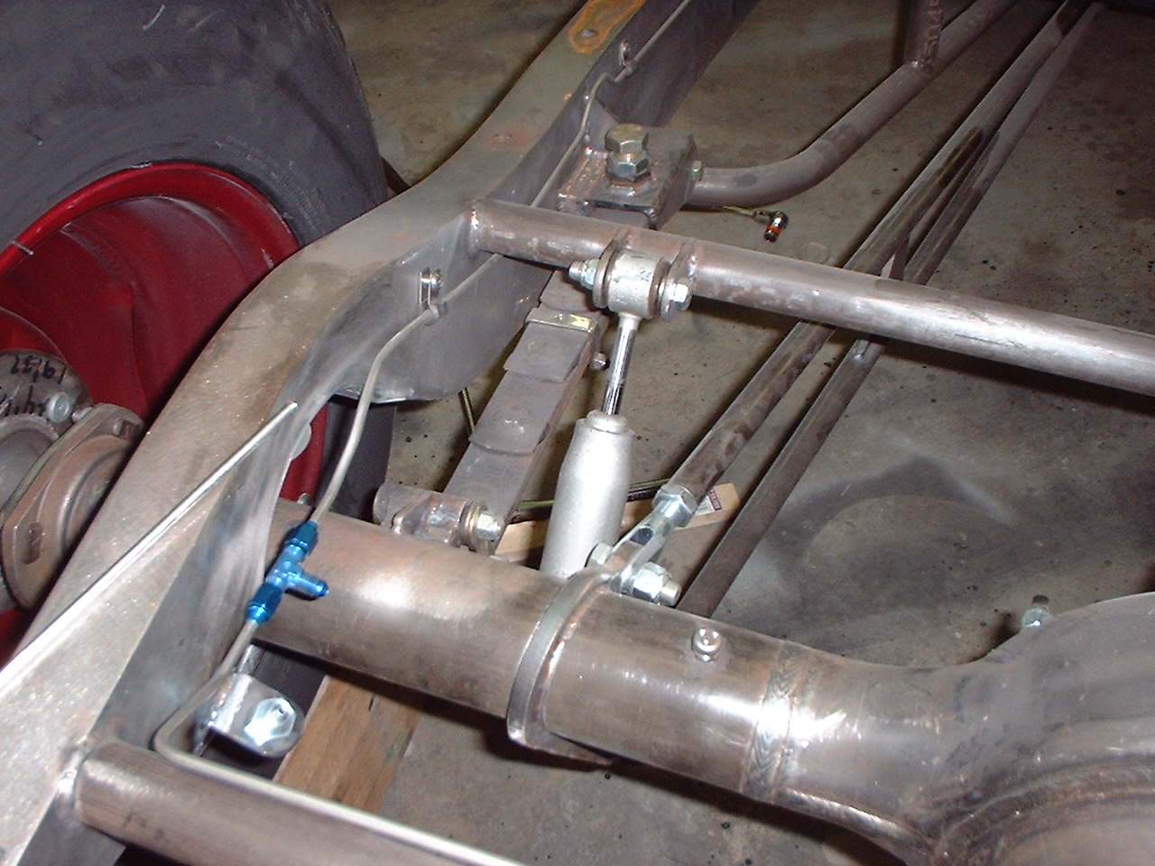

    Here's a shot of my old roadster with a four link using '36 bones as lower links.
    I ran it for some time as a true split wishbone and broke things twice, not due to engine torque but because of the normal side to side stress of street driving.

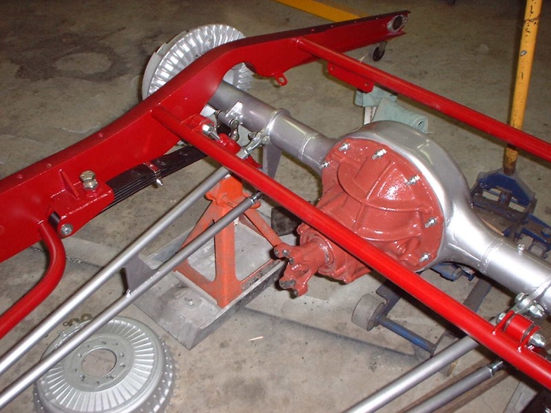

    Like this. I'm building another almost like it right now.

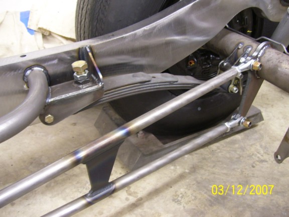

    Here's a shot of the rearend showing the upper and lower mounting brackets.
    I wouldn't ever run split bones on the rear of any street driven car.
