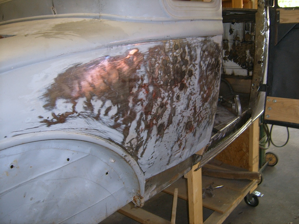

    The Old Bodies go through years of twisting and bending so you can get cracking in the corners and stress areas. If it's cracking in weird places I.E. roof panels or 1/4's. The body way have been burnt and is work hardened. But it can be fixed. I fixed a 32 Pontiac Coupe and a 34 Chev Coupe that had been burnt, I had to anneal the hard spots. The hard spots will ring compaired to a dull thump when hit. To anneal the MIld Steel warm the area up until the paint turns brown and let it cool on its own. No air No water. Just a slow cool down. The metal should become softer. Then you can hammer and dolly it. Weld the splits with a Torch, drill the ends first. If you have to, make a backup plate to reinforce the area. The only problem with this is it make this area stronger then the next and you end up with a double layer of metal. Look out Rust!!
    Just some thoughts: The Old Tinbasher

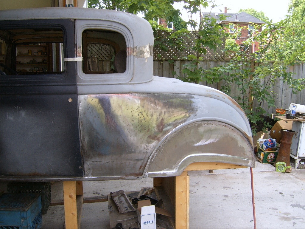

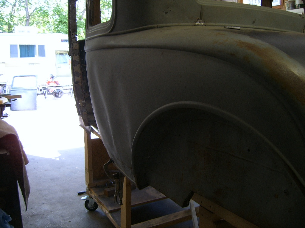

    Some photos of the car would be great, a lot better to be an arm chair repair when you can see what you bs about. Drilling a hole is a great idea, also you might need to run a hack saw blade along the crack to get the panels to realign, those parts were stretched out before they tore. If there are a good number of cracks in one are you might be better off replacing a section. Make sure the repair is done correctly and you car will out live you, adding a X brace to the center of the body is a good way to help control some of the movement in the body, and ensuring that the wood in the car is in good condition and you are not forcing the body into shape.
    The picture below is the standard area that these five windows crack, this car had been repaired some time in the 60's and due to how it was repaired the whole area needed to be removed and replaced.

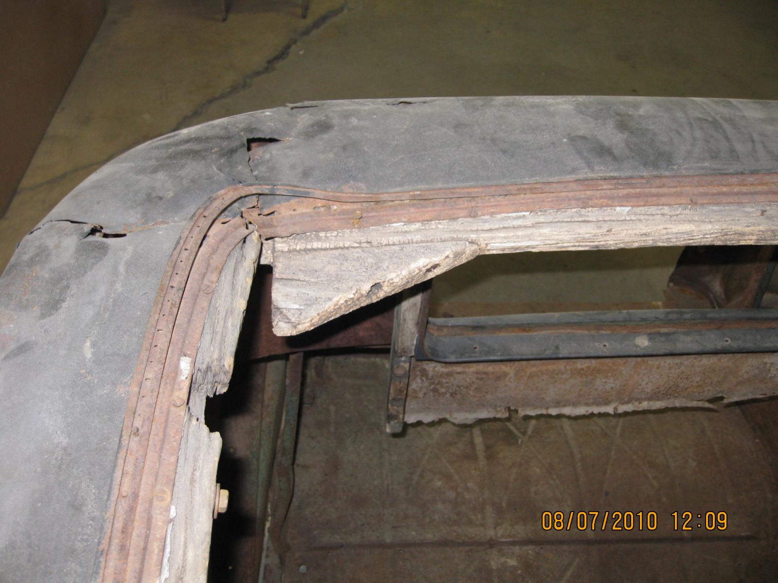

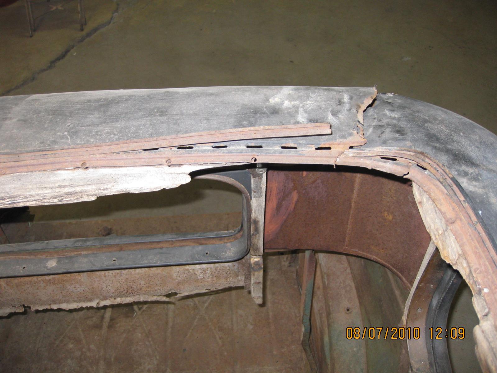

    Here are some pics of what I'm dealing with. Something flattened the rear of the roof years and years ago and caved the back of it in which you can better see in the one pic of the whole body. All I've done so far is pull/bend the roof back out so the cracks align and tack in a few spots to hold it in place. Before I carry on though I figured I'd better ask here to make sure I'm doing the right thing and not making matters worse. I haven't stop drilled anything at this point but I will from now on.

    Thanks for the pictures of the cracks, once you get the metal cleaned up and bumped around you will probably want to make some patch panels for the roof area. the rest of the body looks like it is in great shape keep us posted on your progress
    The upper quarter patch that i made was done with the english wheel and the pulmax was used to put in the belt line. a lot of prestreching in the belt line area with a 1" anvil on the wheel then the pulmax was used to coin the part .

    This is not just a crack I would definitely be making a new panel for this or you are just gonna end up chasing your own tail... and I like all the others said take the paint down and rust off before you start welding or it will only get worse
