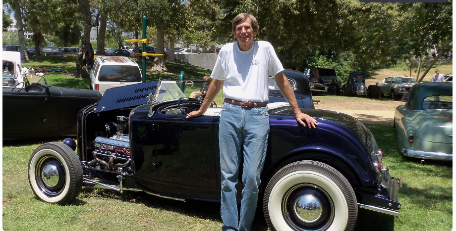

    Pat (RIP) was 6'6" and drove a 32. The right seat would be key.
    Great pic of him.

    Another phot of Pat Ganahl & his roadster, 6'6" and a chopped windshield. HRP
