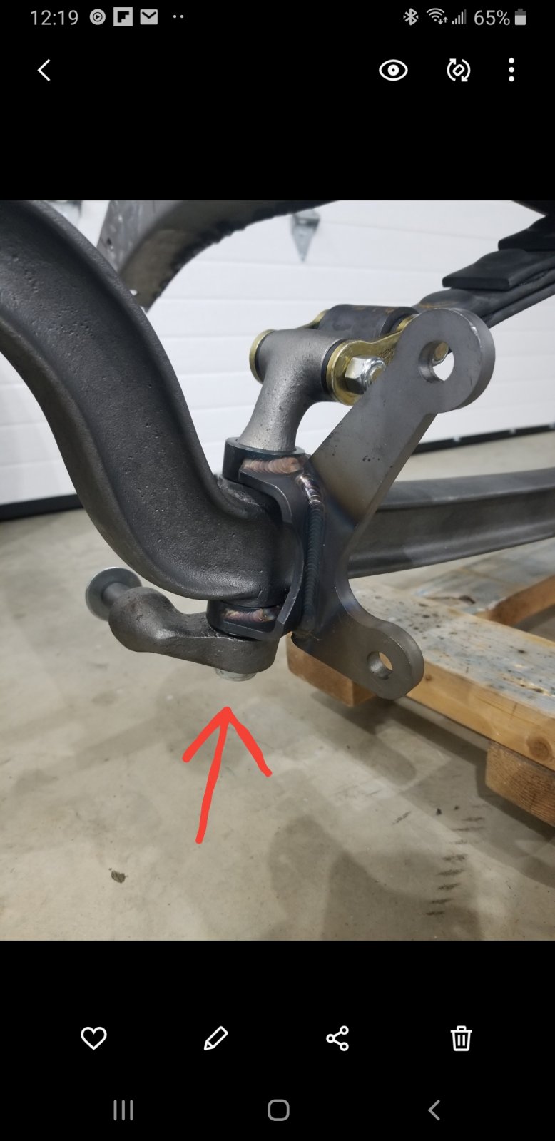

    Why so tight? Isn't there a 'key' to keep the shock mount square on the perch bolt?
    Dino 64 likes this.
  14. Doug Sonnenberg
    Joined: Dec 10, 2020
    Posts: 70
    Doug Sonnenberg

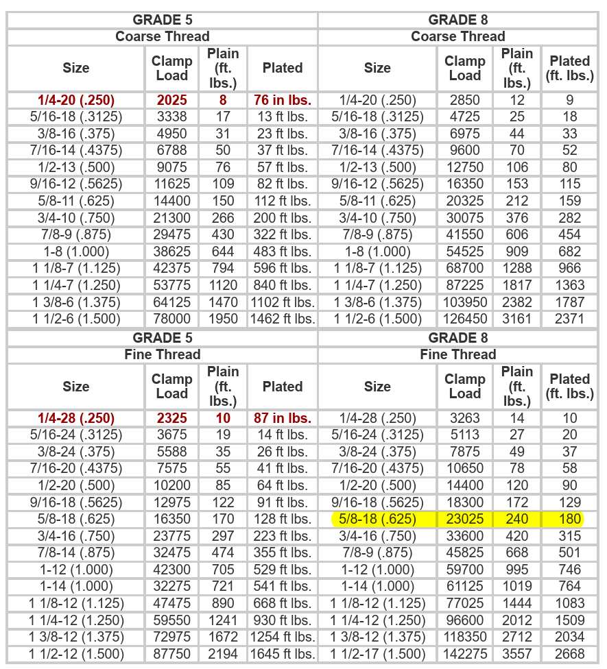

  16. 4bangerbob
    Joined: Jun 29, 2013
    Posts: 152
    4bangerbob
    from AB, Canada
    I believe the thread is a 5/8-18 NF thread. Material equivalent to grade 8 bolt? chart below may give you a good starting point.

  18. Doug Sonnenberg
    Posts: 70
    Doug Sonnenberg
    240 ft lbs seems like alot. Ill just get it as right as incan and maybe double nut it if possible.
    Thats a good idea, i may do the same to keep from moving
