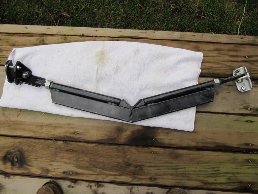

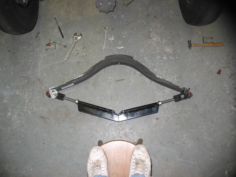

  3. I built a spring spreader for my Model A rear spring and use clamps when breaking down or ***embling the spring.
    Those springs have a tremendous amount of energy when they are stretched to connect to the spring hangers, so an abundance of caution is advised.

    I really like HemiDeuce's spring spreader tool. Would like to see more of this so I could build one myself.

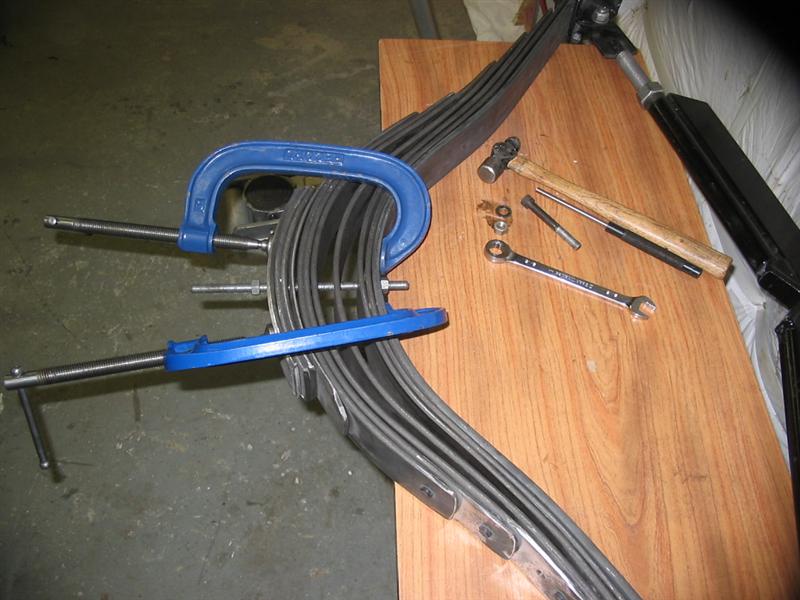

    After polishing and lubing the leaves, you can ***emble the spring with a long threaded rod, nuts on each end...THIS IS when you use the 'C' clamps.

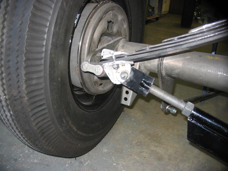

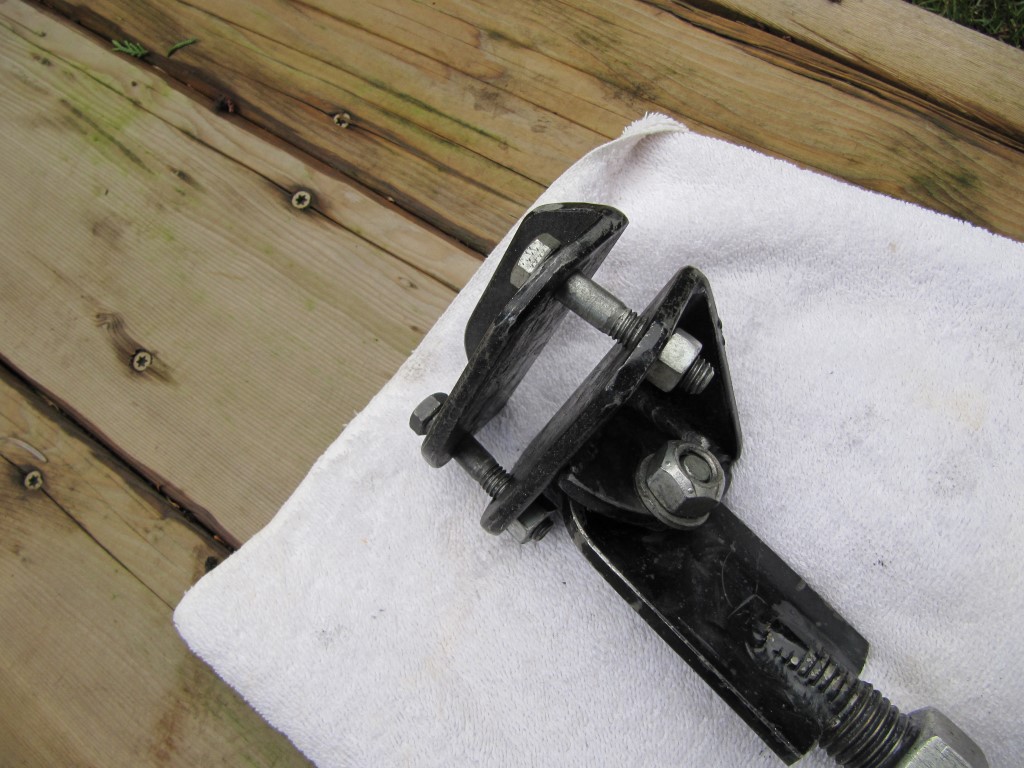

    I saved the three pictures in case I needed to copy it. I really like how it is bolted to the ends of the spring so it can't slip off. great plan.
  20. I've been asked to post pictures of the end clamps on my spring spreader.
