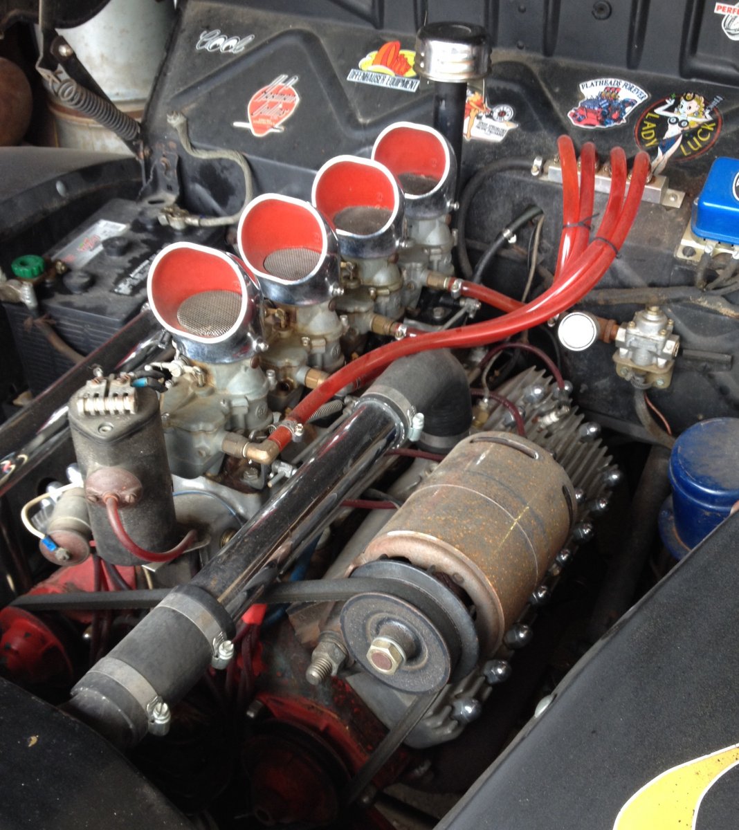

    I am finishing up a Model A roadster that has an 8BA flathead from a 50 Ford. The engine came with some die cast chrome acorn nut covers for the head bolts that were never installed. . They are a rather loose slip fit so I was wondering what others have done to keep them in place. A dab of silicone? Liquid Nails? Any suggestions appreciated. Thanks

    Posts: 8,369
    19Fordy
    Just a dab of silicone works fine. These have been on 20 years.
