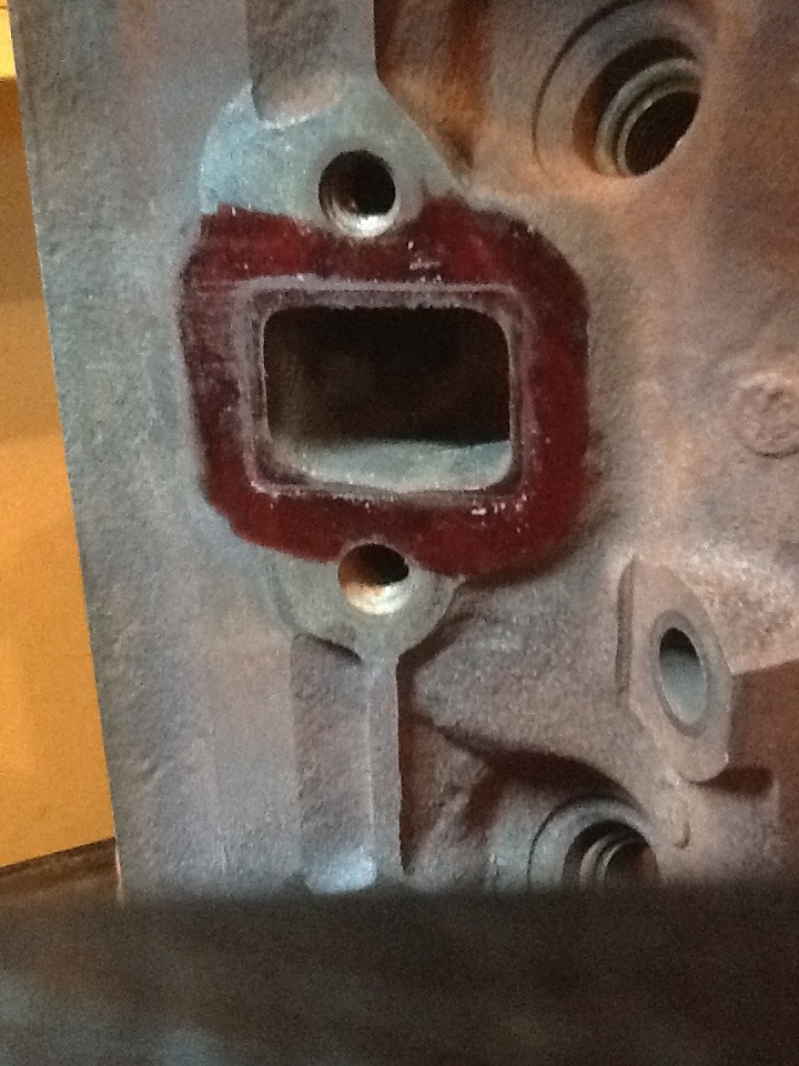

    Then,use your marker or ****m to mark out the face of the the intake and exhaust ports:
    The second picture didn't photograph real well,but you get the idea;the marking dye allows your scribed mark from the inside of the gaskets to be transferred to the face of the cylinder head surface ,providing a guide to shape your ports to....

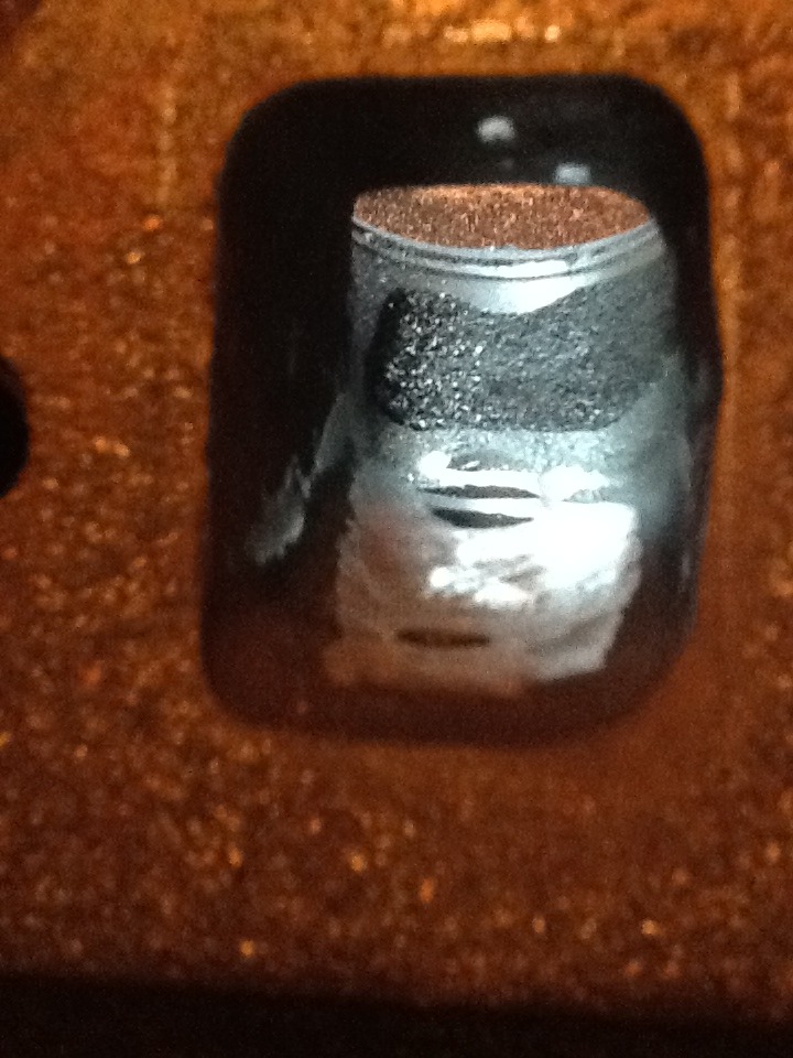

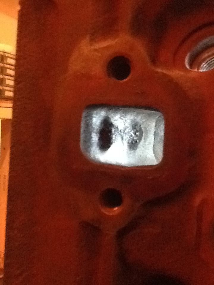

  5. powrshftr
    Joined: Mar 29, 2013
    Posts: 4,710
    powrshftr

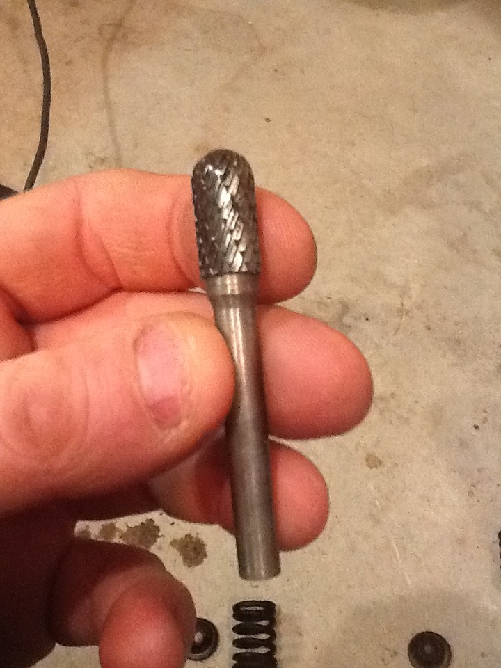

    Then chuck your carbide bit up in the die grinder ( long shank bits will be necessary for some port work,but shorter ones work well for gasket matching and shaping the port mouth,and chamber work).
    Carbides and sanding rolls are available from your local Speed Shop,Summit,Jegs,Speedway.
    Start slow,and use gentle,steady motion on the cutter.Take your time and get the feel for it.
    I like to rough in two sides of the port nice and close to the line,then flip the head over and get the other two sides....
    Posted using two Dixie cups and a medium length piece of string.

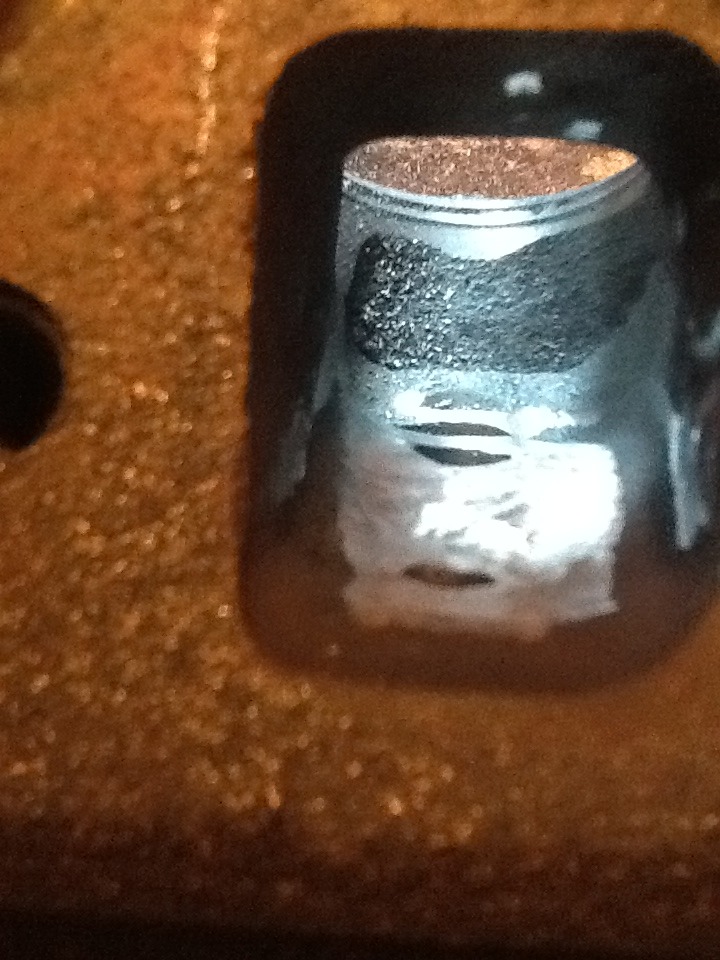

  6. powrshftr
    Posts: 4,710
    powrshftr

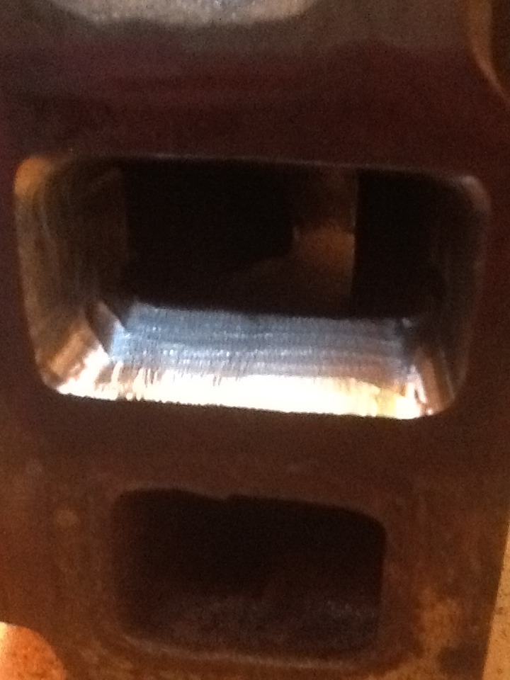

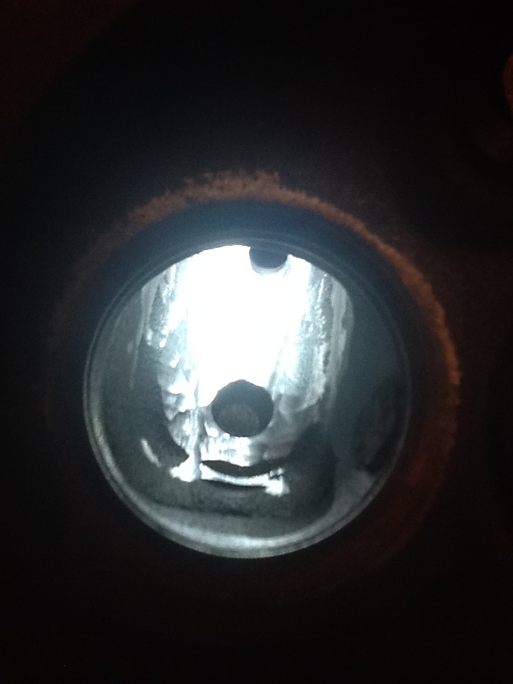

    After roughing in the intake port to match your gasket,taper the shape gently,and not too severely back into the throat of the port.You can pull some material out of the pushrods bulge in the port,but don't get too crazy with it and break through.....
    Then finish your intake port off with a chase with the sanding roll to smooth and contour everything,and set the final shape and contour,and remove any gouges,scratches,or imperfections...
    Keep in mind,all this work was done very quickly in my garage this afternoon,just to rough things in and illustrate some of the methods used,and steps to take.

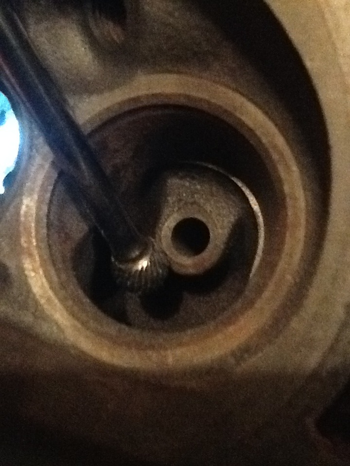

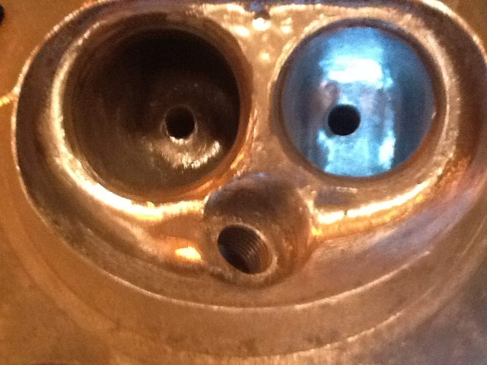

  7. powrshftr
    Posts: 4,710
    powrshftr

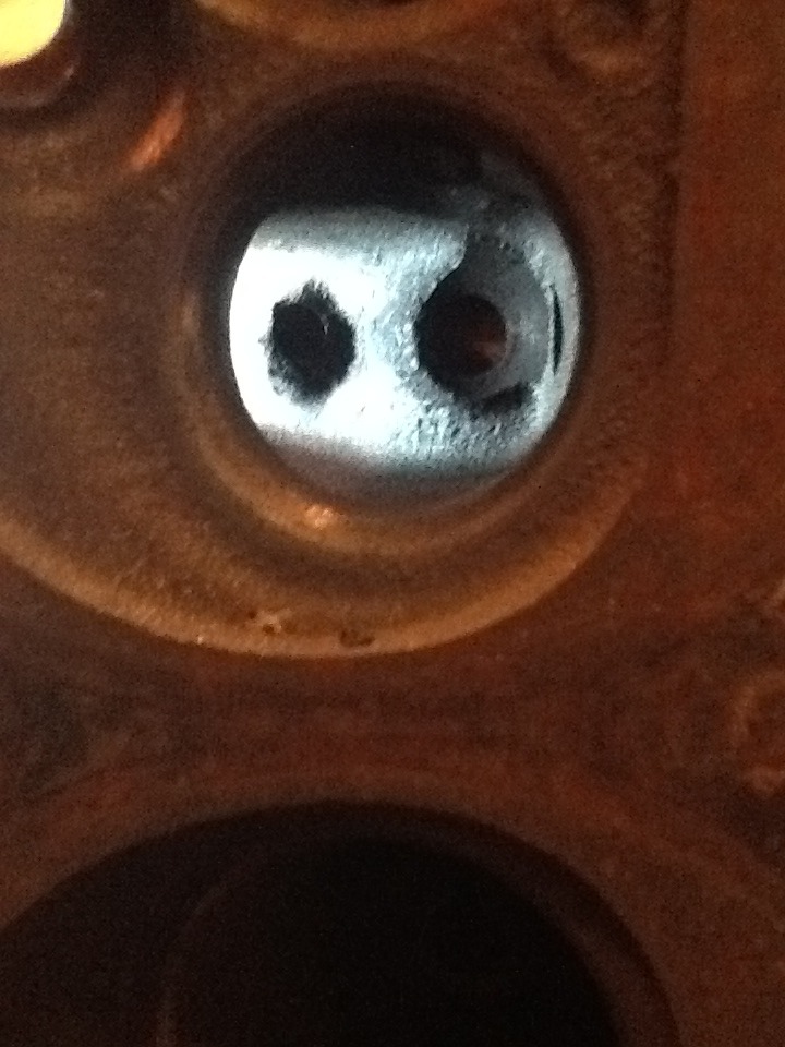

    Then,moving on to the exhaust side,repeat the process.....but on small Fords,the exhaust side is where you really earn your porting stripes...;)
    See those two goofy looking lumps in the exhaust ports?Those are the thermactor bosses (closest to exhaust port)'and the valve guide boss (closest to the combustion chamber).
    The thermactor boss is for the devil emissions control,present in Fords starting around '66 in California...It's a sort of air injection port in the exhaust.Dont look at me,I didn't invent this ****!:)
    The guide boss really serves no purpose in a high performance motor.All it does is choke off the airflow and back up the port.
    Removing it does nothing to harm strength or durability,but everything to improve performance.....
  8. powrshftr
    Posts: 4,710
    powrshftr

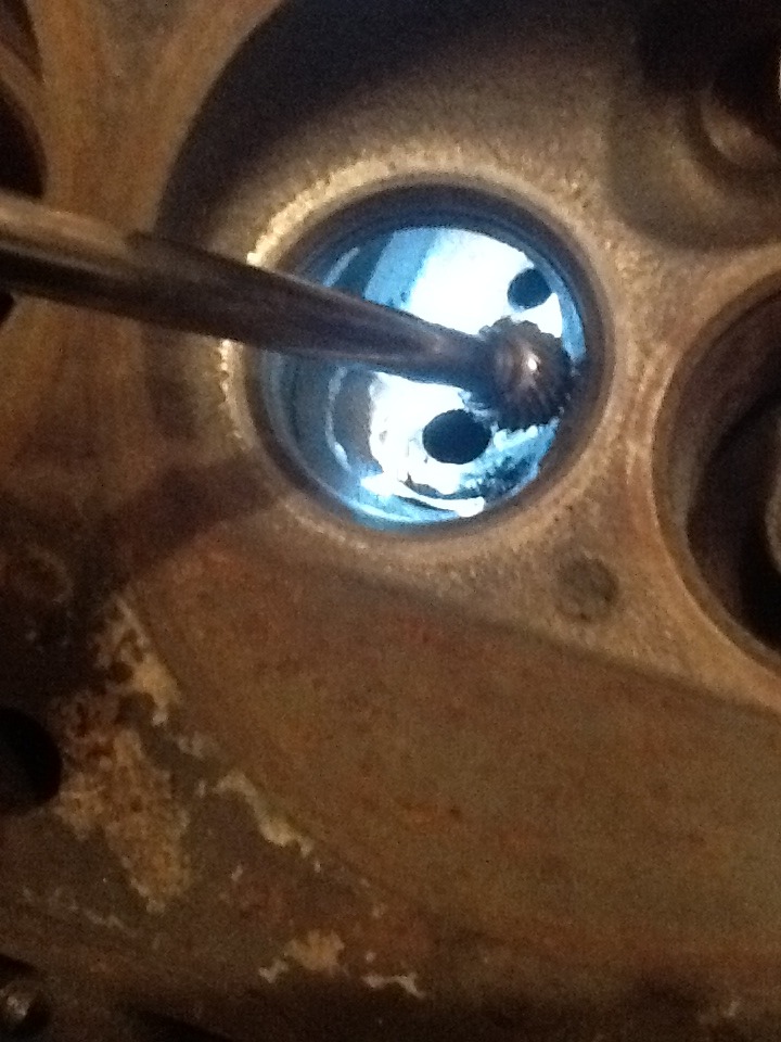

    Start by using your long shank carbide cutter to slowly work the thermactor bump out til the port roof looks something like this:

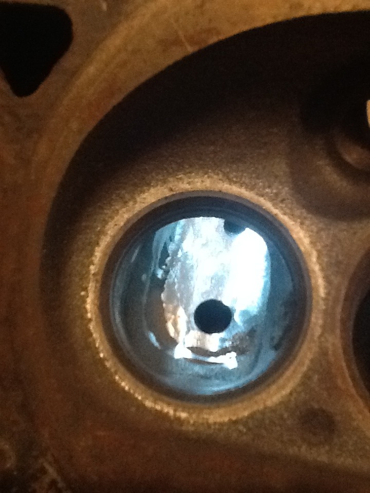

  10. powrshftr
    Posts: 4,710
    powrshftr
    Now we can move to what's called the "bowl" area,directly under the valves.
    We'll start with the intake:

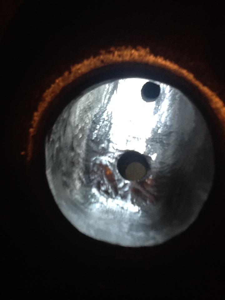

    The valve guide boss on this side doesn't have to be completely removed,but it needs to be pretty drastically streamlined and reduced in size,like this:
    Just take it slow,and just glide the cutter very gently along the edge of the guide boss,slowly tapering and contouring it.I prefer to work one side at a time,but do what is easiest for you.
    This is where having a variety of carbide cutters really pays off:For re shaping of ports,I like a non-tapered,cylindrical,round nose cutter.That makes keeping the walls nice and straight easier.
    However,when contouring the valve guide bosses,a more oblong,narrow oval shaped bit is useful in getting into tight spots.
    Also,make sure when all the heavy work is done,to smooth it all out,and shine 'er all up with a sanding roll,and don't forget to get the area directly under the valve seat,where that really awkward,rough transition from as-cast to machined meets....just be careful as always to stay away from the valve seats.

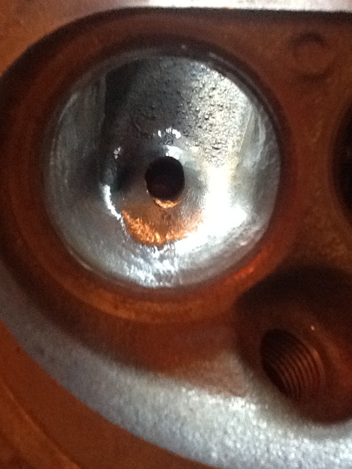

    Here's the transitional area I was talking about:
  12. powrshftr
    Posts: 4,710
    powrshftr

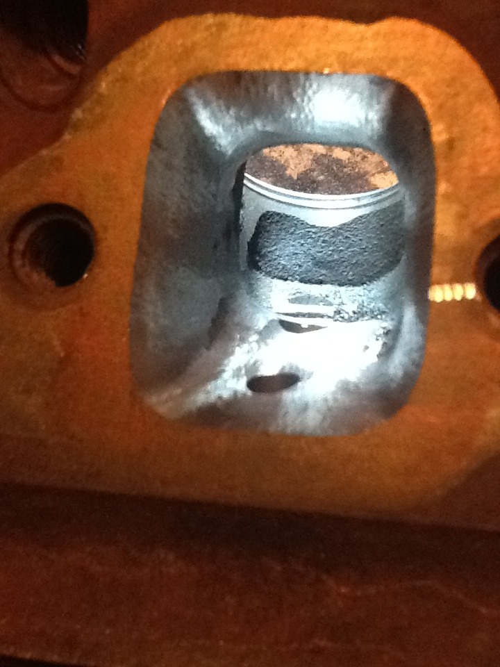

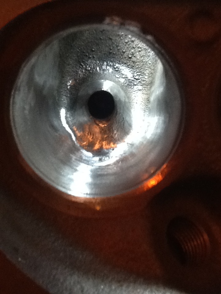

    And on the exhaust side:
    Work the cutter into the bowl area gently and slowly to remove any gouges and ridges,and smooth out all roughness.
    You don't have to take tons of material off,just make everything look more like the guy who designed the heads intended:No sharp edges,rough,casting lines,awkward corners to turn.
    Instead it should be a smooth,flowing form from beginning to end,with some attention paid to slightly smoothing and reducing the angularity as the air and fuel has to turn the corner in the port.
    This is what's known as working the "short side",or optimizing the "short turn radius".

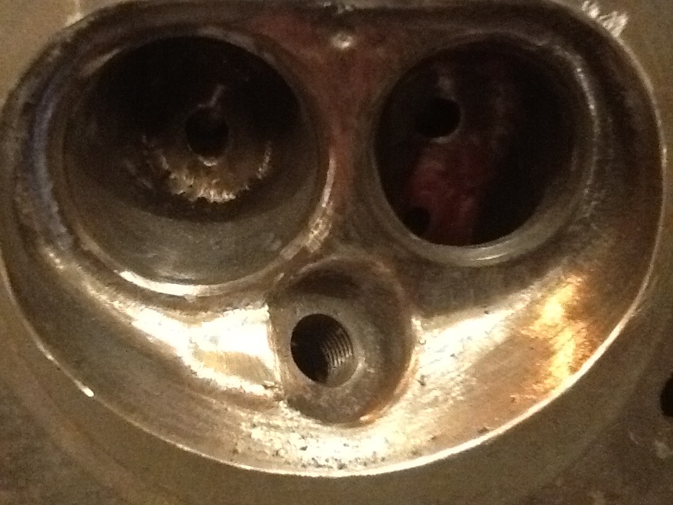

    Finally,you can find a few more advanced horsepower in the combustion chamber if you get into larger valve sizes,by laying back the chamber walls to unshroud the valves,but I won't get into this.
    Instead,I'll keep it fairly basic,starting with just cleaning up rough machine work around the valves:
    Careful,gentle application of the cutter here will buy you a bit of airflow just through smoothing things out so they play nice with the airflow.
    Also,I was always taught by my crusty old porting mentor guy to smooth out the sharp edges in the chamber:
    Just knocking the edge off VERY gently with a carbide bit and following up with a sanding roll will do it.
    Finally,I give the chamber the once over with the carbide bit very gently to remove any casting boogers,then polish it up real nice with a sanding roll,and call it a day.:)
