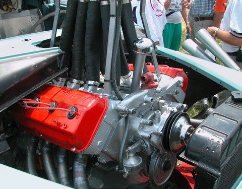

    Interesting that you brought up the Ramchargers Altered. They based their megaphone individual pipe exhaust on some English motorcycle technology (Norton maybe, but I'd have to check). Anyway, I always wondered what the car would have done with a 4 into 1 collector system.

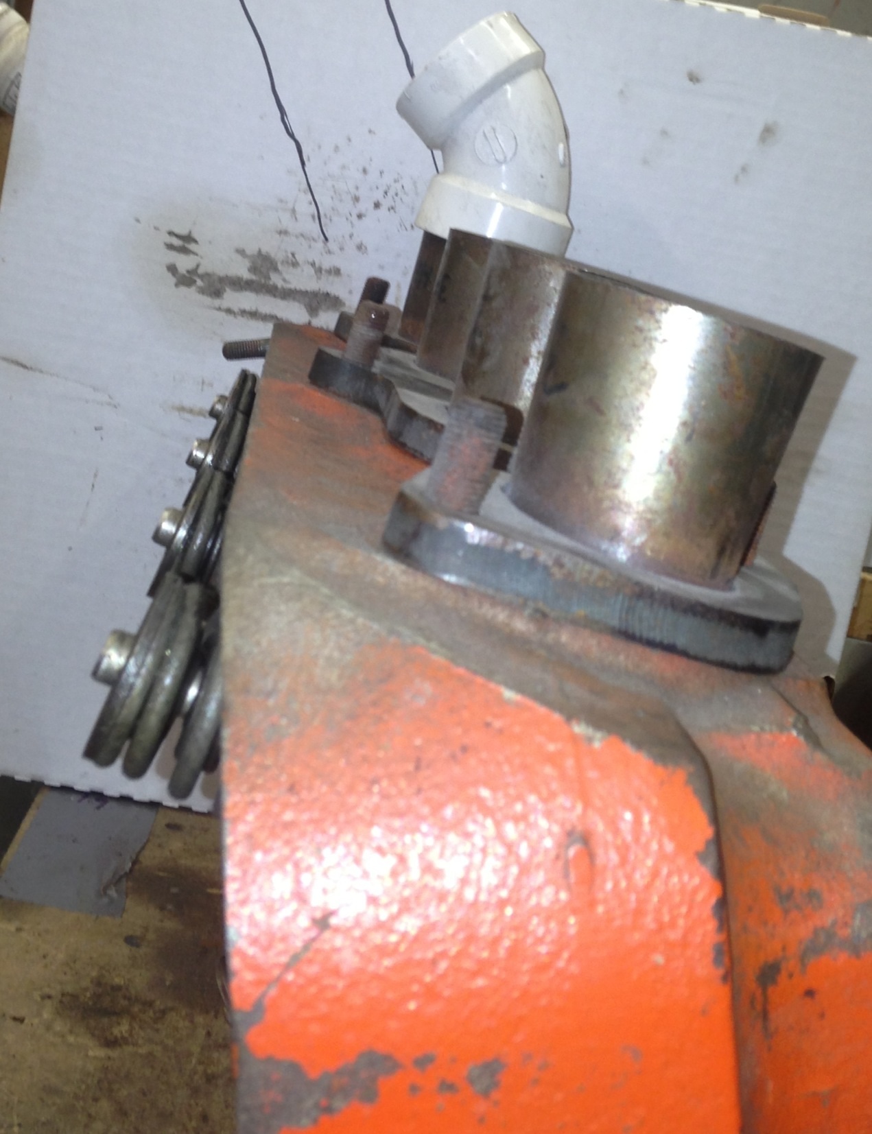

  12. Bear with me- this one pic per post ****s.
    Ok here's the high and mighty.
    Note the pipes are angle cut to meet the head.

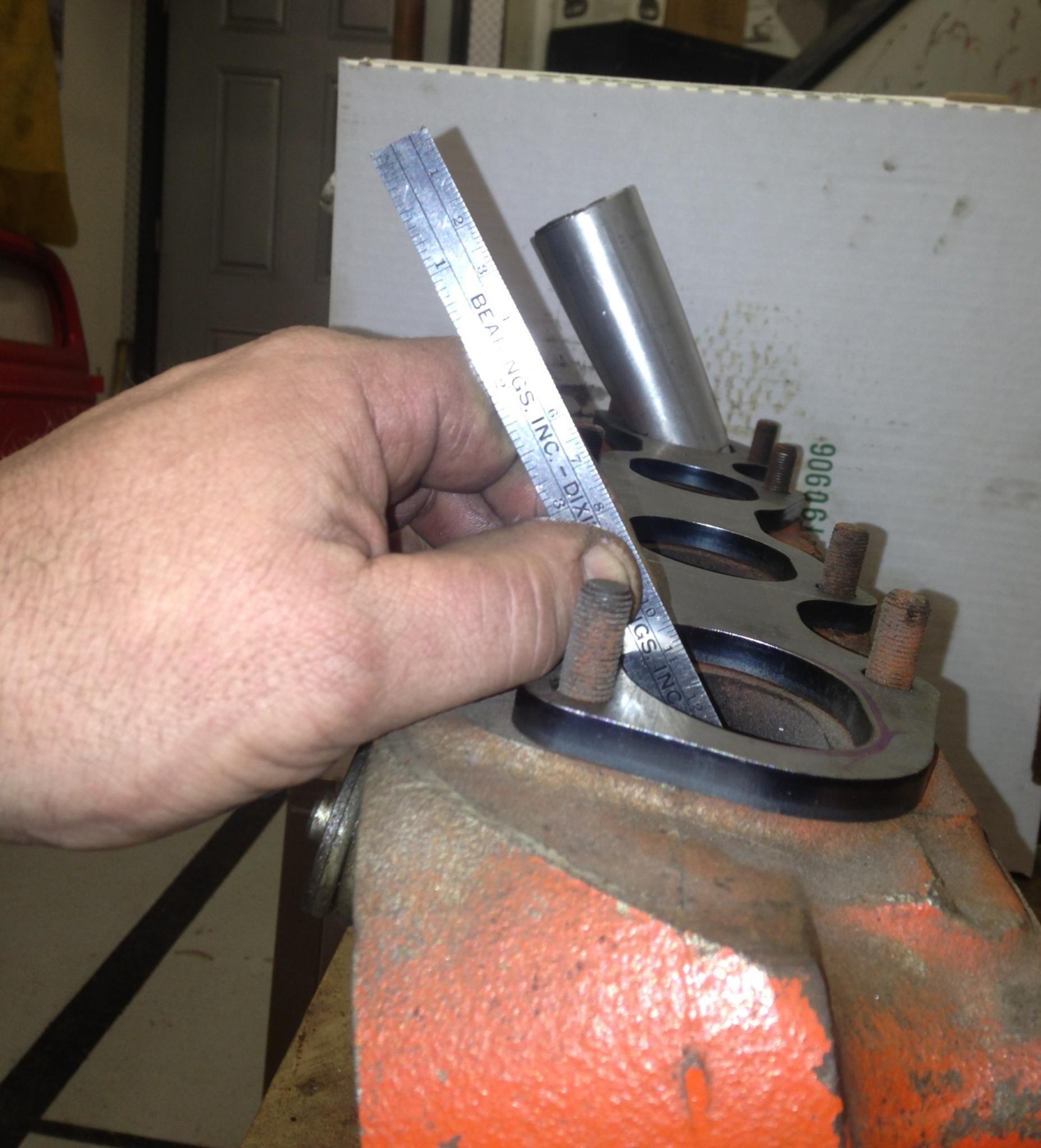

  15. The ruler is at the angle of the exhaust port roof.
    The pipe in the background is angle cut to match that angle.
    Pretty straight shot out of the port then off to a long radius gradual elbow.
    BTW its not easy ovaling the pipe, cutting it at the angle. Every time you adjust everything else gets out of wack. It's a pita and easy to see why it's not done. The straight take offs are a walk in the park.

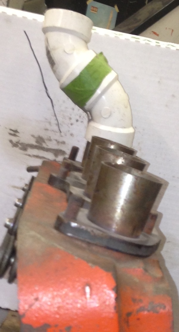

  16. Here's the straight takeoffs.
    The black lines on the background are the out line of the angle cut pipe in the previous pic.
    Then the elbow should be closer to 90* ( didnt have one) to get the pipe over to the black lines. It needs to be to those black lines or the header pipe hits the frame.
    It just looks like pure torture on the exhaust flow.

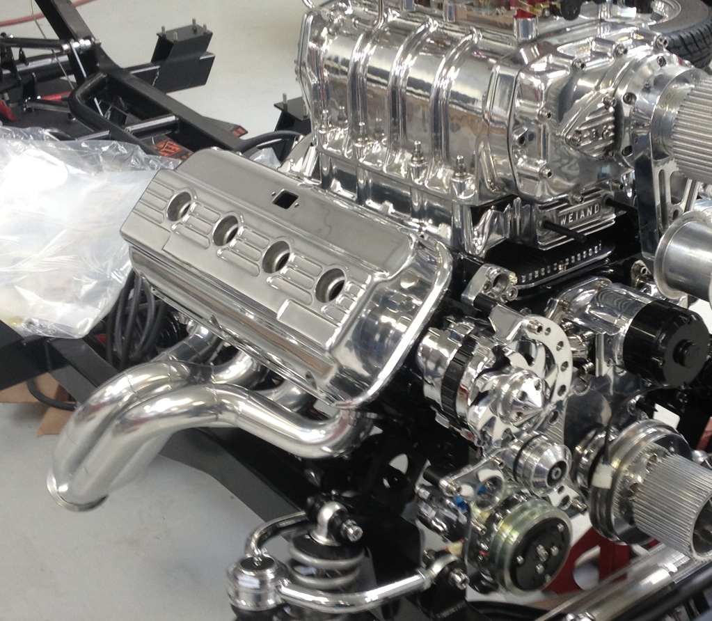

  17. Ha, I'd have a few more elbows.
    Almost every set of hemi headers I've ever seen have been like this.

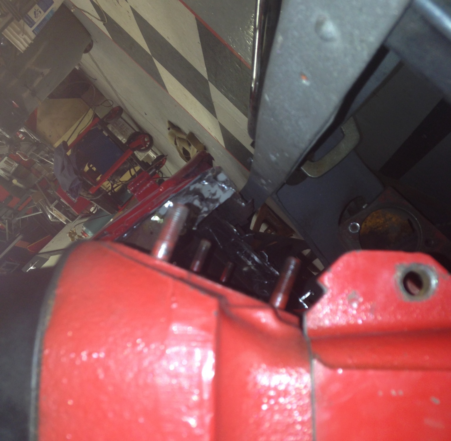

  18. Try not to get dizzy, but I though it would be helpful to see the frame dodge with the head orientated the same way as above.
  19. The reason I'm asking is most of the primary sizing and cam testing is done with that goofy *** jog in the headers. To me its way beyond stupid. The primaries are over sized to compensate ? I think so any way ?
    Now if I decide to screw around with the exit path, how is that going to change my other variables that there's decades and big dollars in R&D. ?
    Just for reference, I can oval 4 straight pipes and fit and weld the 8 elbows for one head quicker than getting 1 angle cut pipe to fit correctly.
