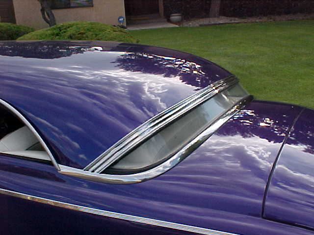

    Looking for some help on this one,...Lexan/plastic doghouse...
    Is there anybody in the Northwest that can bend Lexan/plastic to
    make this doghouse identicle to pictures posted below ????
    No I dont have a break,..nor do I know anybody with one...I read the previous posts and looks extremley simple to do by the testimonials from
    guys who have done it,..this is for the Veneys Vega,..would need done almost ASAP...Please call or email any info,..very appreciated

    Use a table saw to cut it down, clamp it between 2 2x4s and use a heat gun or a blow drier to make the bends.
