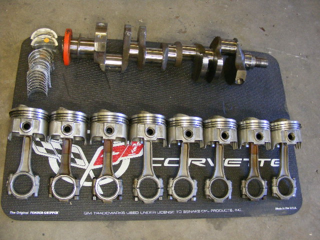

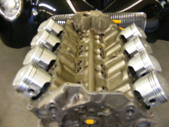

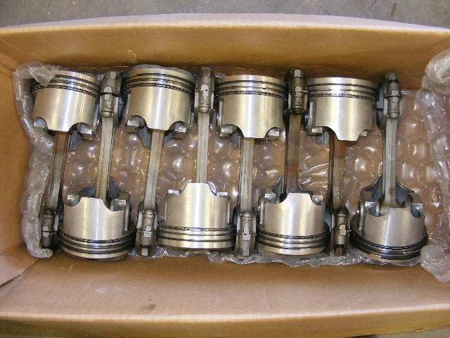

    DSCF6861.JPG DSCF6864.JPG DSCF6866.JPG DSCF6875.JPG All you need to build a 301-302 short block, minus cam and cam bearings!
    All just posted in the HAMB cl***ifieds.............................................
