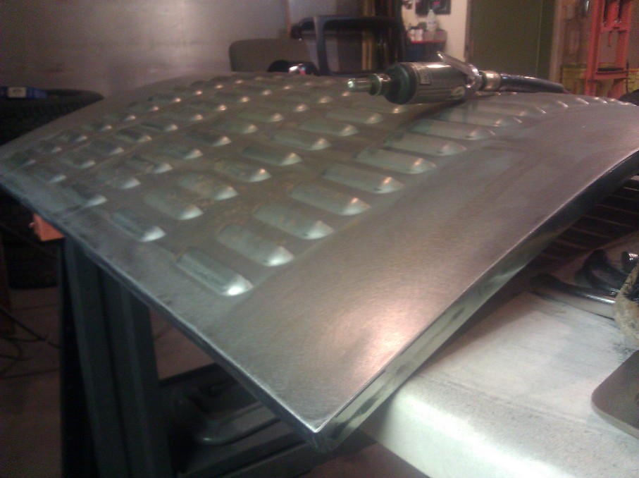

    I started with a 20 gauge louvered steel panel. I bought this on ebay for around $125. It was the width and length of the Model A opening plus a few inches extra on each side. If you know of someone who can louver, have a sheet cut out and punched to your desired pattern. You can also use plain sheet metal if you don’t want the louvers.
    Here's a similar one:

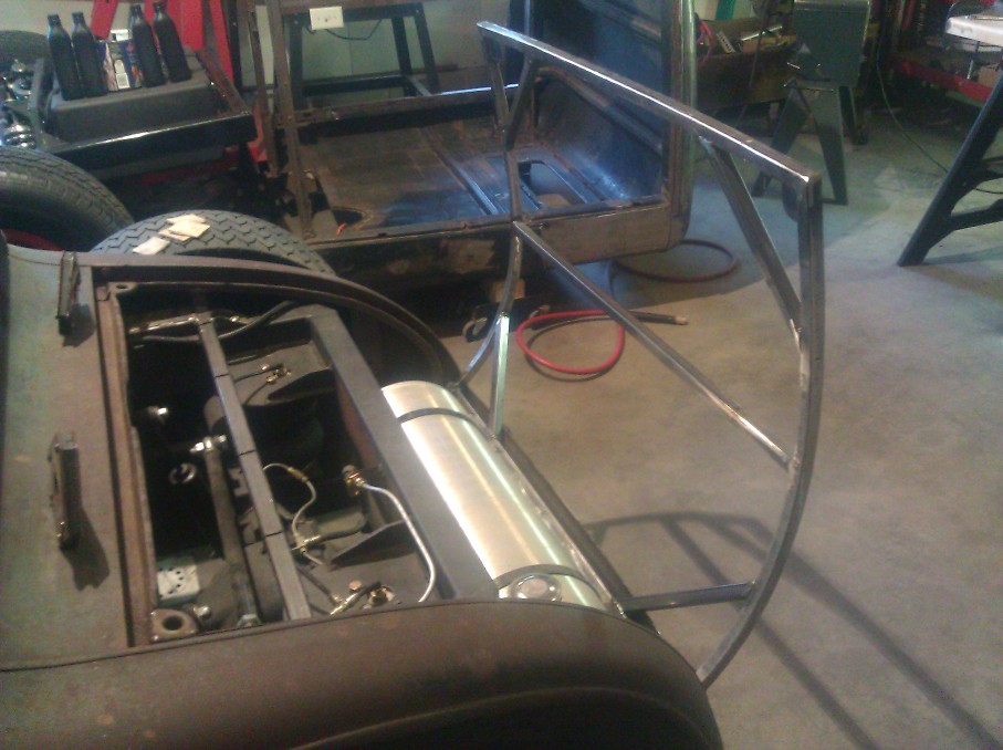

    Next I measured the opening along all of the edges (across the top, across the bottom, and along the curve on the sides). I bought enough ¾” X ¾” X 16GA square steel tubing to go all the way around with enough extra to go across once and for the corner braces. I had an old bear claw latch lying around along with a 1937 Ford V8 trunk handle. The only other things I had to purchase were the cable and clamps for the latch.
    To get started, I cut the top and bottom tubing to length leaving 3/16” clearance on each end. This will allow for your gap between the trunk lid and body. Next miter each end at 45 degrees. I used a cut off wheel to cut through 3 sides of the tubing so it could be easily bent to fit the slight curve of the body. There are 7 slices in each. Once I could bend the tube to match the body shape as close as I could, I clamped them to the opening and tacked the cuts back together.
