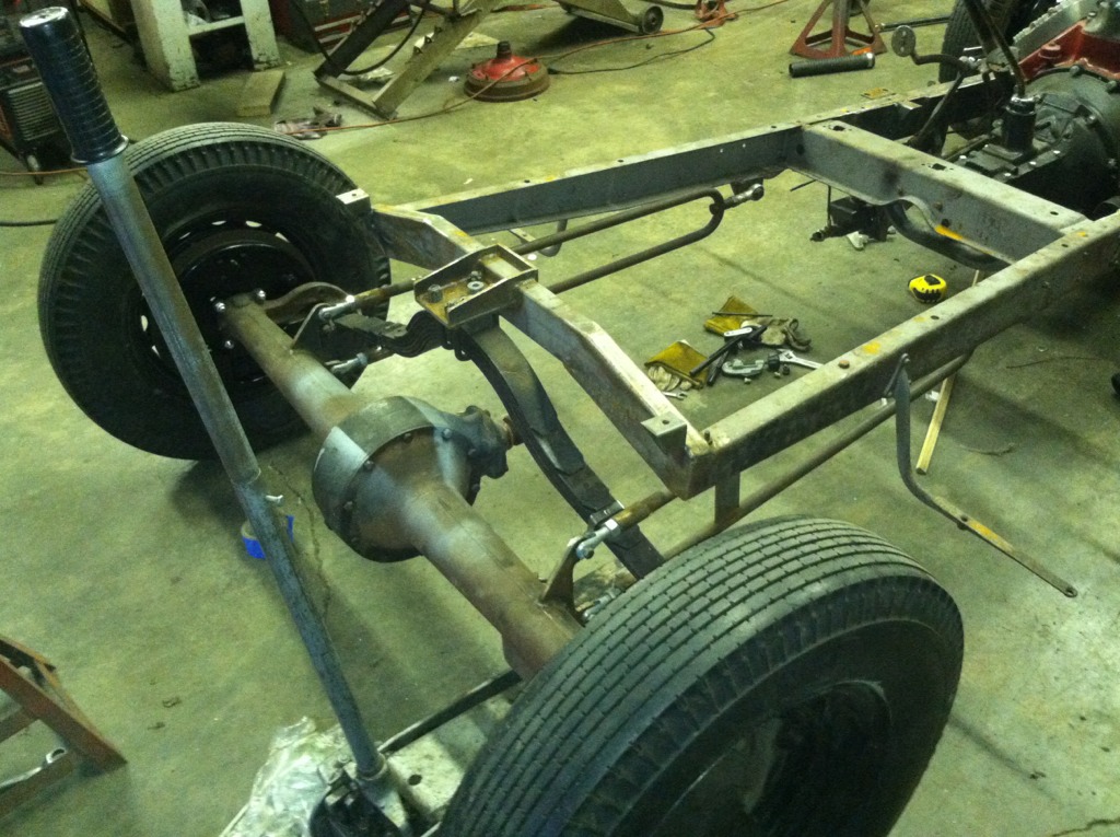

    Here is how I did my a frame. Kept the stock a crossmember in place.
