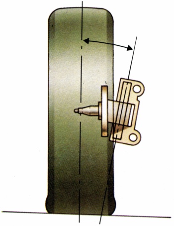

    Brian, perhaps I do overthink things, but just to be sure I asked my question properly I found this drawing on the net. From what I've heard, the ideal king pin angle is one where the line drawn downward thru the king pin intersects the tire patch in the center of the tire's tread. In the case of this image, it doesn't hit center, but falls to the inside. So... I've been thinking that when you change tire diameters / offsets, you can't help but move that point left / right or perhaps even above below ground. That's my worry, that when this idea relationship is changed, you may drastically (again overacting) change the handling from over to under steer, for example. Gary

  4. gnichols

    Gary,
    What you're describing is scrub radius. That's the distance between the king pin (steering) axis and the center of the tire contact patch.
    In case you're still pondering this, a simple rule of thumb is to simply keep that theoretical point inside the tire contact patch and the car should be drivable with no major issues. While zero scrub (contact patch centered on pivot) seems like the ideal, it often isn't.
    For example, you may want to minimize the difference that tire pressure or braking will cause the car to pull in one direction or the other. Or maybe you want loaded suspension bushings to give predictable handling results like stiffer bushings while still being compliant. Moving them apart allows the tire to load the suspension leading to more predictable handling events on soft bushings. A positive scrub with the tire outboard as in your picture will steer easier because the tire will roll around the king pin axis as the wheel is turned (if the brakes aren't applied).
    There are lots of reasons (compromises) that a suspension engineer will select a tire/wheel combo that is offset from that point. But in general, just keep it inside the contact patch and you should be ok.

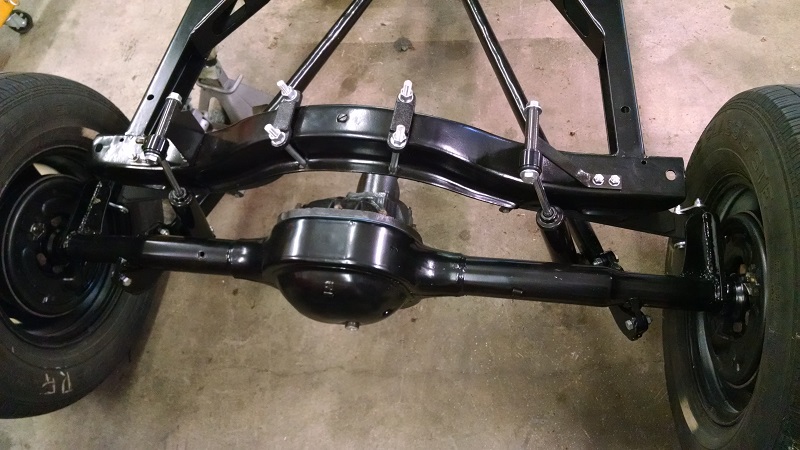

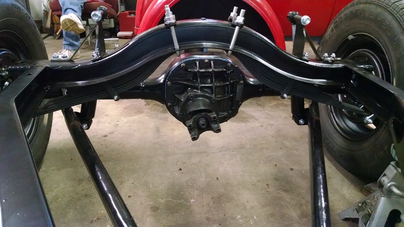

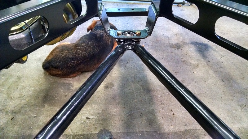

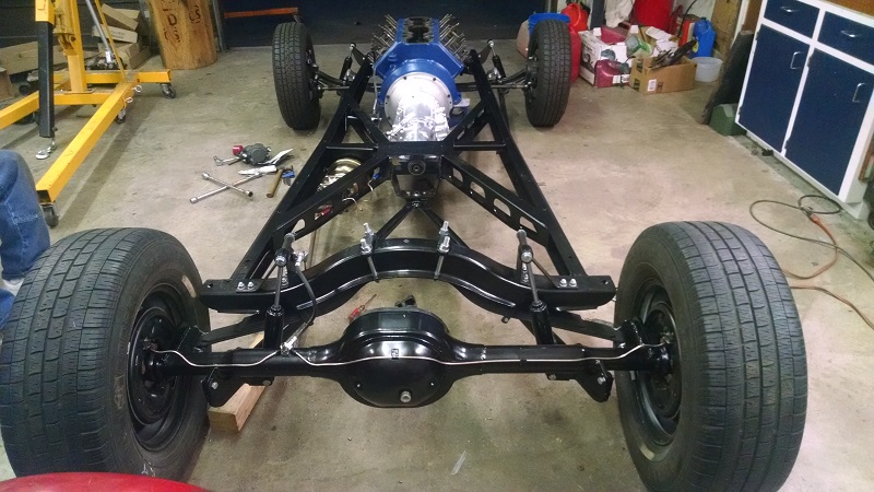

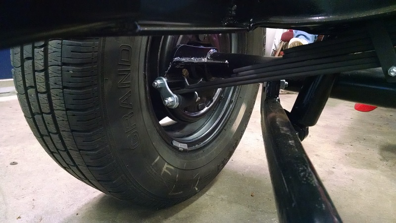

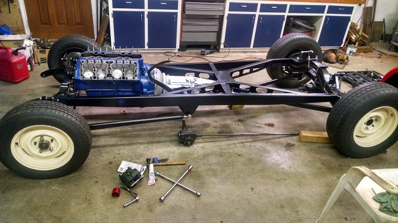

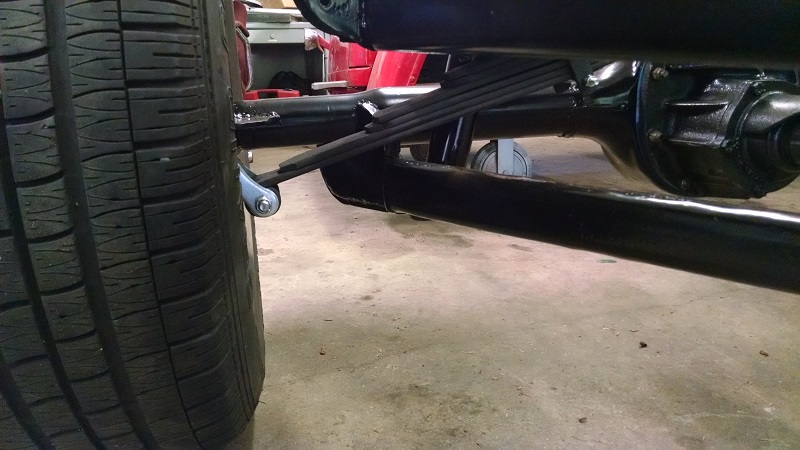

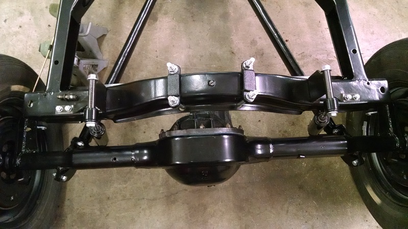

    I want to thank you brianangus for all the efforts you put into this thread. Here is one I am working on now that uses the spring in front on a model A in the rear. It has an 8" Ford rear out of a Mustang with a stock A rear cross member moved ahead 8" and a T rear spring. I used a set of 37 front bones with a 1/4" flat bar welded in the middle of the tubes vertically. To attach it to the axle I made a set up like a 35-36 rear axle has. To attach the rear spring to the axle I used a kit for mounting the spring behind but swapped it to the front of the axle.
    The shocks have a double sheer bracket welded to the bones on the bottom and some mounts bolted to the top of the cross member. The shocks were a tight fit and the flange of the A cross member had to be heated and bent down for clearance. I used a model A front bone capture mounted to a small cross member directly below the front u-joint to hold the 37 ball socket. This gave the suspension the design that alleviated any binding that splitting the bones does. Here are some pictures of the set up. The frame is from Dagel's and has their x-member in it. IMG_20150921_181654954.jpg IMG_20150921_181708850.jpg IMG_20150921_181716027.jpg IMG_20150921_181723353.jpg IMG_20150921_181737846.jpg IMG_20150921_181745122_HDR.jpg IMG_20151001_191302539_HDR.jpg IMG_20151001_191328352.jpg

    Nice work 55Willys, this design has inspired some thoughts for my next project, helps keep it low and no bottoming out of rear suspension.
