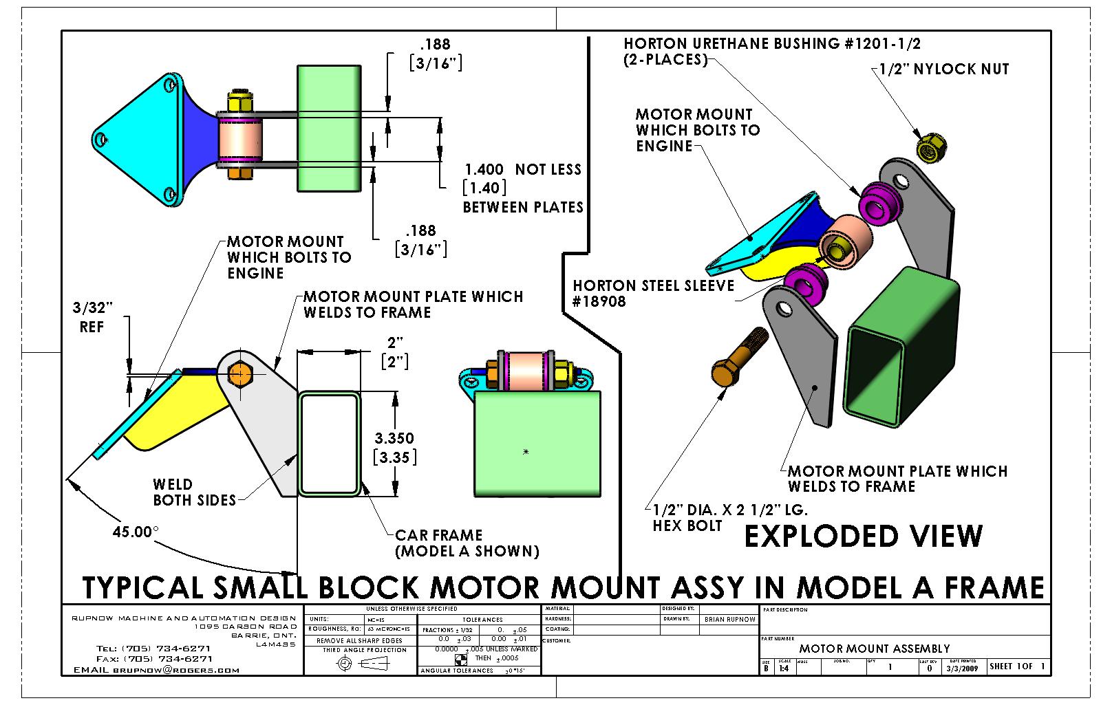

  7. Its been a while since I posted anything in this thread, but tonight when I was answering someones question elsewhere, my answer seemed worthy enough to post. Its about what to use for isolation bushings when building engine mounts.

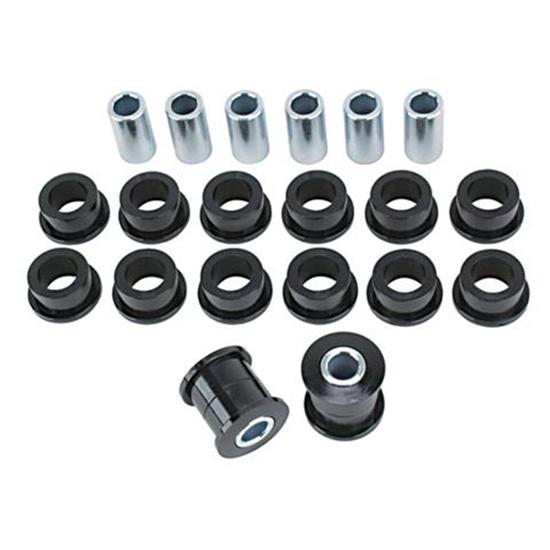

    I buy mine from Horton in Milton, and I think he gets then from Pete and Jakes. They are urethane 4 link bushings. They work really well for motor mounts and 4 links, but I will give you a word of warning. You absolutely can not "dummy up" mounts to tack them together with those bushings in place, then remove the engine and bushings to finish up welding. Those damn urethane bushings melt if you even breathe on them. They stand up fine to general engine heat, but they sure don't like heat from even short tack welds. After ruining enough of them and then having to re-order and wait, I finally turned up a bunch of them on the lathe from cold rolled steel. Now if I am positioning a suspension or a set of motor mounts, I use the steel units I made, tack everything in place, then dis***emble and do the finish welding. The urethane bushings seem to last forever then.

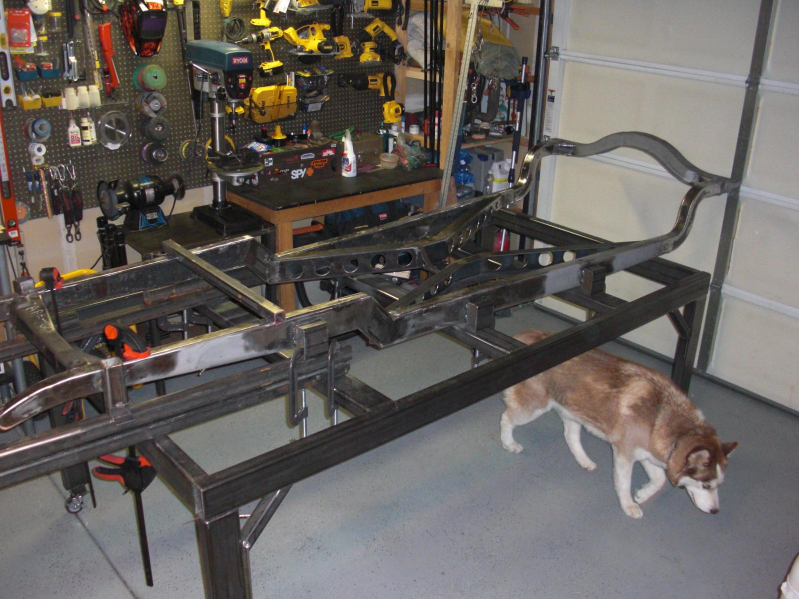

    Thank you for the info on the ladder bar brackets. I have one more question for you. this is my first build and I am trying to figure out the order in which to do things. I read earlier in this post where you were talking about pinion angle and from what I understand you want to get the front end ***embled and put the rear end under the car with the spring that you are using and compress the spring by getting some fat chicks to sit on it then you can figure out what angle to put your ladder bar brackets on the axle so that they will line up with whatever front mounts you are using. If that is correct, then the question I have is how exactly to mount the spring hangars in order to get to this stage. I am using a posies model a style spring and their spring behind hangars that place the spring seven inches center to center from the rear axle. I am also using their rear shocks that will mount between the axle and the spring. Can I just put the rear into a fixture at 3 degrees up and weld the spring hangars in so they are level with the world. Also I have an 8" kick in the rear and 4" in the front would that have any effect on the pinion angle? Thanks again for any help. and here is a picture of my frame as it sits.

  21. Again, you are dealing with the uncertainty of just how much your spring is going to compress between "free" state and after the full weight of the car is setting on it.-Simple answer is to find a friend with a similar size car and the same spring and measure the difference between his spring and yours.---Or you can build some kind of jig to hold the spring securely and preload it to what you THINK the car is going to weigh and see how much it compresses.---Or you just put the rear into a fixture at 3 degrees up and weld the spring hangars in so they are level with the world (Which is what I always do) The ladder bars should have at least one adjustable end on them, so you can tweak the pinion angle after the fact if you need to.. Choices are somewhat infinite here, although its a bit more difficult with a leaf spring than with coil overs. The fact that your frame is kicked up front and rear really has no effect on things.-----Brian
