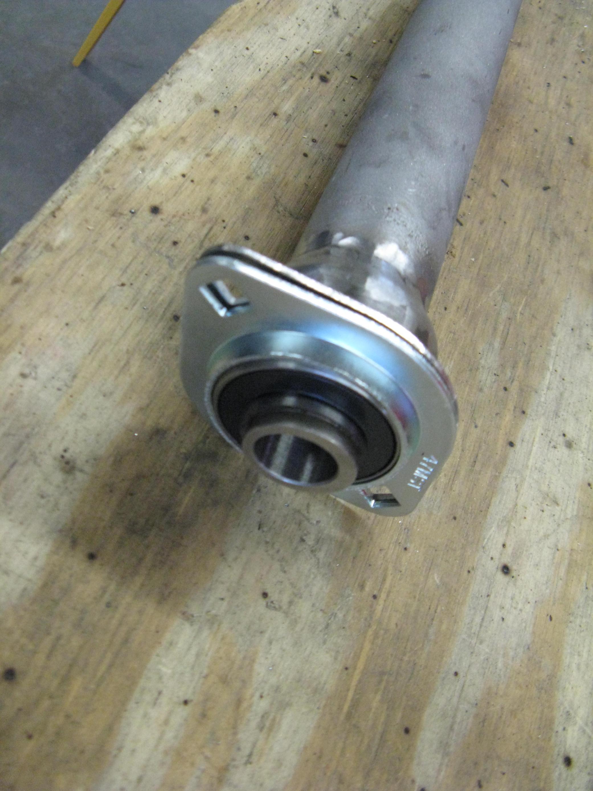

    Step 2 - In order to support the shaft, you must install a bearing in the end of the column. I purchased a 3/4" bearing (P/N HC204-12) and a 2 bolt flangette (P/N 47MSTZP-2) from Tractor Supply.
    In order to adapt it to my 1 1/2" column, I have to make a bell adapter. I used a piece of 2" exhaust pipe 1" long. I put it in my press with a large socket that happened to be perfectly sized and belled one end of it. On the other end, I made a 1/2" cut every 3/8" with my 1/16" cut off disc and hammered those inward to reduce the size.
    From there, I simply tacked everything up and made sure it was square and did a trial fit. After I was sure the length was ok, I welded the adapter to the column and cleaned up the welds.
    Step 3 - In order to get the shaft that I had to work, I had to cut it to the needed length and chuck it up in the lathe and turn the o.d. to fit the bearing.

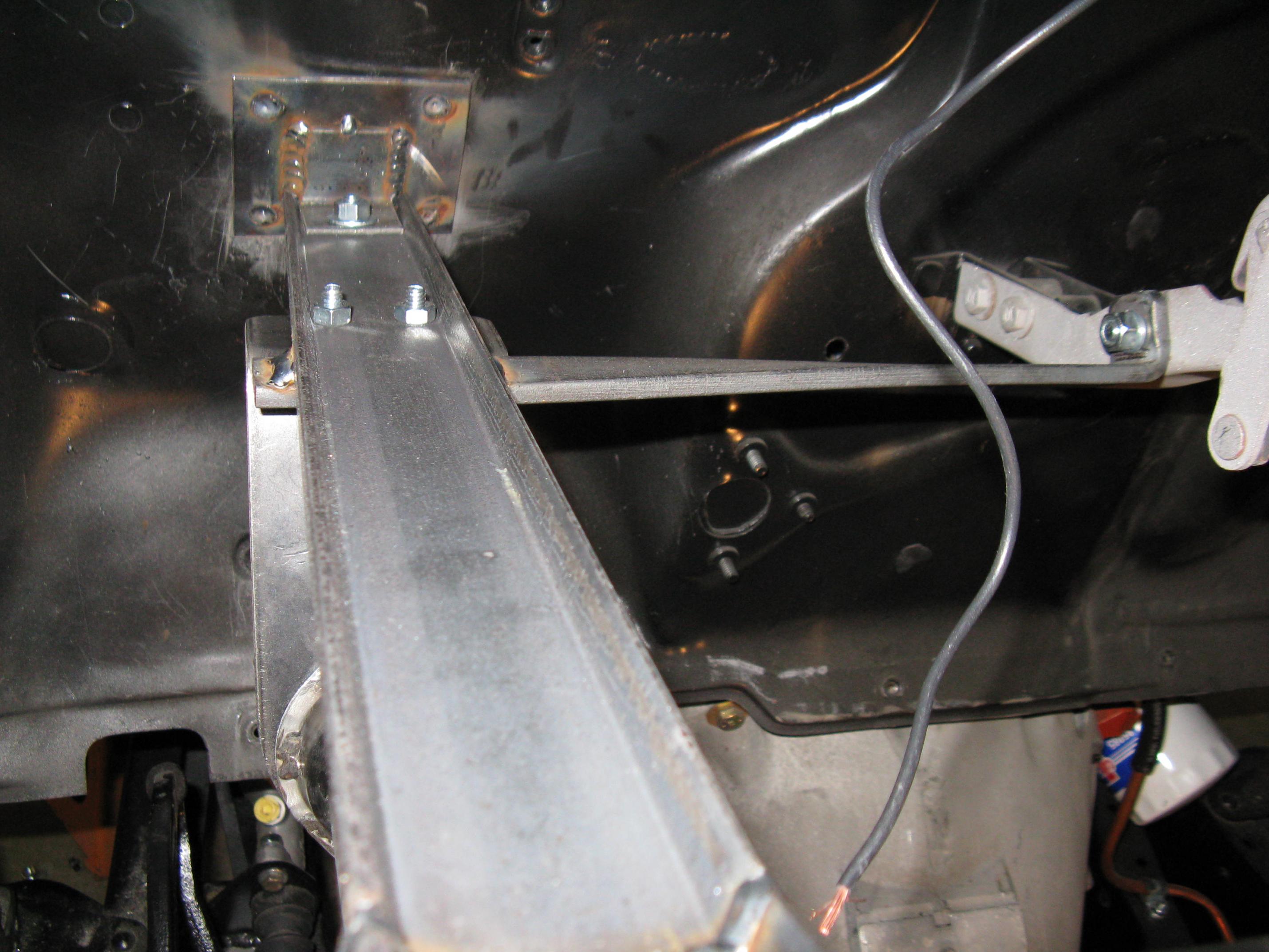

    I ended up with a problem in my install. I could not get the column to connect up with the rack and pinion using two standard 35 degree Borgeson joints. When I tried to use a "double joint" on the rack and pinon, I got into trouble again. There was not enough room between the starter and the frame for my "double joint".
    At this point, I was forced to re-fab my column into a "shorty" style column", which enabled me to reduce the shaft angle from the rack and pinion and get everything hooked up.
    Building the "shorty" column is the same. The problem is that you have to support the end of the column with a bracked that is suspended under the dash and not connected to the floor. This bracked must be sturdy.
    Here is what I ended up with. I fabricated a bracket that used a piece of 2" X 1/8" channel and that extended from the firewall to the dash. This piece also required a piece of 1" X 1/4" flat bar with a twist to steady it. The flat bar was anchored to the center dash support.
    From there, I fabricated a drop of 3" X 1/8" flat bar to support the end of the shaft.
    This made for a very sturdy mount. It also allowed me to use the standard 35 degree joints. I will also fabricate a panel that will have a 3/4" spring loaded lip seal in it to seal the steering shaft where it enters the floor. This will prevent water and ambient air from entering the cab.
    Hope this helps. You should have about all the information you need to do your own conversion. You can also see that it would be pretty easy to build your own column using some 1 1/2" or 1 3/4" tubing. Good Luck!

    Just a note here...anything with a dash should have a bracket in line (above) the steering mast jacket attached to the firewall. It is very effective in solidifying the car's cab structure.

    i don't understand. The channel is in line and above the column. It is attached to the bottom of the dash and the firewall....in line.

    What does the rest of the steering shaft look like - how did you route it down to the box?

    It is the shaft you see in the picture running into a standard Borgeson joint attached to the rack and pinion.
