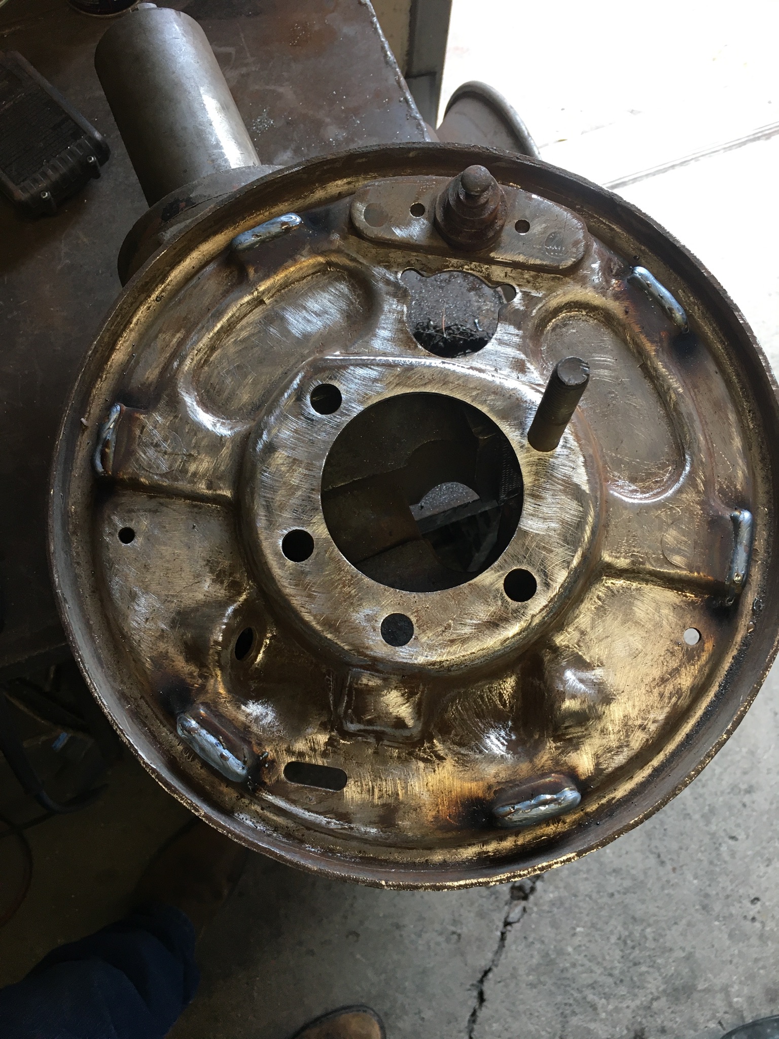

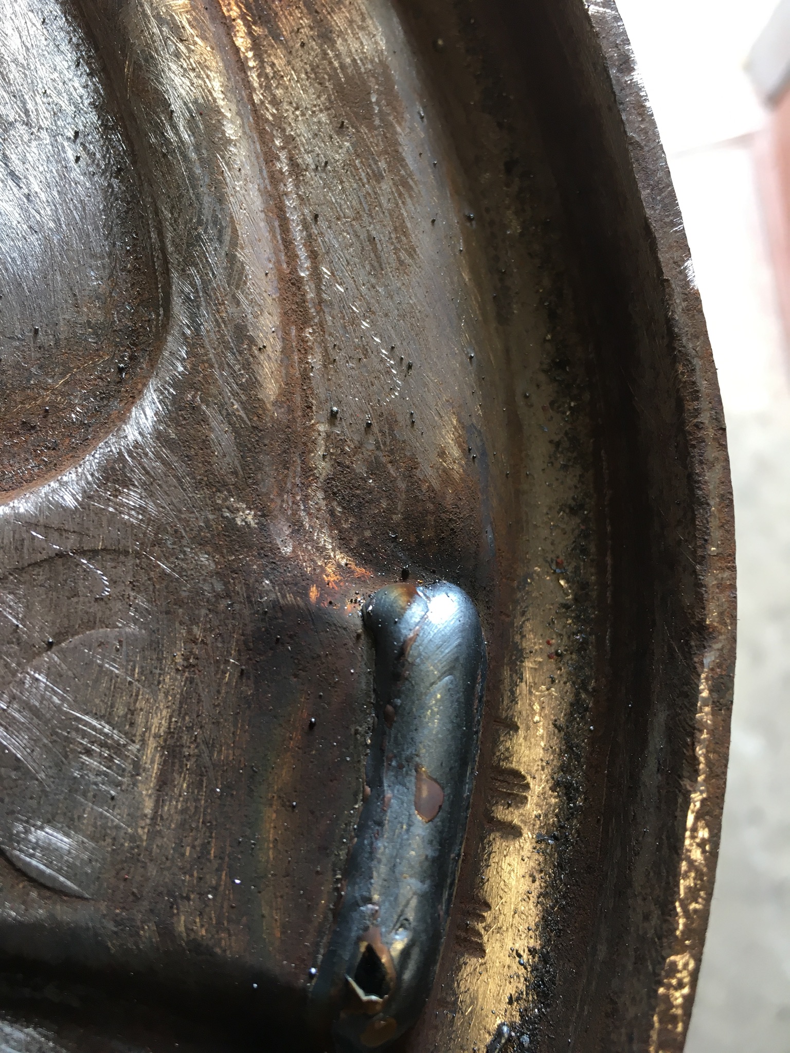

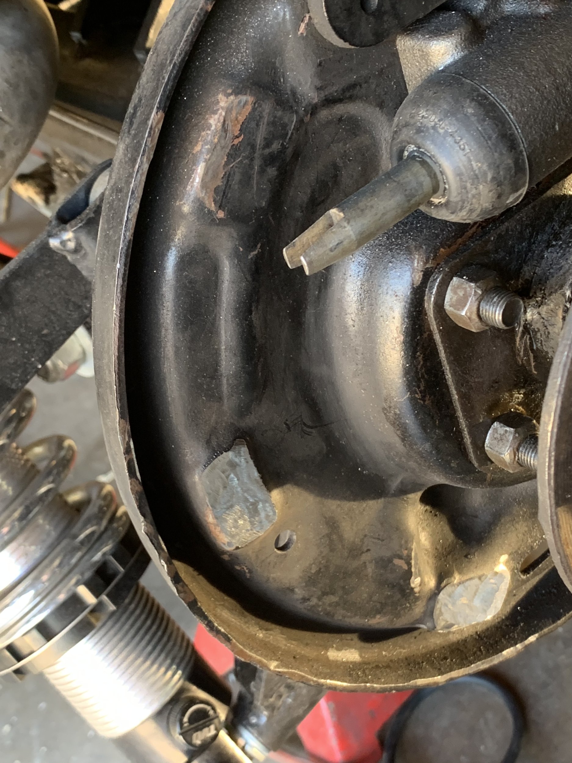

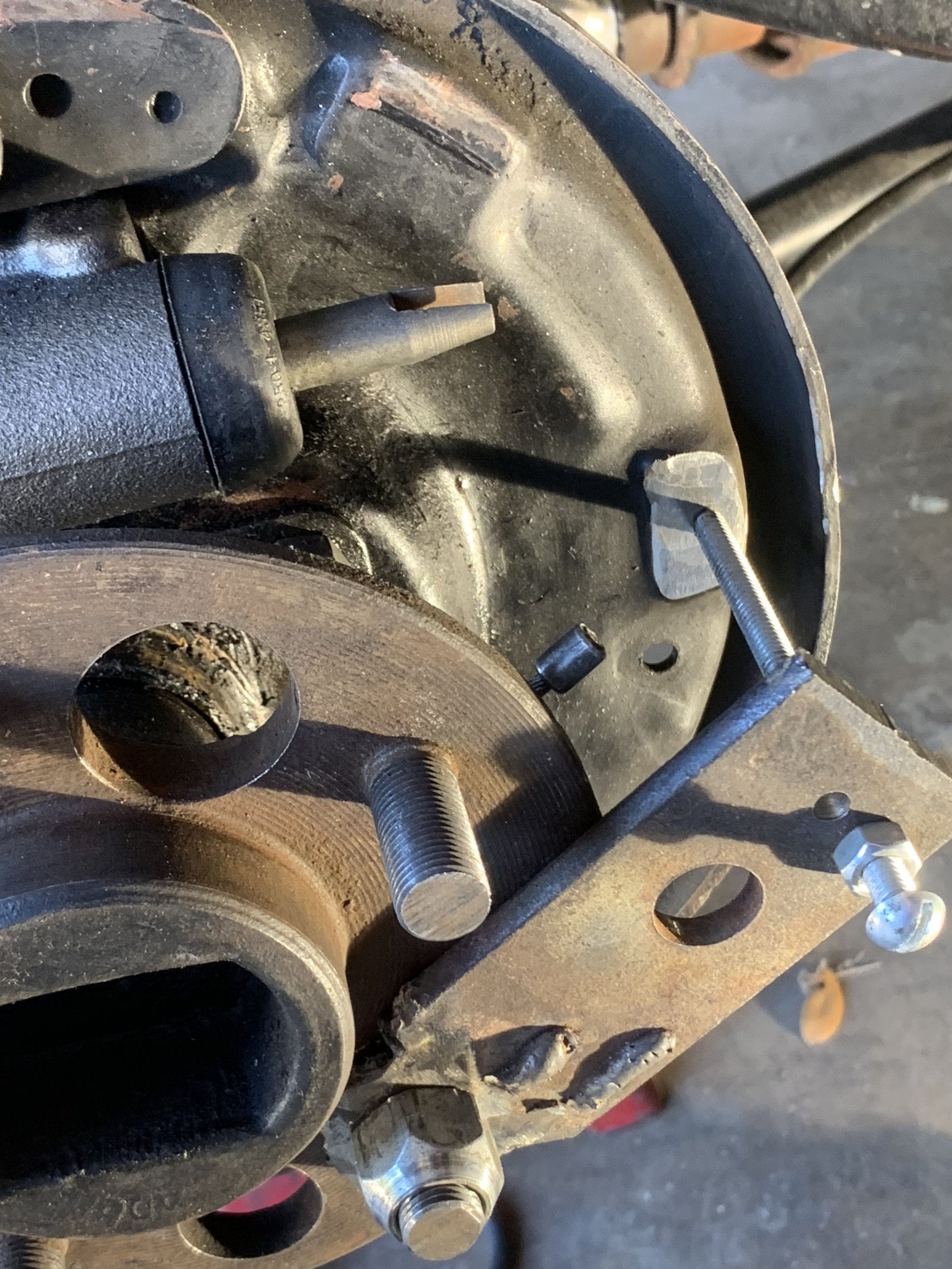

    I while back my roadster needed new brakes. I found that the pads on the backing plates were worn. I figured I would just level them off. How hard could that be? The car would not stop worth a darn. I bought new shoes and drums. I desided to see if the grinding job was accurate It was not. The wear on the shoes gave it away. The wear was slanted.
    I took a piece of s**** and drilled some holes in it so it would fit over a stud and a bolt could go thru on the other end. I swung it around and found the lowest pads and ground the high ones to match. I used a 1/4-20 bolt. A quarter turn moves the bolt is .0125". I found you can judge contact by the sound of the bolt dragging over the pad.
    I checked the shoes and they measured great.
    PS, I used my 4" grinder with a worn down wheel.

    I always welded them back up when they got grooved.

    D583F12C-D962-42DC-BBE6-80A69F8BAA57.jpeg 70096908-C406-4159-9100-C53A31F6E9F3.jpeg You did good Andy. We’ll all use your technique from now on. First p*** on a pair I was working on.
