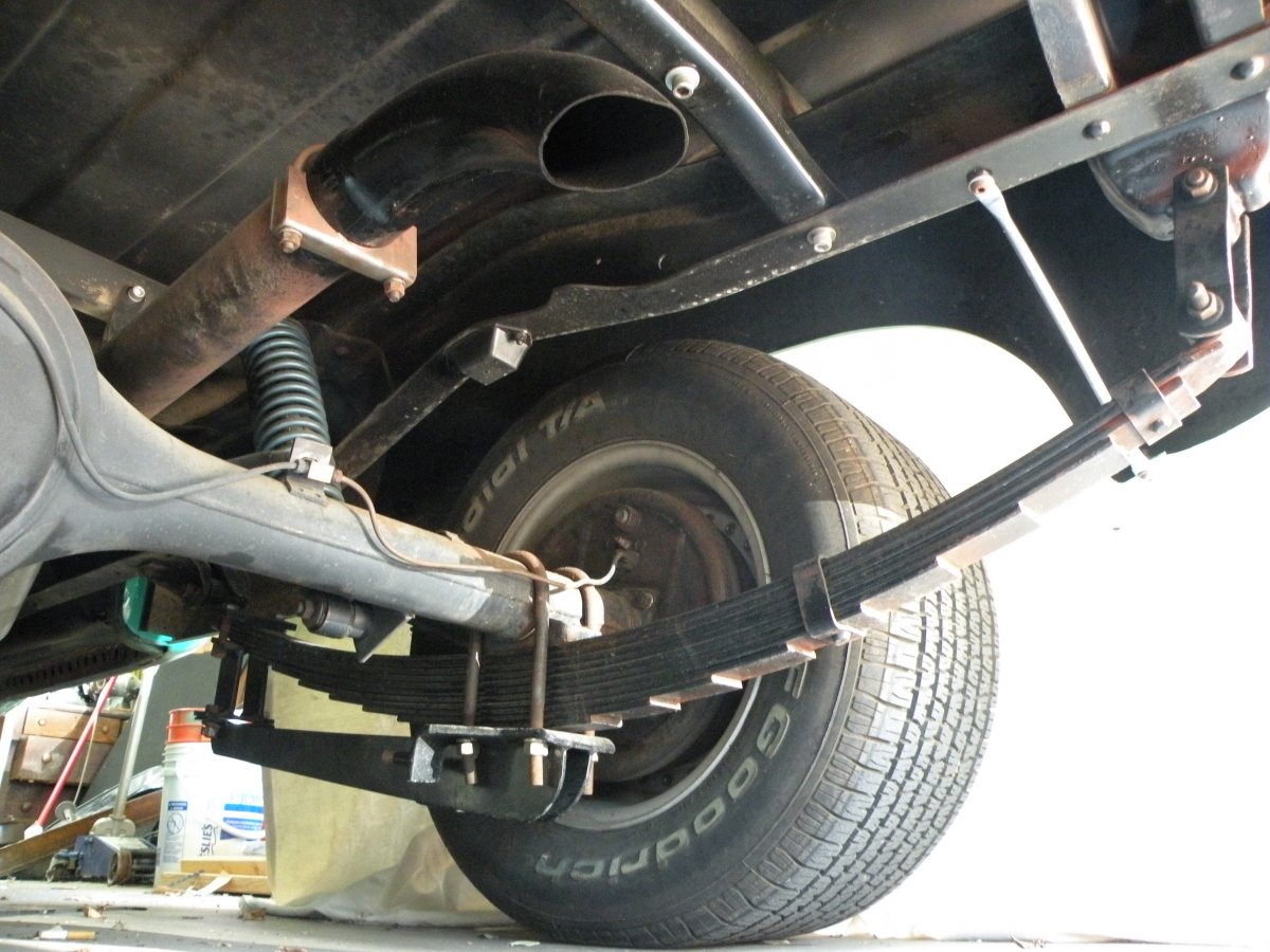

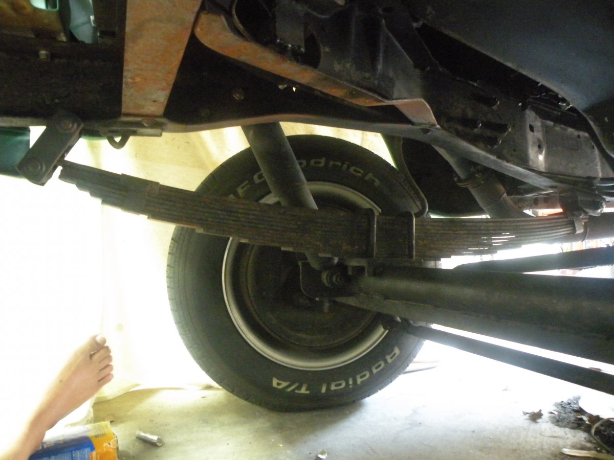

    Actually, it hadn't occurred to me that this could be the original spring setup. Maybe it is, but someone has had their fingers in everything else with this truck, so I'm trying to go through and identify what might be wrong.
    As for the ride, the tires can have a lot to do with it also. The original tires were nearly 32" tall, and the current tires just 25-26" F/R.
    I owned one of these trucks years ago, and remember that the rear springs had several flat leaves at the bottom of the stack. No sign of any of that going on here.

    heh...I stand corrected! yeah, someone added a whole bunch of leaves to those front springs, and the rears are probably 3/4 ton.
    You could probably get rid of a bunch of leaves, and keep the height, and smooth out the ride. If you take out leaves and it does set down too far, visit a spring shop and have them re arch them as needed. They might be able to help you figure out the right amount of leaves for your application, too.
    Play with it, see what happens.

    regarding the stiff ride I did leave a suggestion a couple of days ago about removing leafs. I just saw the photos of your rear setup. There two things that are causing the rear to ride stiff . as I suspected before I saw the photos you have way too many leafs so removing half will help a bunch but that solid clamped ******* traction bar is also stiffening up the ride .that setup will stop the front half of the spring from working so only the rear can move. A ladder bar with a floater will give a way better ride , but that setup must have some type of floater at the front or rear of the bar or else it will be in a bind and again ride stiff and start cracking the housing. This problem is only with a ladder bar -Leaf spring combo due to dissimilar arcs causing a bind. with coilovers there is no bind. you like the truck high so putting the springs on top of the housing will gain back what's lost in height by removing leafs.
