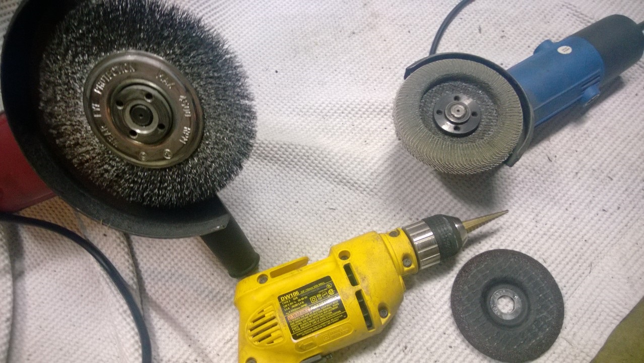

    Tools:
    • Drill with step drill bit
    • Grinder
    • Small cut off wheel
    • Grinding disk
    • Wire wheel

    I attached some pics to help anyone that wants to try this.
