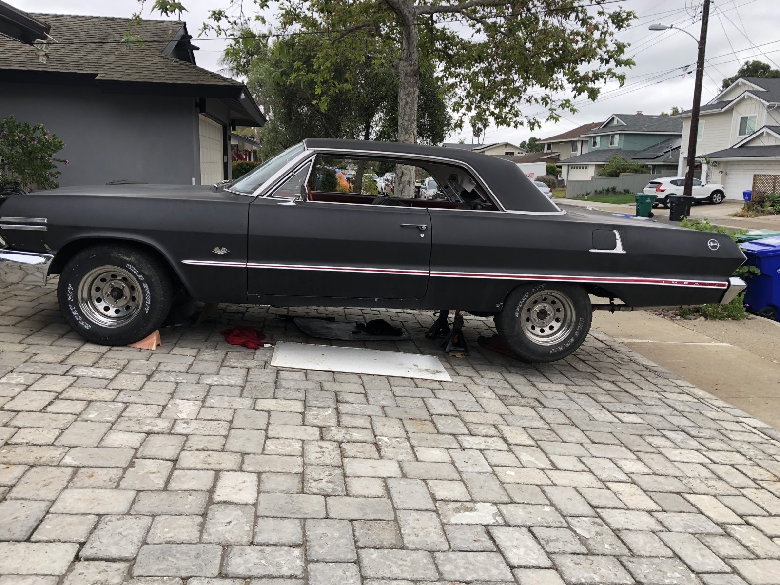

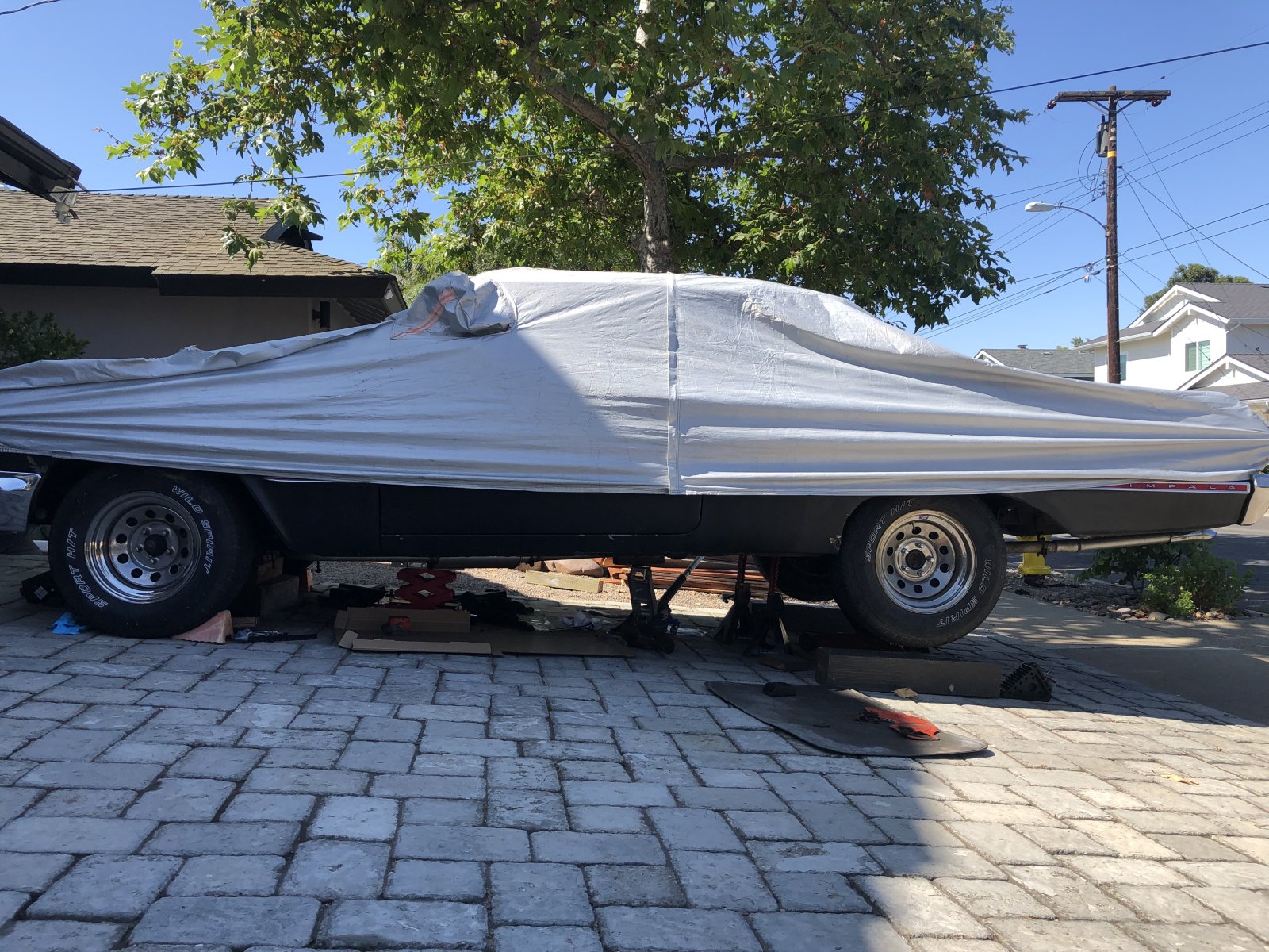

    Yeah I just removed and replaced my 3 speed ****** by myself on a sloped driveway. I know I’m a dumb***. I’ll never do it on a slope ever again. I almost couldn’t it back in. Next time it’ll be on a level surface. This car is just going to be a cruiser, going 12 mi to work 2 days a week and in the future will be the car I teach my son how to drive in.

    Welp..........the sloped driveway makes it easier to remove the ****** because you don't need to jack it up sooo high to drag the ****** out.
    When installing the ******....just turn the car around before you start !! :rolleyes::rolleyes:
