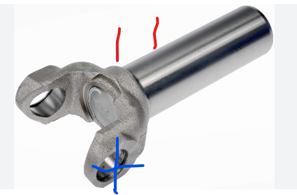

    You'll need a TH350 driveshaft yoke because the spline is different to the old SM318
    once the trans is mounted in place, install the yoke all the way in, then slide it out 1" AND support the rear axle with jack stands under the axle tubes.
    Then bolt the old D/shaft in but leave it hanging down. [this also applies to the front D/shaft of 2 piece types]
    Measure the distance from the centre of the cross in the yoke to the centre of the cross in the rear universal. [or the hanger universal on 2 piece]
    This is the measurement that the Driveshaft shop will need

    Thanks for the great illustration. Is there any thing else that needs fabrication? I saw someone mention flex plate and cross member moving back. Can I use what I have?
