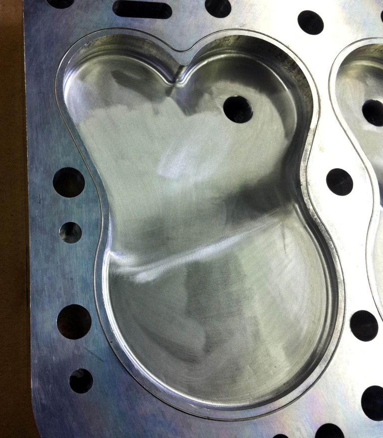

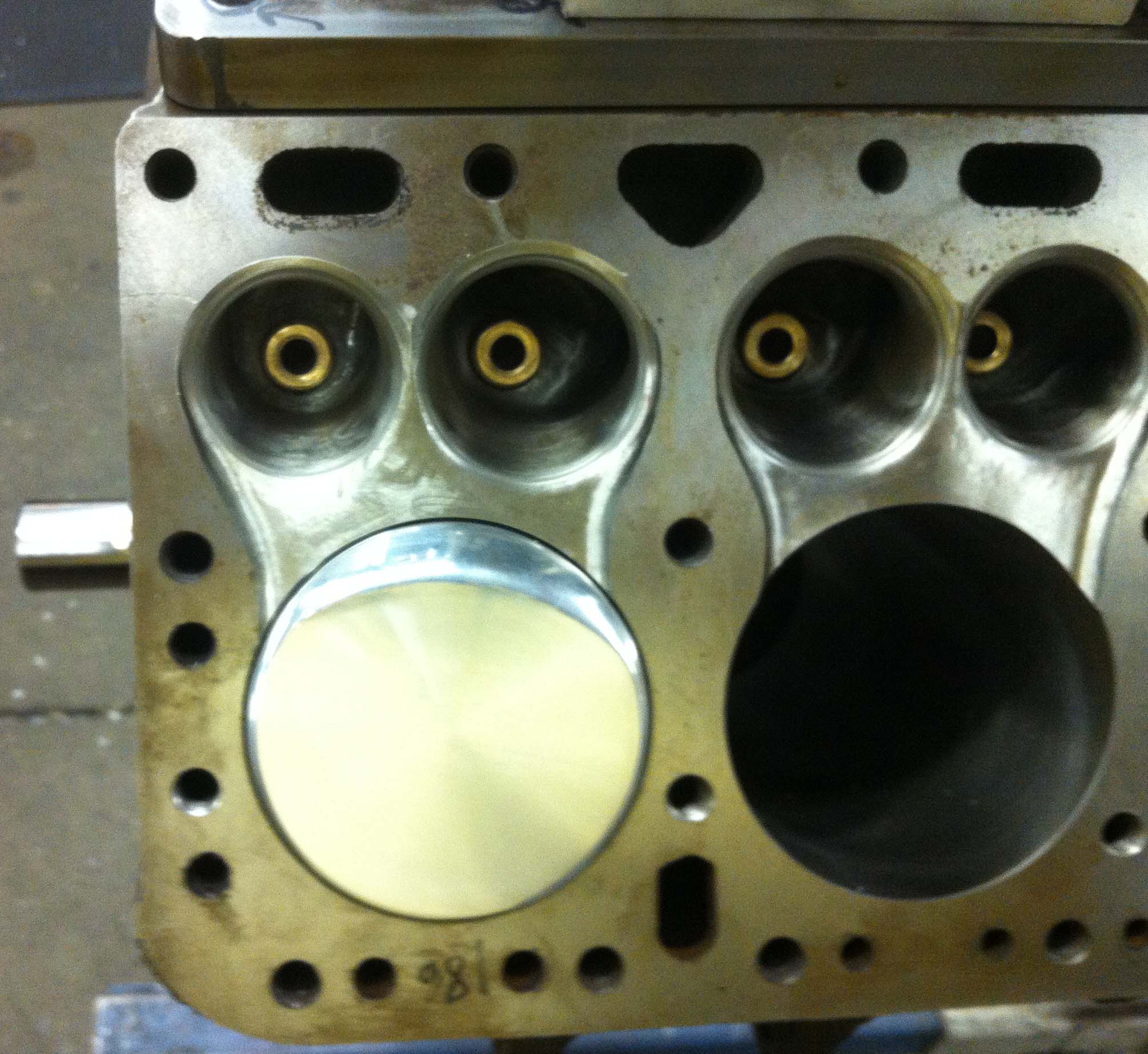

    I agree lean is bad! I think my biggest concerns are crank flex with only three mains, and how much cylinder pressure this 73 year old block will take!
    We have popups, but not domes. We run a Harley KR design chamber, but not the dome chamber design. We'd have to design new chambers to run domes.

    I meant piston top thickness.
  15. 38FLATTIE
    Joined: Oct 26, 2008
    Posts: 4,349
    38FLATTIE
    from Colorado
    Lippy, they are THICK!
