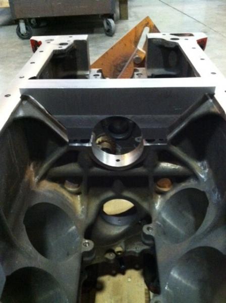

    I'll take one more kick at this thing, and I just know its gonna cause a ****storm. I scoured the thread, couldn't find a rod length so I could calculate peak piston acceleration, but like several other guys, I REALLY dont think thats gonna be your main issue, and it sure as hell wont be piston speed.
    I'll preface this by saying I have no first-hand nitro experience.The main issue I see with this thing on nitro is main web/cap integrity and crank flex. And once the webs and caps start moving around, the **** is going to hit the fan. If it were me (TR, Gregcon and Cutaway Al are gonna freak :eek::p) I would look very hard look at switching to aluminum rods. They will go a long ways to absorbing some of the violence that is otherwise going to end up being absorbed by the main webs, and that crank that is only supported by three main caps. Even on a light nitro load, you are in a whole different world as far as bottom end loads are concerned. I have seen clear evidence of main web/cap movement at around 650 hp in naturally aspirated 2 bolt main blocks, I hate to think of whats gonna happen with a load of nitro and three main webs. I have had good experience with BME rods.

  25. 38FLATTIE
    Joined: Oct 26, 2008
    Posts: 4,349
    38FLATTIE
    from Colorado
    We have redesigned the main caps and girdle. The mains are now doweled, and are wider going across the block. The center is a wedge shape, and far stronger than before. We are currently looking at cross-bolting it. Still, it remains to be seen if it will be enough!

  26. FrozenMerc
    Joined: Sep 4, 2009
    Posts: 3,567
    FrozenMerc
    That center cap looks really good. I didn't realize that the Cad's had such a deep skirt on the block, that will really help your bottom end strength. Cross bolting that thing will also help stabilize it. One more shot of the Slider for inspiration. If they can build that kind of power out of a Ford, I know it can be done with a Cadillac. Keep up the Good Work.

  29. falcongeorge
    Joined: Aug 26, 2010
    Posts: 18,339
    falcongeorge
    from BC
    I dont like the idea of cross-bolting that center main, isn't pulling inwards at that point going to tend to wedge the cap away from the block? This would be complicated to make, but how about a girdle with integral main caps that bolts to the pan rail and original main cap bolt locations? Just a thought...
