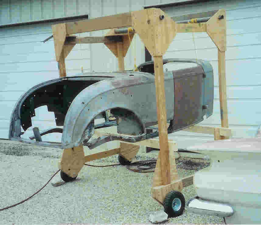

  11. Atwater Mike
    Joined: May 31, 2002
    Posts: 11,618
    Atwater Mike
    VW engines seem to have gained weight, too!
    I recall lifting my '27 T tub onto the 'A' frame... 4 of us, it was heavy; but not half as heavy as it is now.
    No reason for it, either. I don't get it.? o_O:eek:
    williebill and Budget36 like this.

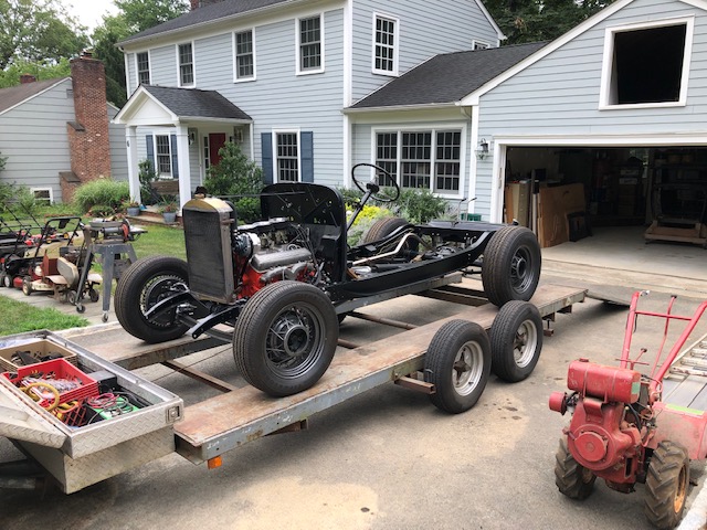

  13. sshep
    Joined: Oct 13, 2018
    Posts: 300
    sshep
    Tom, I am glad that you were able to get the three window body back on the frame. I look forward to your continuous progress on getting your 3w back together again. I know you and your brother were able to do it but if you ever need help with something heavy again like that please let me know.
    As a side note I was able to put the roadster body on my frame by myself with a car lift. I put the body up in the air and rolled the complete ch***is under it. Then I set some old tires on the frame and set the body on top of the tires. I re-positioned the strap to the back and used a floor jack with a 4x4 block of wood in the front so I could control the angle and set the body over the firewall. I worked slowly and everything fell into place without much fusing around.
    P.S.- I hope you got your grille situation worked out.

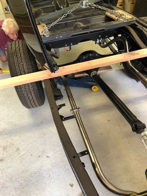

  15. ekimneirbo
    Joined: Apr 29, 2017
    Posts: 5,320
    ekimneirbo
    from Brooks Ky
    Don't mean to knock what you did, but I would suggest that anyone lifting a body like this at least put a board under that sheetmetal panel before lifting. If it kinks or bends it will be a big problem. A board underneath it and running the complete width will move the strain to the sides where its stronger. Glad to see that it worked for you though. :)

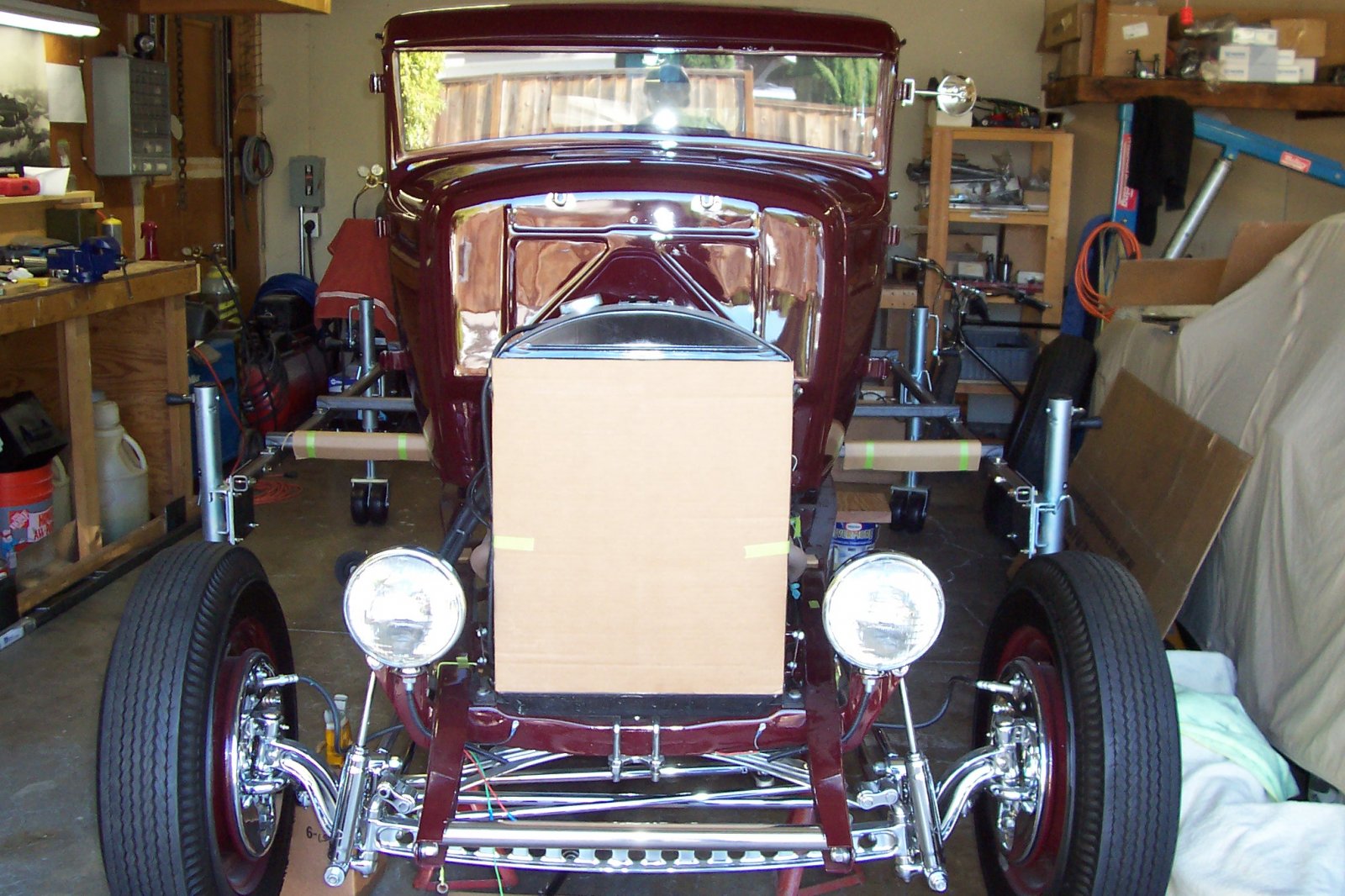

  17. BoxCar Tom
    Joined: Oct 21, 2010
    Posts: 55
    BoxCar Tom
    When you talk about safety precautions It got a bit shaky for us. Toward the end we had to shift from the 4x4 wood beam with a beefy eye bolt to two smaller eye bolts thru the forward body channel connected with a chain. The come-a-long cable was vibrating and both eye bolts bent. We had maybe 6 inches to go so took it real slow.
    Thanks to everyone for all the comments and compliments.

  21. ekimneirbo
    Posts: 5,320
    ekimneirbo
    from Brooks Ky
    Yes, thats true. The question though is it thk/strong enough for lifting the whole back end of the car. I would suspect that it is pretty thin wall stuff just to brace the body some.
    Then there is the back part of the sheetmetal where the trunk lid is open. Is there any bracing there.
    I found out the hard way that straps will bend sheetmetal as they tighten when lifting. Just trying to keep someone else from making that mistake. It looks like it worked just fine in this case, but myself..........I would not do it unsupported.:)
  22. Andy
    Joined: Nov 17, 2002
    Posts: 5,389
    Andy
    DCE9A726-3BF4-4559-A5FA-921B82914BEB.jpeg I made this to remove a body and move it away to work on it.
  23. BoxCar Tom
    Posts: 55
    BoxCar Tom
    Well done, I like it, plenty of access to the underside of the body, easy to adjust the height by turning the cross pipes. Is that the crank handle on the far end of the pipe? And just right for a light body. Like the big wheels. Easy to move around. Wish I put bigger castors on my dolly.
