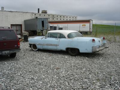

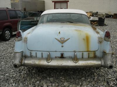

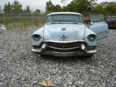

    There are some pics:)... I havent got any of the suspension system
  11. Damn thats a little bit nicer than I started with. I'll try and get some suspension pics up soon

    Looks are desiving... It is a bit rotten:rolleyes:
    And I have never seen so much filling on one car:eek:

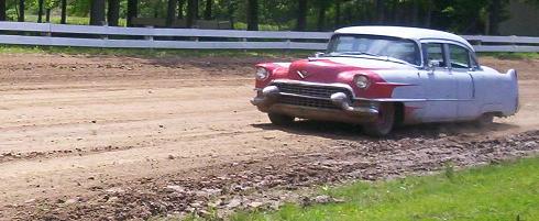

  18. I talked w/ the guys at AirRide this past w/e about lowering my 55 Caddy - sounds like a pretty straight forward install - I'm hoping for a winter project/install. Hey Joe...is that pic of your car one I took at the Autorama? Good to see ya (however briefly) in Columbus.
  19. Yuppers thats your pic. I looked at your cad but was retarded and didn't have my camera on me and hoped you would be there on sunday. Wish mine looked half as good now after all my work. Talk to you later Joe
