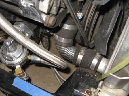

    Here is a photo of my lower hose. Two different sized openings, a bend and a twist all within a few inches.

    I think you are going to have a problem with this set up you have here. The connection joint between the tube and the engine and the tube and the radiator have no place to transfer the motion of the engine and vibration. You need to be sure that motion is not sent to the neck of the radiator or it will metal fatigue it and cause it to fail. You can correct the problem by lengthening one of the connection couplings so as to absorb the vibrations, even on a solid mounted engine. Looks nice, just thought I would forward the lesson I have learned the hard way.

    I appreciate the words of caution but as I indicated in a subsequent post..."As in the photo I posted, I am using short lengths of regular hose to bridge the gaps and then using the bands to clamp them in place. When complete there will be approximately 1 inch of hose exposed between the clamps/bands"...the rubber hose I am using will flex with the engine torque and vibration, the clamps are just that...clamps. If I need to adjust the setup to provide more range of motion then that can be easily done. I have also used some industrial grade shock isolators on the radiator that will allow more range of motion than on stock mounting setups. Thanks again for the heads up, always good to hear from "voices of experience".

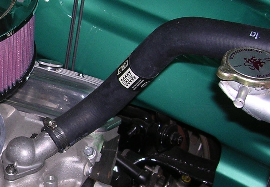

  11. Here is a whole different animal.
    I took this picture yesterday for a kid that wants to buy a stock Model A radiator off of me but has a flathead V8 engine, 59ab. This is what I did so I didn't have to change the radiator necks. Same premise...
    I'll direct him here for photos... thanks.
