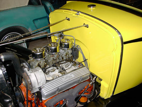

    Mine. Radiator moved forward.
    .[​IMG]
  6. Nice pic Rok. How far forward is that?
    Any one else have a pic of a radiator forward? It just seems like a good way to buy some room.
    Pics with hoods or hood tops only would be cool....

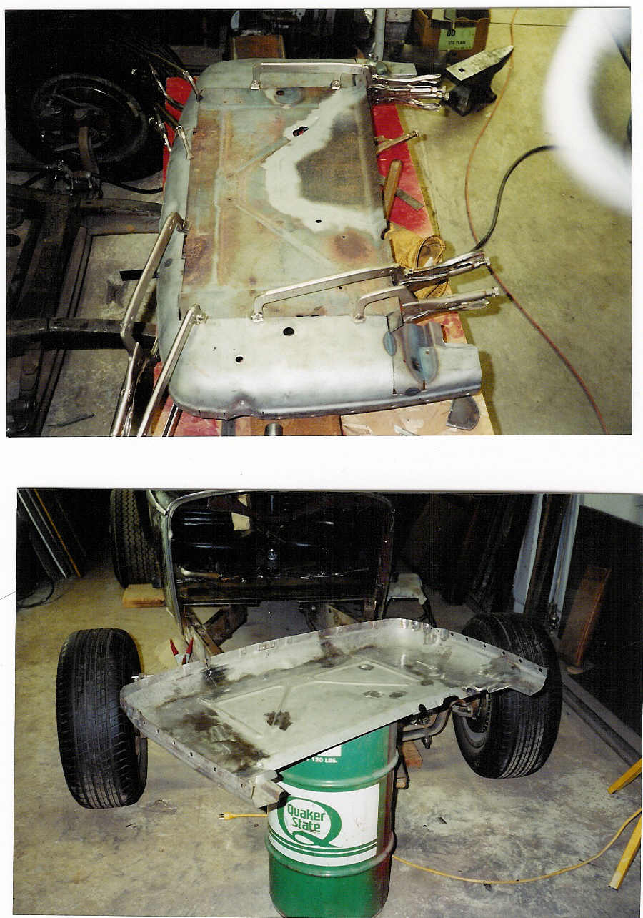

    Reversed firewall gets you about 4". and like Pist N Broke says, is a bit of work. A recess and short water pump on a SBF should work. In my opinion the reversed design beads looks OK, but I may be biased. still the firewall is a bit of work to get looking good.
    This is a reversed firewall with modified mounting feet and a approximate 4" recess as well. Cuts down on the foot room a bit, had to mount the seat as far back as possible and keep the seating position as high as possible. This all to keep the original 30 grill shell and full hood.
    Canuck
