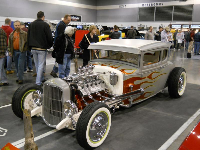

    It is done very frequently. Here is a V-12 Lincoln flat head in one too. Not uncommon many years ago. When the GM OHV V-8's in showed in 1949 a bunch of the Olds 303's were put in A's.
    Normbc9

    Thanks Turns, Ned and Norm.
    This is good stuff. I always wondered why the radiator can't go forward or the frame lengthened. It always seems to be about cutting the firewall. You know, that Lincoln just proves that if the engine "fits" the space, it looks right.
