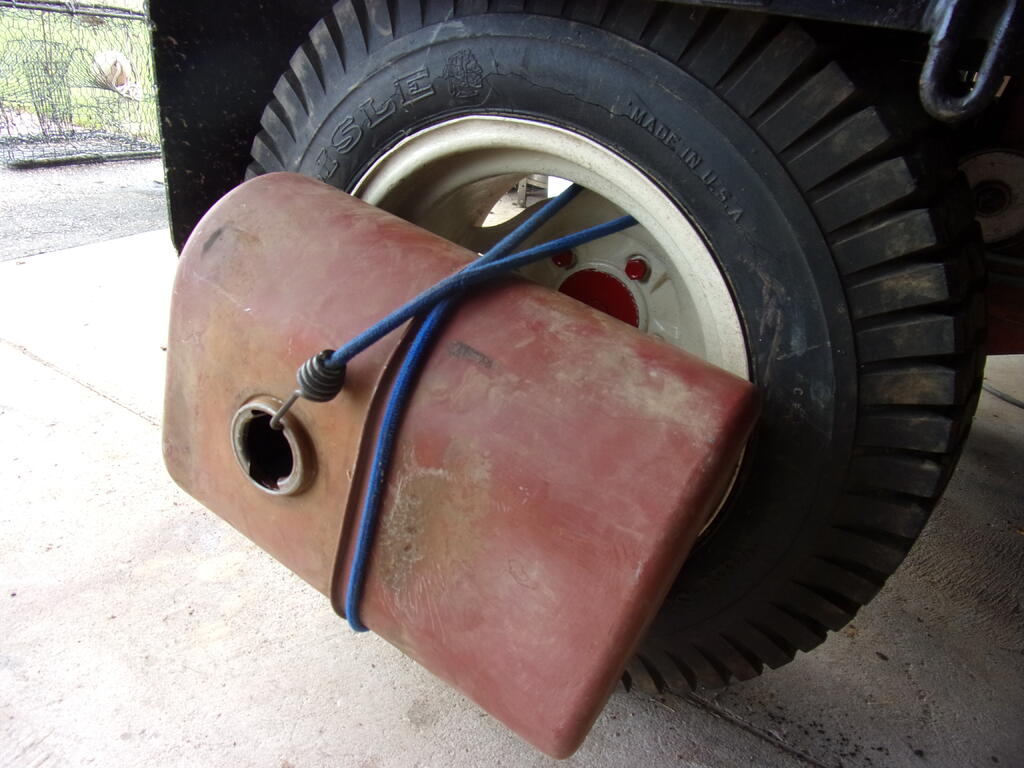

    Bleach
    I’ve read some guys putting a chain inside and tying the tank to a wheel and then driving around really slow for a while. I don’t know what kind of cleaner was used.

    holy **** that would take a big tire… Kind of clever nonetheless
