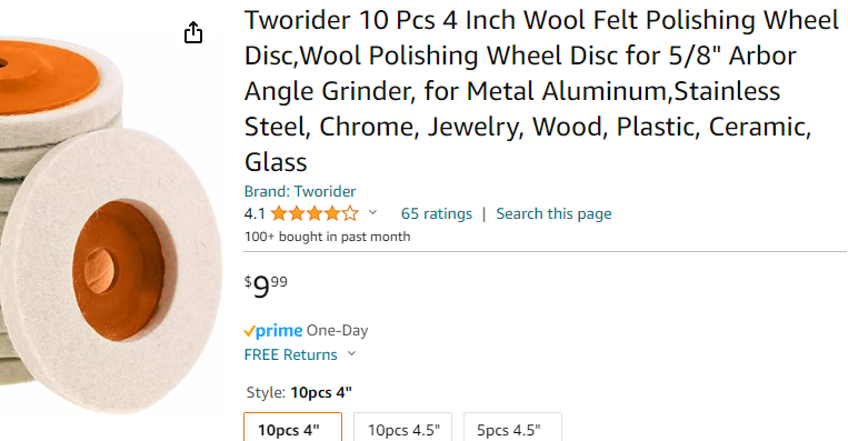

    4" wool pad on a high speed angle grinder, red rouge, watch the heat as chrome can blue. Use the edge only. Finish with mothers on a clean pad. You can buy those pads on amazon cheap.
