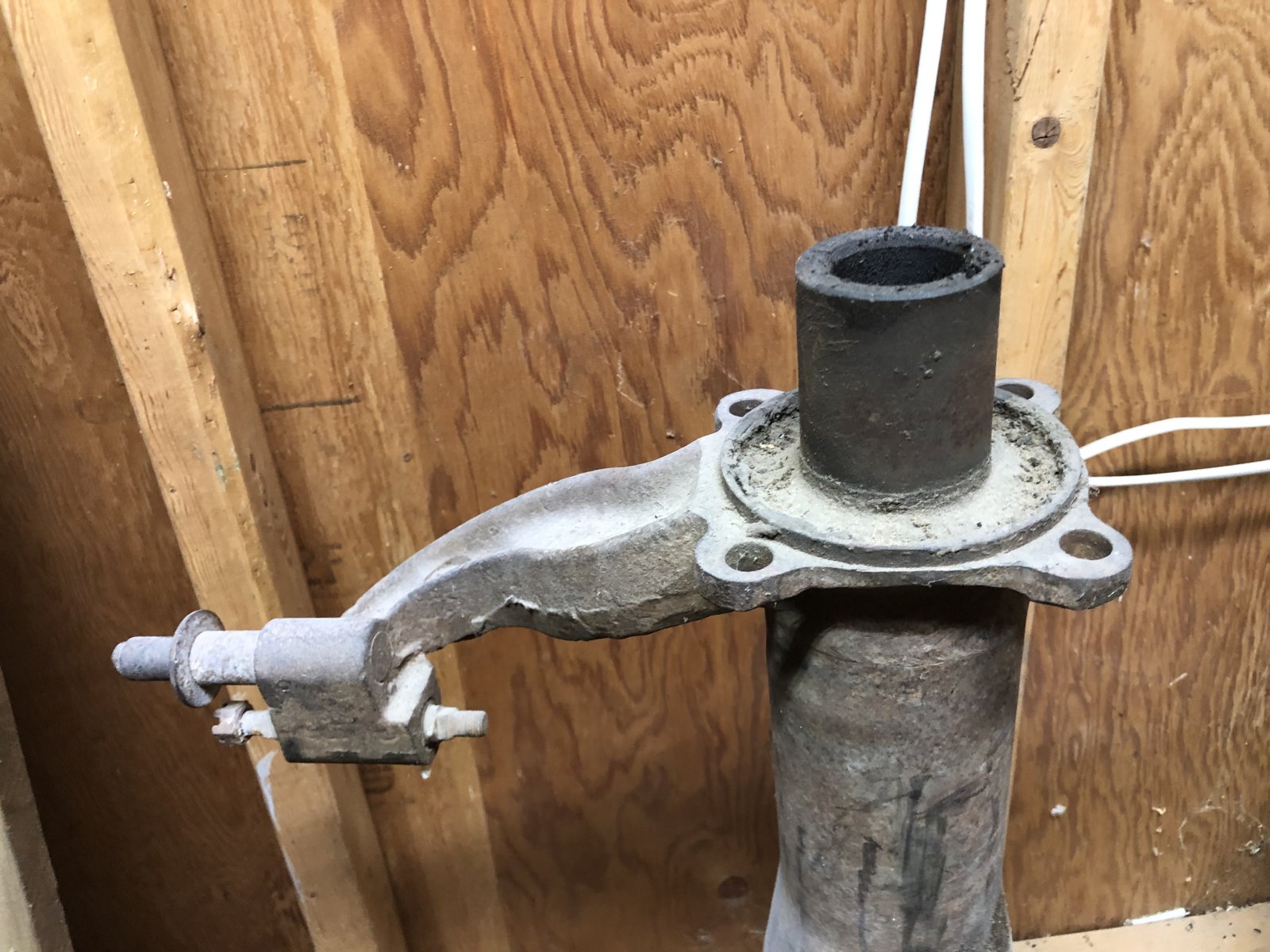

    Here are the pictures of the two general styles of axle trumpets. The later ones ('42-'48) are like the '40s but a bit longer. If you are going to cut the ends off and fit push in axles, it won't matter. It is advisable to get a matched pair, at least by year, so that the tapers are the same on both pieces.
    1935
    1940

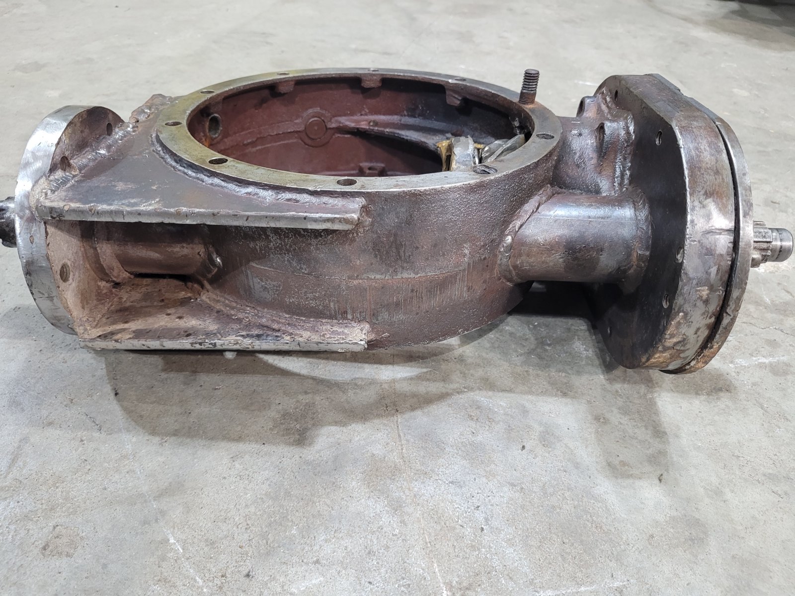

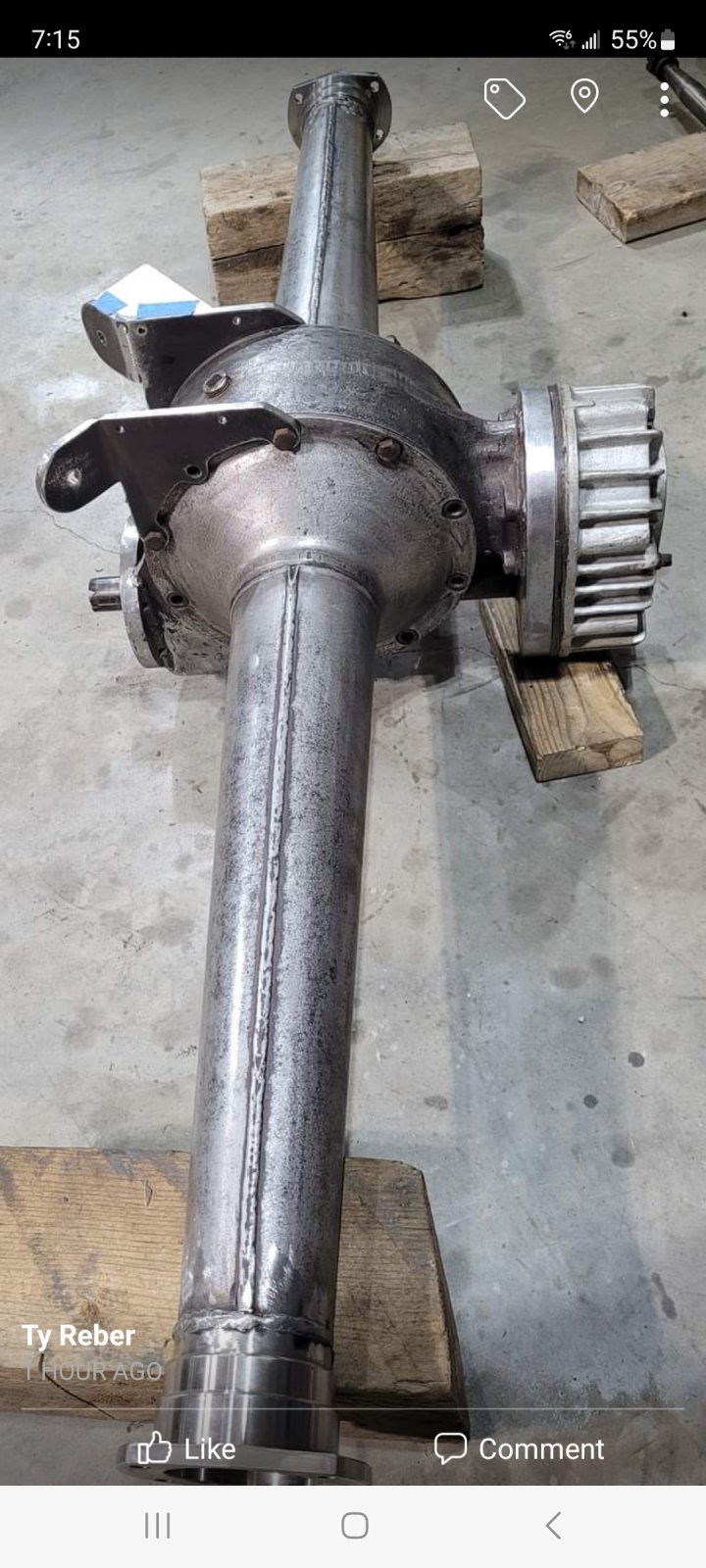

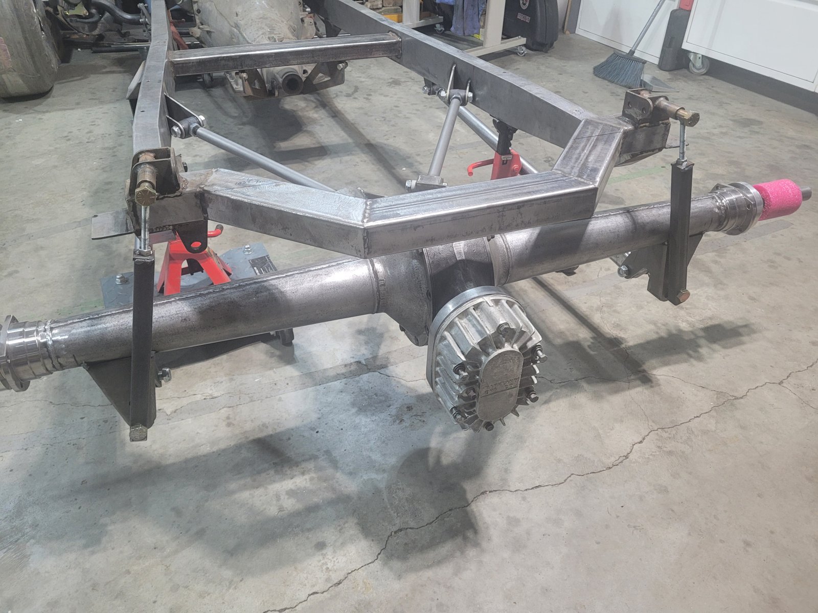

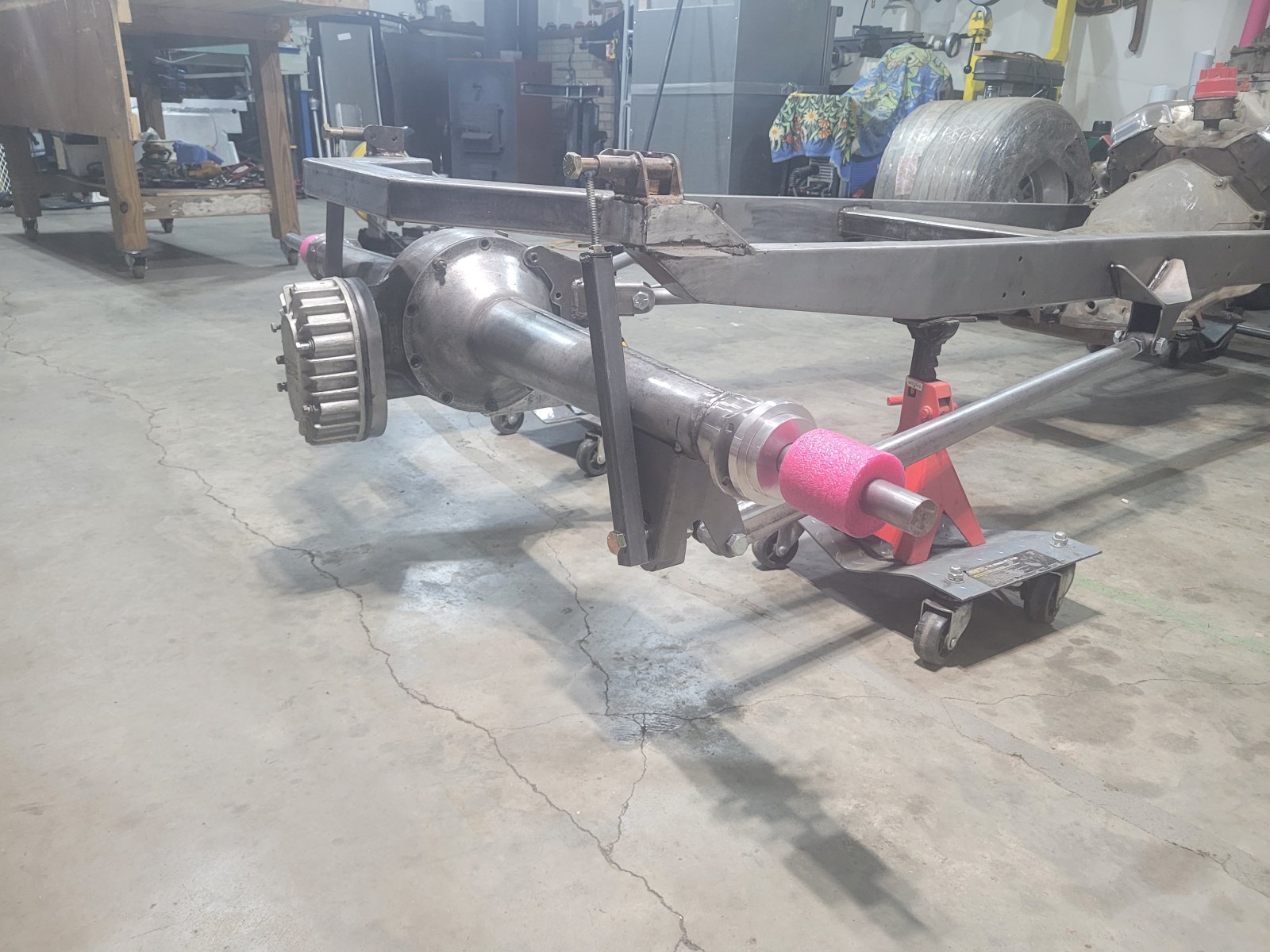

    Hi Mike, I've been reading the replies on your post, all very good info from good guys willing to share. Here some info I have learned about the 46-48 banjos. First the side bells are wider which makes it easier to cut to your preferred with whatever it may end up. Second they have the nose bearing on the end of the pinion which makes it stronger than the earlier years of just 2 bearings. You have the rearend that was sought after in the 50's for building quick change rearend for many racers wishing to have the ease of changing gears at the track. I have the same rearend, it was made into a qc by the Frankland family. I'm currently trying to find parts to make mine usable. The guy at Hotrod Works is very knowledgeable and spends time with you to figure what you need. I would suggest that you call them for further ***istance. Here is a few pics of what I've ended up with. Remember that this started out with a 46 coupe rearend just like yours. Note that the fill and drain pluge are now on top. 20230524_205352.jpg 20230524_205401.jpg Screenshot_20230503_191508_Facebook.jpg 20230503_184018.jpg 20230309_124511.jpg .
    chevyfordman likes this.
  19. RE: Nose Bearings: This is what we call a pinion support bearing and Ford banjo style rear ends had this from late 32 onward. The pinion bearings changed a bit over the years - from late 32 to 48, but all of these rears had the support bearing.
    When you buy used Halibrand 201 style center sections, many of them have been cracked/welded in the pinion bearing support area. There are multiple reasons for this happening - likely because of too much load put on the 201 (as the pinion is trying to force itself away from the ring-gear, causing the casting to split). One has to be very careful buying used Halibrand stuff - any of it --> A, V8/201, 301, etc.. For a modern quick change, the best bet is the Winters unit, with the good differential, etc..
    Kiwi 4d and 51 mercules like this.
