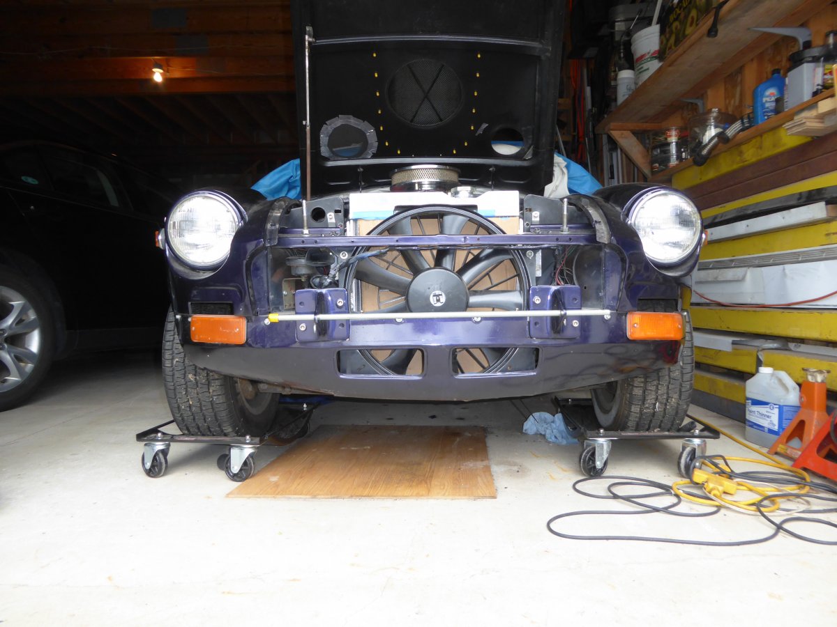

    I have a 350CI 400 HP engine in my car. Its a tight fit and I have always has some cooling issues. I'm revamping the system to try and improve cooling.. The engine is lower than the rad so I have a filler block on top of the intake above the thermostat to make this the primary fill point and the high point in the system. It has a 16lb cap and overflows to a remote recover tank. The rad has a 24 -26 lb cap so it will not open before the 16lb cap. I replaced my old custom br*** and copper rad with a new 3 row, .75 tube Champion aluminum rad. and improved the upper and lower rad hoses. I replaced a 160 degree stainless thermostat with 3/16 holes drilled around the perimeter with a virgin undisturbed 180 degree high flow thermostat ..not sure which was a better use for the system. Space is tight and there is no room for a mechanical or electrical puller fan in front of the engine. I have a 17" pusher fan mounted in front of the rad with about 1 1/2 inch air gap. Its shrouded but I plan to improve the current shroud and ducting on the front of the car. It has a 175 degree auto switch. I'm looking for suggestions on any mistakes o might have made or thing I might improve. Attached is a picture P1010390.JPG of the current set up. Thanks . .

    Pusher is less efficient than puller, but if there's no room, you do what you can. Does the hot air have somewhere to go? Looks like the upper hose routes nicely, is the lower also good?

    Does the shroud cover all of the rad? I wonder if the shroud and the fan itself are restricting some of the airflow.

    The fan covers almost the whole front of the rad and sits inside a deep round tunnel. I think it can be improved a bit by eliminating some possible minor possible leak areas and improving the ducting to the entry of the tunnel.
    Attached is a front view of the fan/shroud ***embly. Its a little hard to see. P1010392.JPG The Rad currently has a piece of cardboard in front of the fins to protect them till final fitting is complete.

    Increasing the flow won't necessarily cool it down. Thanks for the front end picture. My question was answered. Dedenbear make water pump that may work for you. Enabling a fan to be rear mounted

    Is the fan too big? I have never seen a design where the fan was, as yours looks like, bigger than the radiator. Perhaps the fan is not moving enough air because the area behind the fan is restricted in comparison to the opening.

    Attached are a couple photos. One from the front of the car. Note the bottom of the rad is currently at the bottom of the front lower valance. The other shows a top view. You can see there is only about an inch to the pulleys, belt and alternator etc. You can also see the pusher fan shroud is about 4 1/2 inches wide. it MIGHT ..be possible to remove the pusher and its shroud and move the rad forward slanting the bottom out enough to make enough space for a thinner puller ***embly. I wonder how much that change might make? I would probably not do that though unless the current set up does not work.. BTW.. I worked with a fan research company who designed , tested and built this fan ***embly for Ford. At the time it was the largest and most efficient OEM fan available, although not used as a pusher, but why I originally selected it.. (and it was free)
