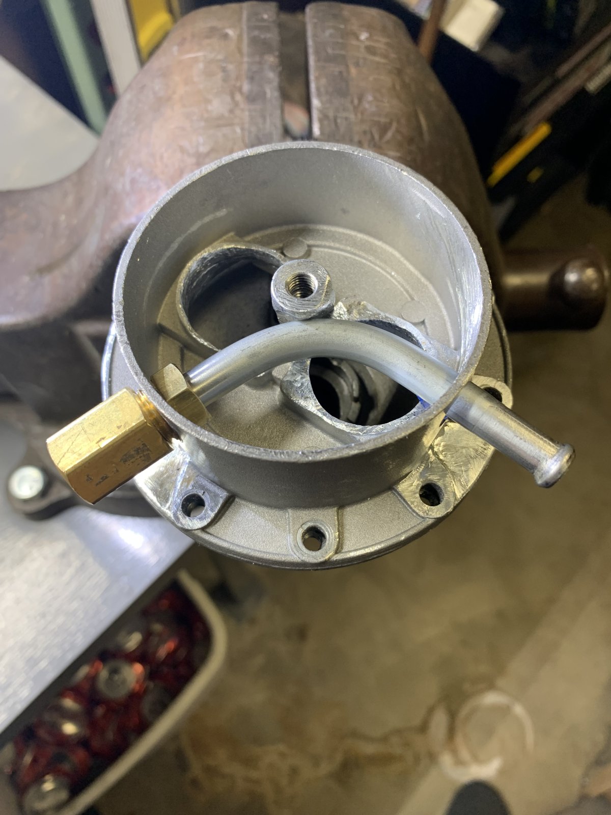

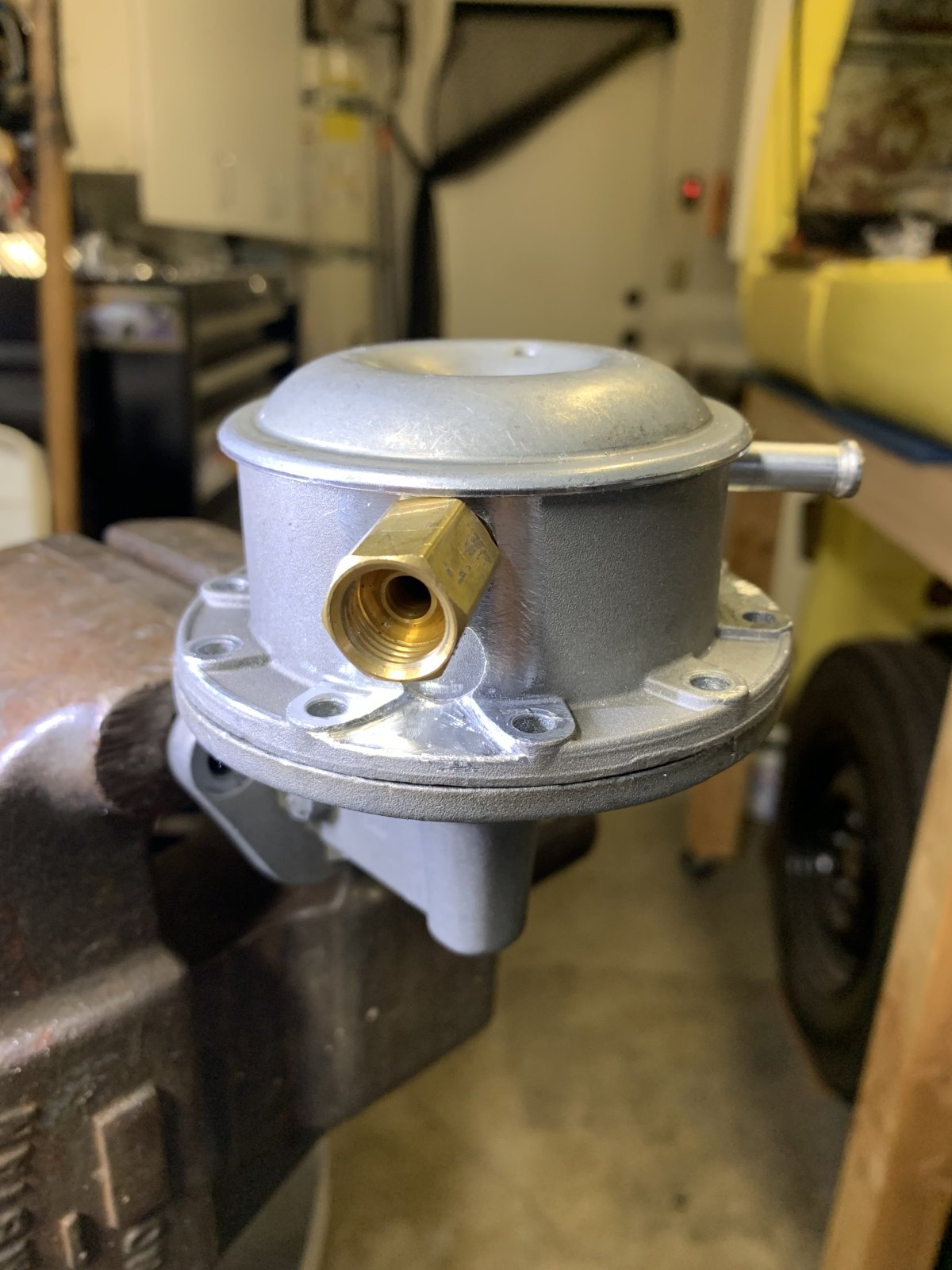

    You could gut it then send fuel thru it via and electric fuel pump. IMG_0691.jpeg IMG_0692.jpeg

  14. wheeltramp brian
    Joined: Jun 11, 2010
    Posts: 3,235
    wheeltramp brian
    I did the same thing on a customer's cadillac. The thing sits on top of the engine and it is in plain view. That way, it still looks stock with the electric pump.
