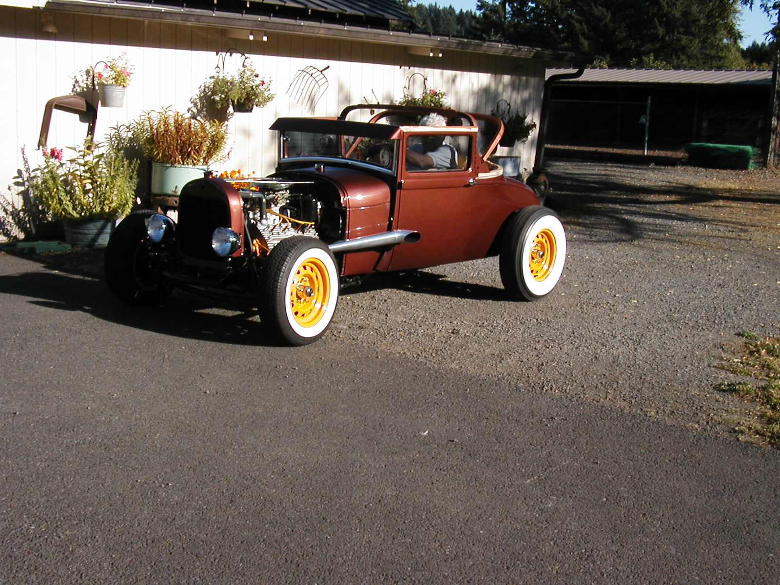

  8. This one has one and first gear is a waste of time and at 75mph in 5th gear if you want to change lanes and get around anyone you have to downshift into 3rd gear to pickup any speed at all and that's a well built motor with a single 4bbl.

    I would argue that is because of not making the right choices when it comes to gearing. S-10 boxes with 4.03 gears are wrong with 3.78 or 4.11 rears. This is why I have two transmissions to make a Franken T-5. S-10 shifter location and a 2.95 first gearset.
