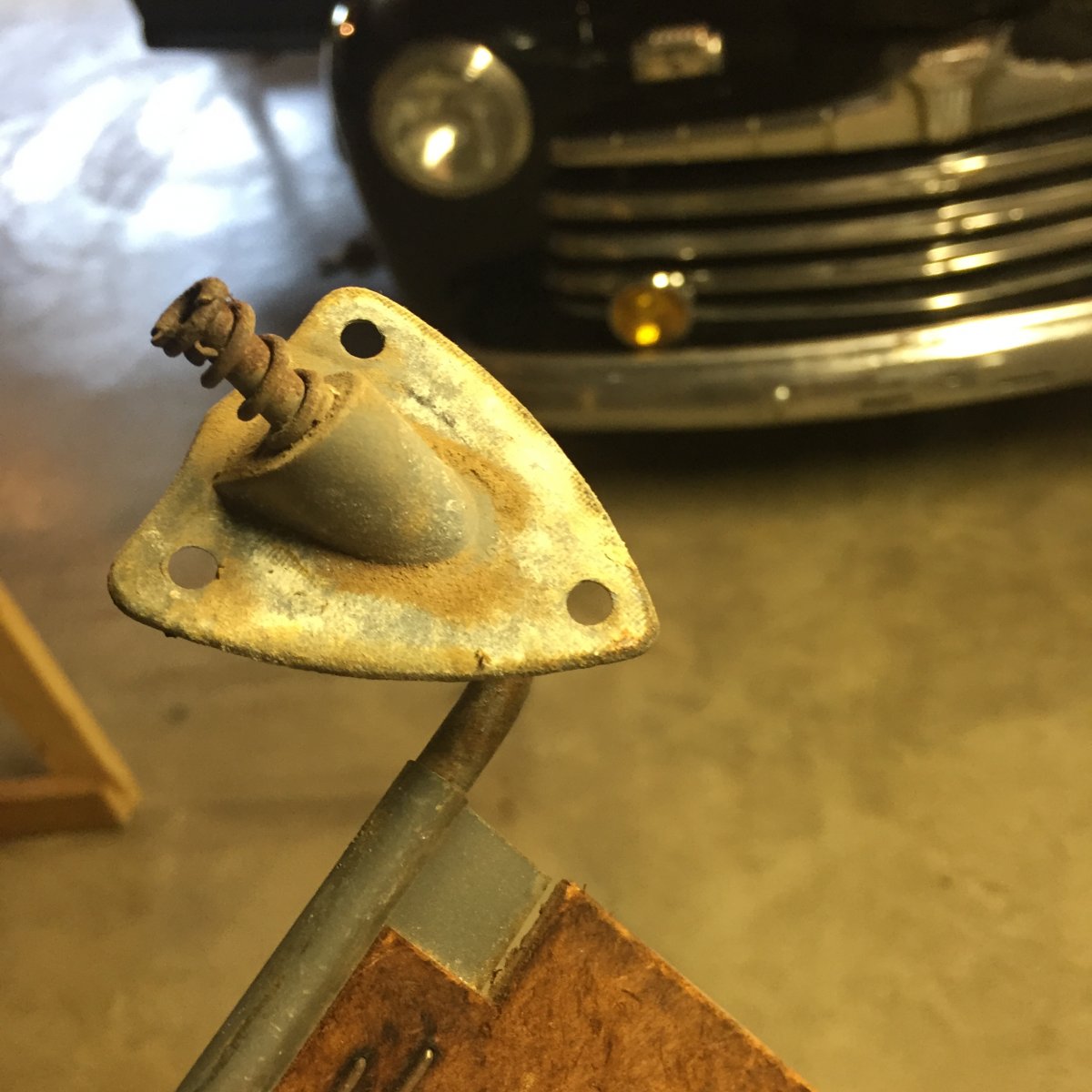

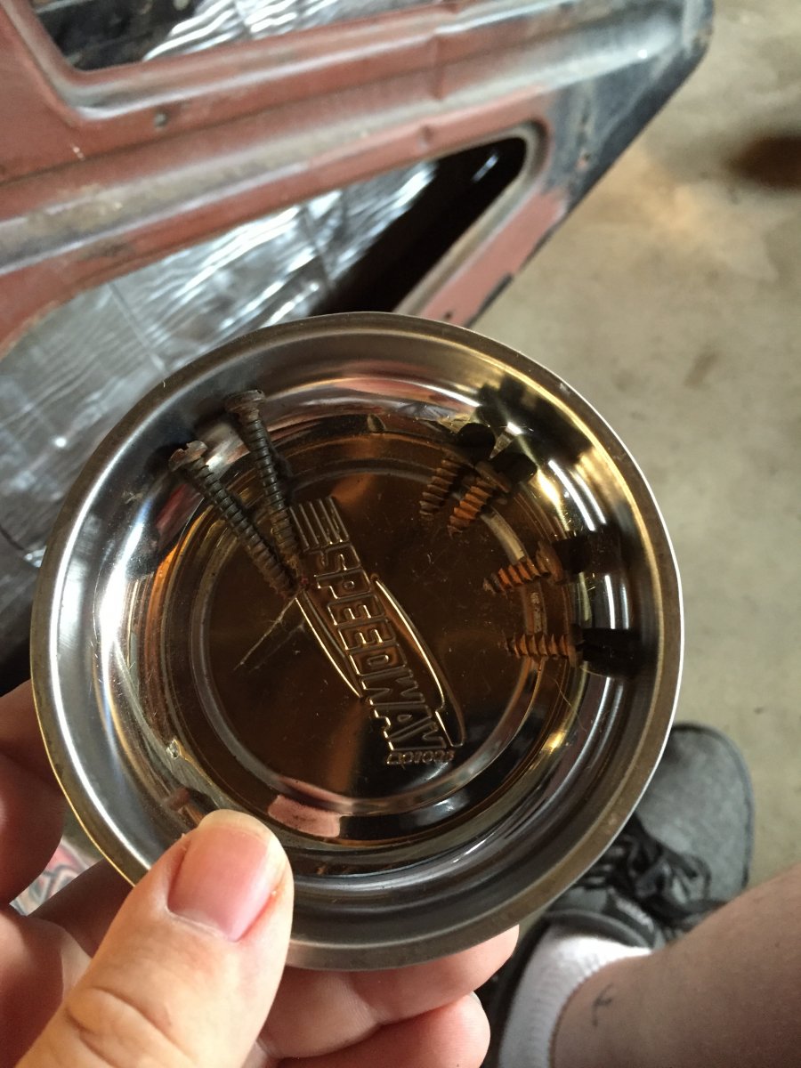

    image.jpeg Two long screws in the A pillar and four short ones in the length.
    Flipping the grab rail down you can see two things. Right off the bat you see the big tangs that are attached to the car and hold the windlace and second you see corisponding dots that are from the alligator/grab teeth that hold the headliner under the rail. You can see a bit of the head liner is still attached to the rail here.
    As good as any directions are reverse engineering will always help.

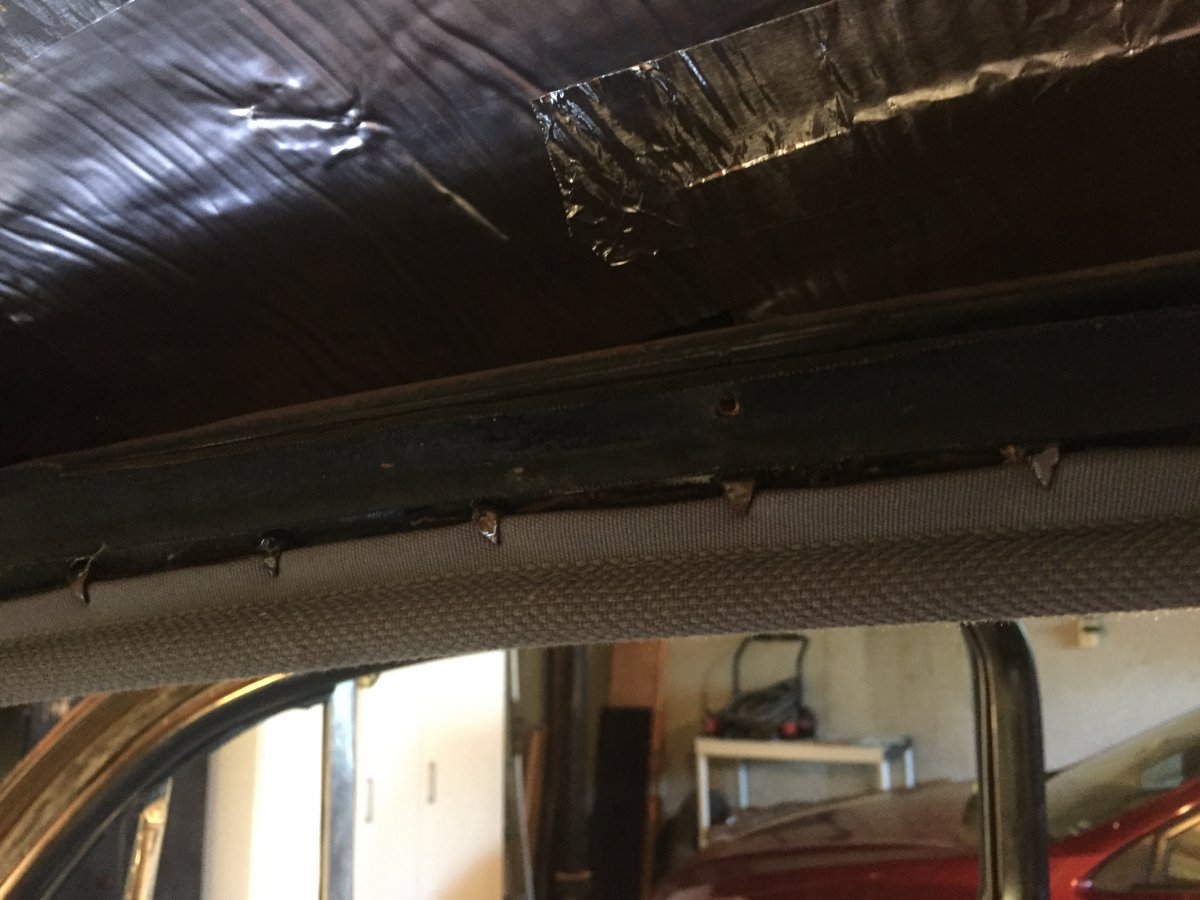

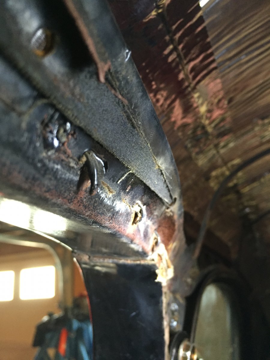

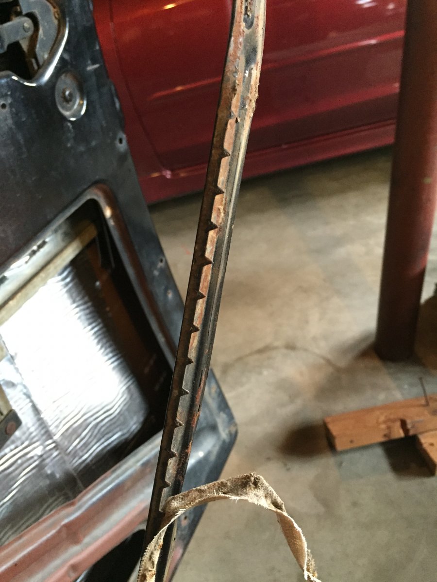

    Here you can see the teeth much clearer as I peeled the old head liner off. I did NOT bend these teeth I just pulled the fabric out.

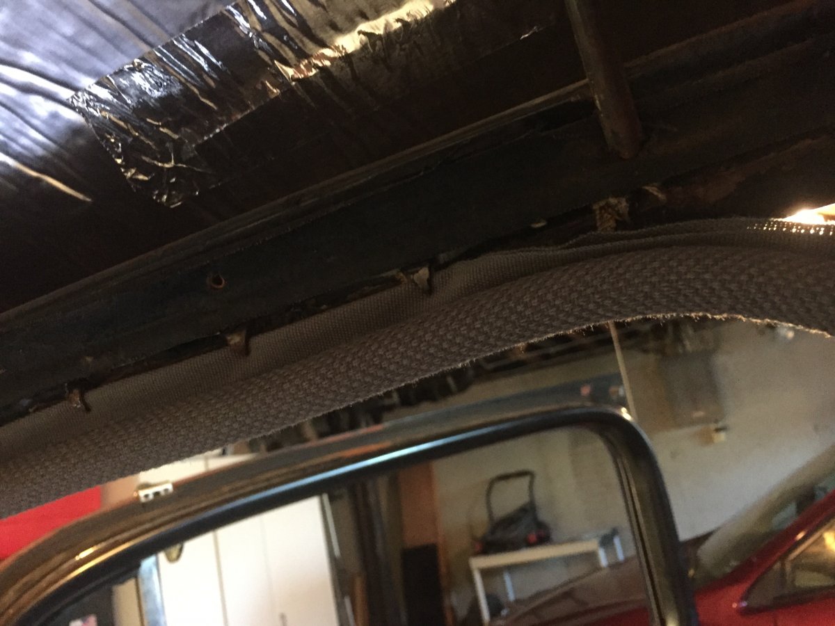

    image.jpeg I then moved onto removing the windlace bias tape from the tangs on the car. I took this photo to show how tight they were held in. Partially for you guys and partially for myself when putting the new stuff in.
    image.jpeg You can see here that the tangs are curved. They hold stuff in with the tip, not by hammering the whole tang flat. I did have to gently pry some of them open with a flat blade screw driver to get them to release

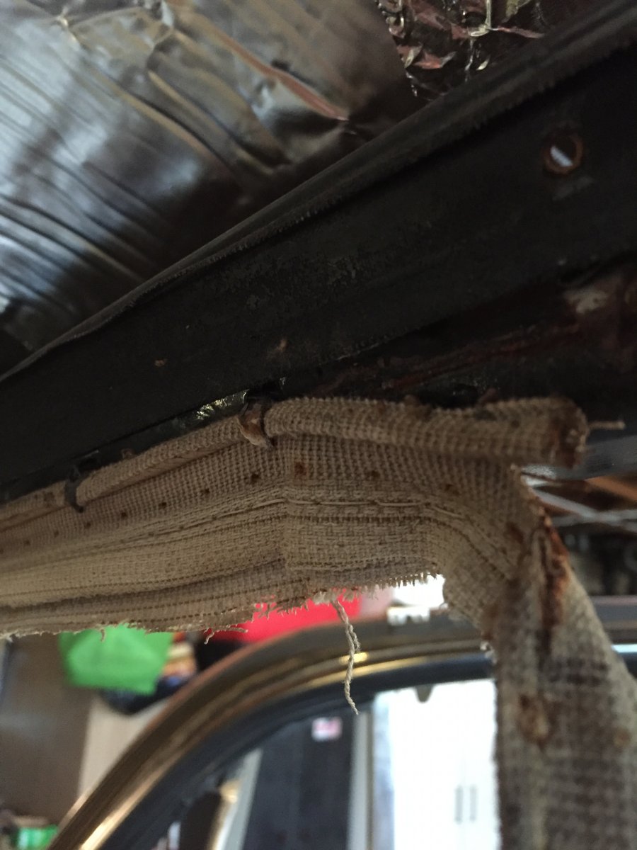

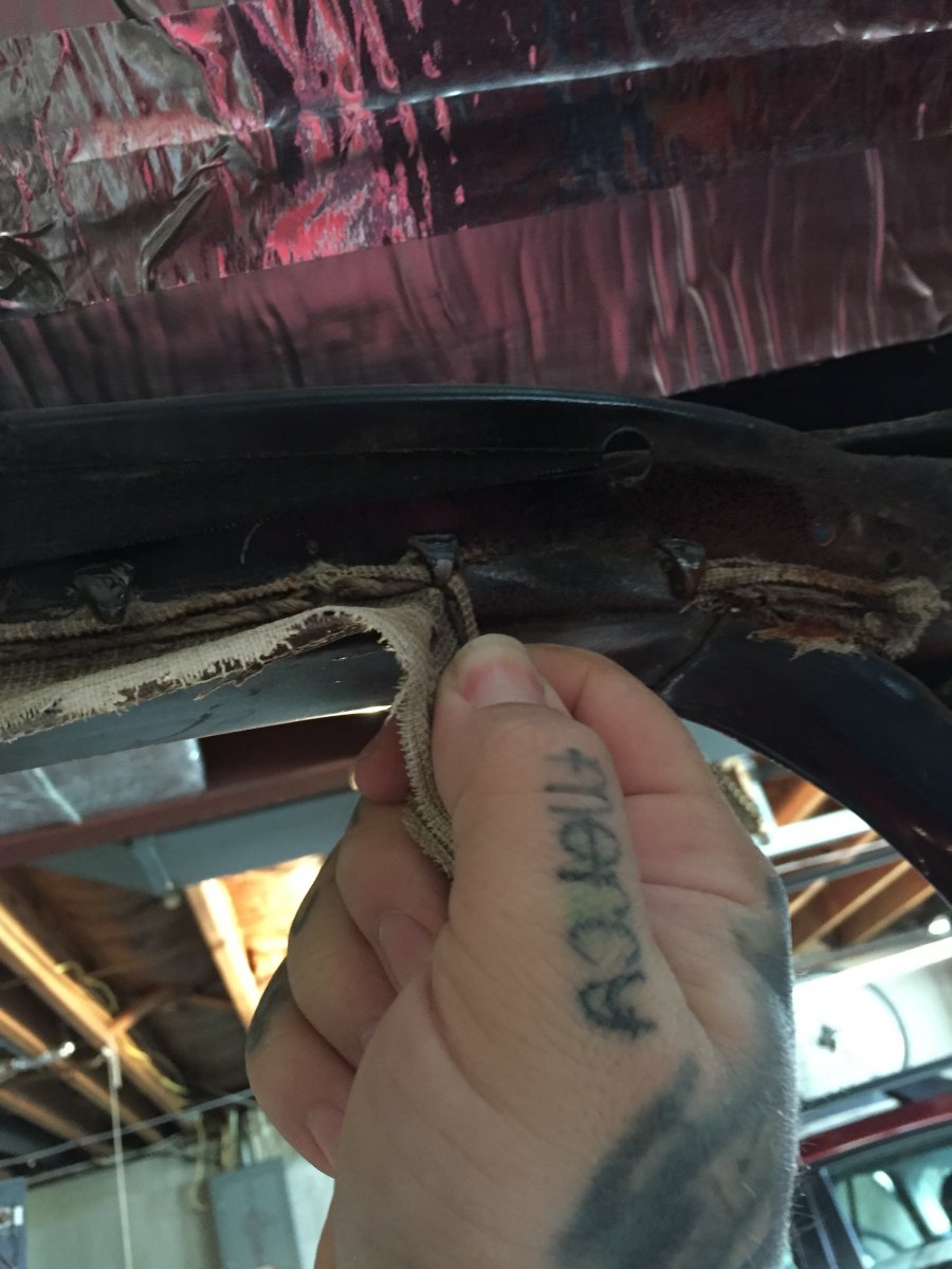

    image.jpeg Here you can see that the windlace from the factory had a bit of cord sewn into the edge and the tangs sorta curve around it.

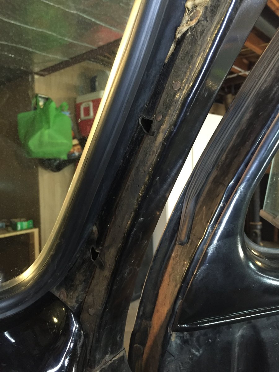

    Working forward the windlace is nailed to a tack strip in the A pillar.

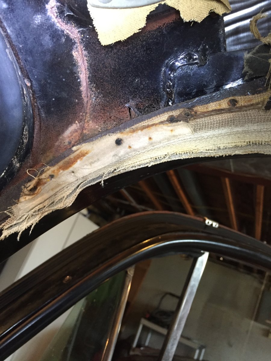

    image.jpeg Here is the tack strip with out the fabric. Mine was in pretty good shape but I still elected to leave the existing tacks instead of pulling them. Figured it would keep it more solid.
    Here you can see that while there is a channel for the tack strip it is held in place with some tangs here as well

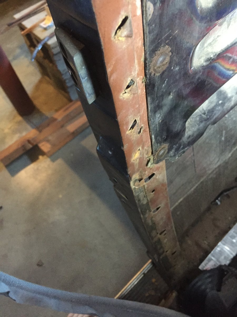

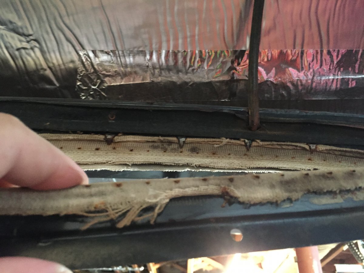

    Below the dash the windlace is held on a few different ways. The first you'll notice is a retainer strip that the kick panels stick into. It comes out with a couple screws.

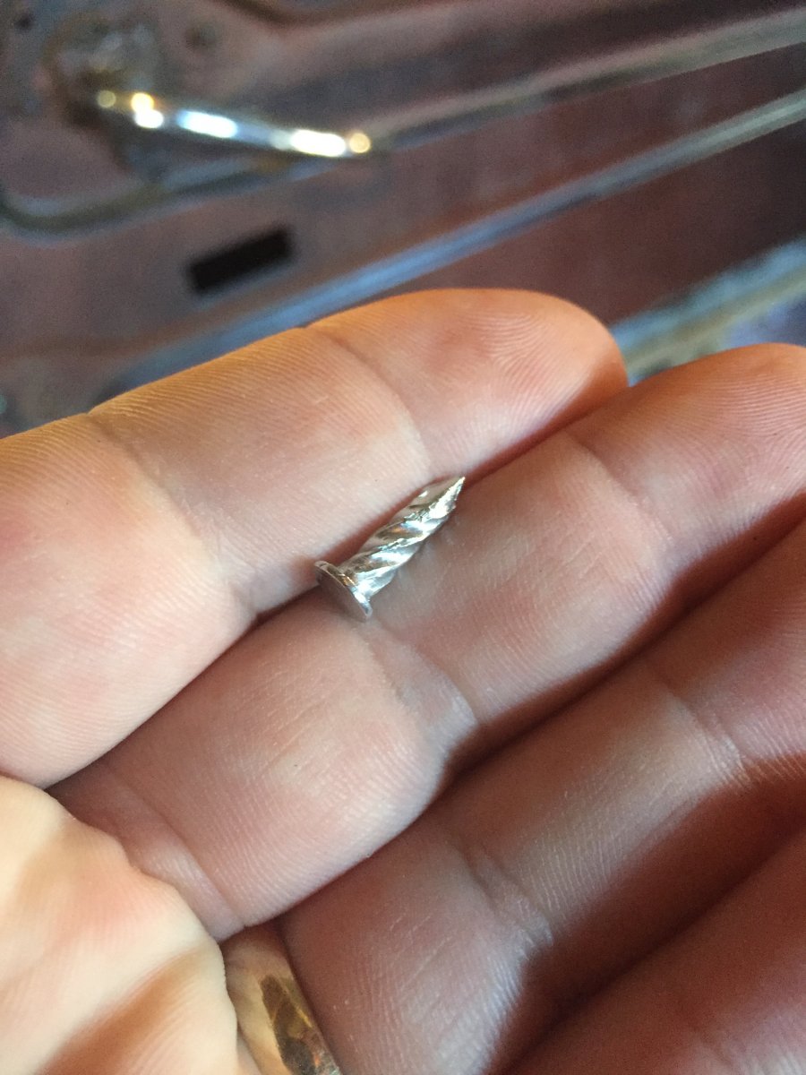

    After some Kroil they came out and I marked them with chalk. You can now see the four nails under the retainer. These are what actually holds the windlace in place. I marked them as well
    reagen and lothiandon1940 like this.

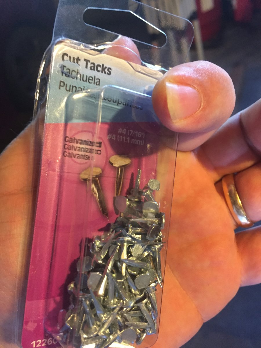

    You need to figure out which piece is the drivers side and which is the p***enger side. You want it took look like the top photo with the flap facing forward. This one is for the p***enger side as chose to start on the side that doesn't have a steering wheel to work around ;) I suggest you do the same.
    You will end up flipping the flap back and attaching the windlace with the tacks and nails in the dark gray bias tape that runs the entire length. Then the flap folds over it and covers it all.

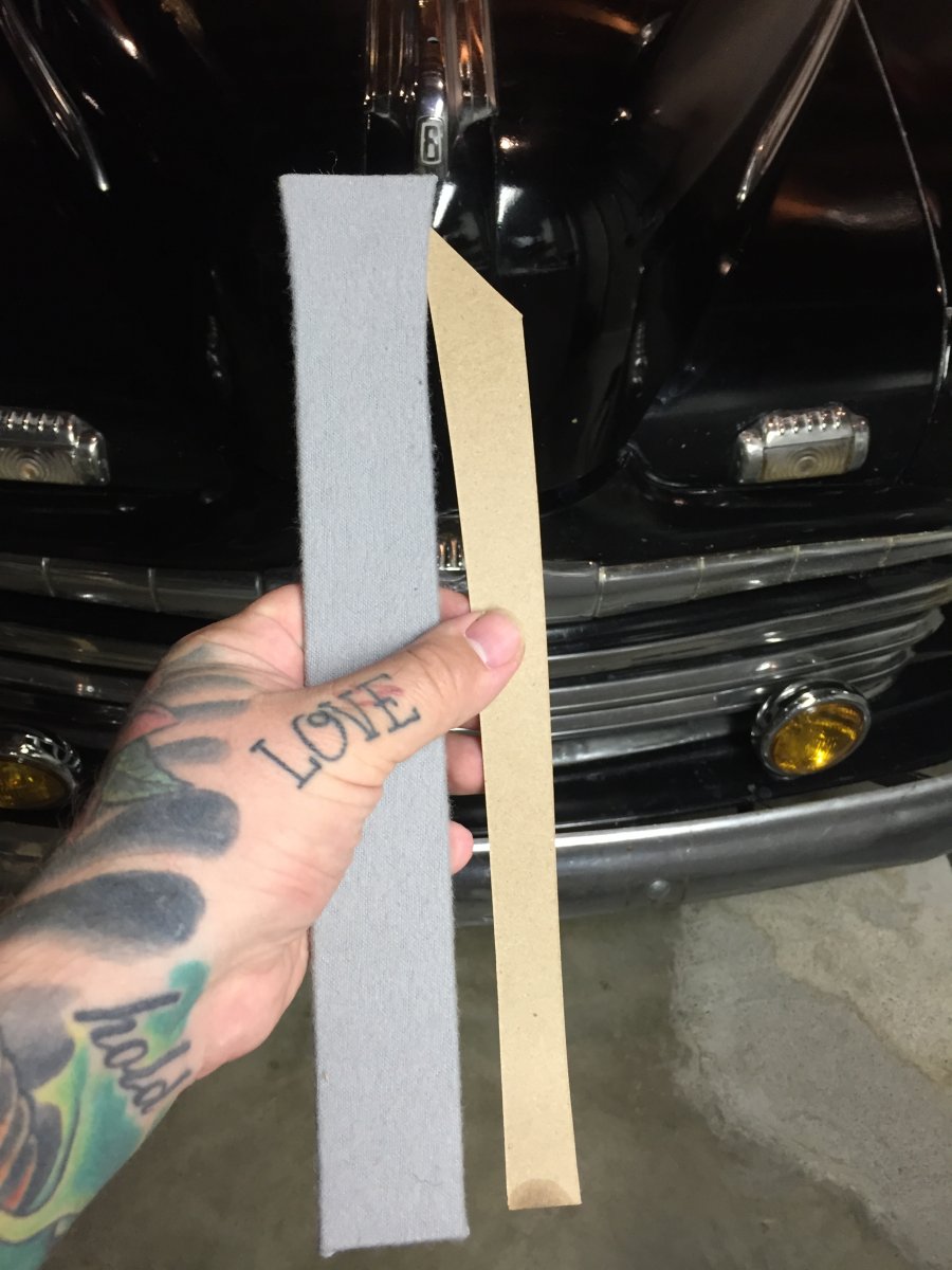

    Now would be a decent time to go buy some contact cement. Depending on what your comfortable with some people glue the windlace in place and then tack it etc. either way you will need it. image.jpeg however supplied in my headliner and windlace package- which came with so much stuff that I never even knew I needed I really felt smart for buying it- were these nails and tacks image.jpeg these gnarly ****ers are what you use to hold the windlace down under the kick panel retainer strips image.jpeg and a whole bunch of these are what you use for the rest.
    lothiandon1940 likes this.

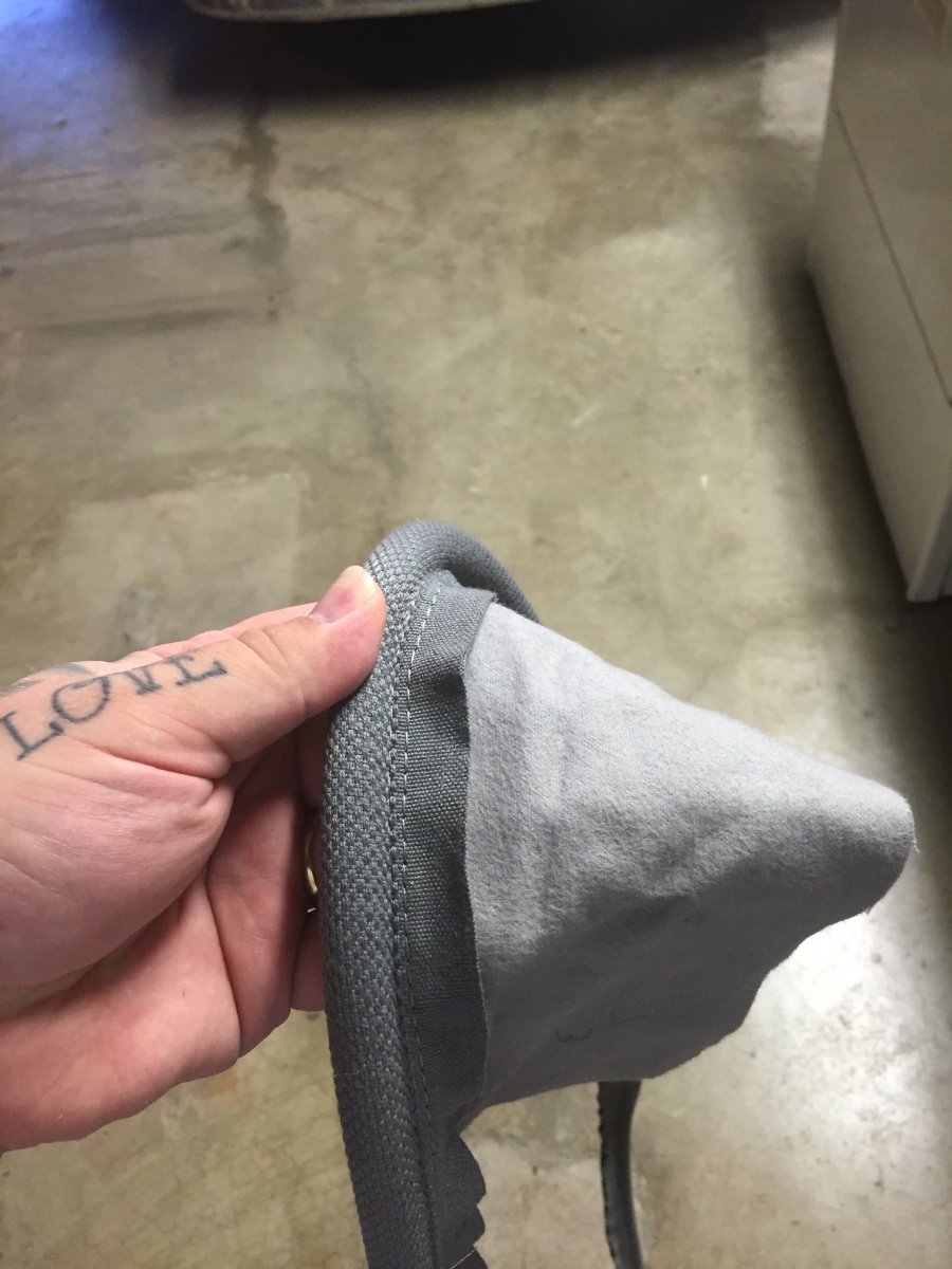

    Some of these tangs needed opened a little more to slide the bias tape under them. I kept them tight enough that I could slide a few in place and then go back and hammer the tangs all down.

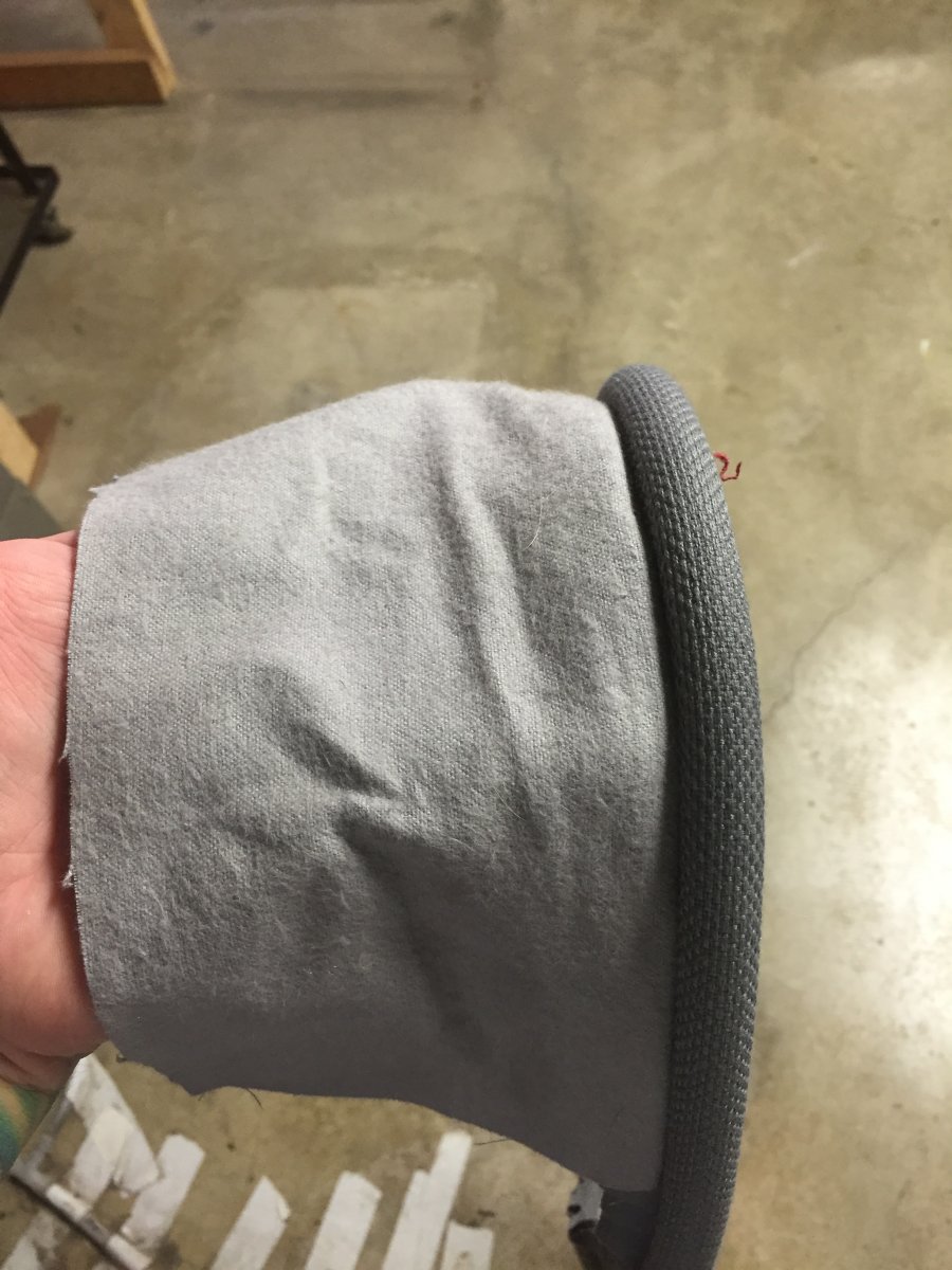

    I roled the back edge of the bias tape over to simulate the cord that was on the stock stuff and also to take up some slack to bring the fat roll into place. I wanted good tension side to side so it wouldn't sag or do something weird. Just do a little at a time, take a few steps back and go back at it.
    image.jpeg You can sorta see how I roled the edge here

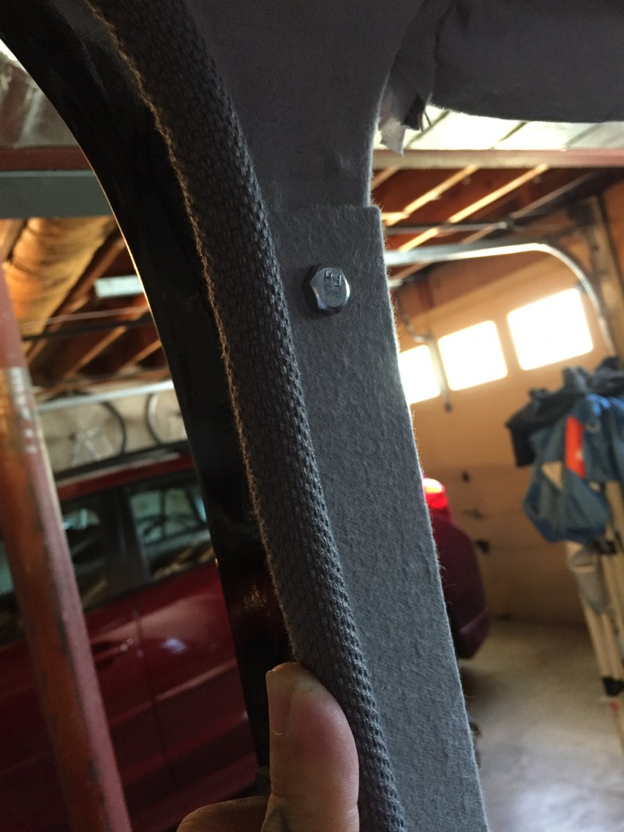

    image.jpeg All snugged up I went on to bringing it down the B pillar such is a mix of tack strip and tangs. Your nails and stuff all end up under a trim piece and the quarter panel upholstery.
    However I did fail to show that corner being made. It's a tight turn so they recommend cutting the bias tape - not the cord! Aka fat part - I found after mocking it up that I only needed one small slit to let it release any tension and lay flat threw the corner.

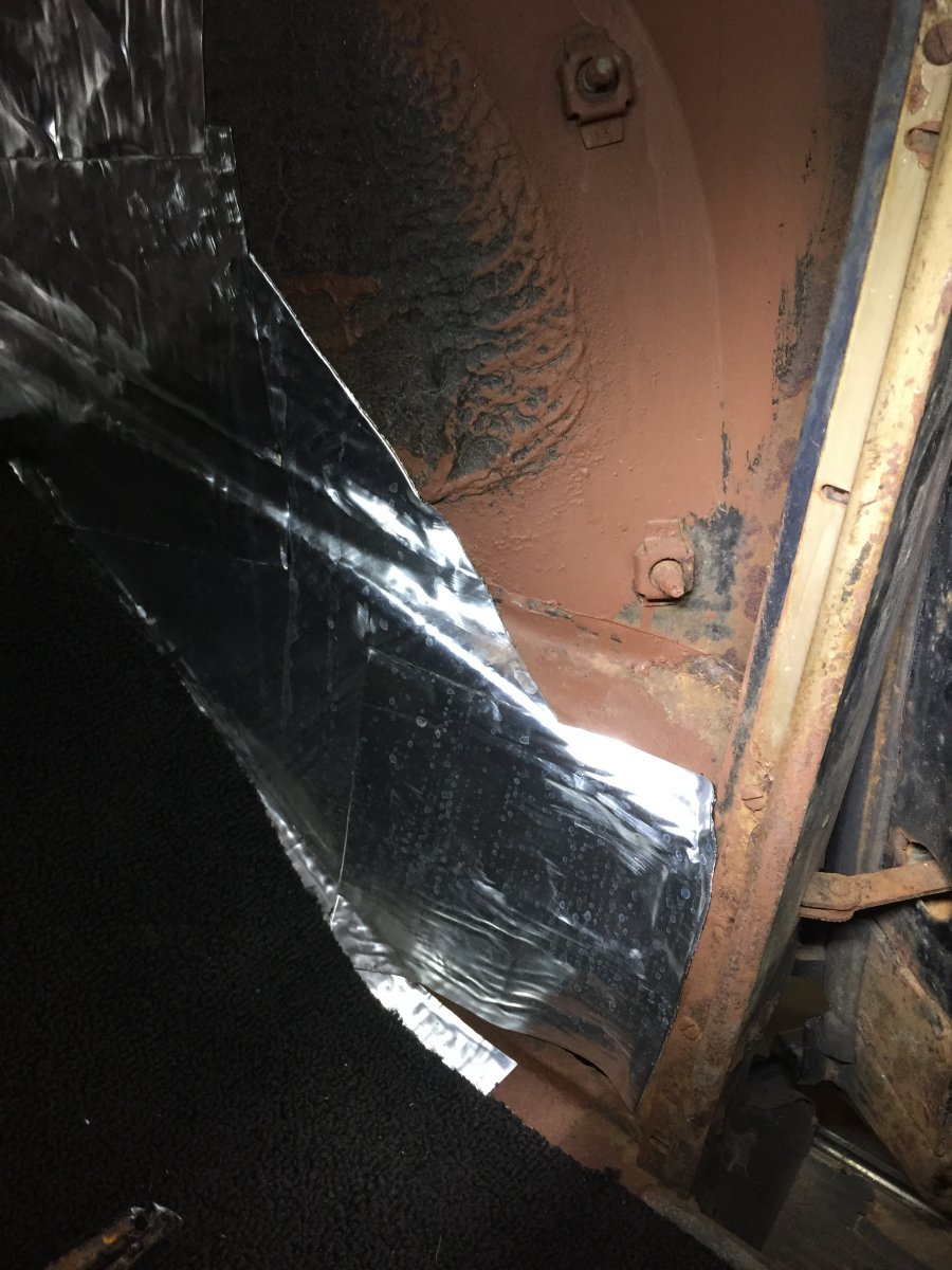

    Ok at this point with both sides done I removed the sun visors. They are held in by three screw headed bolts, I think they are called clutch screws? Anyhow I took them off image.jpeg i didn't realize that the unit went up into the metal structure, I kept this little piece of the old head liner that was revealed to later use as a bit of a template for cutting holes in the new one image.jpeg Keep in mind when you get to this area of the headliner that you want to get it nice and tight but you also need to be able to install these with out ripping something when you tighten it all down. You'll get that more when you pull that area tight and push a few fingers to see how far the headliner is from the roof where they bolt on.
    image.jpeg Then I took the supplied padding- looms like synthetic jute padding/insulation- that came with the kit and cemented it to the vertical/ flat face of the rear window opening. That's the only place I can think of to put it. The directions said around the side windows and I didn't have any left from stock so it's a little bit of a guess but when you look really close there is a small gap from the face you glue it to and the back side of the garnish molding. I guess this would bring the headliner out to meet the molding. I put it on in one peice and made one cut to make it curve but if you made the padding not quite as wide it would probably let you bend it. image.jpeg then ironed the headliner. It was shipped folded and is fabric so every day heat was not going to get rid of those creases. image.jpeg You then will want to figure out which side is the front and which is back. They both have little wings off the corners but you'll notice there's a big difference in size of the actual panels. The big one is the back as the back window gets cut out of it.

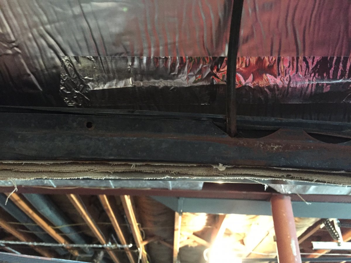

    image.jpeg I then crawled into the back seat and popped the last bow out and slid it threw the sleeve on the back- the listing as it's often called- and put it back in place. Finished they sit about 90 deg from the window edge but I let them lay down at this point. - side not they bows are under a little tension but they more or less just need clocked correctly in the funny shaped hole they go into and squeezed a bit to slid one end out and then the other side slides out.
    The bows need to stay in the right order so I just pulled them and installed them in the car one at a time instead of trying to put them all in the headliner and then try to get it into the car and blah blah blah.
    Anyhow I did the first two or three by themselves and then did the next in groups sliding two or three bows into the listing and then putting that group into place. The panels get kinda short so it would be really hard to slide one bow in and put it into its place at a time.

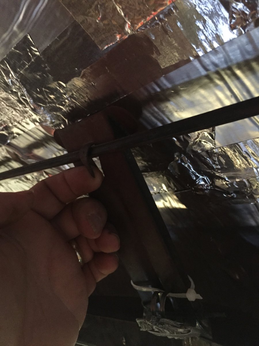

    When you get to the front the bow is held in the center by a metal tang. You need to pull it back and remove the bow, slide the bow into the listing, put the bow back in place but not pushed all the way forward.
    At this point you need to look over your saggy headliner and make sure it is even from side to side. Pulling on the white listing to adjust it and NOT on the fabric panels.
    Once your happy with how centered it is you push the bow forward with the last panel hanging down out of the way until the listing hits the tang. Cut a small slit in the listing and NOT the fabric and insert the tang into the listing and slide the bow under it. With this all in place you can use you hand or a really clean hammer to push the tang down/up to hold it in place like it was when you started.
    This one solid point is now your front to back and side to side reference point as its not going anywhere now.

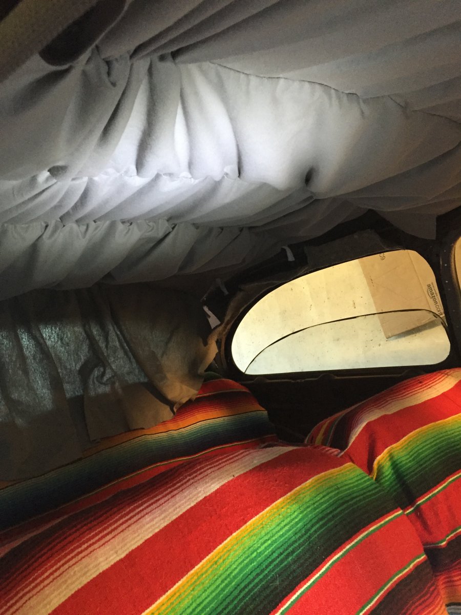

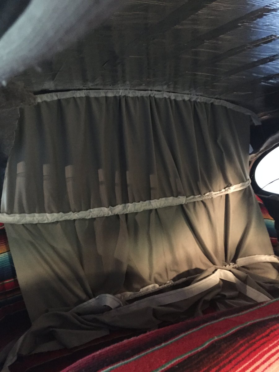

    Now I worked my way back laying the bows into the correct position

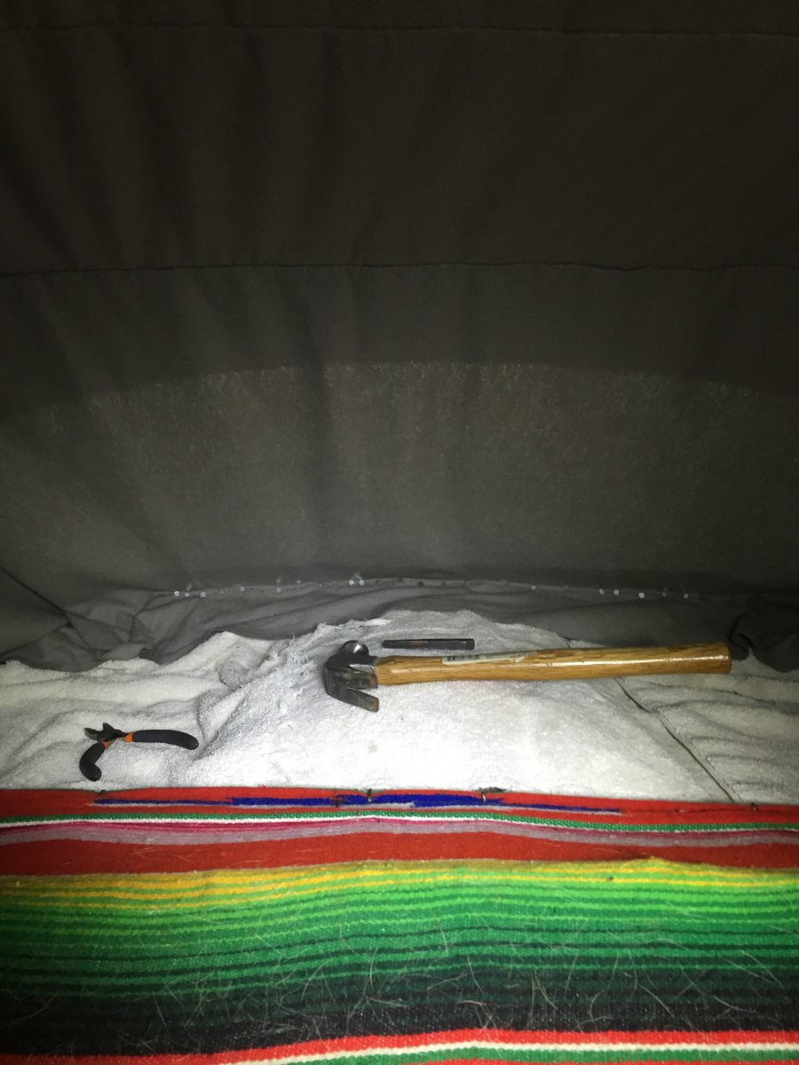

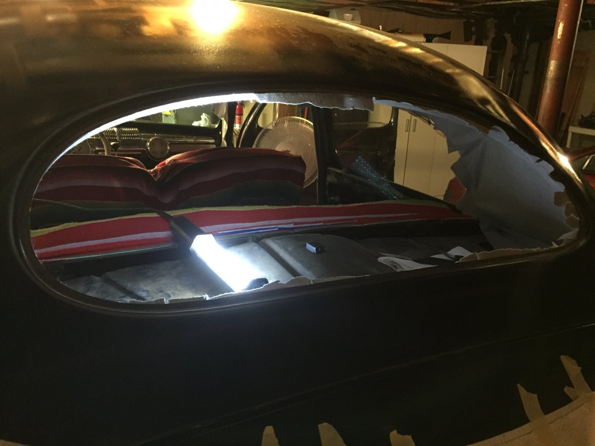

    Looks a little like a bedroom fort at this point haha. image.jpeg then I worked a little at a time getting the side to side wrinkles smoothed out some. Getting rid of the bunches really. What you do is cut a small slit, I used scissors, on the far side of the listing and pull them down. The listing in my case has a crease in it where it hangs on the bow, you cut it and it allows it to come down over the edge with out gathering up.
    The panels sort of flap over in between. Keep in mind to get slow and in small increments working one bow at a time, pull only on the listing, and do NOT cut the seam.
    One it feels as good as your going to get it, I kinda pushed it down as to simulate it being pulled and secured into place, you pull the back down and secure it.

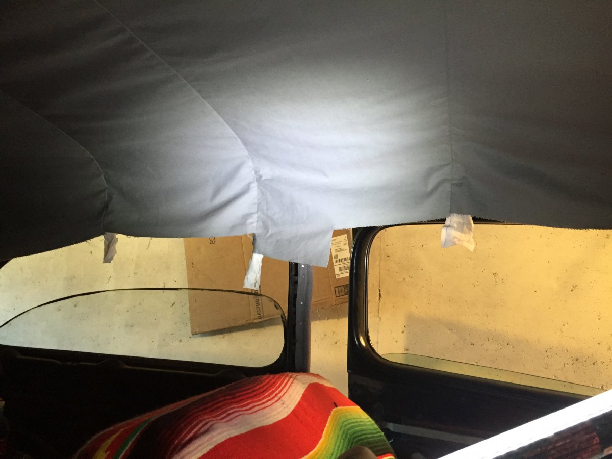

    The back tacked in place and the front bow in the tang/clip it was as tight front to back as it was going to get so I moved to glueing the last panel to the edge just above the windshield.
    You can see here that I held it up with some magnets and started with a 10 inch wide section in the center. I then let it dry and set up before doing small sections working back and forth towards the edges.
    Towels are to keep glue off the dash, I was using a fan to cool me off and let the cemet set up faster so I didnt want to risk a stray slobber of glue.
    image.jpeg Here you can see how much extra fabric there is. I stretched under the edge and glued to the bottom edge. That area is the dark narrow line. I tried not to over saturate the area with cement as to permanently discolor it but it was enough to make it a little darker until it dried. I used the round end of a putty knifes handle to kinda burnish the fabric flat and get it nice and tight.

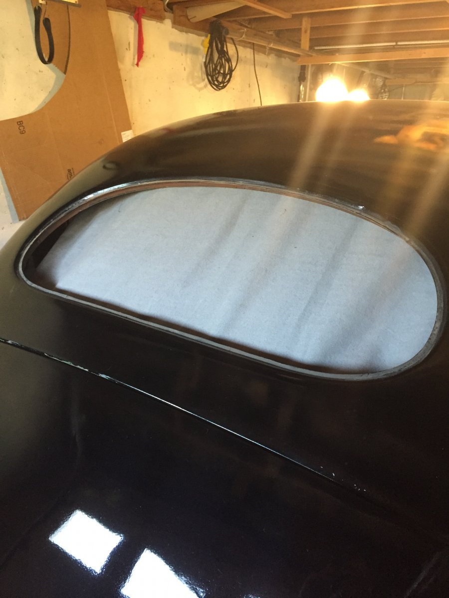

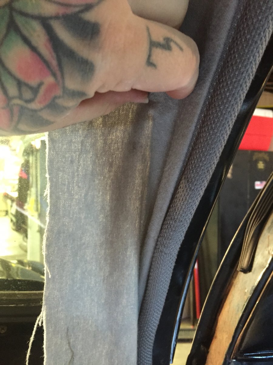

    Right I got the windshield edge glued in. Ok. So after that I reinstalled the alligator teeth/grab rails over the doors. With it installed you shouldn't really see the bias tape of the windlace or at least not much of it. The fat cord part of it should be fairly close to the bottom of the grab rail.
    I then worked towards the back getting the side to side stretch nice and tight. Again working one bow at a time going back and forth i took a little bit deeper cut into the listing until I could pull it all tight. ( you kind of have to guess a little on this part as your still just pulling on the listing)
    Once they feel about right all the way to the back come back to the front of the car and trim the white listing so that there is about an inch hanging below the grab rails.
    You then shove just the listing into the grab rails making the bow areas nice and tight. One bow at a time until you get to the side windows. I used a smal putty knife. It worked pretty well but I think had I rounded the corners I could have made better use of it. image.jpeg

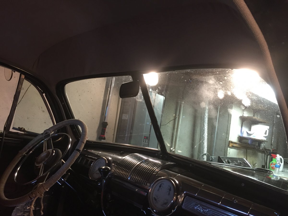

    Terrible photo but when it's indoors, at night, and the back window is covered it's what we get. You can see here I pulled the listing tight and cemented it to the lip around the window opening.
    You don't glue it to the vertical face where you glued the padding but the horizontal surface that faces down.
    With the listings secure you can move onto the panels. Working my way back forward I was careful and stretched the panels into the window openings. I used some tape but a bunch of small strong magnets would have been way better. You want to make sure that while you pull the wrinkles out your not going at a weird angle or creating pickers in a different panel. Having something else hold it really helps to see what it will look like all tightened.
    To make the transition of the tighter curves near the back of the window make some little slits on the edge of the fabric. You can typically see where they need to be. When you use your hand to stretch the fabric around the tight bend you'll see the section that needs cut pulled tight.
    It's best to take make the slit a 1/4 inch or so at a time and test it weather than cut to deep and have really fowled it up.
    When your happy with it glue the panels to the window opening. Leave all the extra material still.

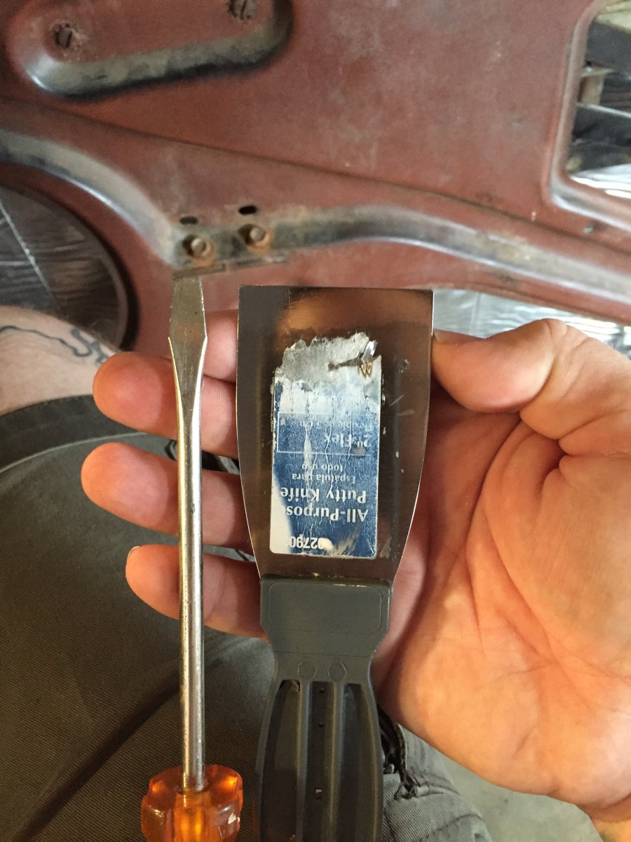

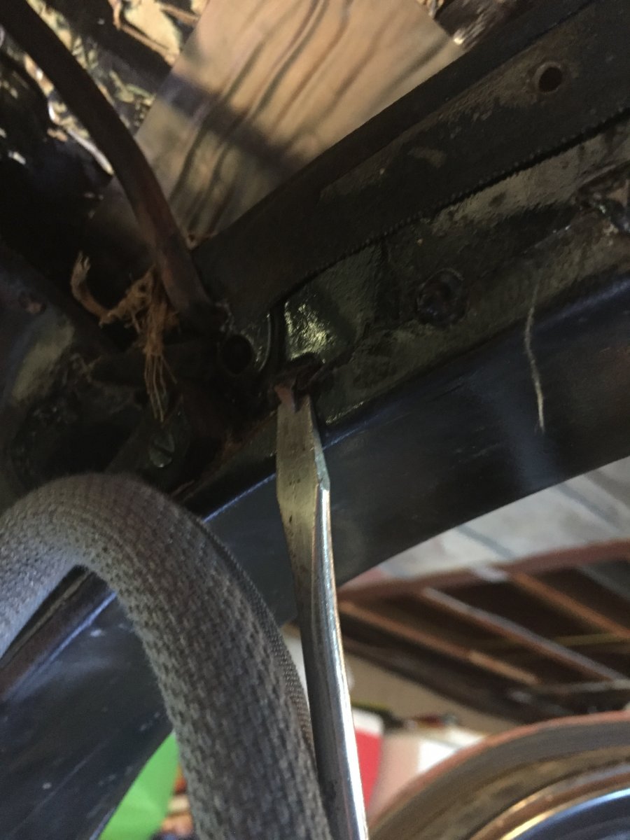

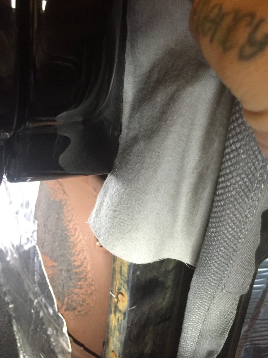

    image.jpeg Moving forward to the grab rails I used my screw driver and putting knife to push the panels into the rails.
    image.jpeg I pulled it tight and worked the area that was close to the grab rails into the teeth until it was holding but hadn't "****ed in" all the extra fabric. I took this photo to show the angle of the putty knife going into the teeth. It's not straight up.
    The instructions said to shove an inch or two of the fabric up into the teeth so with it secured on both sides I cut the panels about an inch and a half below the opening and then shoved it into the teeth. I figure the extra material shoves the teeth deeper into the fabric and holds more pressure on everything.

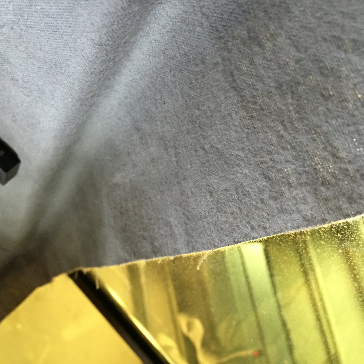

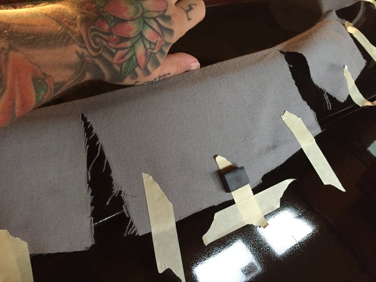

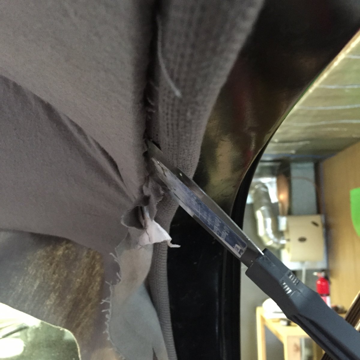

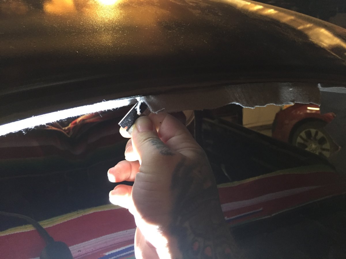

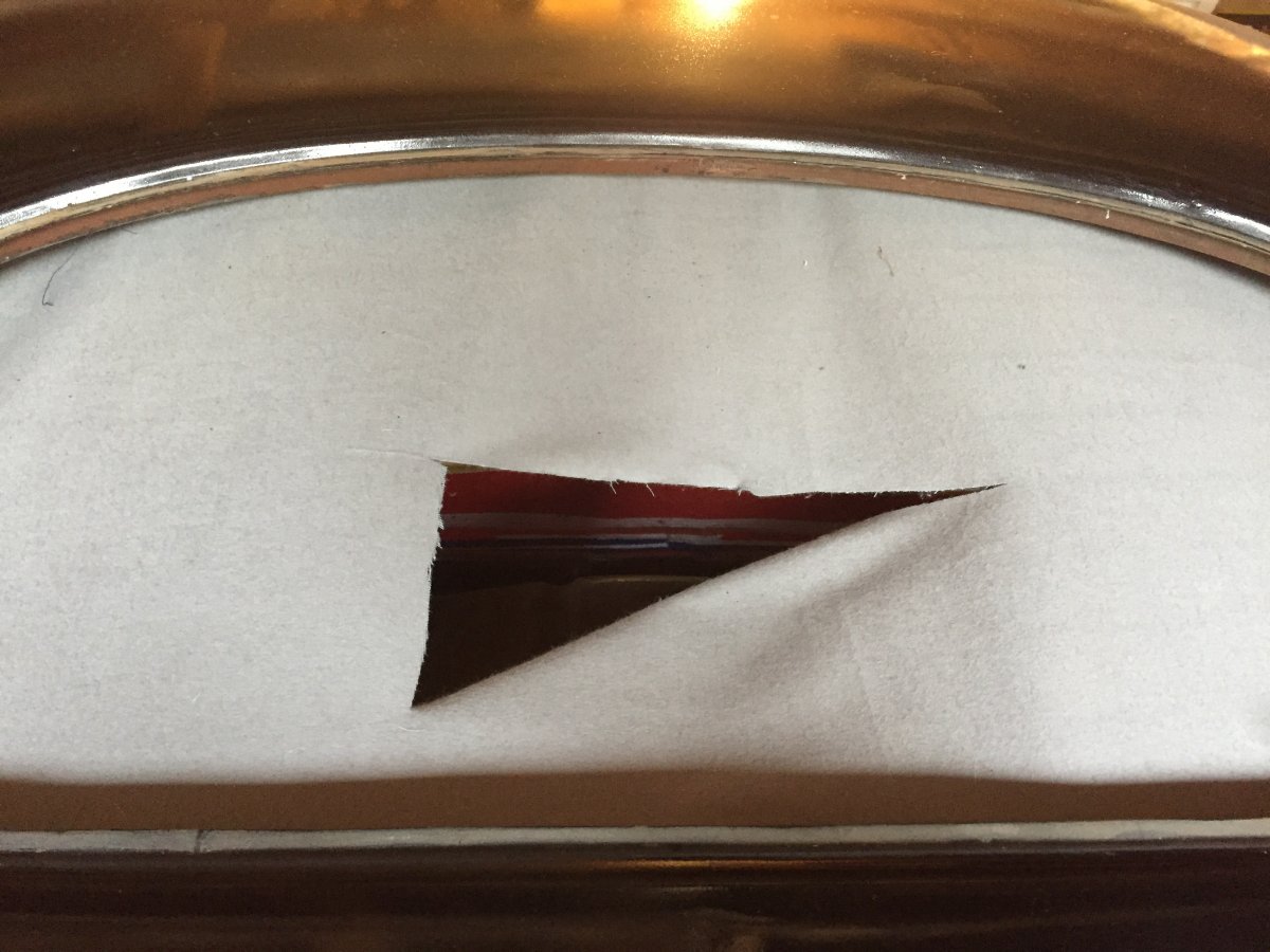

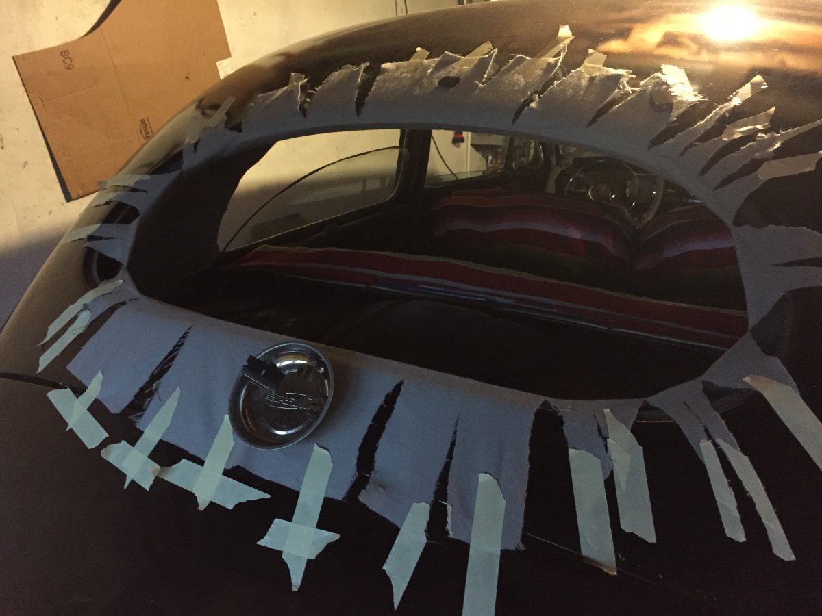

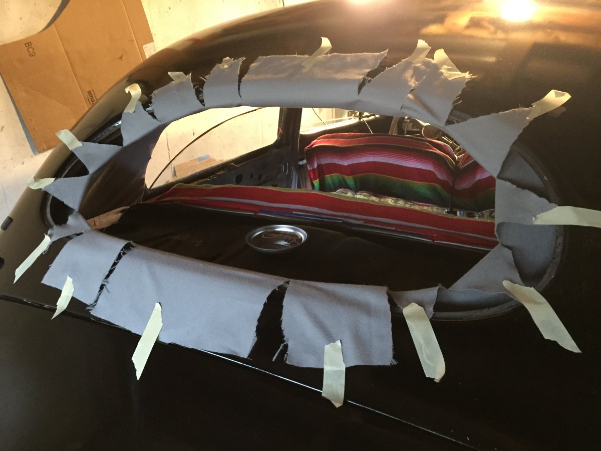

    I left the little corner flaps near the windshield lose and in trimmed to deal with later and moved to the back window.

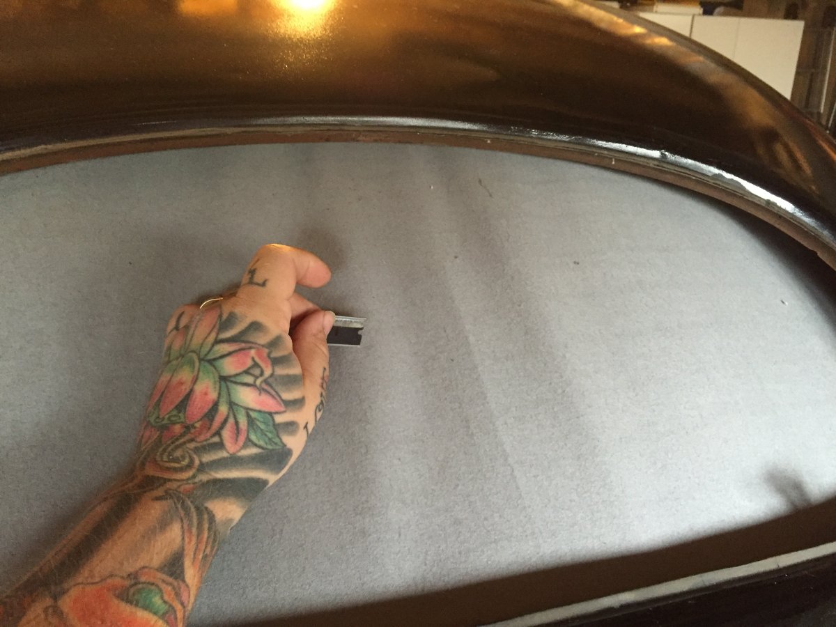

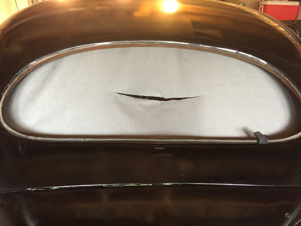

    image.jpeg Yikes. I took a new razor blade and cut a knick in the center of the opening and slowly started opening the window area up in segmented flaps as the headliner glues to a flat lip that the back window gasket covers. I think I took some photos trying to explain where exactly but for now I'll post photos of how I did the back window opening
    image.jpeg image.jpeg I tried to keep the cuts quite a bit shy of the edge because I wasn't really sure how far the fabric would stretch and didn't want to have a slit showing from under the rubber gasket because I rushed it.
    This took a long *** time. Be prepared to take your time.
    Here you can see me starting to use the magnets and later tape to hold everything out of the way and sort of in place. image.jpeg My first cuts made an H shape and then I brought the center line further to the sides and added an upright. You can also see that I've started halving the top flaps already because the top of the window has quite a bit more curve than the bottom

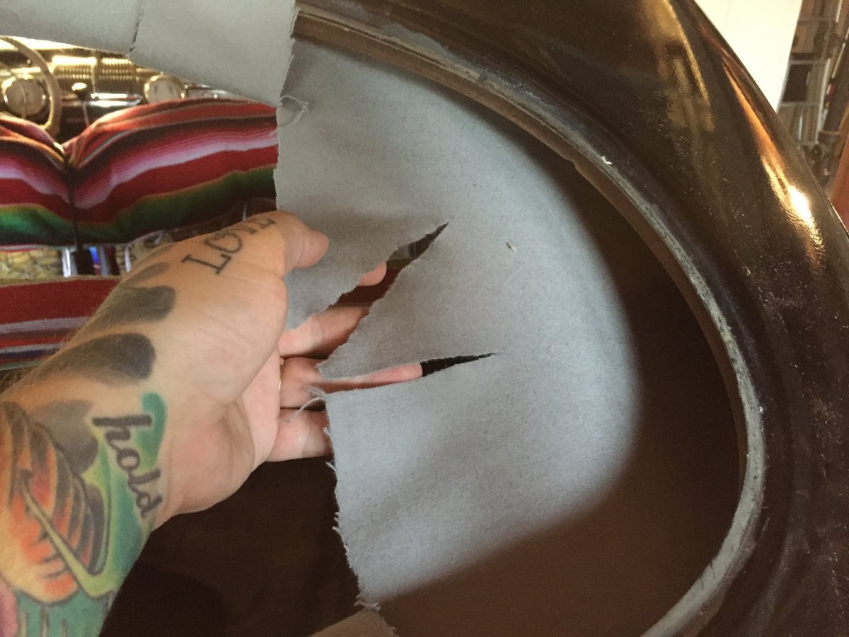

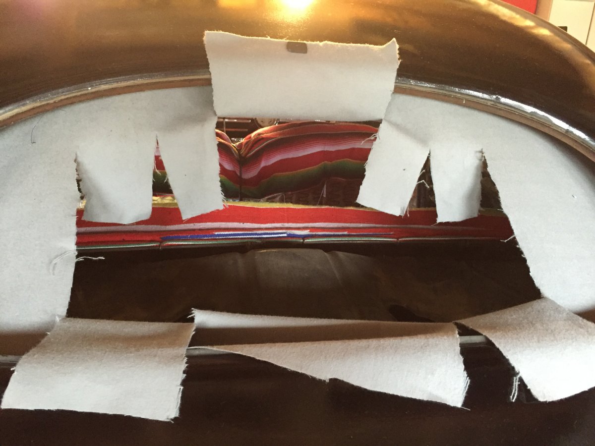

    image.jpeg This is how I approached the tonight side sections.
    In this photo you can see that I've slowly snuck up on the opening with the slits and have things holding the sections tight.

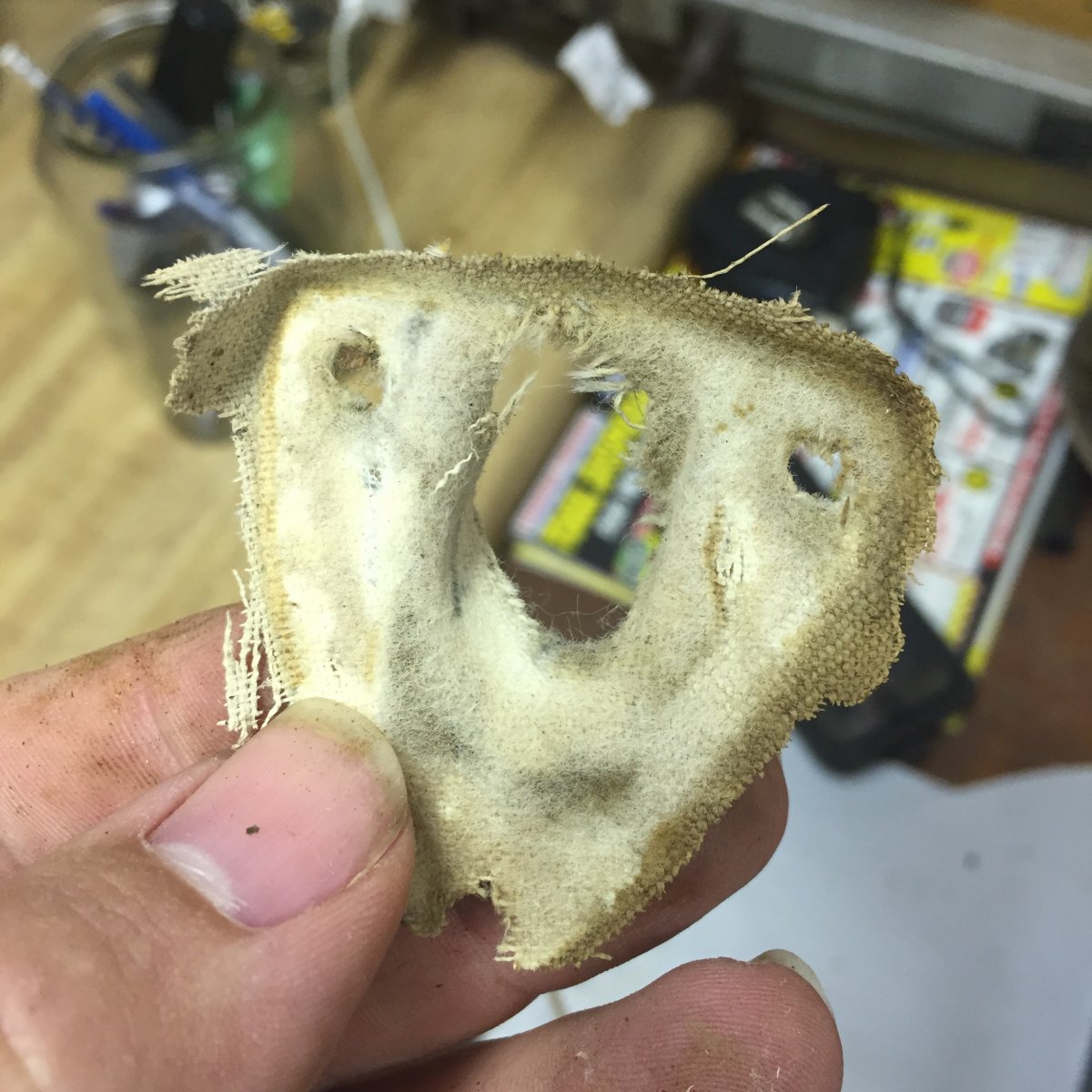

    image.jpeg Should look about like this at this point. image.jpeg my thumb is resting on the lip I'm stretching to. The opening is like an upside down T my thumb is on the vertical leg and the headliner will glue to inner horizontal arm.

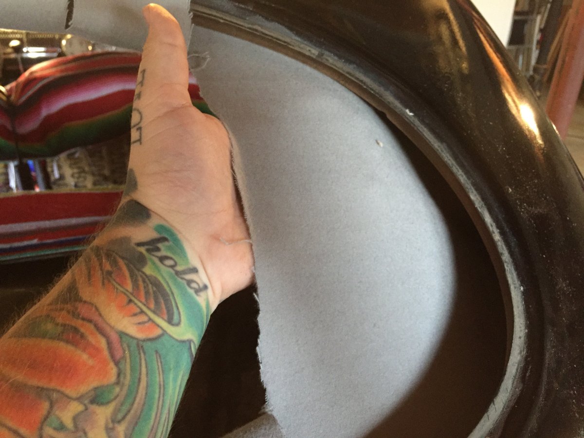

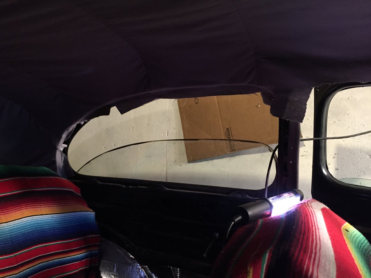

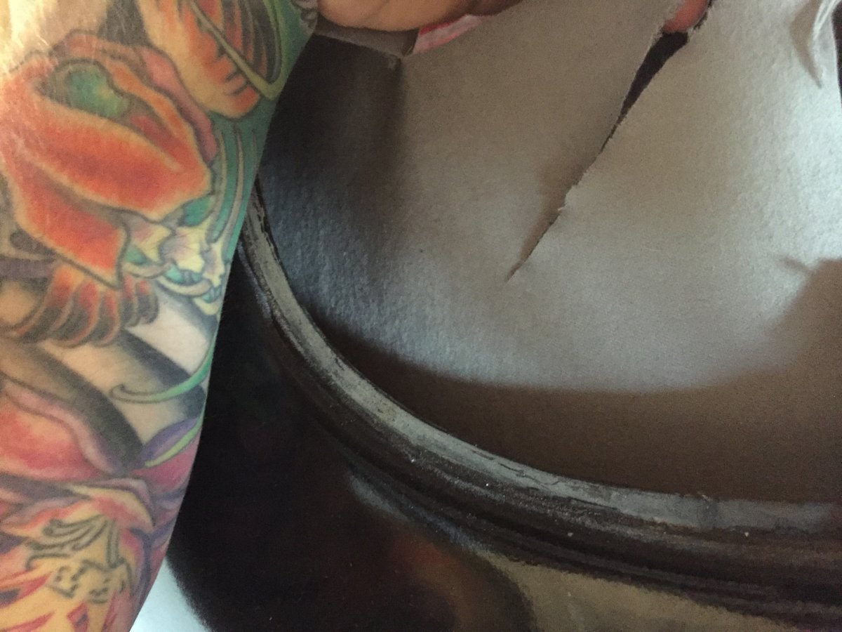

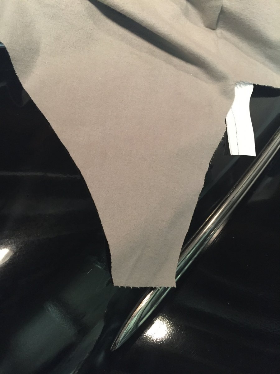

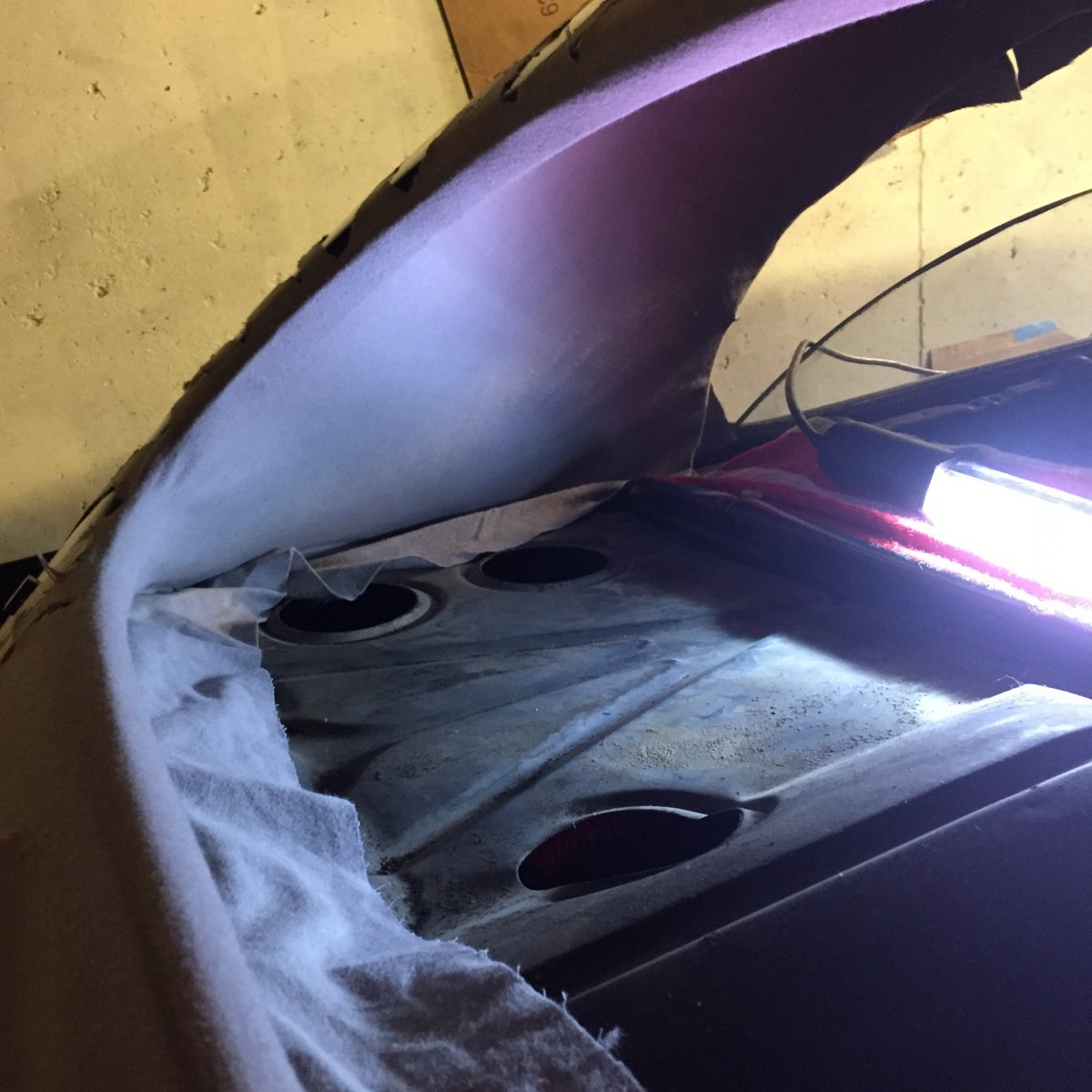

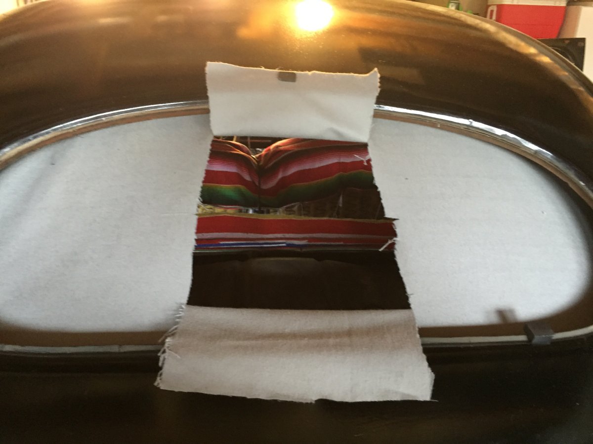

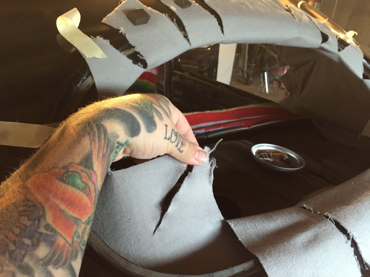

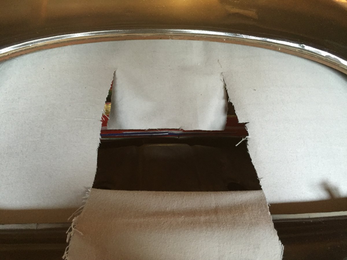

    As I worked the curves closer to the lip I started splitting each triangle section into smaller ones. Really trying to sneak up on it and keep weird tension out of it.

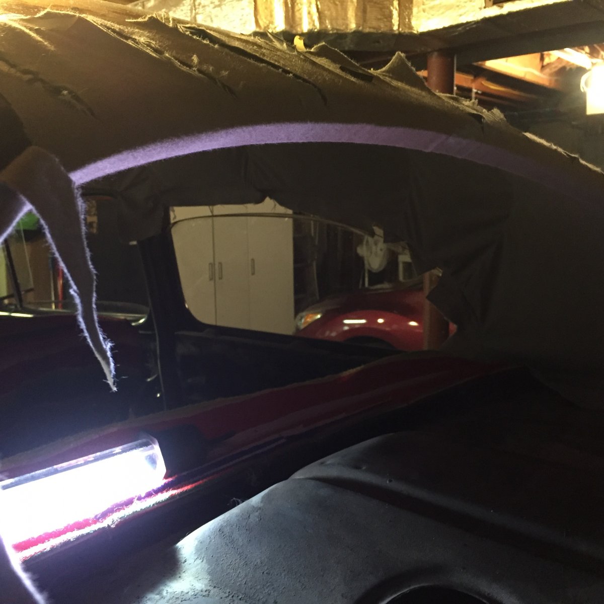

    image.jpeg You can see the width of the opening here and see that I didn't need to pull the cut lines all the way to the opening to release the tension in the fabric as it transitioned around the curves. image.jpeg as I brought the tight curves in closer i tried to pay aren't ion so how the headliner looked on the sail panels to make sure I wasn't making it look weird or twist. the wrinkles you can see near the top of the back seat get stretched out later after I pull the back seat and cement it down to the panel there.

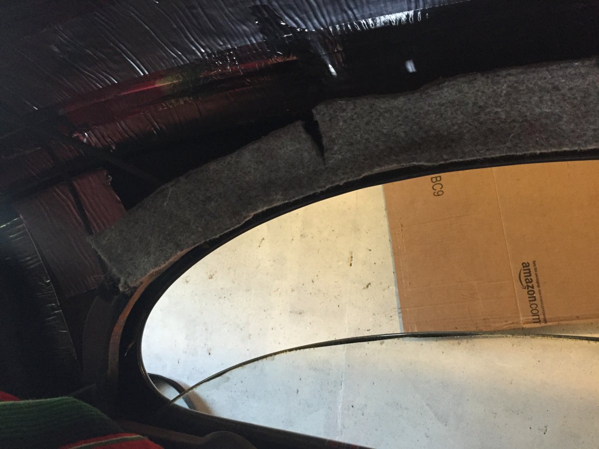

    You can also see all the extra fabric on the package tray that hasn't been trimmed yet image.jpeg got it all tight and looking like something that blew up in a looney toons cartoon!

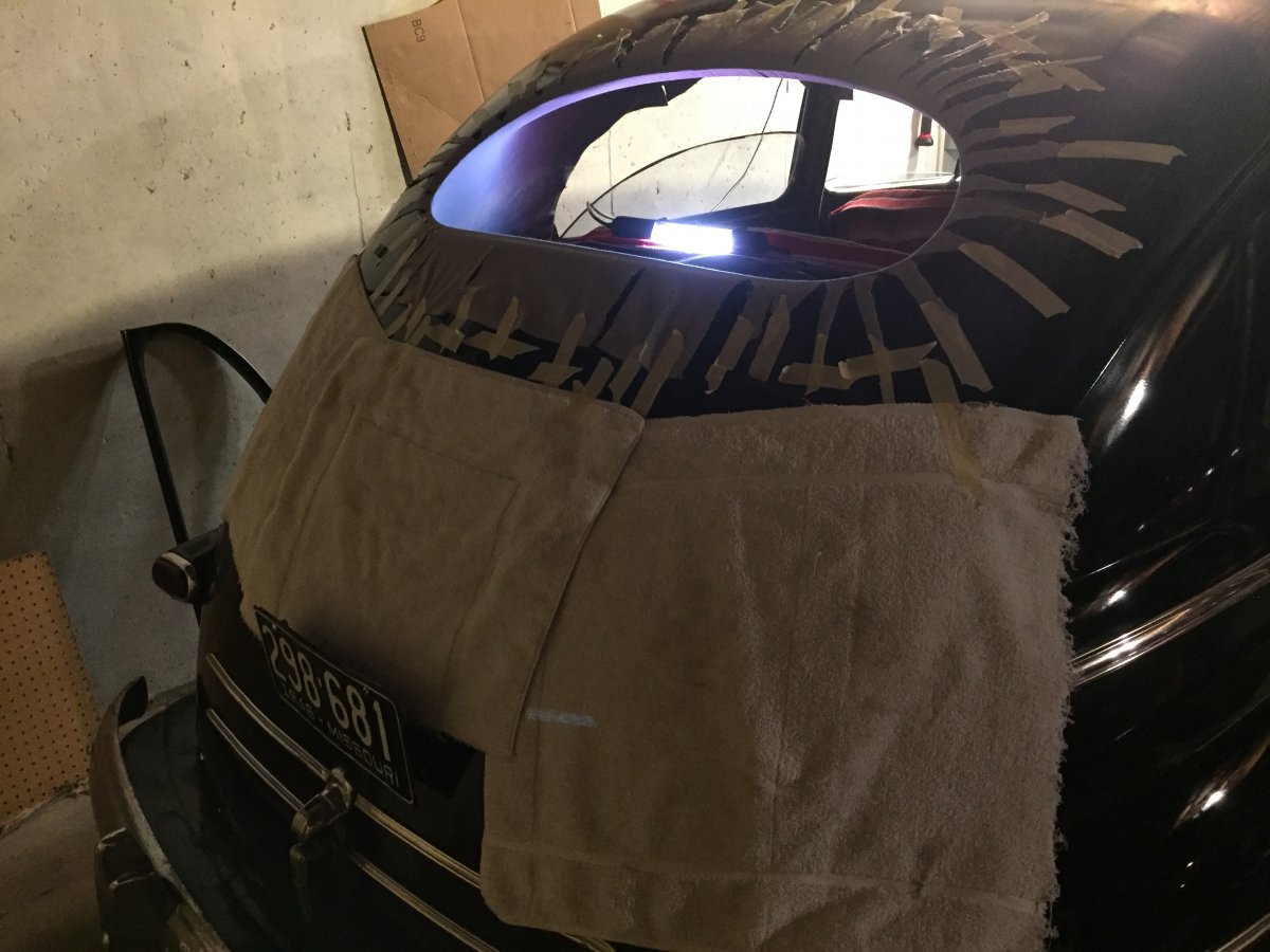

    I the went around and glued small 3-5 inch sections in at a time leaving the rest tapped in place. I trimmed the sections back a bunch as i got a chunk done so it was all trimmed about the time it was all glued. image.jpeg
    I the ran a razor in the corner of the T and cut the extra off after it had dried for a while. This lets you have the most surface area when glueing it in. So there's a good half inch wide strip of cemented area around the whole window holding it in place. image.jpeg image.jpeg There ya go! Almost done

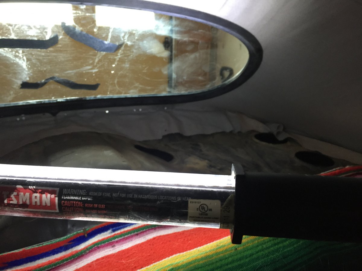

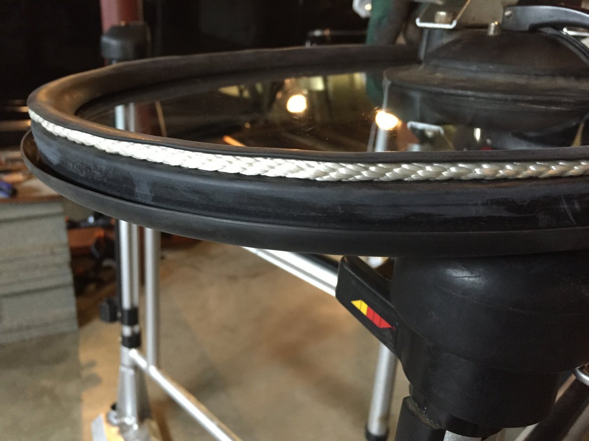

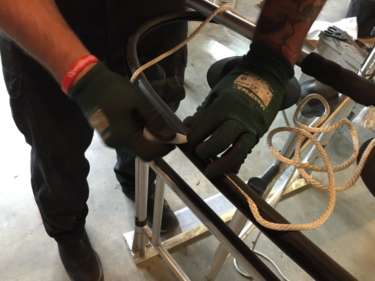

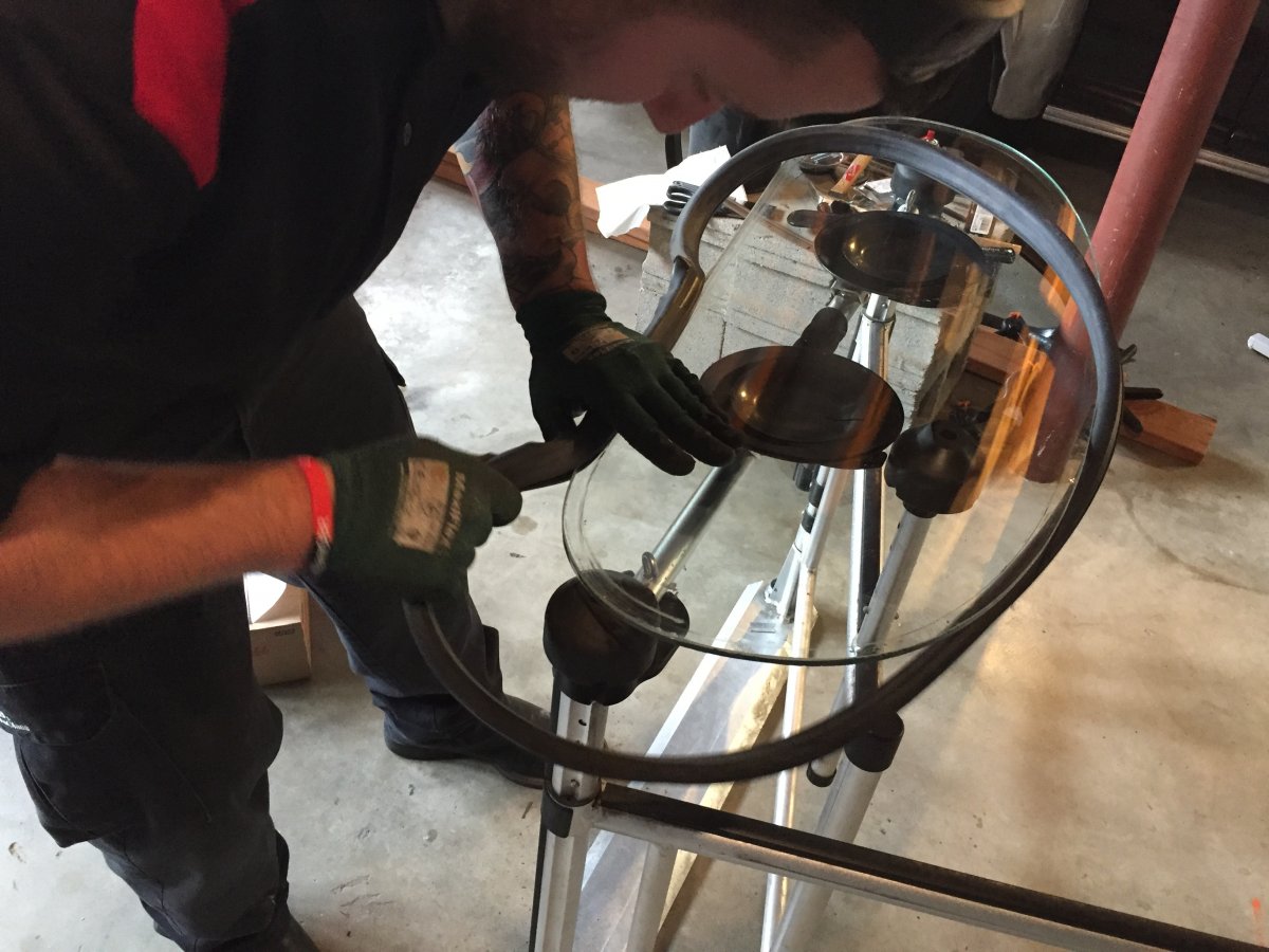

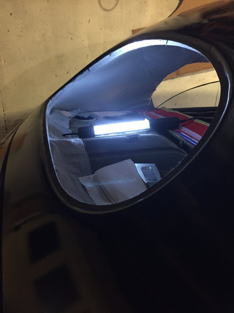

    Time for gl***! image.jpeg clean up the gl*** and put the new gasket onto the gl***. I think there's a marker that shows bottom center on these and there is a front and back. It's pretty easy to figure out and came with directions but I did have a friend who does this for a living come do it for me, but I did help more than taking photos as it really does go easier with two people. image.jpeg
    I thought you guys would like this little trick, he's feeding the rope into the gasket threw the cone of a caulking tube so you have a good grip on everything, the rope isn't bound up in your hand, and the tube tip pushes the gasket open and let's your direct the rope right where you want it!
    image.jpeg Gl*** is in! - the window goes into place from the inside, when we removed it we cut the seal on the outside and pulled it in removing the old gasket after it would out of the car completely.

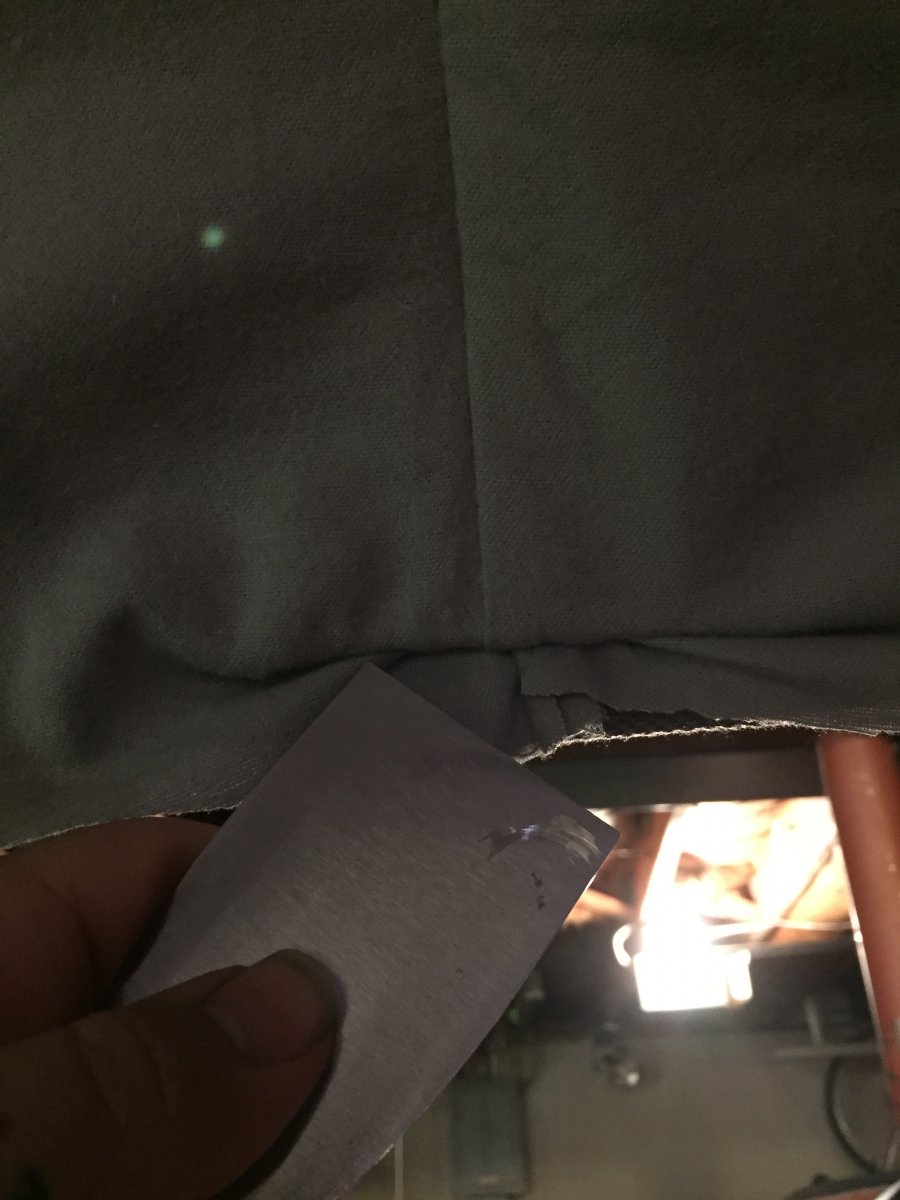

    Ok so no photos of this but I then went and cut the extra material out of the back window openings. Against right at the end of the flat so there is as much cemented area as possible.
    Onto the windshield area I ran a razor along the edge and cut all the extra out leaving some extra at the ends where the A pillar begins.
    I then trimmed the flap on the windlace that goes behind the dash and up the A pillar so that I could use my putty knife to shove a few inches of it between my dash and the A pillar. There are some curvy transitions around the bottom of the windshield/ top of the dash that you'll have to cut some reliefs for as you lay the flap over the A pillar to get it flat.
    My kit came with a little cardboard piece that I think your supposed to wrap the fabric around and sorta wedge it into the A pillar and then the corner flap from the headliner goes behind that. I ended up t******* the fabric flap to cover the A pillar, rolling the edge over and glueing it to itself and then cementing that all to the A pillar/ A pillar tack strip. Folding the top over as well and t*******/ tucking the headliner flap in behind it.
    Sorry for no photos of any of that, just take it slow and use common since and you'll get it.
    image.jpeg The piece on the right is the A pillar cardboard. On the left is an upholstered panel that goes on the B pillar after you trim and glue the headliner down.
    image.jpeg It bolts on to a 1/4 20 nut that's welded into the B pillar. I'm going to cover this bolt head with something more flattering but honestly once I put the seat belts in you can't even see it.
    The length of the piece is held in place by the garnish molding and the bottom goes under the interior panel so there is no worry of it dancing around.
    image.jpeg Put your windshield garnish molding in and your quarter window garnish moldings in and your done! Well I guess you need to carefully ***** some holes for your sun visors and instal them as well but seeing as I haven't covered mine yet they are still out of the car.
    You can kinda see here that most of the A pillar is covered by the molding so don't stress to much.
