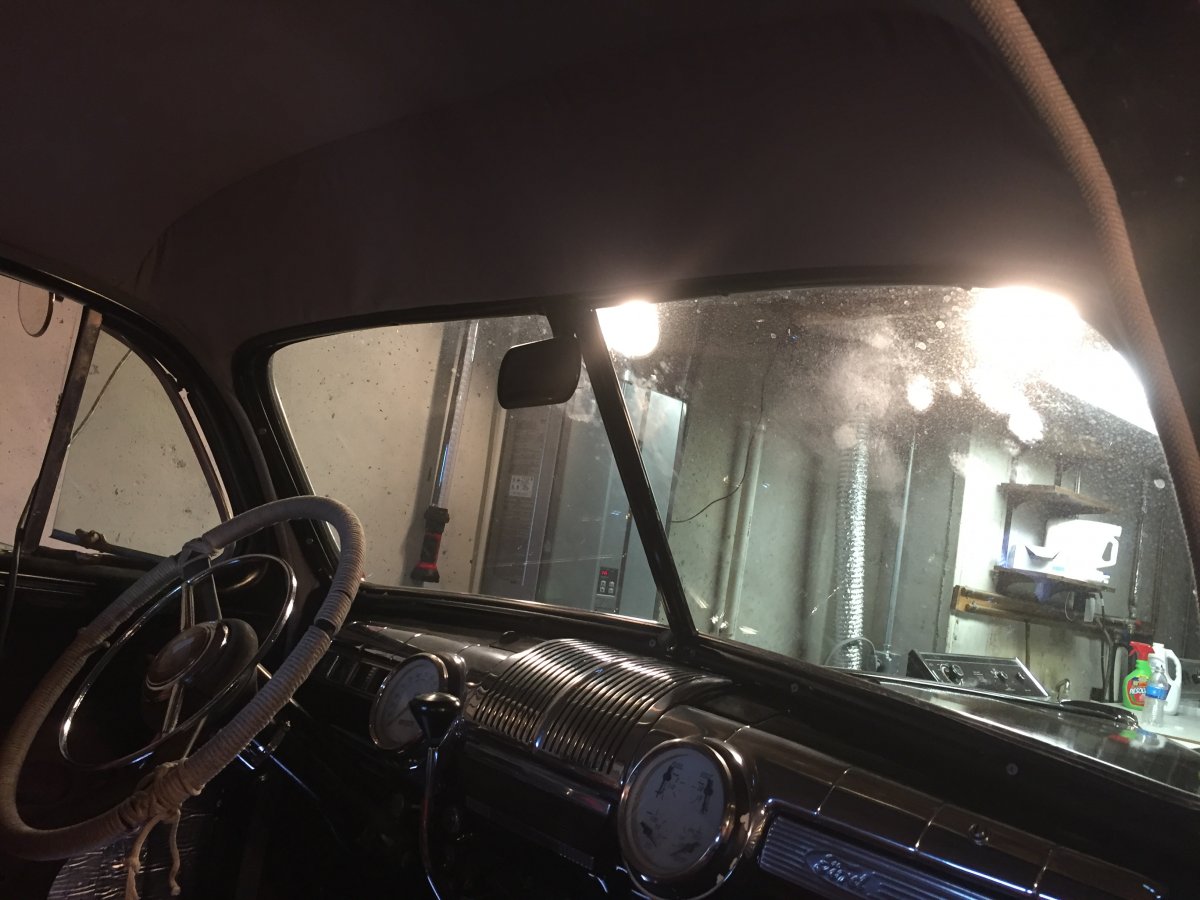

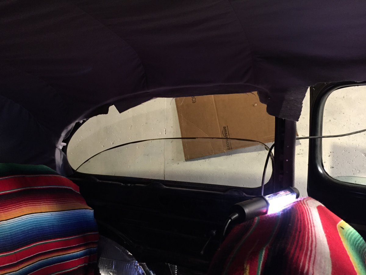

    I’ve also found this through an internet search... excellent and thanks... I spent Saturday doing the bows and basic install in my 40 Ford... need to finish windlace first which I would not have guessed without your post.
    Great contribution....
    Some pics...
    Sent from my iPhone using H.A.M.B. View attachment 5038772 View attachment 5038774 View attachment 5038775

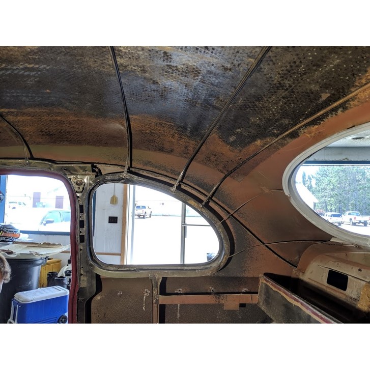

    What do we do with the two sets of thin wires on either side of the rear window on my 46 short door Business Coupe? I do not see this addressed on any forum or install video. Thanks in advance.

    ...Some people use them, some don't. Ideally, I like to see them used as they can help keep the headliner nice and tight in that kinda complicated area in the curve to the back window.

    What did you do with the two sets of short wires between the quarter windows and the rear gl*** ?

    Your headliner needs pockets for them, just like the rest of the bows. I favor using them.
