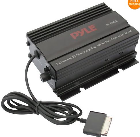

  23. squirrel
    Joined: Sep 23, 2004
    Posts: 59,983
    squirrel
    I got my old truck running again, it has speakers but I took the old underdash c***ette deck out. I ordered a $25 PYLE 2 Ch 300 W Mini Amp w/ipod Direct Input PLIPA2 from ebay, I'll give it a try. Rated 15 watts/channel RMS into 4 ohms. Has an ipod docking connector.
    Maybe I'll remember to let you know how it works once I get it installed....

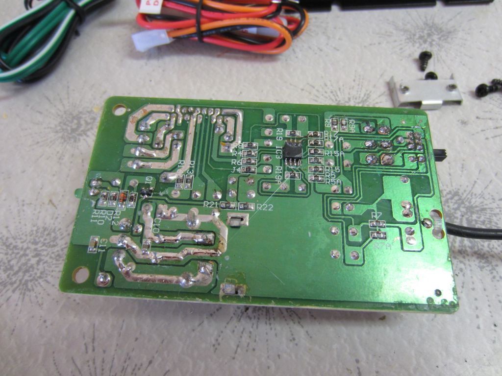

  30. squirrel
    Posts: 59,983
    squirrel
    I got the cute little piece of **** in the mail today. It has a stereo volume control built in. Also the input cord for the ipod is an option, there is another version that has a normal 1/8" (3.5mm) stereo jack for any audio device to plug into.
    I'm thinking of desoldering the volume control, and remoting it with 6 wires, so I can mount it in the dash, where the original radio volume control was. I'll mount the amp behind the dash too.
