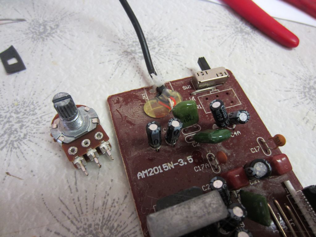

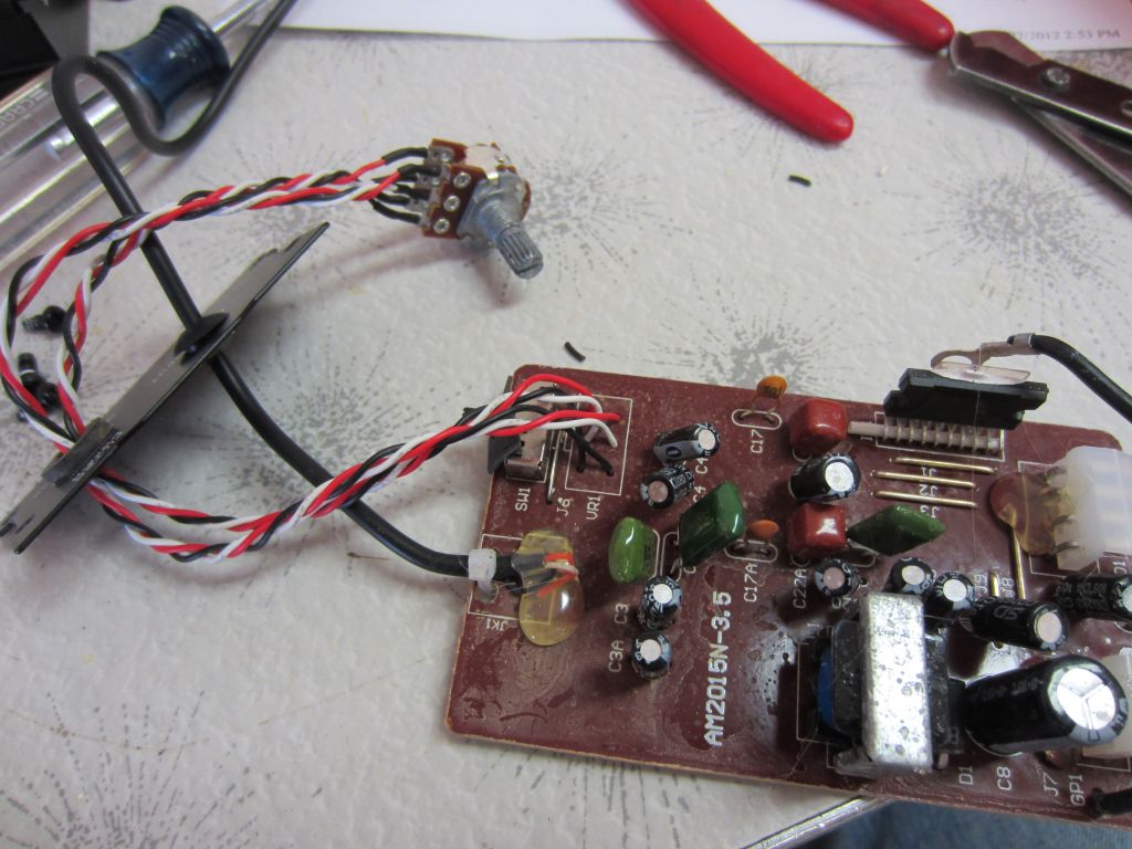

    I got it finished...and I'm not too happy with it, but it should work for now. I will probably change the cord from the ipod cord, to a normal 1/8" plug. The problem is the volume control (called a level control on the unit) does not turn down all the way--it's plenty loud at low volume, and really loud at full volume. The ipod connector is a line output, so the ipod volume control does not affect it at all. That's why I'll probably convert it to use the headphone jack--then I can adjust the volume on the ipod to get a decent range, and use the volume control on the dashboard to quickly adjust it as needed, like when my phone rings, or the gal in the car next to me is complimenting me on my *****in old truck.
    also, the ipod connector is not a charger, just a line input. So you need to charge your ipod between uses.

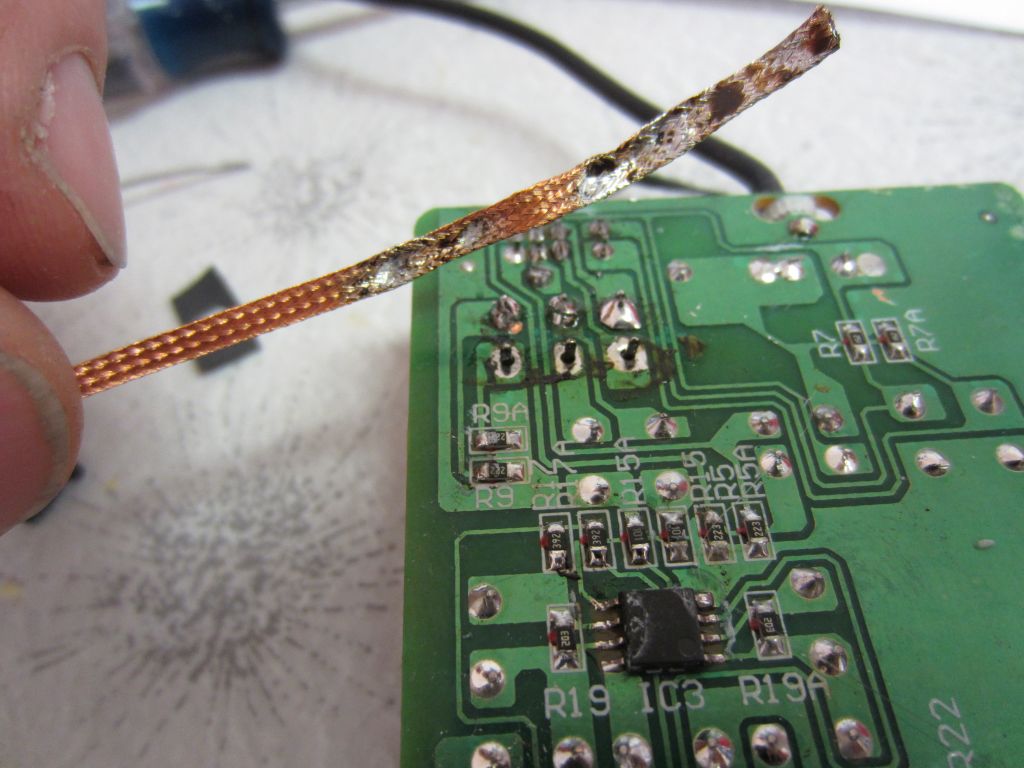

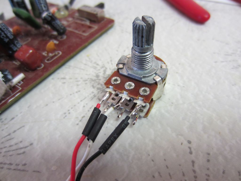

    Some pics. I used solder wick and a soldering iron to remove the solder from the volume control, then I added some wires between the control, and the circuit board, and put heat shrink tubing on the end. I ran the wires thru a grommet, which I put in the original level control hole in the end panel. I found a nut to fit the control, and used a couple 1/4" washers to make it fit the 1/2" hole in the truck's dash. I found an old vent knob, and drilled it to 7/32" and then partway thru 15/64, it fits sort of ok but not perfect.

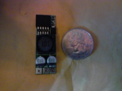

    OK, 6V guys (like myself)... Got this in the mail today. My new 6V to 12V inverter, which will allow me to keep my 6V system and run a modern 12V head unit (hopefully). Cost about 6 bucks plus s/h, and if it works I'll be a happy boy. Wondering where I should take the 6V IN from... Maybe the ignition switch? Or would I be better off running a line straight from the battery?

    How many watts is your head unit? How many amps is the fuse? You have 1.5 amps available, that's 18 watts, and that is the maximum rating. Let us know what happens!
    You can connect it to either switched or battery power. It will only draw a few amps. Most modern head units have memory and use two power sources, one switched and one from the battery (this is the main power source).

    Hi squirrel. I haven't got a head unit as of yet. I haven't decided whether I'm going to use an AM/FM CD unit or just run an iPod sort of thing. The 12V inverter was purchased more or less to drive the amp/speakers, which I'm certain won't work well off of 6V. I'm going to follow this thread a little longer before I make any decisions as far as a source. I'm in no real rush, and I figure the car has been without it for 60 years, so IT'S not in any rush either. I just want to do right by it.

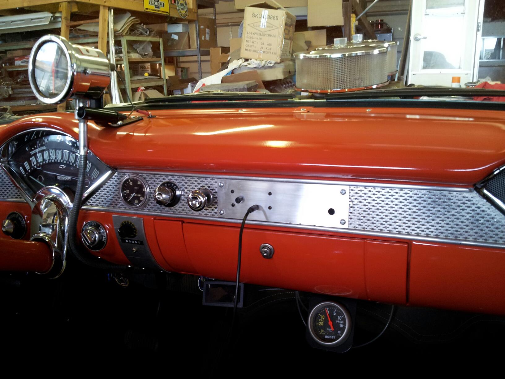

    I just put a little Pyle PLMPA35 in my 55, cost about $25 for the amp. Seems to work. The amp is behind the block off plate, I replaced the end panel of the amp with the plate I made. Yes, I'm going for the race car look, you can make it look like whatever you want.
